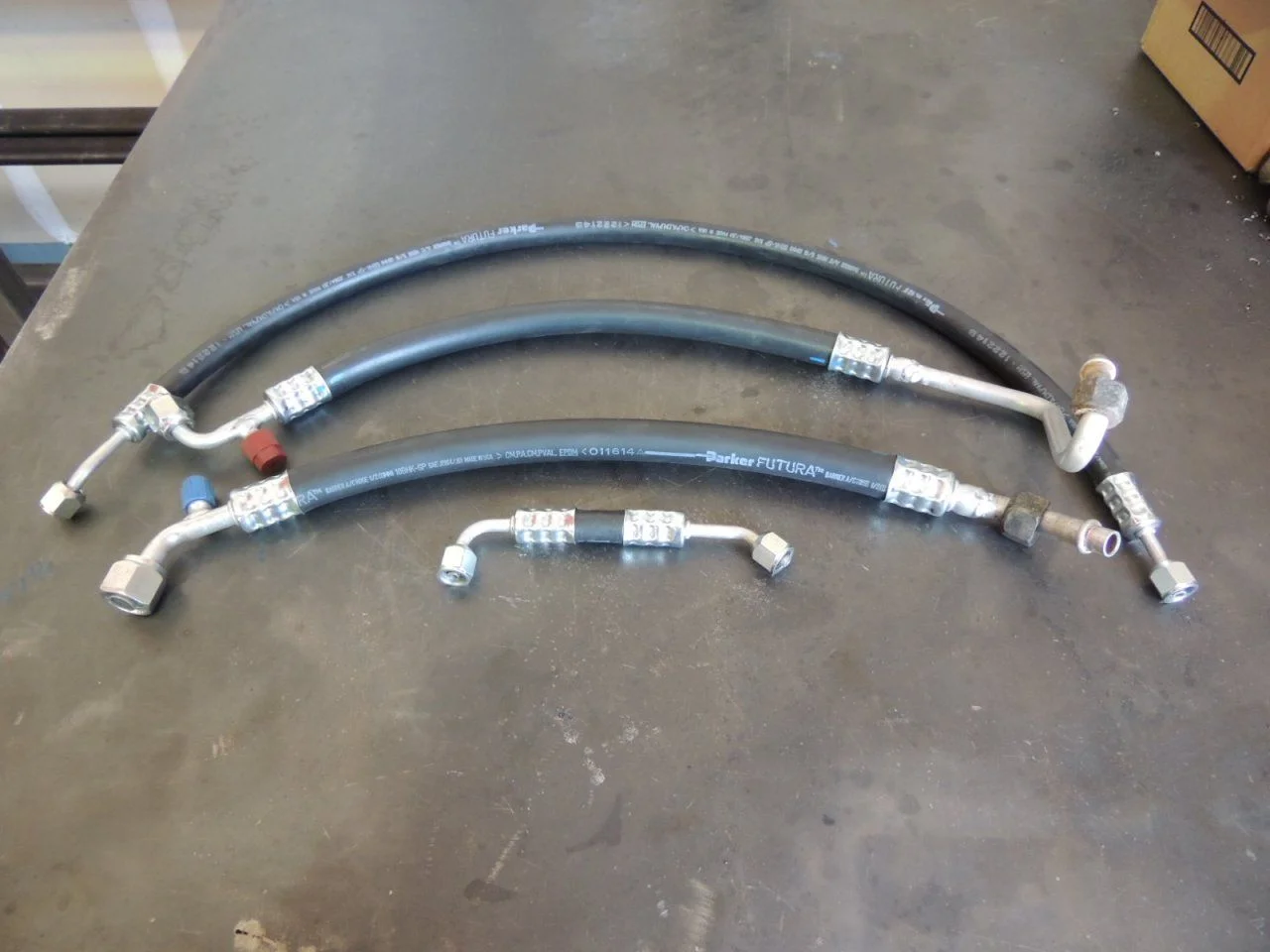

...the completed set of A/C hoses.

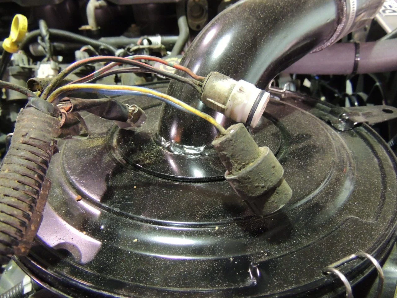

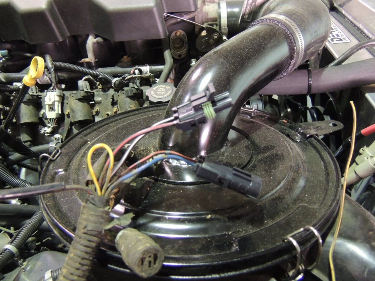

Love the weatherpack fittings. So what is the yellow wire that is looped back? Assuming that is something that isn't utilized by the GM harness.

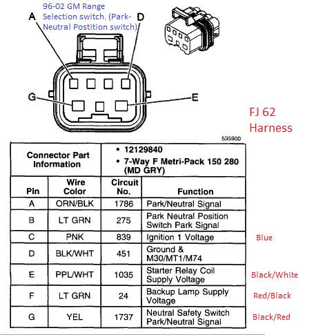

Could you detail how you wire the backup light and neutral safety switch to work with 4L60E? I tried to figure out how to wire them to the MLPS and gave up in frustration.

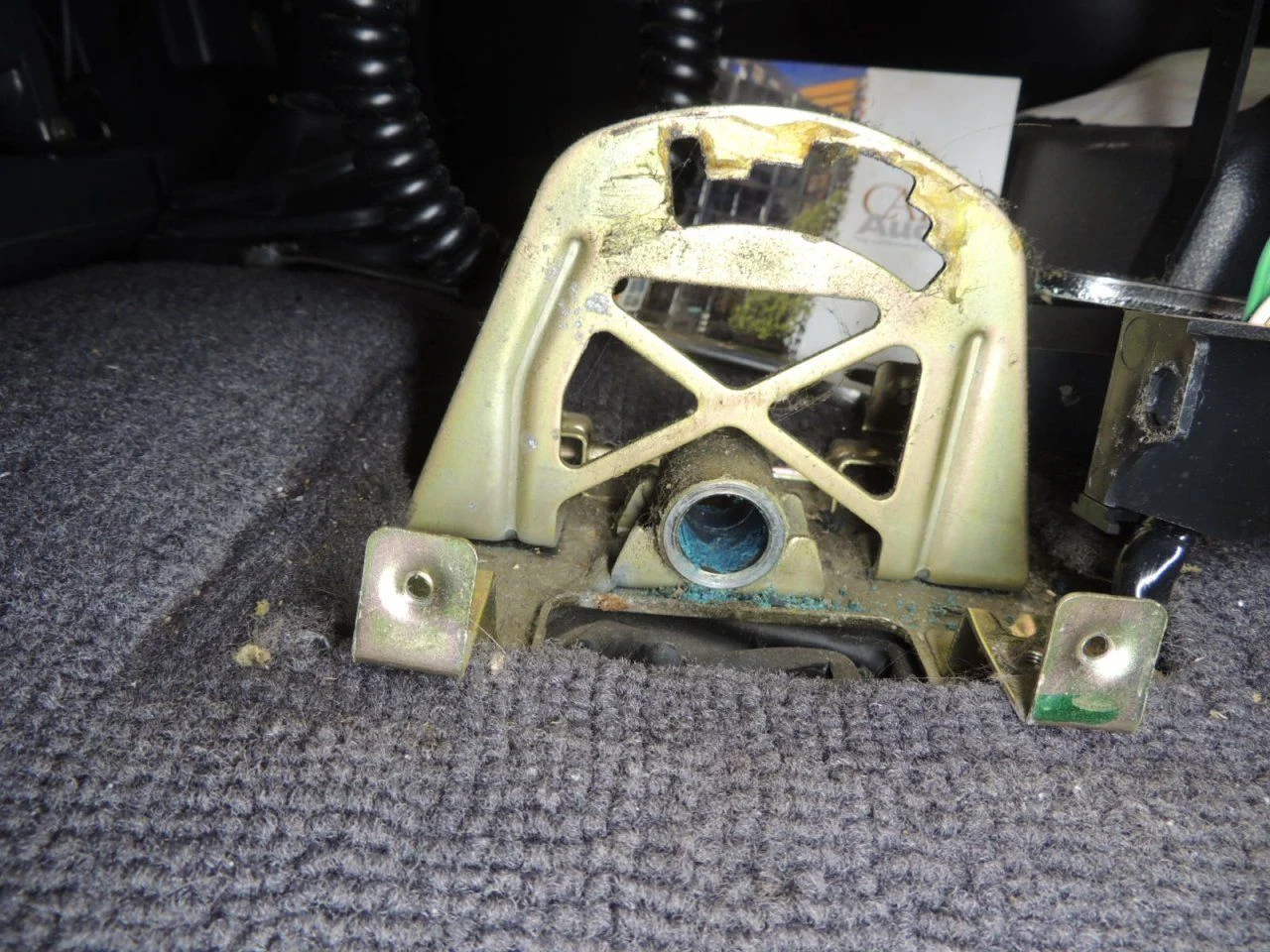

Up next, we'll be modifying the shift linkage, to get everything to read properly on the factory Toyota shifter with the GM transmission.
...but first, we'll have to do something about this.
The stock shifter bushings are so whipped that even the Toyota gear shifter doesn't correspond very well with the Toyota transmission.
This is what they are supposed to look like...
So all the gold colored bracketry is stock Toyota stuff? I purchased my FJ 62 with a Chevy swap and Lokar shifter and none of that gold stuff is there. I have a vision of mating a stock shifter to the 4L60 but it looks like I would need to get not only the shifter itself but the tabs, brackets and pivot point where the bushings go. Is that about correct?

The gold bracketry comes with the adapter kit.

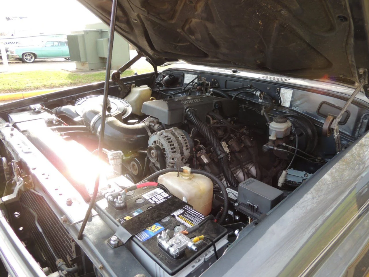

...about to take the first hoodless lap around the block.
How did you plumb/incorporate the charcoal canister. I just pulled my 3FE last night for a swap and that is making my scratch my head...

We eliminated the charcoal canister due to fitment and ease. This is one of the details that we should have done differently. It will definitely need to be relocated with the V8 exhaust manifold.
Dual plug.
You only use the large connector. The smaller 4 wire connector is not used.
