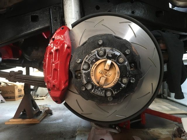

Knuckles went from shabby to sexy!
Before:
After:
Full front axle overhaul with the Terrain Tamer kit and 4Runner calipers. Also splurged on some DBA rotors.
What a nasty job but she sure looks good now. Unfortunately, I broke one of my brake lines so I gotta wait until tomorrow to get it fixed and back n the road.

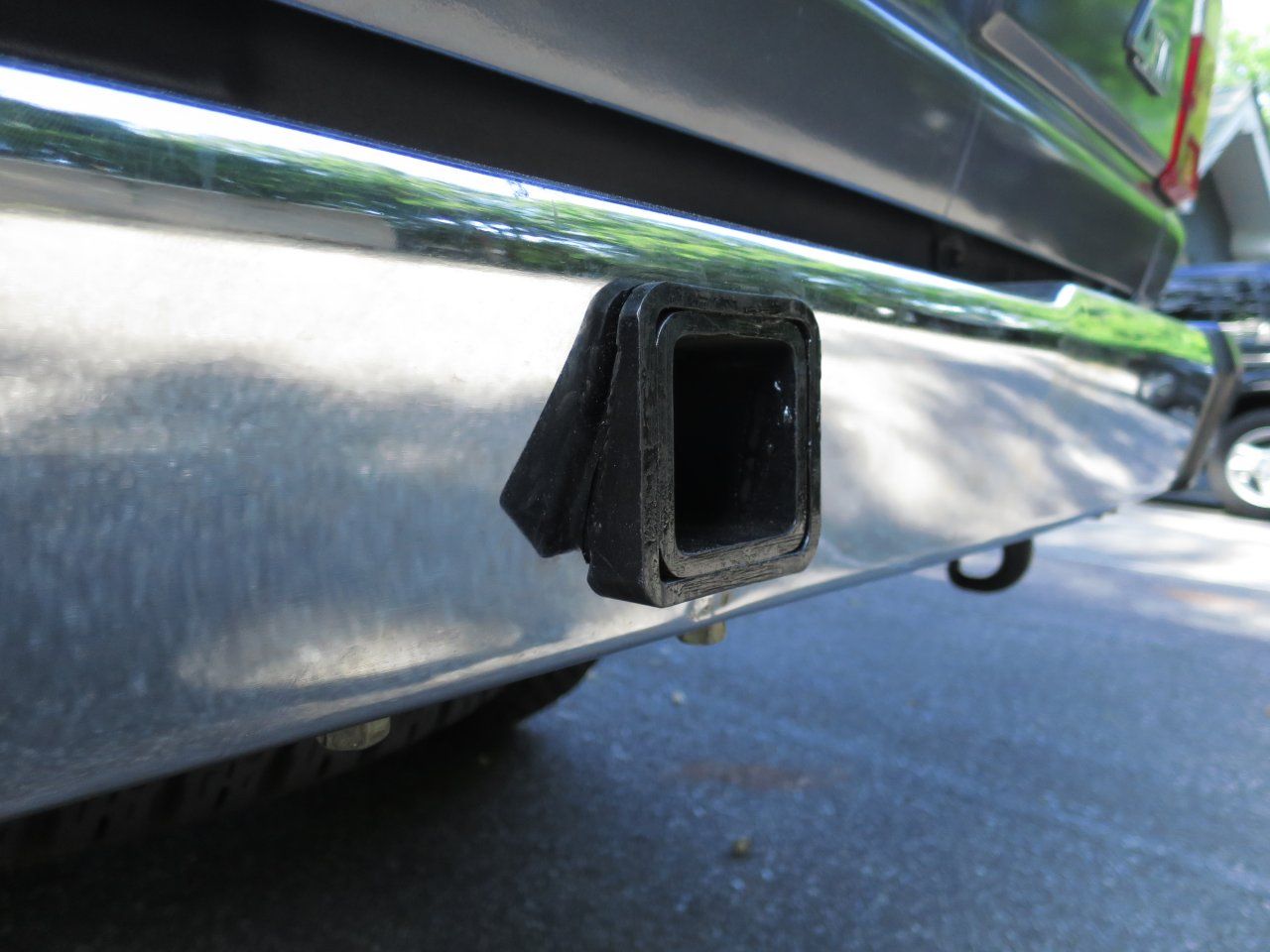

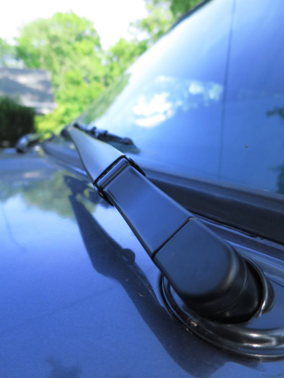

Added some side view gaskets (reevesci,) 4RUNNER wipers (beno) and had a custom receiver fabbed and installed by Trollhole. Trollhole also rid me of the Smog Spaghetti and performed some other odds and ends. So far, I'm very pleased with their work and would recommend them. Same goes for the vendors mentioned above. Pleasure to work with.

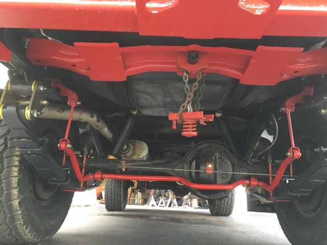

Hmmm, well not so much this weekend, but several over the past few months....Body work to replace rusty wheel wells, rattle can Plasti-dip in Ammo green, new tires, rebuilt front and rear brakes, lots o' powder coating, new springs, shocks, tie rod/relay rod and ends, u-bolt flip kit, a weak attempt to get a few more years out of my rusty frame by scraping and converting the rust, then painting it (I know futile at best), new water pump, oil pan, radiator, clutch slave.....I think that's all. Now it's time to enjoy her again after years of neglect. Oh wait, I have to re-do the oil pan since the gasket is leaking (arggghhhh).
