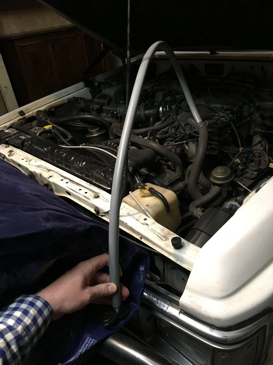

Used my '62 to blow up an air mattress. I'm in the process of moving and have 2 or 3 of the 12v and 120v pumps back in NY somewhere, so I thought I'd skimp and blow this one up with lung power. I forgot how much work that is. Then I had an idea.... Hand throttle on 2000 rpm, garden hose extension, bypass the VSV for full vacuum to the valve and she blew it up in maybe 30 seconds!! New camping hack!

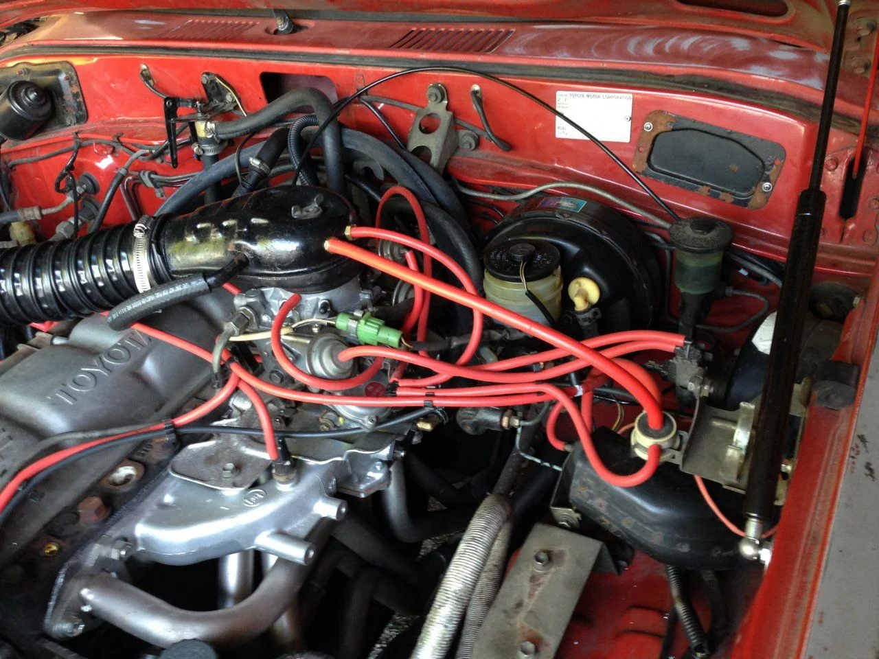

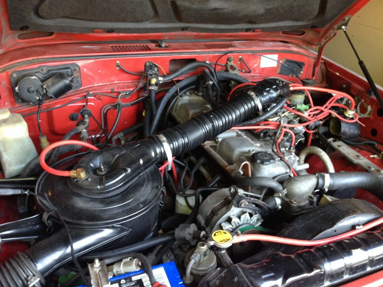

Finished the desmog 3f carb hat routing. Ended up having to add some vaccum inserts to the 3F carb hat. Cleaned the engine bay quite a by moving as much of the remaining vaccum lined stuff up near the carb fan to make room for future plans.

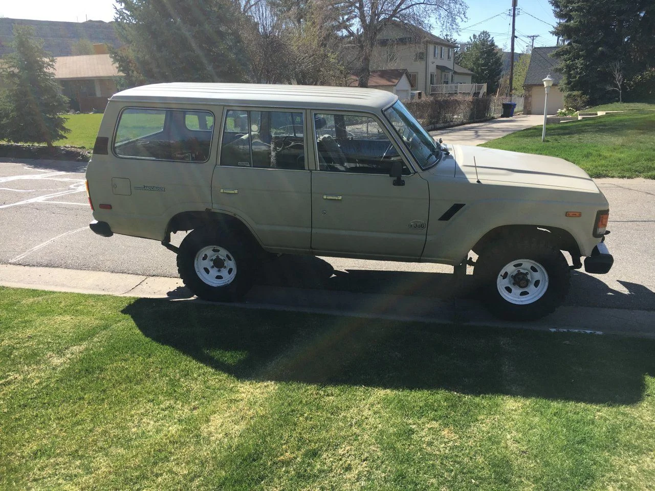

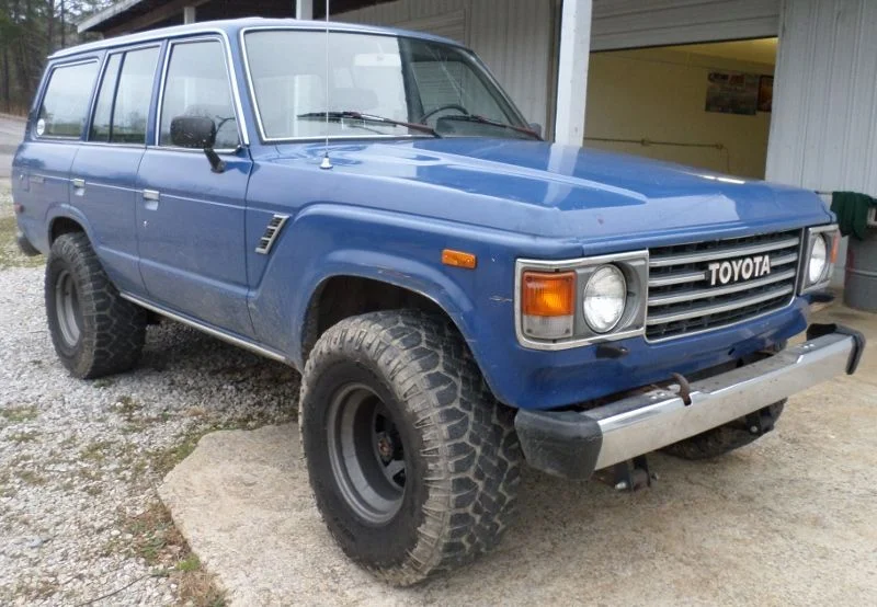

Your post reads like mine. In the beginning I didn't take pics, now I wish I had. Do you have any pics of your rig? The hard part for me is waiting for parts and work to be done by others, that I can't do myself (machine shop). Mine has been down for nearly 6 months, but I can see the light at the end of the tunnel Keep up the god work and share with us what you can:).

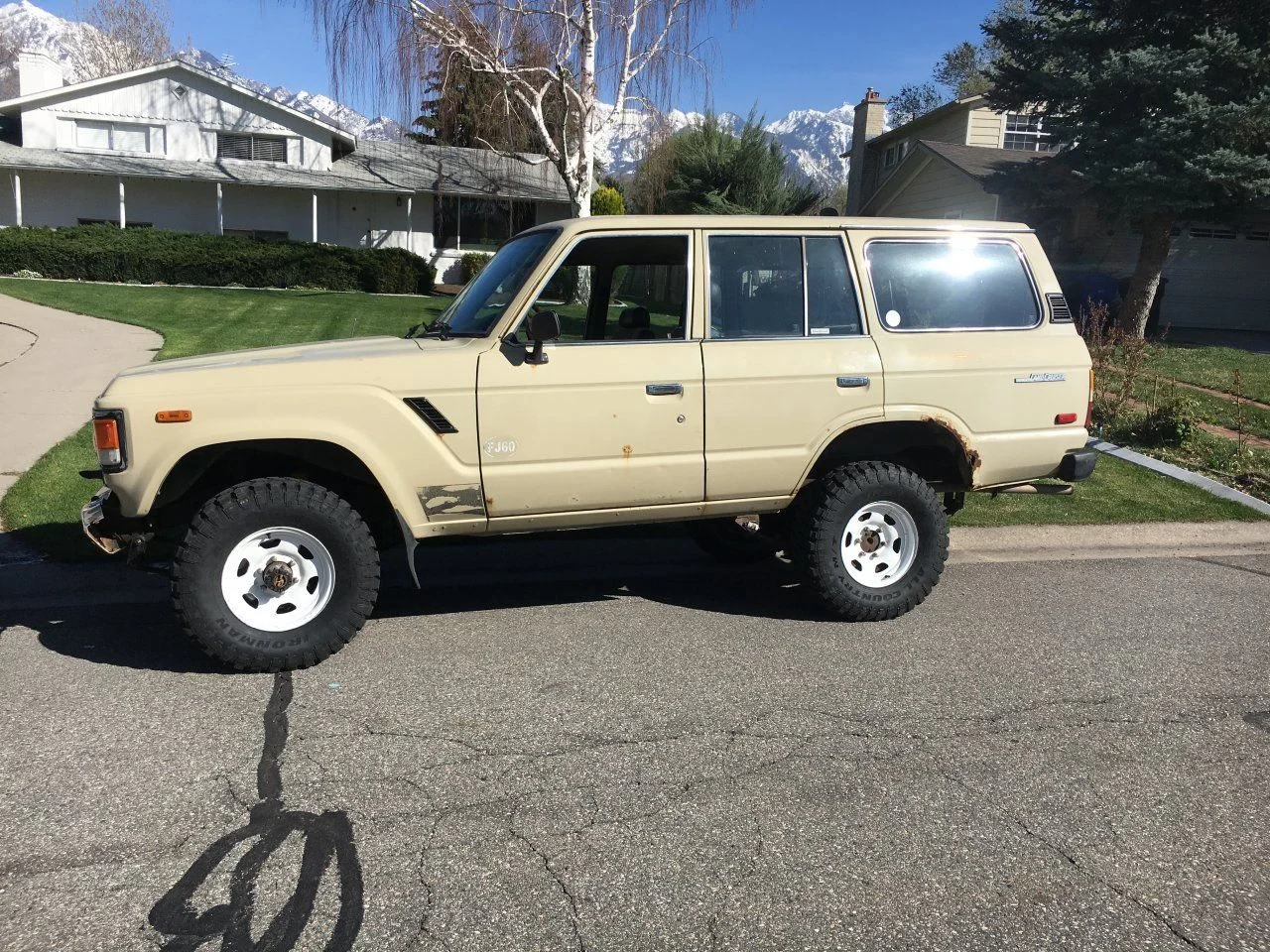

Here's a picture of the truck. I didn't take many pictures of the work I did because, even after cleaning and painting a lot of stuff, after going back in a 60 with thirty years of wear, it blends right in. Even the spotless thermostat housing looks dingy. lol I guess I should have used some polish or painted it silver, but I didn't have time. I started on it back in November and would have been done a lot sooner, but I was running a junkyard and stuck in a garage all day with the owner who is a textbook case of toxic leadership, so the last thing I wanted to do after work was be in my shop. I quit 2/19 and it took about a month to get where I didn't have to drag myself to my shop and kind of wanted to go. Unfortunately, I've got to get moved out of here at the end of the month and have a truck that I also have to finish, so now that the 60 runs and drive again, the rest of its jobs will have to be put on the back burner.

Looks good. I feel your pain. Most of the really hard work we do on theses rigs never gets seen by anyone. That's why it has to be a passion thing.Good luck with the move,hope to see updates sometime on your truck.

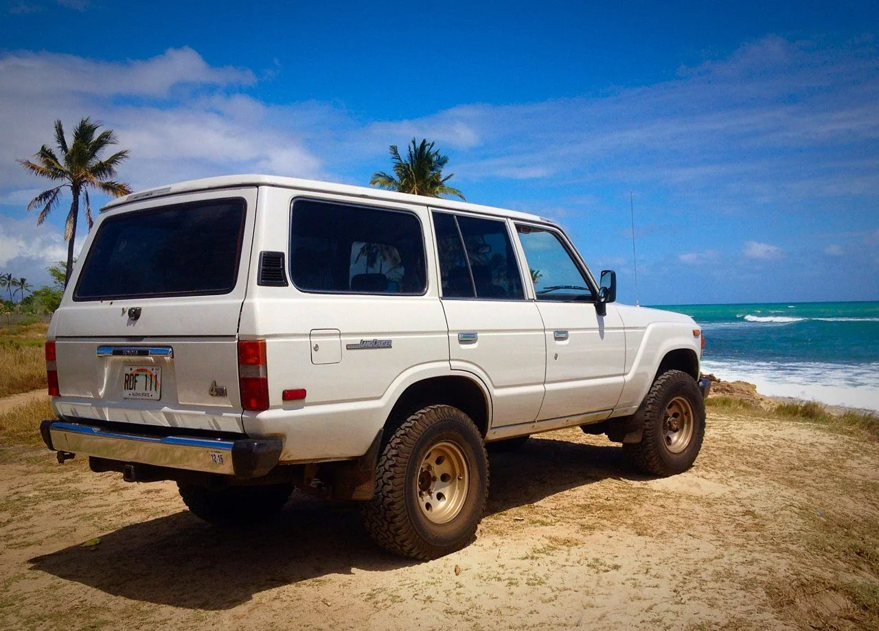

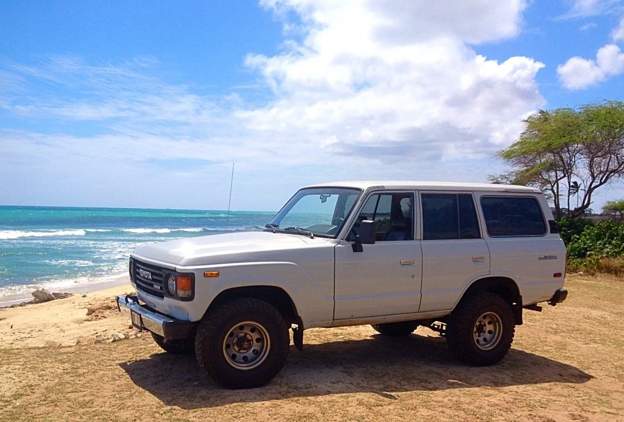

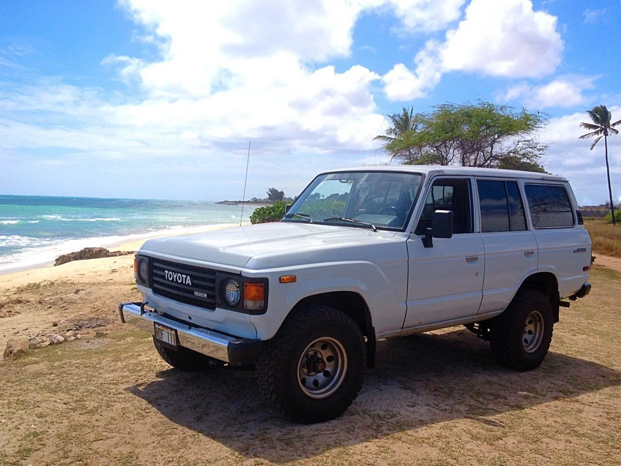

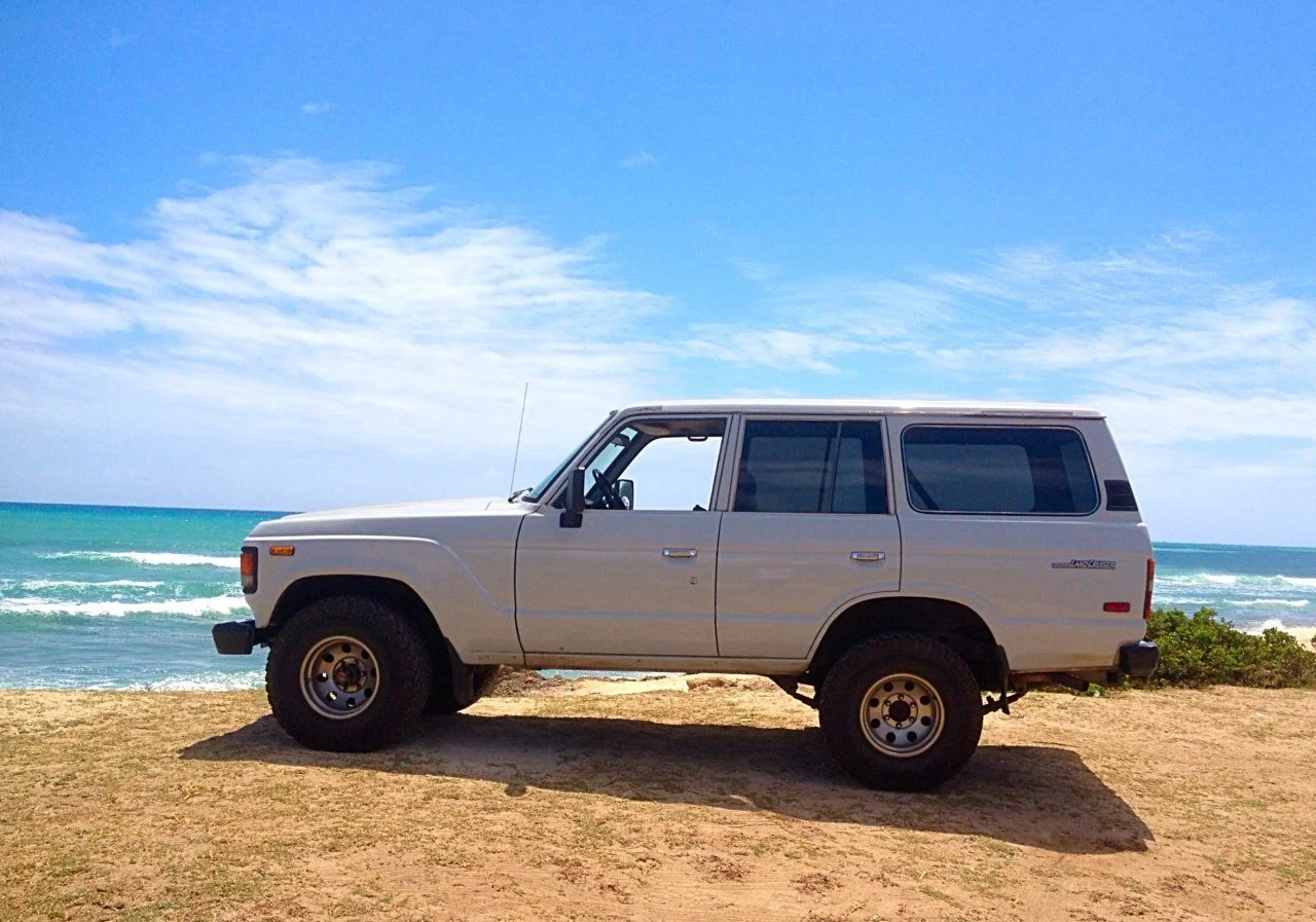

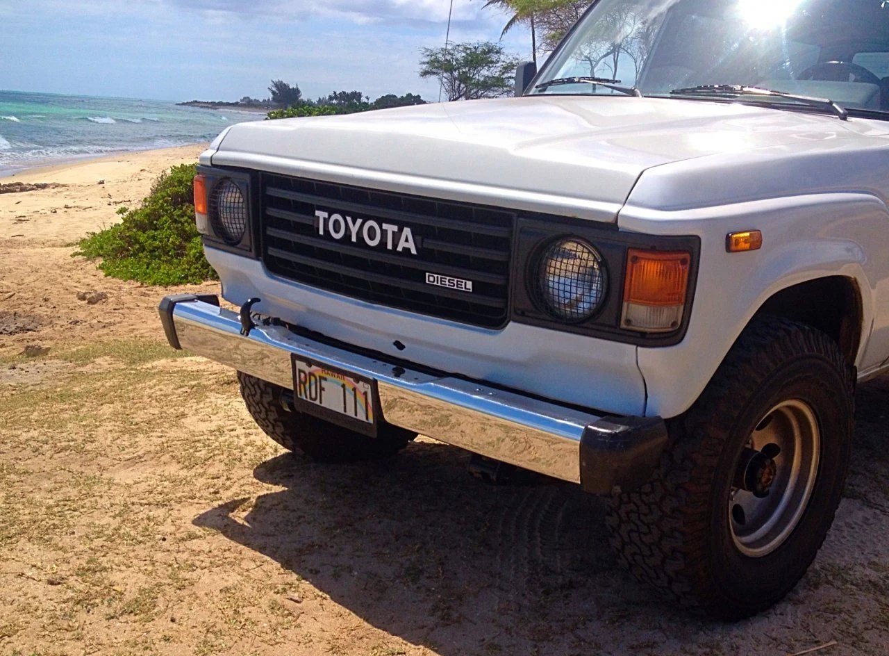

Finally got the 60 out of the garage and into some sunshine. Here are some pretty standard beach poser shots....a couple from this weekends adventures.
I love how clean the sides of the diesels are without the fender vents. Once I get my 5.3 swap done and start doing body work, I'm probably going to eliminate the side vents.
