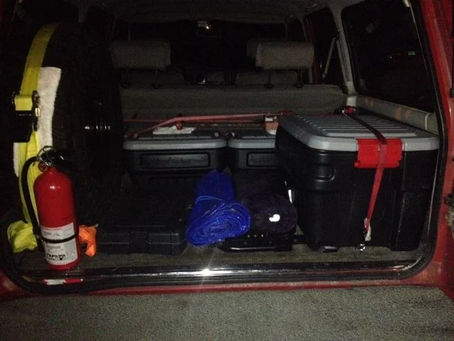

Searching around for a way to mount my spare inside and found a design in the 80 series that I thought might work.
The main challenge is finding a few places in the floor for bolts to be installed.
Going to drive around with it for a few days and then it will get painted up. Also going with a bigger strap so this tire doesn't become a flying object.
I think this is going to work well with my storage ideas. It feels nice and solid I'm glad to have the tire out of the way.
Will post up a parts list when complete if anyone is interested.

Dude, that's pretty goofy looking. Just put a D-ring in your wheel well and and another just rear-ward of the factory tie-down behind where you have your spare. And get a wider strap. I also put a rag under the ratchet part so it doesn't cut into the rubber.
My set-up holds my 35" spare (~100lbs) with zero movement, even after multiple jumps.

Yep, I could have done that but I didn't. I was a passenger in a rollover accident and it's amazing what goes flying. Not saying my idea is any better than yours but I do have four 1/2 inch bolts attaching it to the floor so hopefully that will help keep it in place.
With my son sitting right in front of this tire I went overkill so that it would pass my wife's inspection. If you aren't married yet you will one day understand, lol.

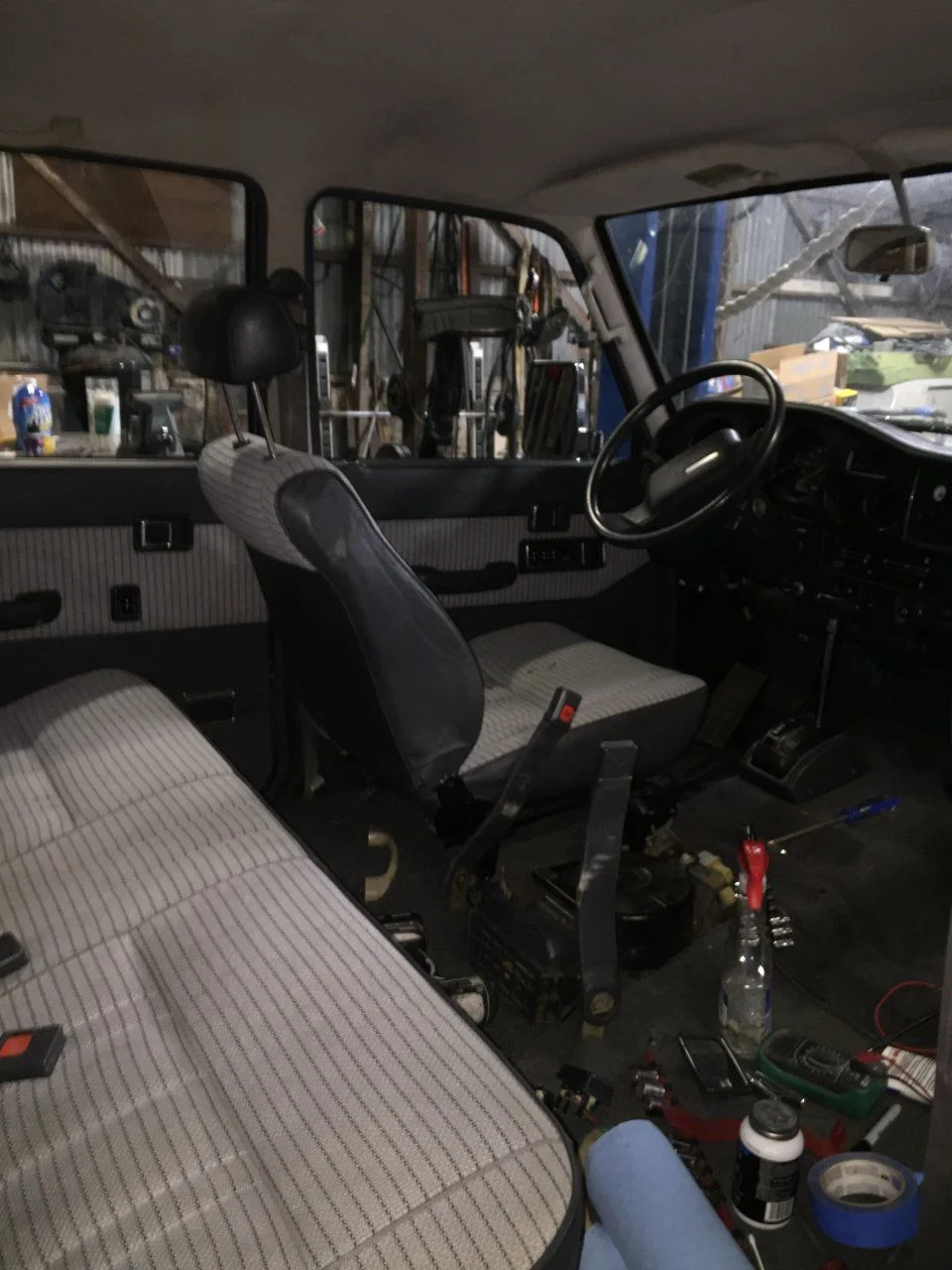

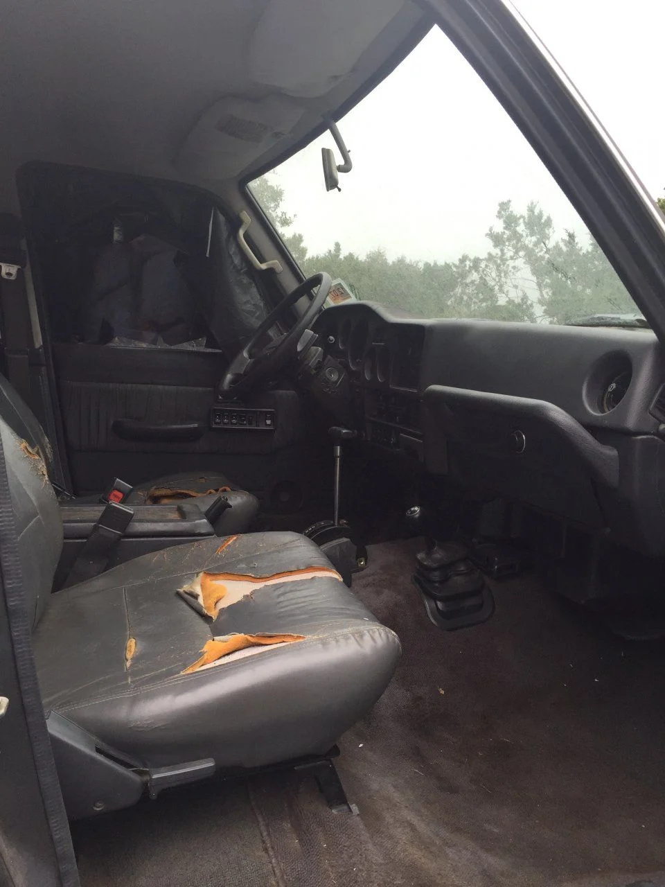

Taking a mild break on my 60 build to baseline this 62 and update the interior. Bought it a month or so ago as I could not pass it up (just down the street from me). The intent is my brother will take it over, but I'll most likely put it on the market if he does not have the cash when the time comes. It's a clean rust free 174K rig. Came with port installed leather that I'm converting back to stock. A new (used) tank and fuel pump and it fires right up with no check engine light. Even the AC blows cold after 10 years of sitting. I have to still figure out a Trans kickdown cable issue and do some base lining on fluids etc... Attached are pics of before and some as I transition to the stock interior.

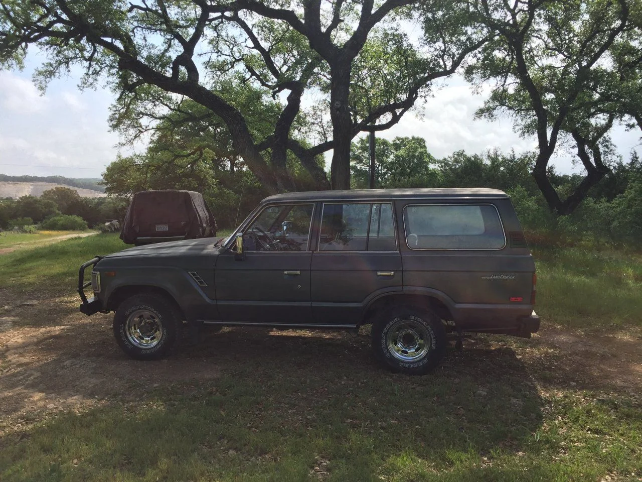

Sharp truck. I really like the old wheels.
Thanks! I love the look of the hubcaps. The 40 steelies and the hubcaps were also quite a bargain. I do feel limited to 10 inch wide tires, but I will cross that road when I get there. The BFGs should last a while.

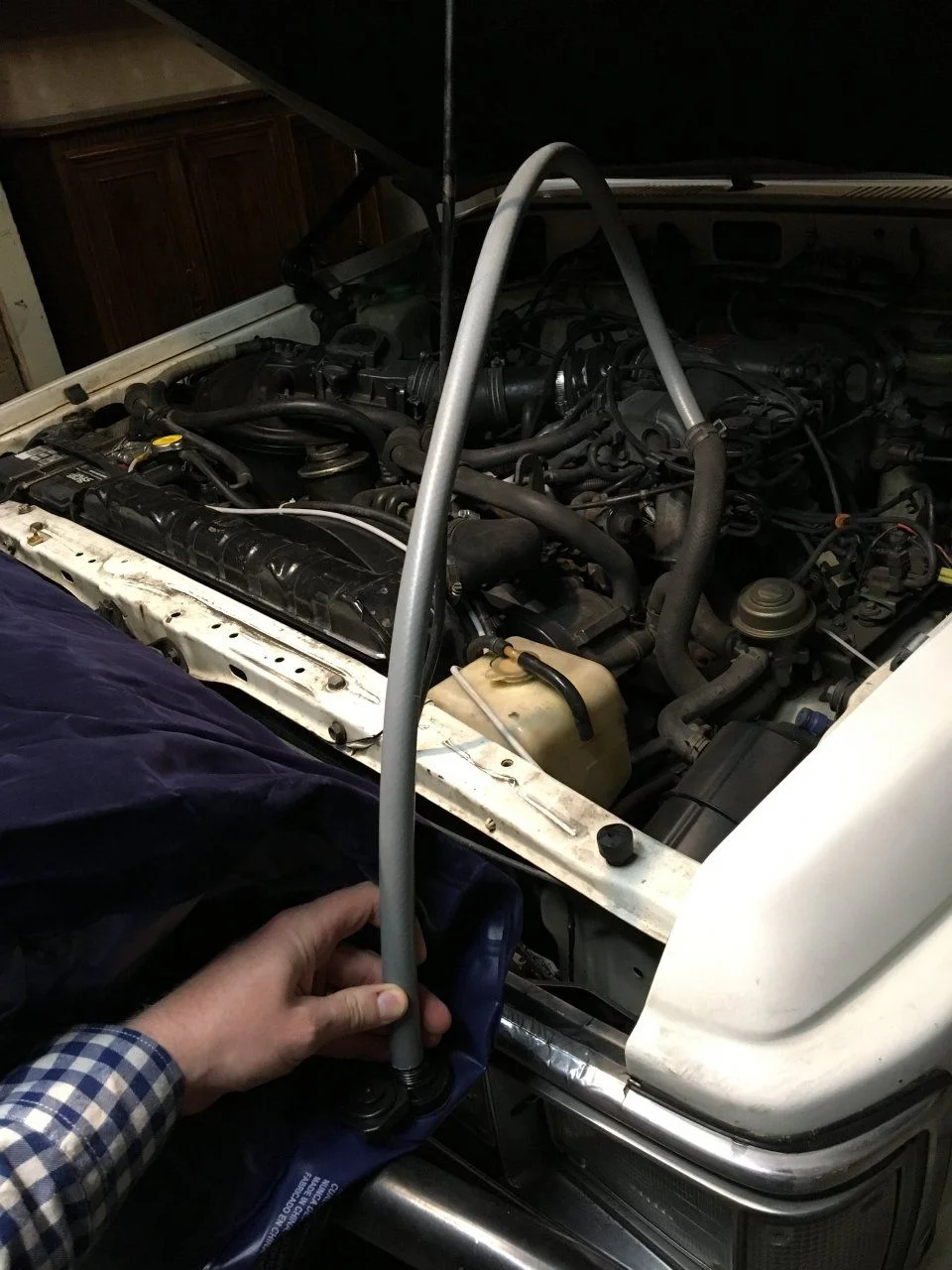

Used my '62 to blow up an air mattress. I'm in the process of moving and have 2 or 3 of the 12v and 120v pumps back in NY somewhere, so I thought I'd skimp and blow this one up with lung power. I forgot how much work that is. Then I had an idea.... Hand throttle on 2000 rpm, garden hose extension, bypass the VSV for full vacuum to the valve and she blew it up in maybe 30 seconds!! New camping hack!
That's awesome! So when you blow a tire, you might actually blow a tire!
