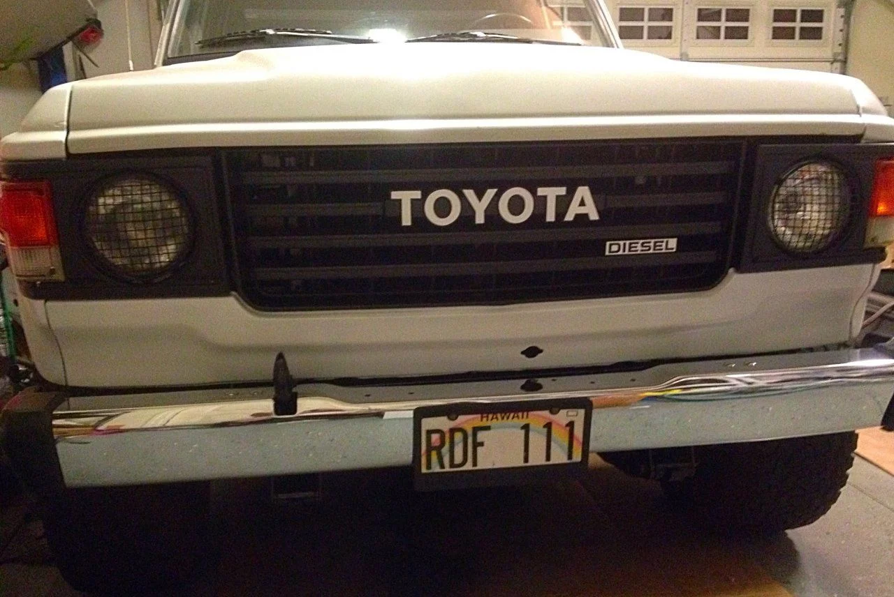

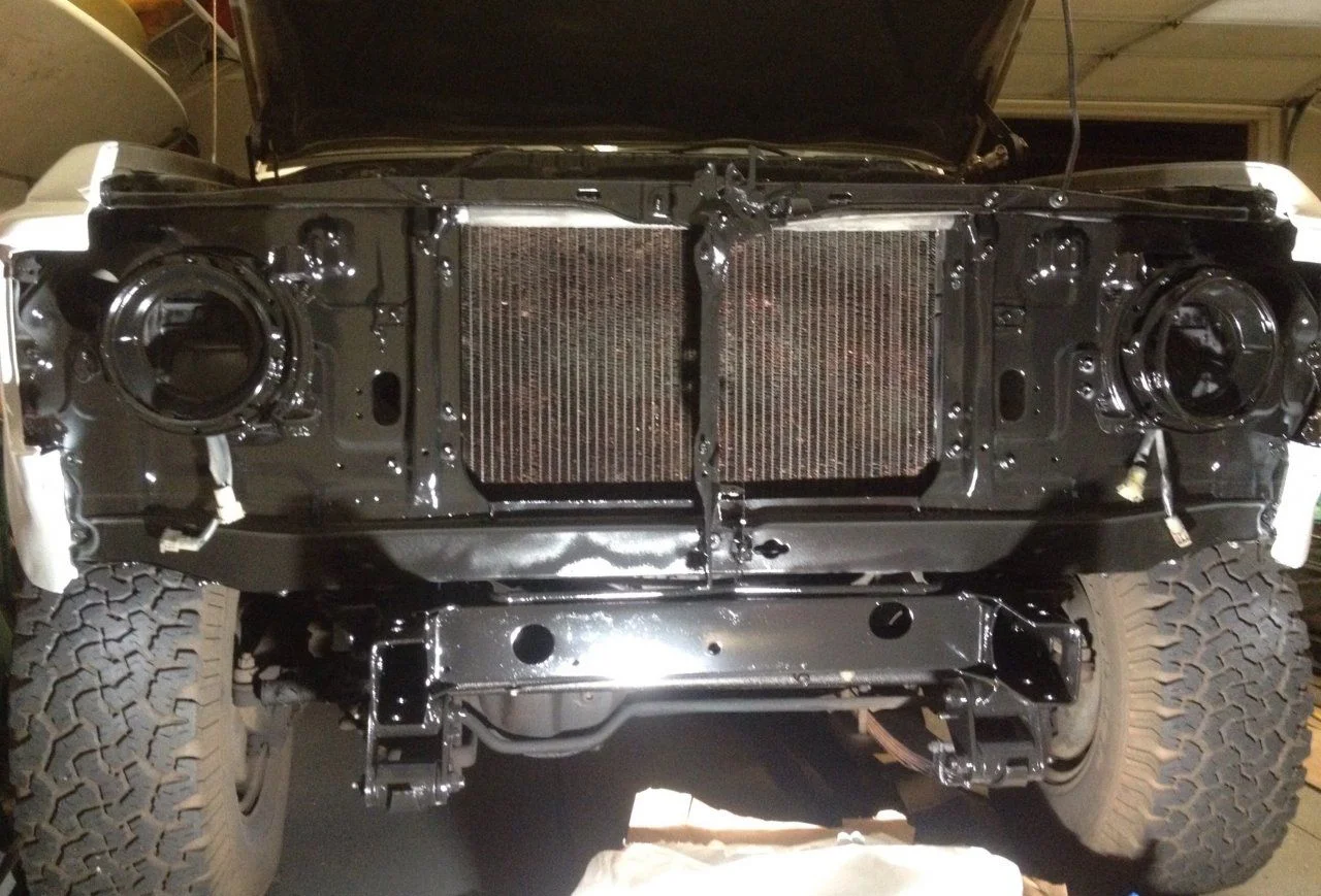

Finished up with a little front end face lift. All plastic trim pieces got a fresh coat of paint and all the metal behind it had any rust removed. What little there was back there was grinder/sanded to bare metal, etched, primed and painted. Now that it's all back together, I can hopefully get some better pics then these low light garage shots. Hope everyone has a great weekend!
@Aloha Jen Very nice job on that grill. Engine bay pics would be nice too.

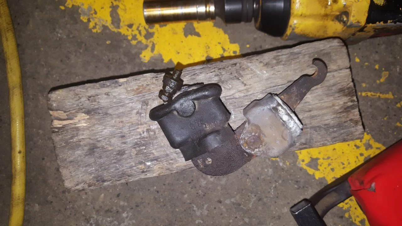

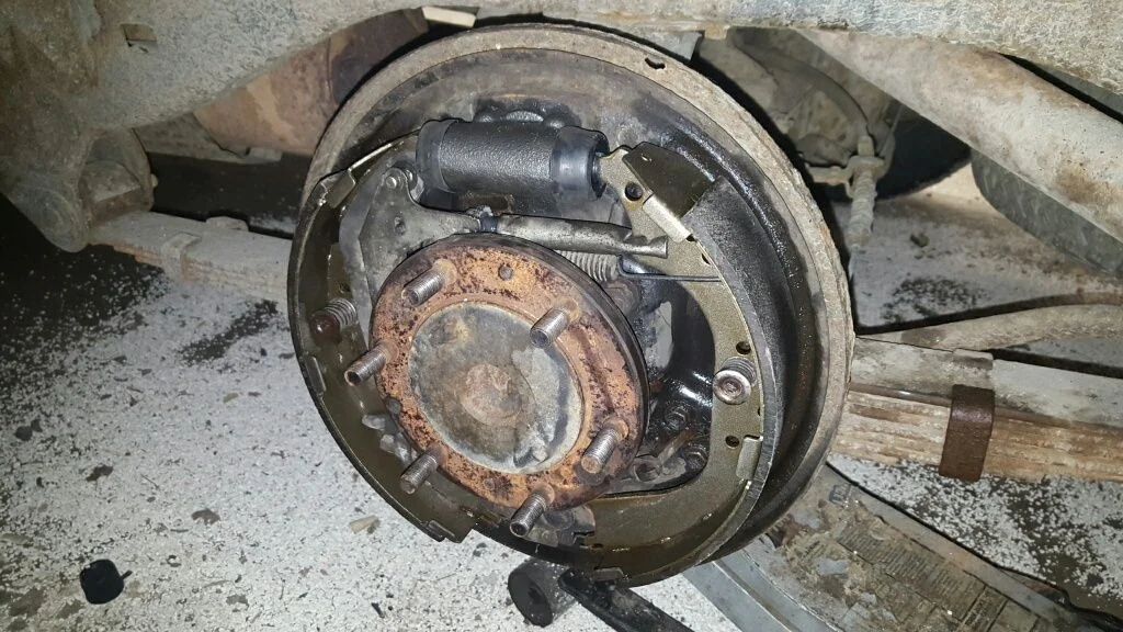

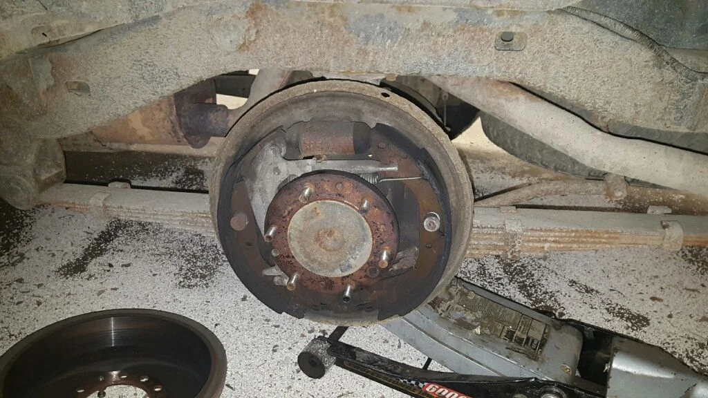

Well, the old girl hasn't been stopping lately without throwing her into neutral so it was time to check on the brakes. Fronts were worn to about 2 mil but were super easy. Rear however..
Had a bad wheel cylinder on the drivers side and a seized parking brake system. Dissimilar metal corrosion was bad. Took a while to work it loose but amazingly i didnt break anything.
Passenger side was the same with the added issue of shoe retainers missing. Doh!
Alls well though and it actually stops now.

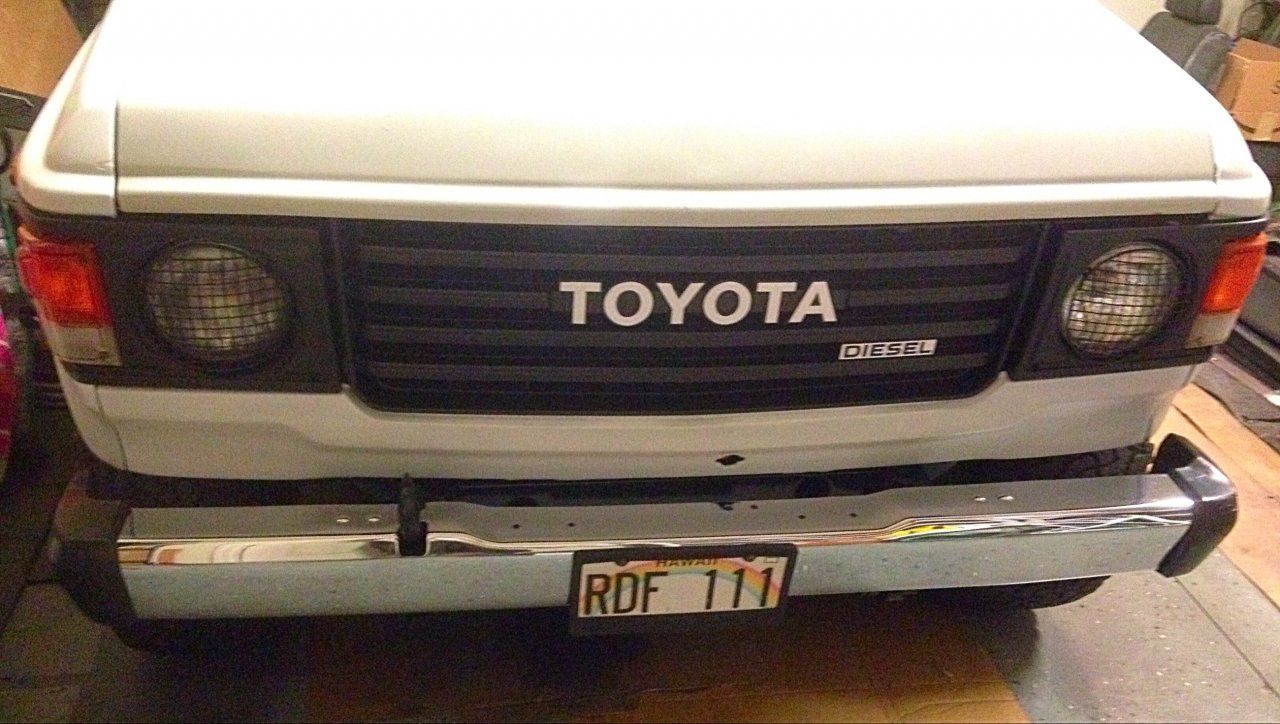

Nice work! that front end looks good. amazing what a little paint can do .
