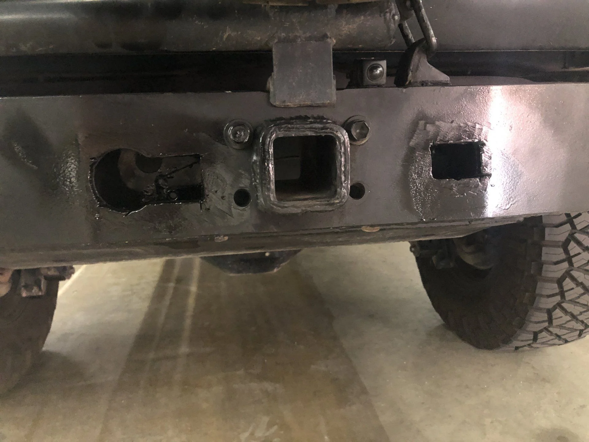

Finally completed my rear bumper

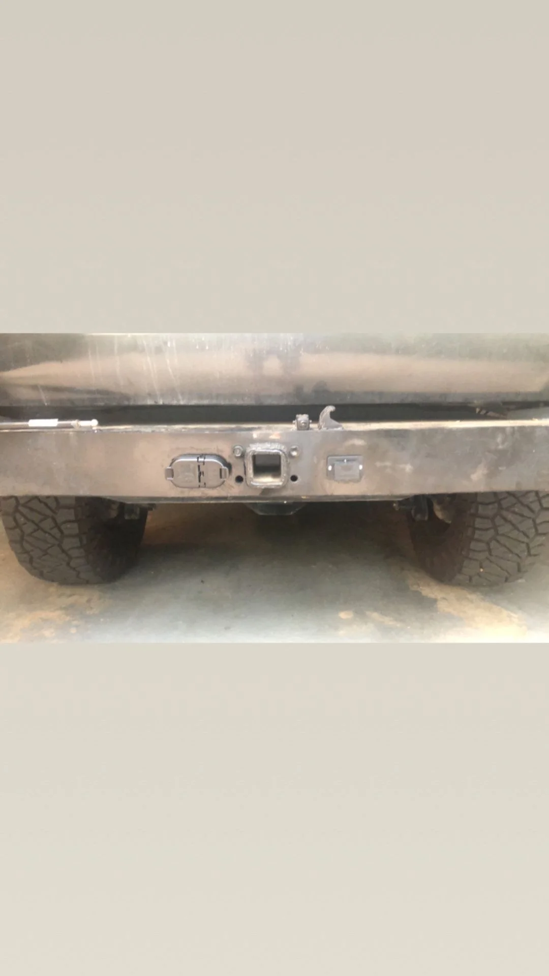

Wired up a 7 and 4 pin and a 50A Anderson connector power point to fuel the trailer. Flush mount so I don't pinch the wires off off road.

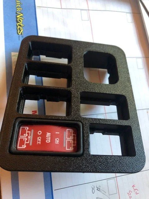

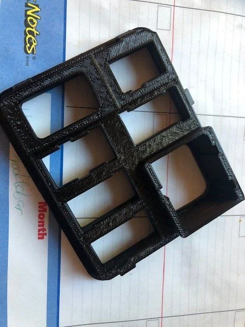

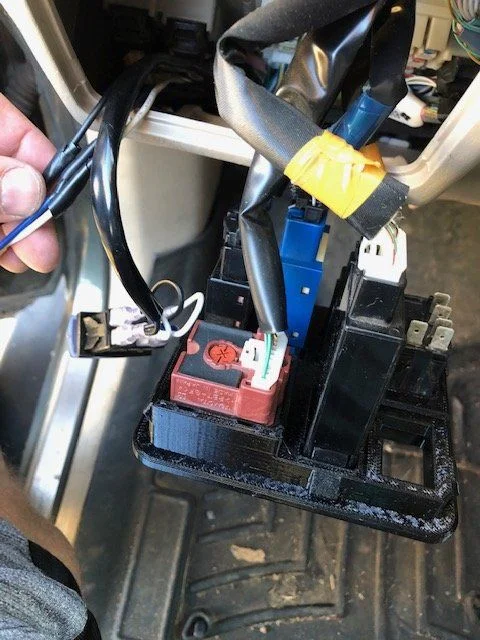

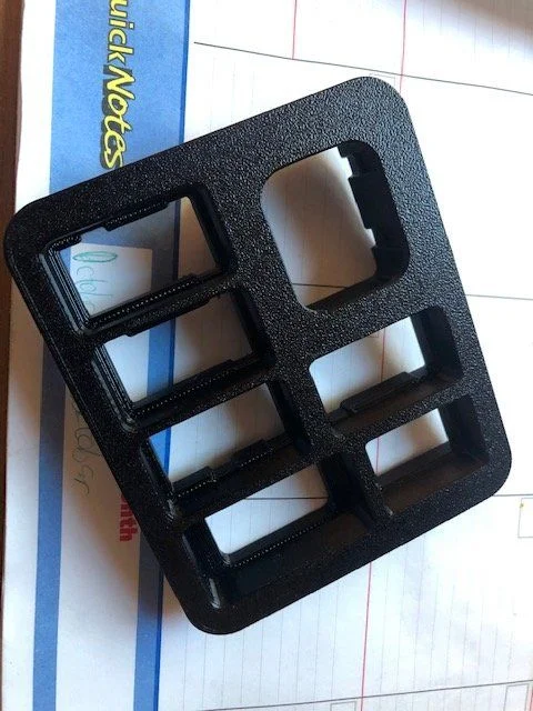

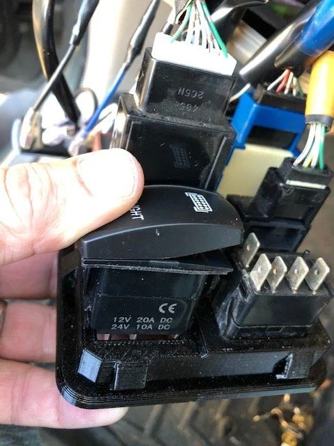

Got it installed today. Overall very impressed... it's an FDM part has really good layer adhesion, and the top surface has a nice texture to it. Almost looks like it's been vapor honed.. I had to sand down my dual battery switch a little as that opening appears to have built a little on the small side.

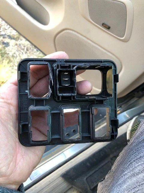

All of the other stock switches fit. I was able to get back the rheostat as I'd abandoned that one inside the dash to use that spot for a light bar. And now the bezel holes are too small for the light bar switches I have, so I need to figure out something else here- not running a light bar at the moment so nbd. And on the old bezel I mangled that opening larger to cram that light bar switch in there... I also lost another small toggle switch too in the transition which I'd snuck in next to the mirror control on the old bezel... but those are just bumper lights so again not a huge deal.. just two things I need to figure out.
Anyone know what switch fits the smaller hole on the top of the bezel?

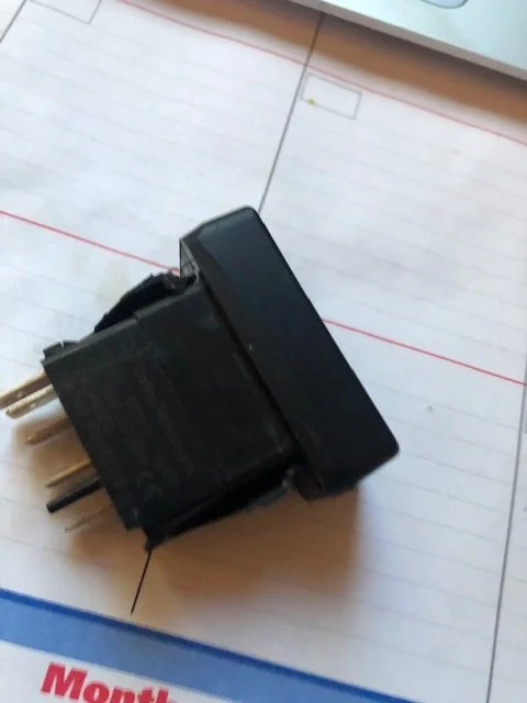

light bar swith doesn't fit
My old bumper light switch

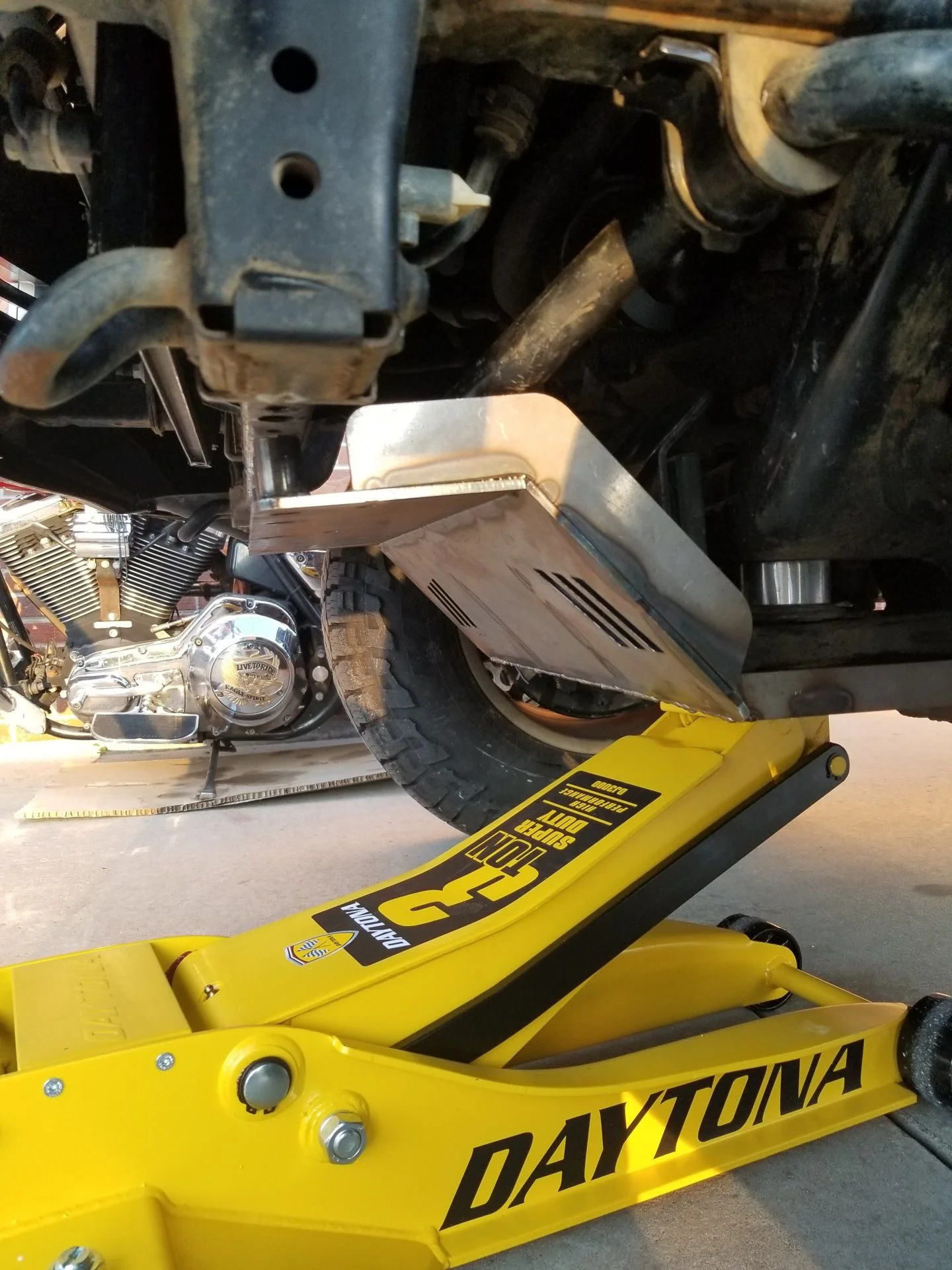

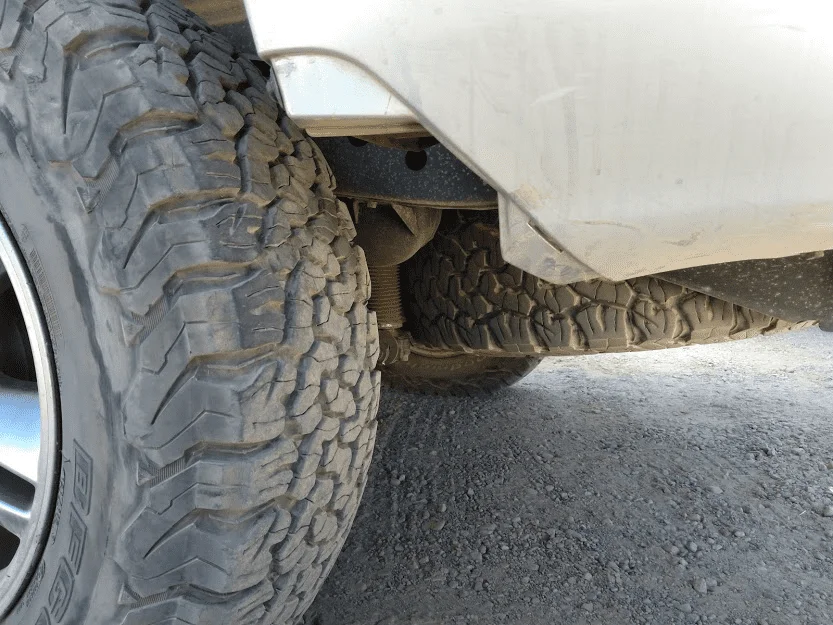

Realized Coastal offroad skid plates will not work with front sway bar. Just a heads up for anyone who was thinking about these.
I may be able to cut off wheel a portion out of the side ribs to fit. Anyone else have this issue? Like the feeling of having my front sway bar on but also haven't driven with no front and only rear. Only tried no front and no rear and that was scary sometimes.

New bezel installed
That smaller hole above the battery switch is for a battery voltage gauge to go into so you know what the voltage on your 2nd battery is.
