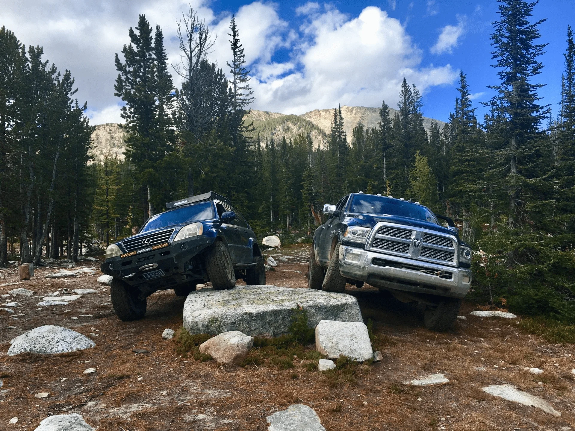

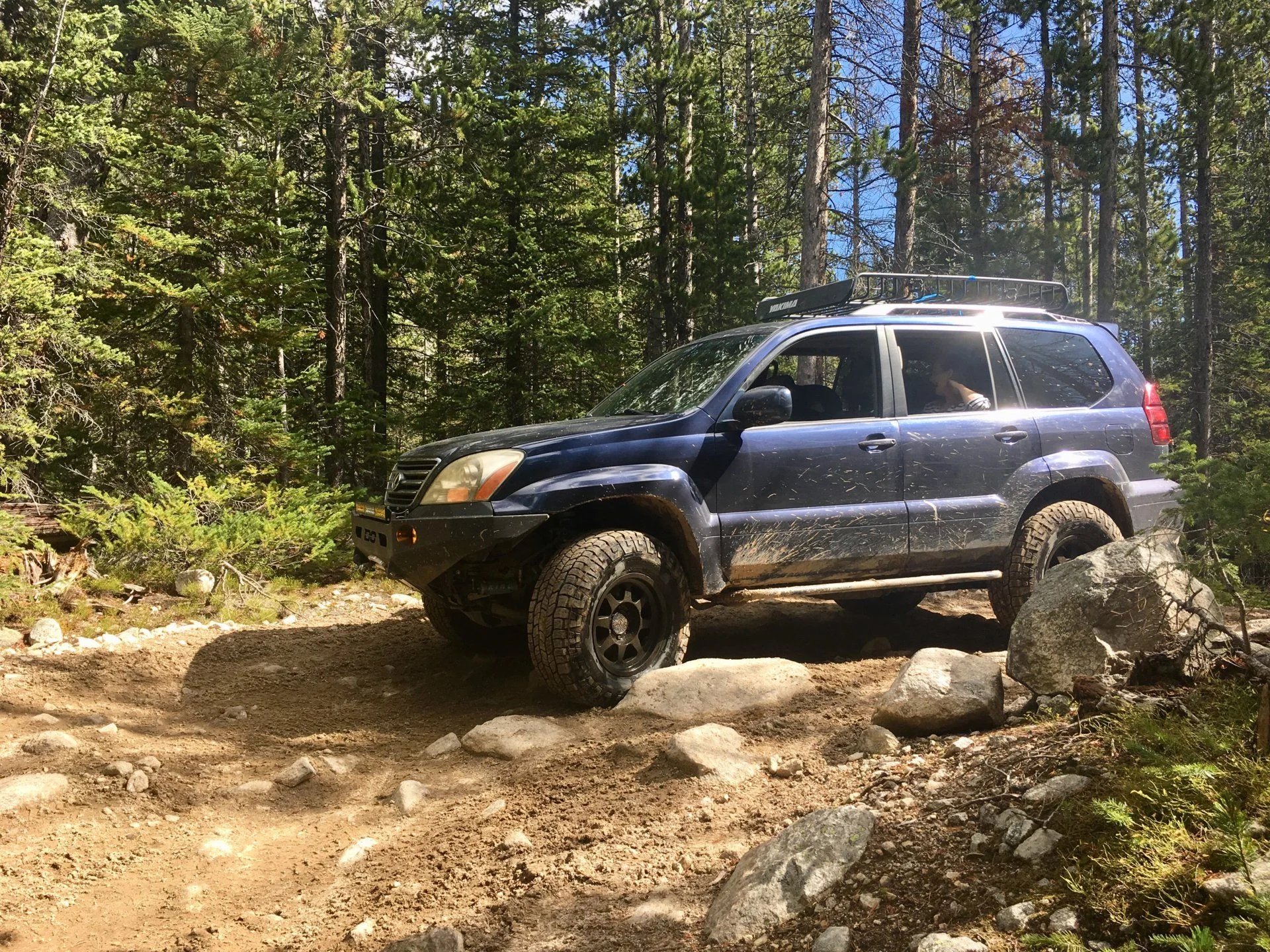

Went up to Caruthers lake in Montana. Tested out sliders and stock skids.

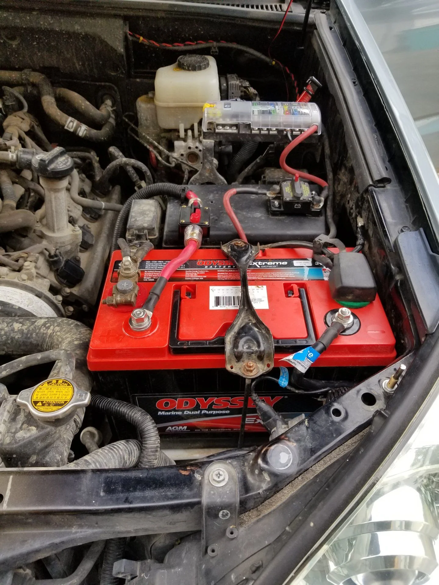

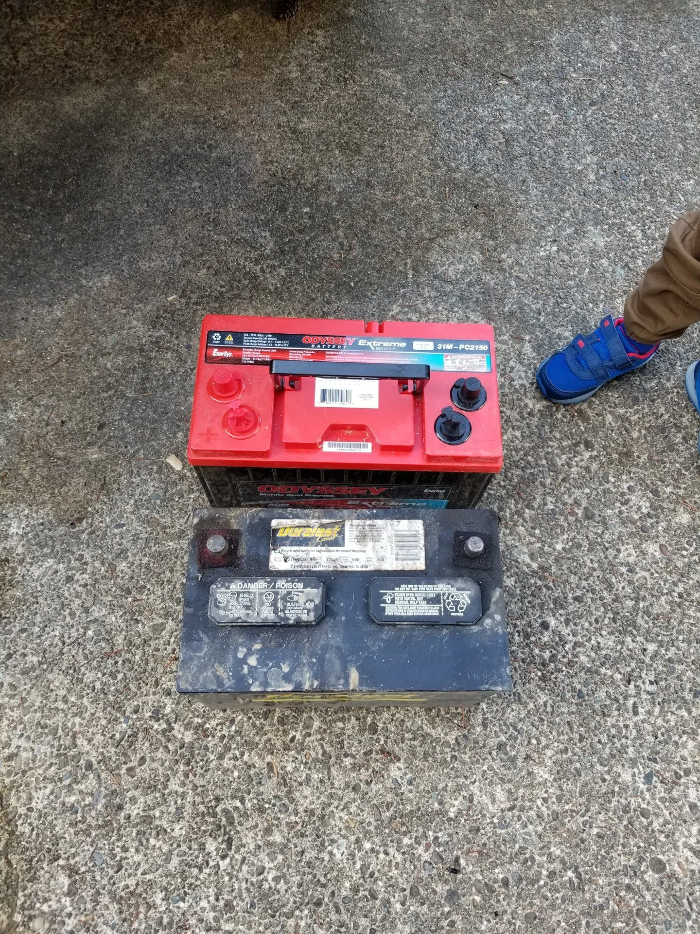

is this the biggest battery that will fit in the stock location without modification? i noticed people using Odyssey 34R-PC1500t
I'm not sure if something bigger is available. I know there's not much more room between the radiator hose and the fender for anything bigger - maybe 1/4".
Height wise you could go about 3/4" taller if you had an aftermarket battery tie down.
Width, there's about an inch of space available.
For me, a group 31 is as big as I would try to go. If i wanted something larger, I'd start looking into a dual battery setup.
I plan to eventually go to a dual setup using the 31 as a house battery and something smaller/lighter as my secondary.
I'll go that route after deleting my secondary air pump system.

thanks for the info. Did you have to modify the battery tray or the stock cables, or anything for it to fit? I am nearing the life of my battery.
There's a 90* bend in the positive cable: I had to bend that straight.
I also had to drill a hole in the fender to relocate the ground cable that bolts to the fender with a 10mm bolt.
I could have solved both problems by extending the cables. The reason I went the way I did is because I'm in the process of building custom battery cables.
When I had my jeep I fabbed battery cables out of welding wire. I'm doing the same for the GX. I'm using 0 and 5 gauge cable and military style bolt connectors. I'll heat shrink and crimp all connevtions. They'll be a bit more efficient but mostly more flexible snd durable than the factory cables.
You can 100% safely run the batttery the way I have it now though.

Must be nice to be inclined on the matter as you. Since i have time, i am considering getting the extension for the cables. if you were to get the extensions, which one would you consider picking up?
