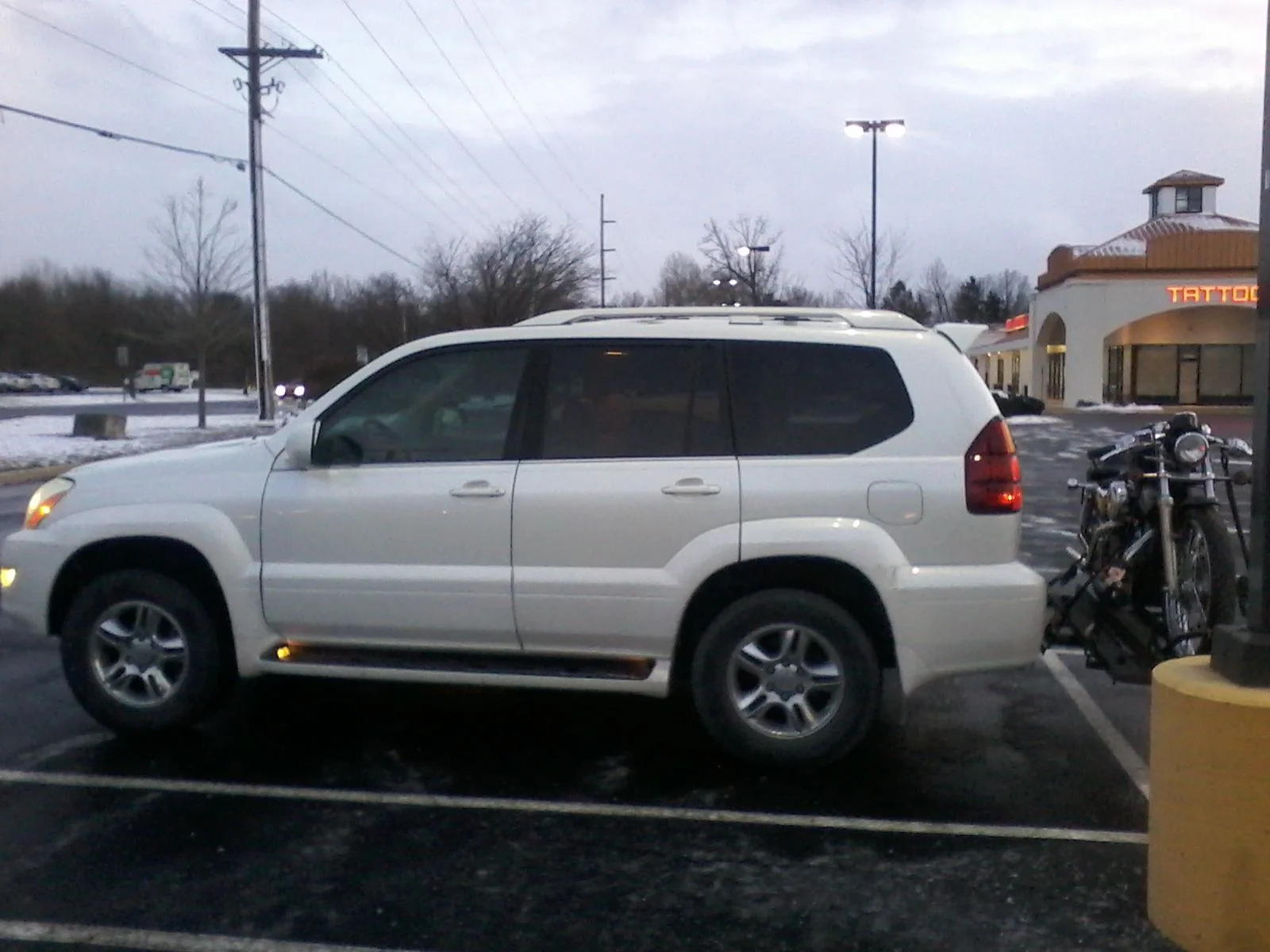

Times like these you'll actually be happy to have the auto-leveling air bags:

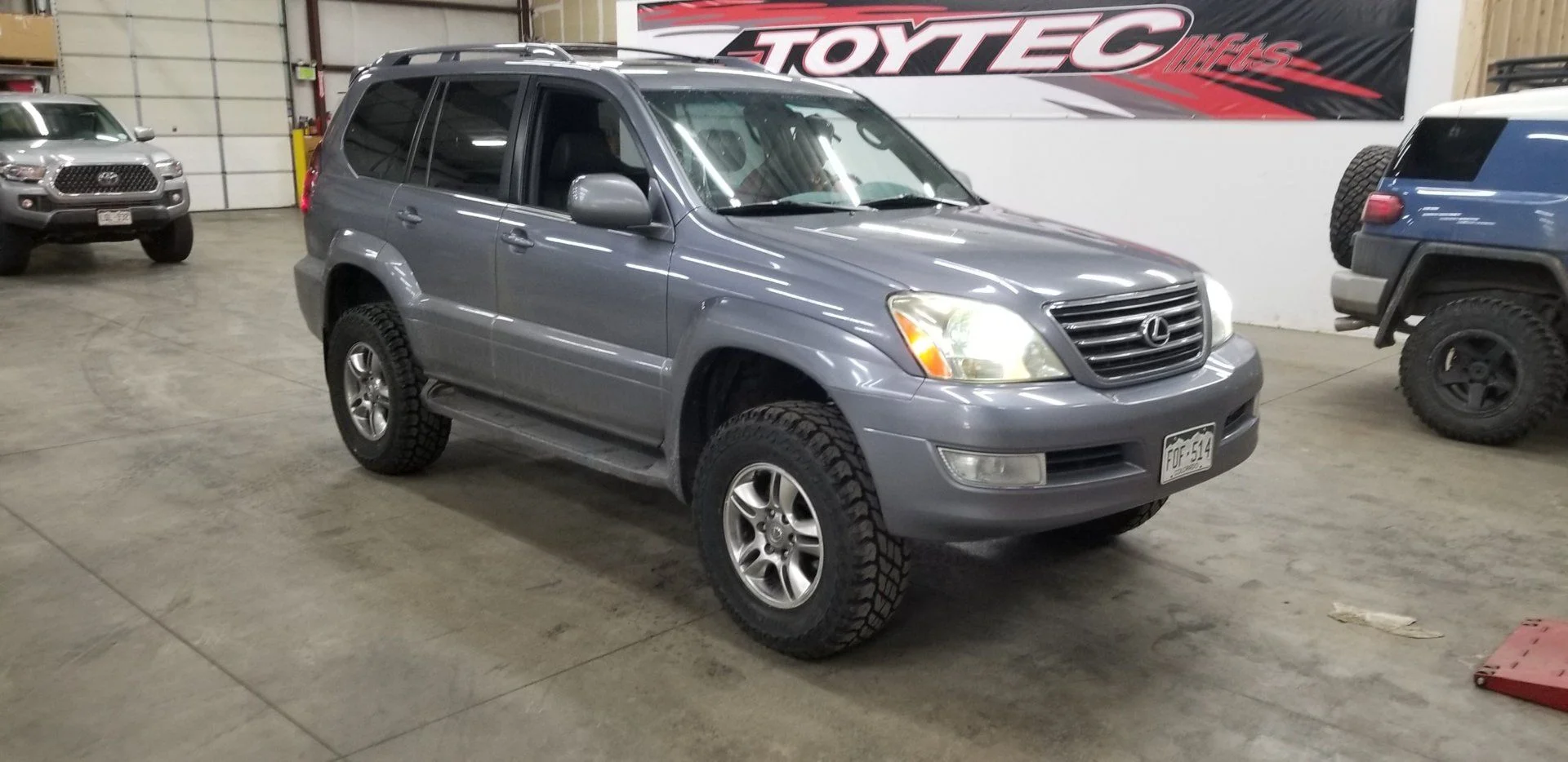

I haven’t picked it up yet, but this just happened. I asked the guy at Toytec to send me a pic when he was done. I used their tire recommendation (275/70/17) and got a call that the tires were rubbing against the UCA so they put 1.25 spidertrax spacers on em. Not my original plan but it should be fine reading other posts on here.....

Looks great. I'm itching for bigger tires. Anyone know how spacers affect handling? And hubscentric spacers are safe....?!?! I've read mixed things, assuming the dangerous ones are purley a spacer and don't have the hub centric groove?
I ran spacers on my Taco for almost 10yrs with no issues. I have .75 BORA spacers on my GX now. They are hub-centric as well. If you can find the right wheel with the proper BS you don't need spacers. But most cannot find what they want in wheels alone. Spacers properly maintained, are no issue at all.
Thanks. Do spacers make a vehicle more stable, or more squirrelly at freeway speeds?
IMO with the .75 inch up front on mine and 315/70 tires it makes it more stable. My current stance is just outside the average highway wear grooves and it tracks great. But alignment also has a lot to do with how well your vehicle tracks and stability comes more from your swaybar then anything.

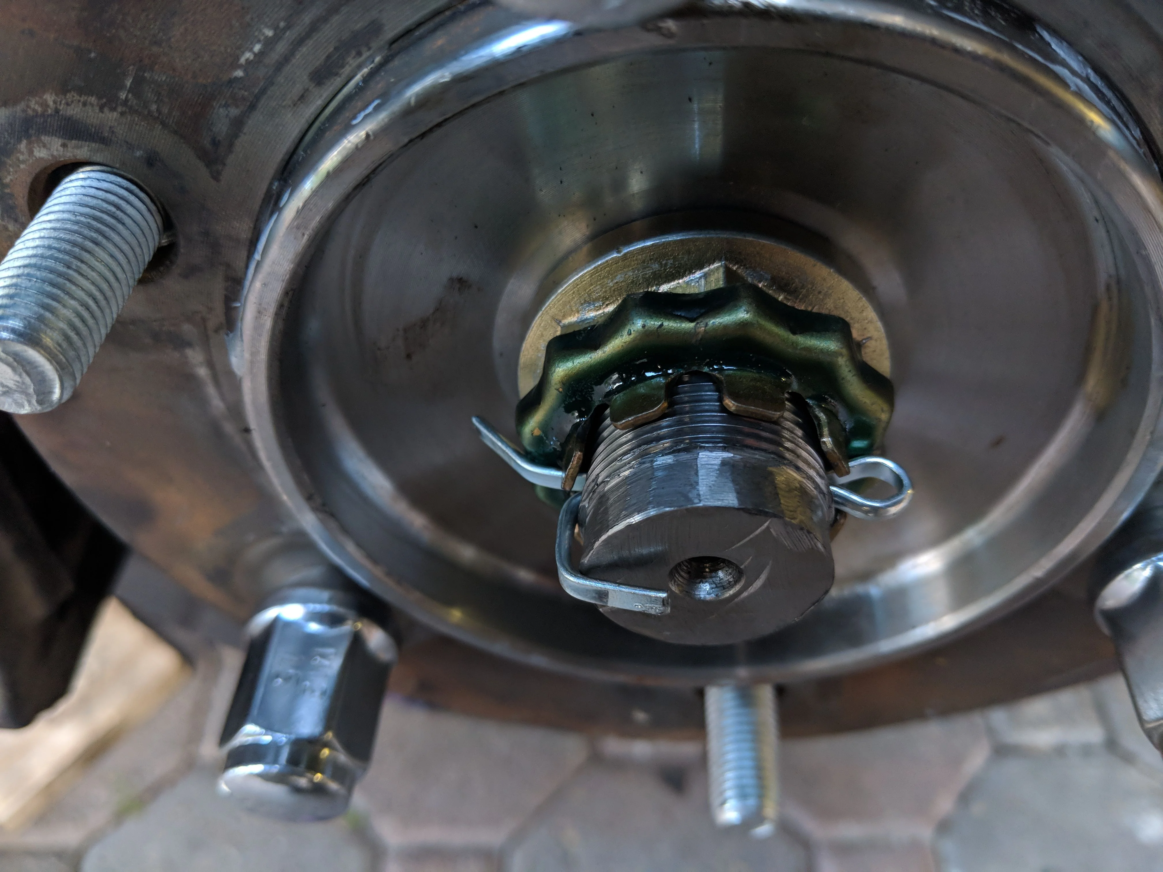

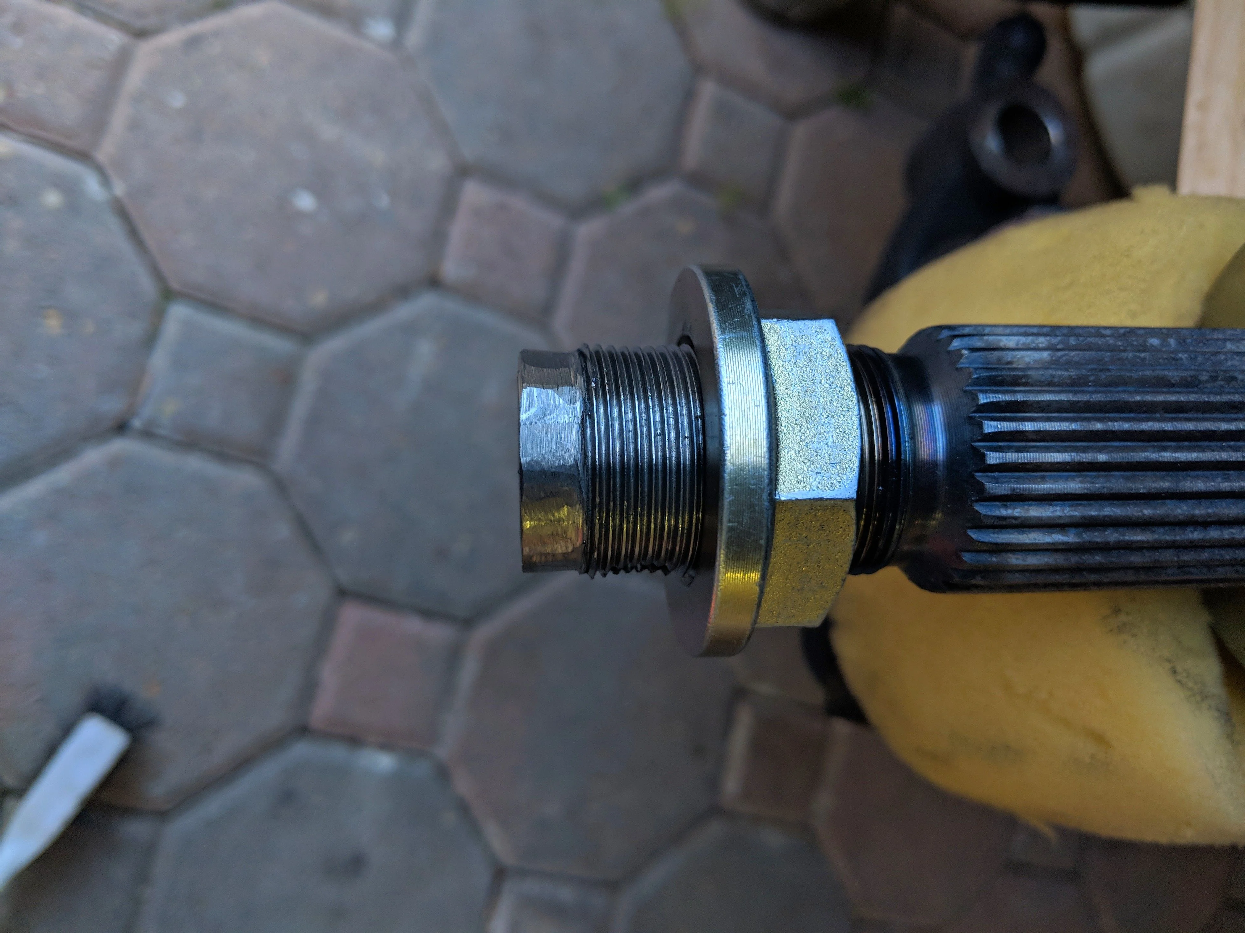

Most of the posts in this thread are about positive experiences (thankfully), so I figured I'd mix it up and share a mistake:
Got a little too hammer happy driving a CV home today and bunged up the first few threads, even though I used the backwards axle nut trick (clearly not doing it right).
The threads "appeared" fine but the nut would NOT come off (plastic deformation somewhere), so out came the angle grinder and goodbye deformed threads! I figured it was ok since they were past the cotter pin hole, and the nut went back on nicely after reassembly:
So,
  1. anyone want to share some more detail on pounding in CVs? This is only my third one but the first two were fine.
  2. can you think of any reason why this desperate "mod" will cause me problems?
I normally don’t have to pound them in. Usually just line-up the slot, retaining clip, slide it in until it’s seated and then “pop” it in. I grab the outer spline with both hands and quickly shove it straight in if that makes sense....
Can’t see where it’s going to cause a problem. You have good thread purchase and have the cotter pin in place. I believe the torque spec is around 173 lbs for that.
