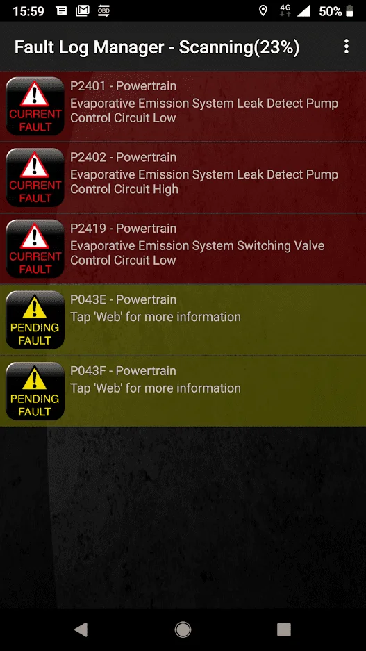

was reminded it's past time to get a Lexus gas cap, the NAPA is not adequate.
1904928
What is that program? On your phonem connects to OBD port?
@runningdrew
Torque on the Play store, it'll talk to any bluetooth OBDII reader (hell even the $10 ones are fine).
I've currently got the veepeak (which is nice b/c it's got contours to unplug it...) but used this one previously (until I tried to crack it open and pin out a toggle switch to the constant power pin lol)

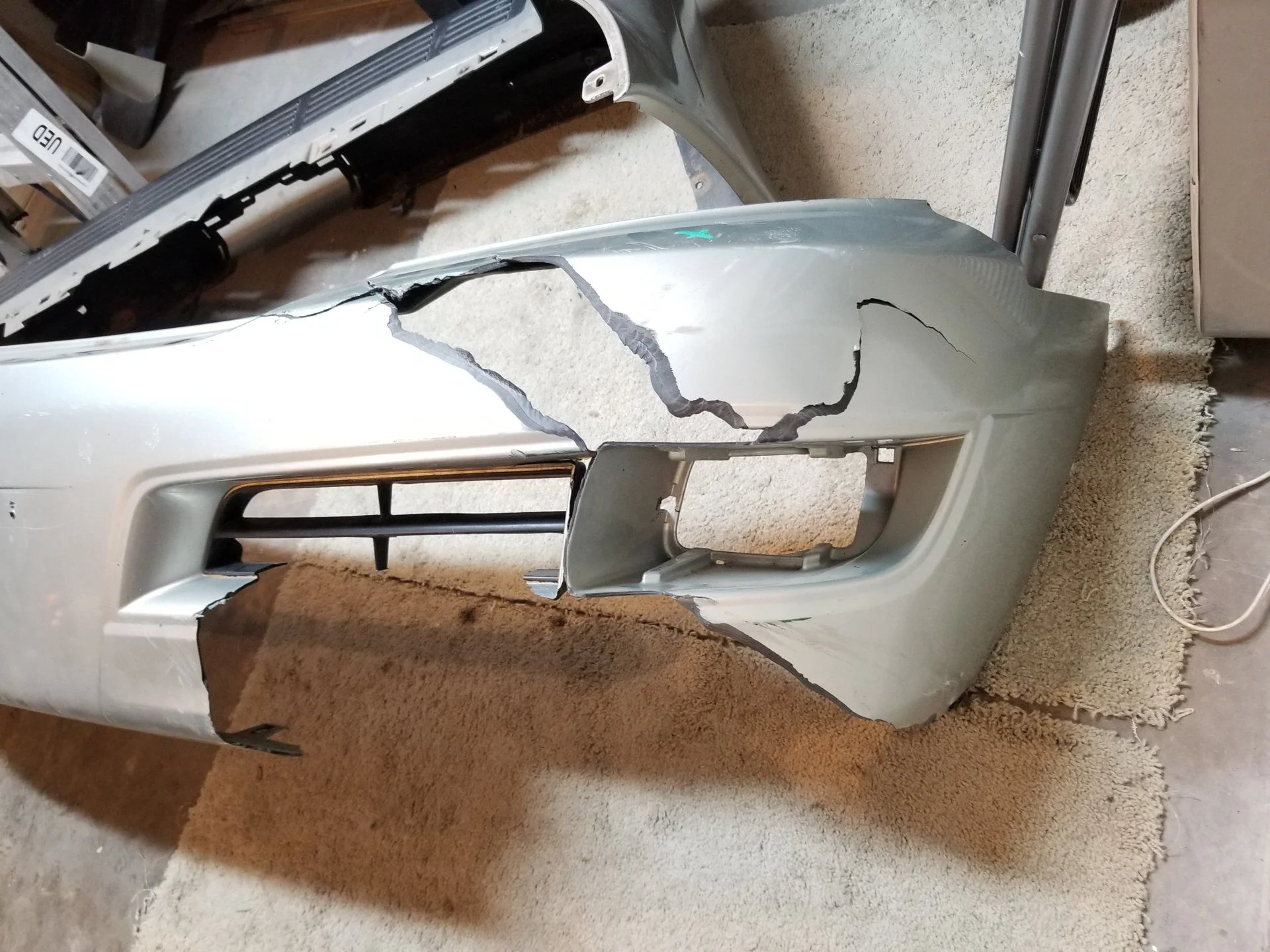

Got to try and figure out what I'm going to do about this first.....🤔. I have a black replacement bumper, but I may attempt a restoration/modification to keep and trim this mangled silver bumper cover....not like anything I try will make it worse.

That’ll buff out

Just break out the heat gun and bondo!
🤣 Right?!
I plan on cleaning up those gaps and filling them with peices trimmed from the running boards and lower bumper lol. I think sanding, prepping and painting the black bumper I bought would be less work... ¯\(ツ)

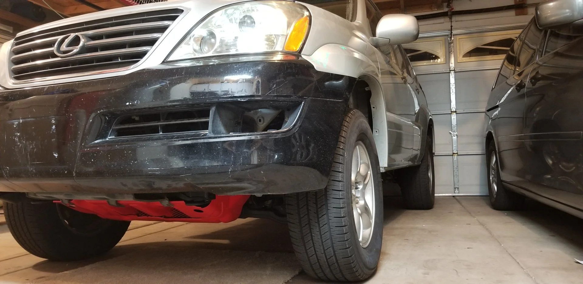

and paint the fender flares and body cladding!!! :steer:
I'm leaning heavily on you, I think tone black on silver would be rad. You're half.way there ;)
And it's totalled, so what do you care?
Haha
You win. I think I'm going to leave it black for now, needs to be cleaned up and will look better, but time to put the fogs back in and bolt it all together. (my wife said the black is growing on her) Its all relatively easy to remove again to paint in the future when that happens..... now time to get an AZ level III inspection so I can insure/register it and drive it on the road legally. (not in the cover of darkness while testing suspension work in my neighborhood :p)

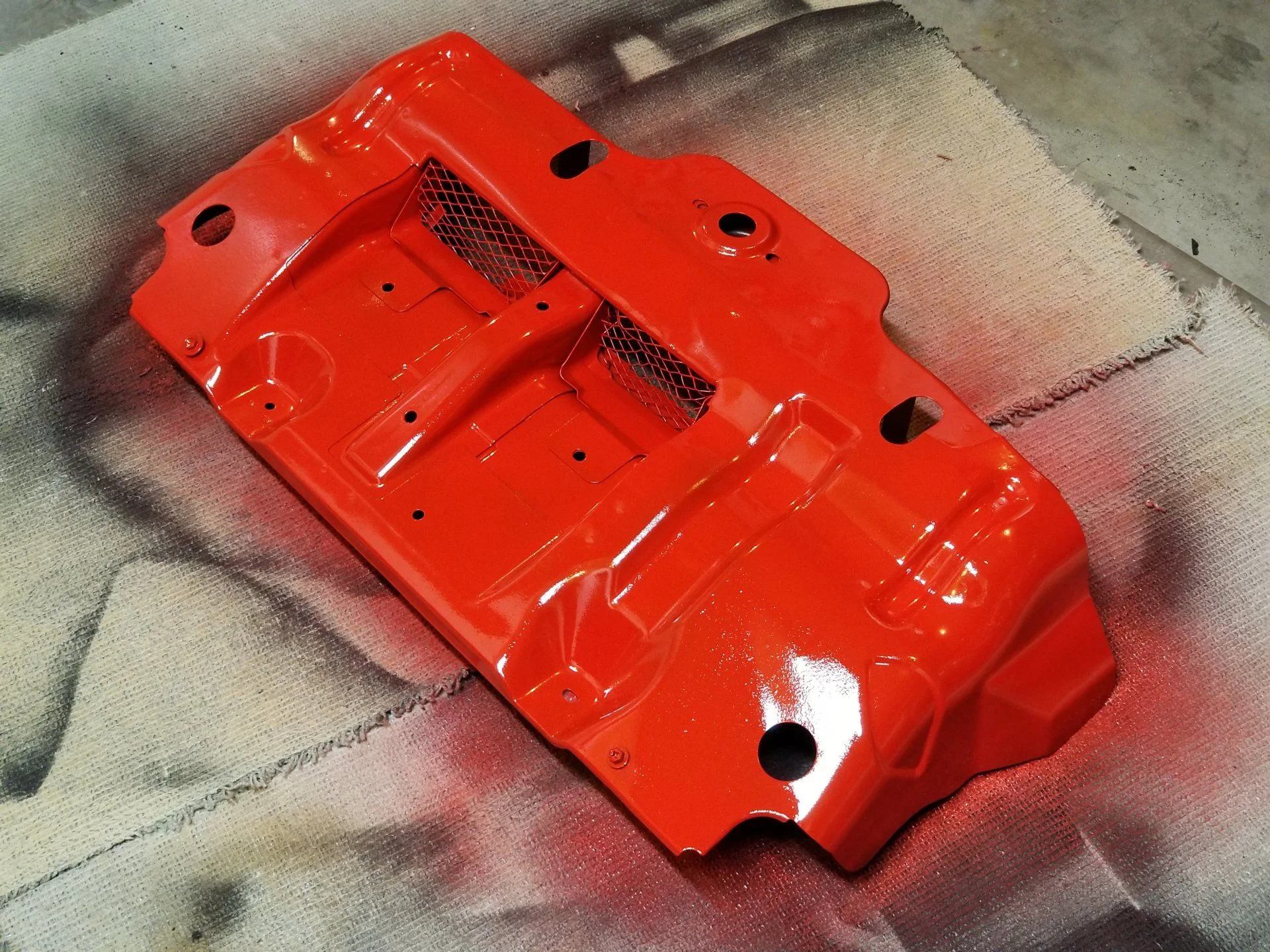

Another note, when removing the skin plates the bolts and corresponding nuts that bolts screw into on the frame were stressed and became stripped. Original bolts wouldn't go back in. They just fell out - threads were shaved. Purchased new bolts at Ace, installed last night, but felt it was a bit forced. If I have to remove the skid again, I'm not sure the same bolts will work again. I wonder how hard it is to tap a larger bolt thread pattern in the frame?

Mine have been jacked, I've replaced the aft 2 and the fore center with nutserts. . .
I think the black bumpers are a preview for eventual aftermarket. Consider blacking the body cladding too, or do a PS to test fit ;)
*googles Nutsert.....That would work. DId you need a rivet type drill gun to place? or can they be done with regular socket wrenches???
Can do with paired wrenches but proper tools.is moar ideal.
