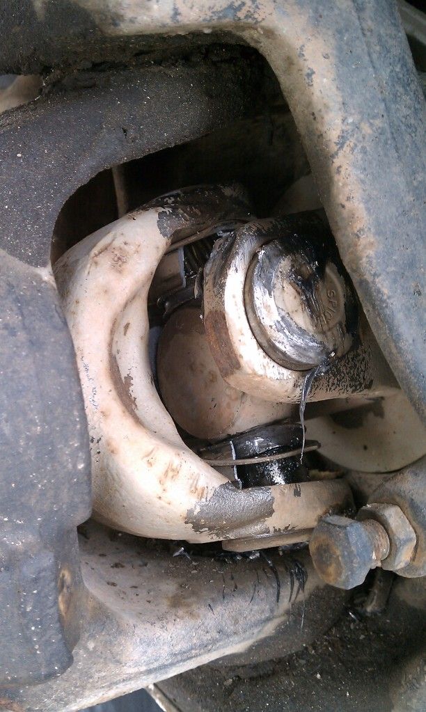

driving out ujoint caps? sorry man, but tell your kid he's gonna have to work on that sexy pose...:flipoff2:
Technically the caps are still there :flipoff2: The best part is a guy came up and asked if I blew a Birf :lol:
Thats all he got :lol:

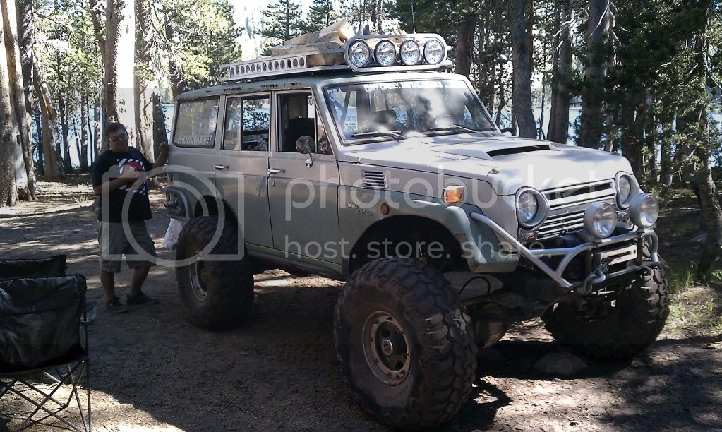

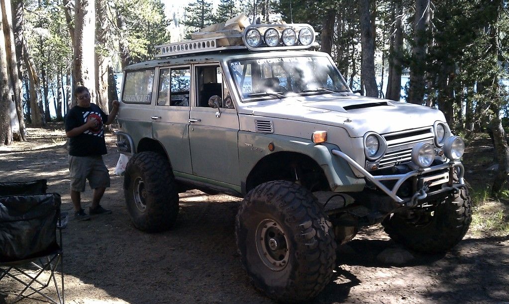

I took the first pic and told him to work on it.
Thats the second pic.
Hes only 17 so there is still time to fix the sexy pose :lol:
