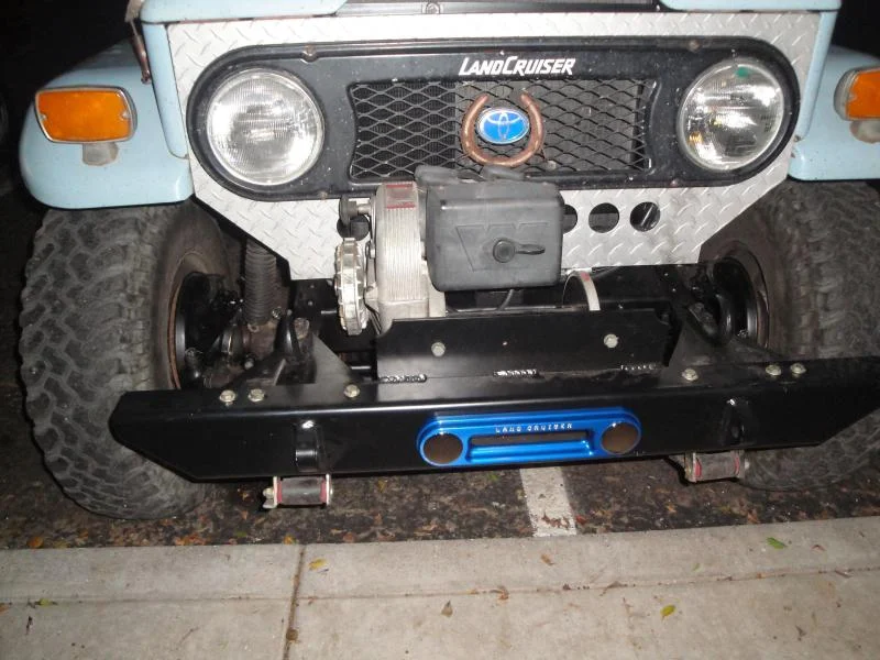

installed an FJ40 bezel winch fairlead

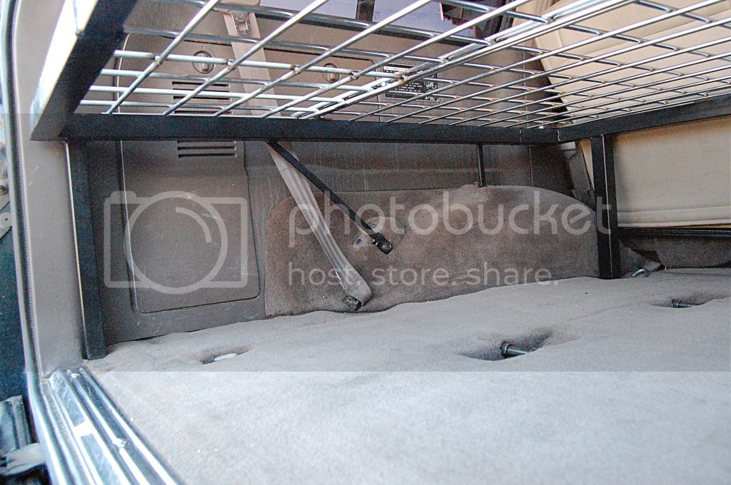

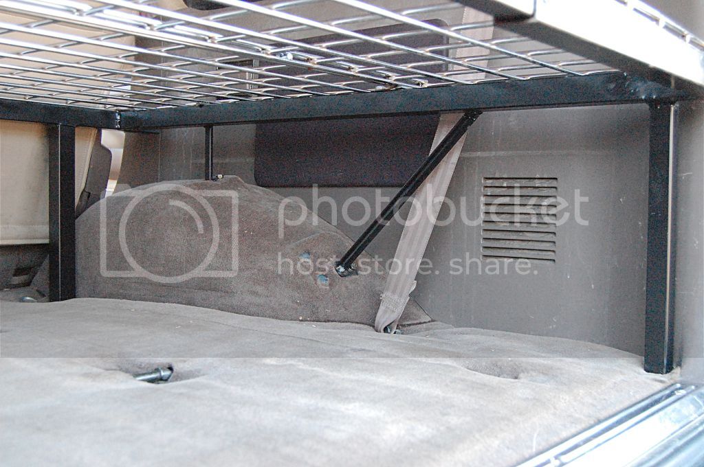

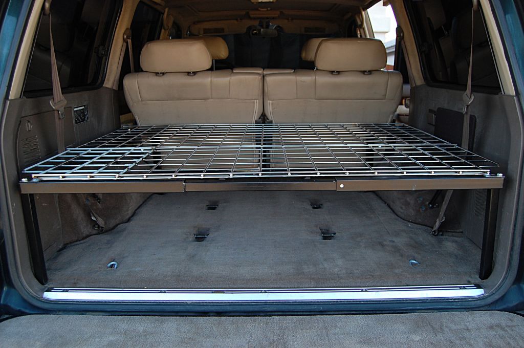

A great light weight storage solution that can be easily removed if needed.
Installed MAD storage platform by jjgarci1. Original idea from http://www.copperstatecruisers.com/rear-storage-area.html.
The platform is mounted to the stock 3rd row seats mounting holes. Grid walls are then bolted to the platform. Total of 12 bolts. Installation took about 5 minutes.
Thanks jjgarci1 and murf.

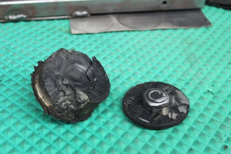

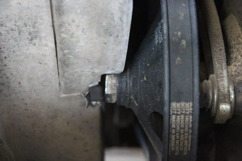

Replaced broken motor mount
I discovered the root cause of all the noise I made coming down Three Feathers last month.
I knew the noise was my power steering pump pulley making a larger opening in my radiator fan shroud, and thought the radiator had movement at the base allowing the radiator to shift back towards the pulley.
Nope - the engine was moving towards the radiator because of a busted driver's side motor mount.
I replaced the broken mount and made sure the other three were intact.
Pics:
Extra clearance on shroud
Odd looking motor mount
Broken mount - it looks like rats chewed trough it :mad:

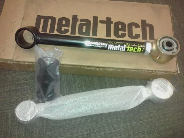

New goodies! The rear upper control arm bushings were torn and figured a good time to move to the adjustables :)

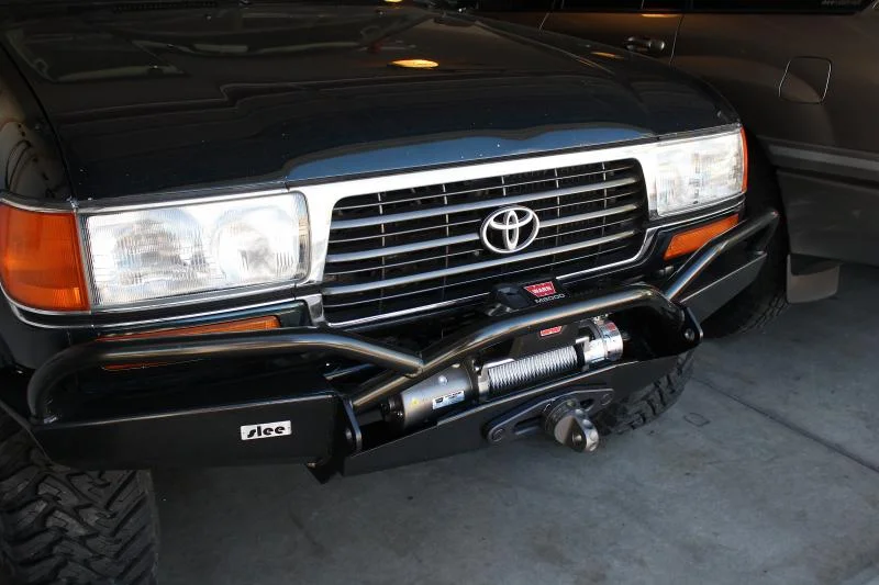

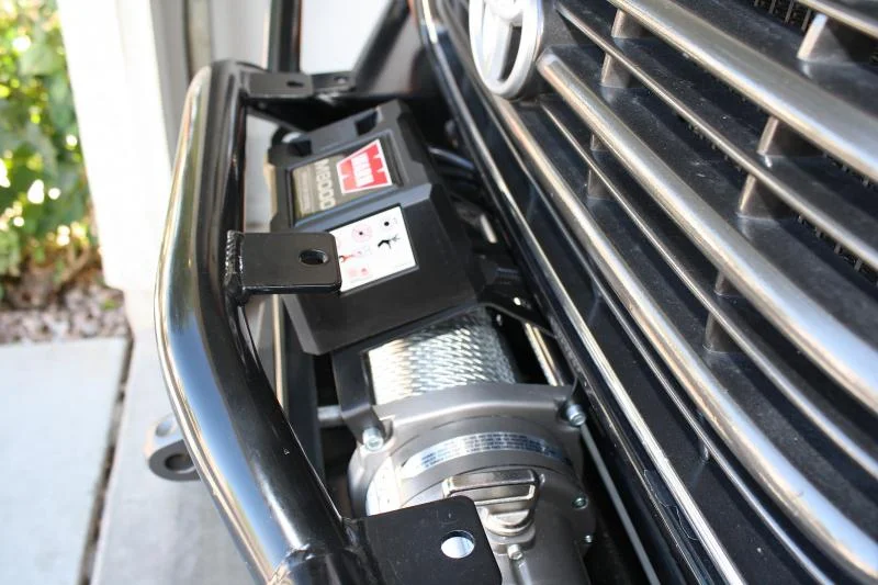

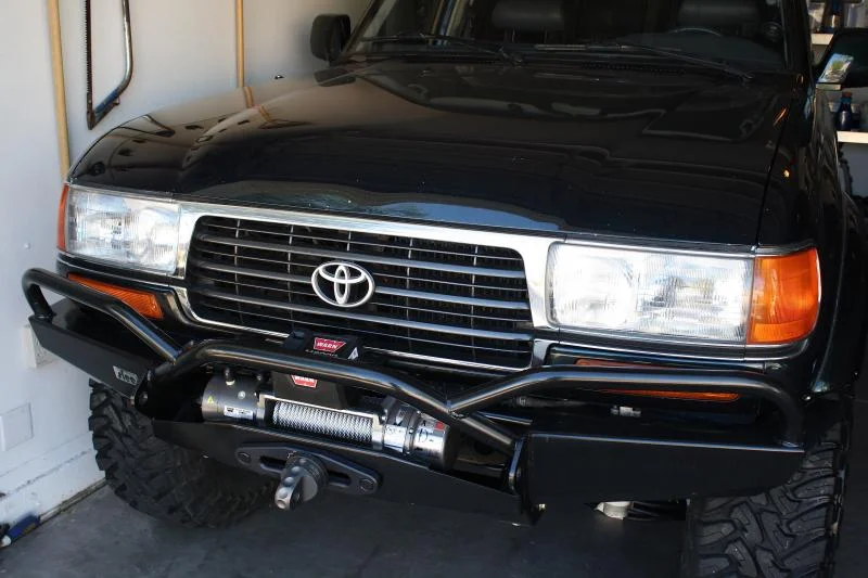

Added a Warn M8000 winch

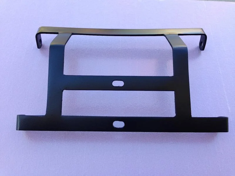

Added a Warn M8000 winch to my Slee shortbus front bumper. Having bought the bumper 2nd hand, it did not come with the Slee bracket for the solenoid box, so I had to make one from scratch.
Looks great Mike, tell us more about the bracket..
