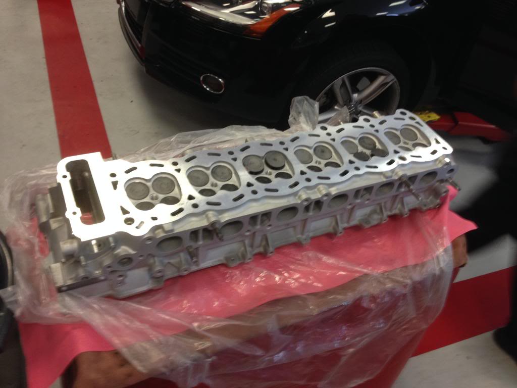

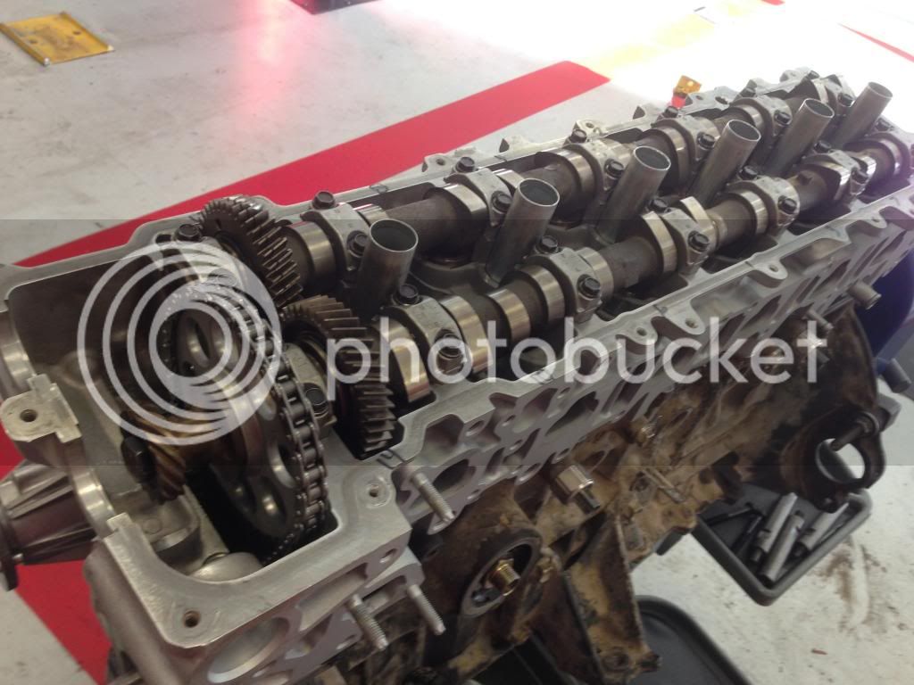

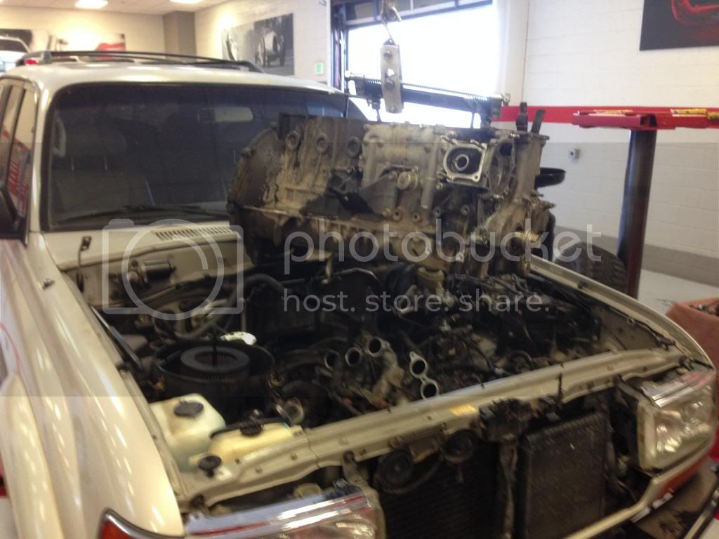

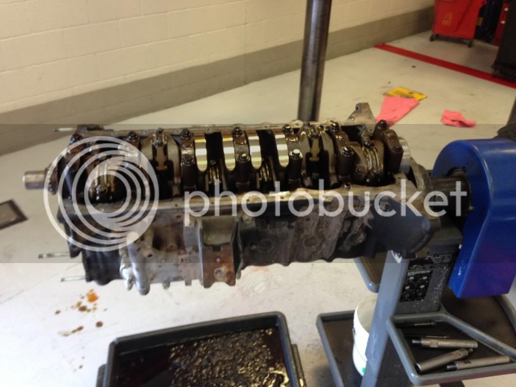

I rebuilt my engine! My valve stem seals were done. I ended up replacing everything except pistons and rings with OEM parts!
This truck runs like Brand New! :cheers:
I sent the head out to Bill's Cylinder head for a full rebuild!
