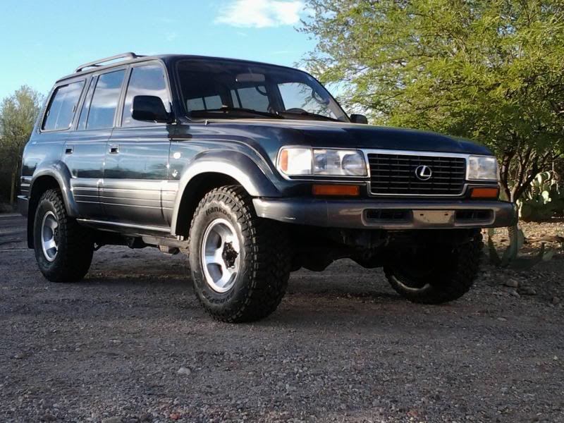

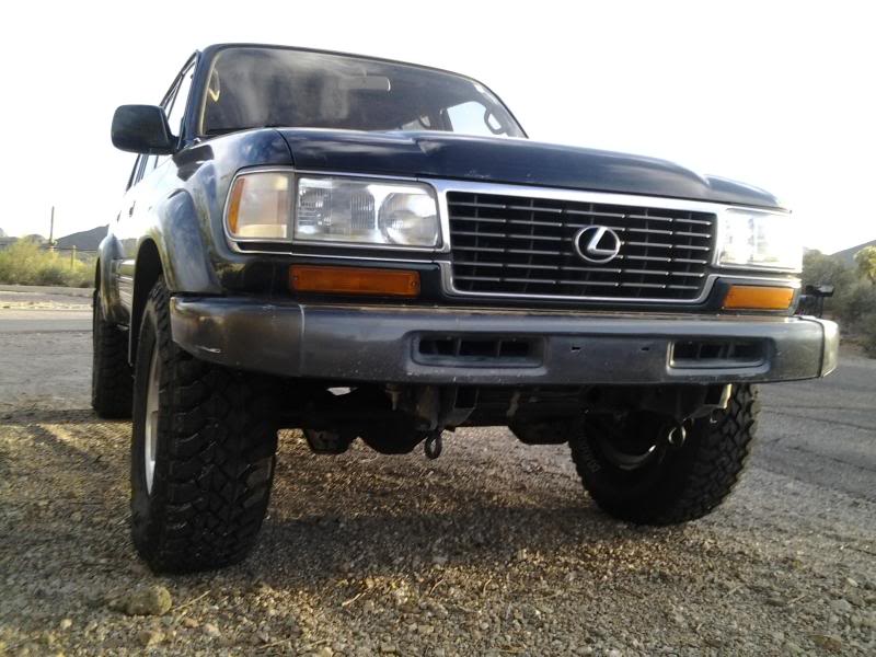

Over the last week or so I have done...
Removed rear heater and PIA plumbing for it.
Removed the remaining OEM cell phone crap:grinpimp:
Installed my 285/75R-16's
Ordered my lift...be here Monday:hillbilly:
Fixed all the broken exhaust mounts.
Picked up a ARB roof rack.
Cut the front bumper in half.
Bunch of little PM stuff:wrench:
The trimmed front bumper facelift looks like one of the "best bang for the buck" out there. What kind of lift are you getting?
