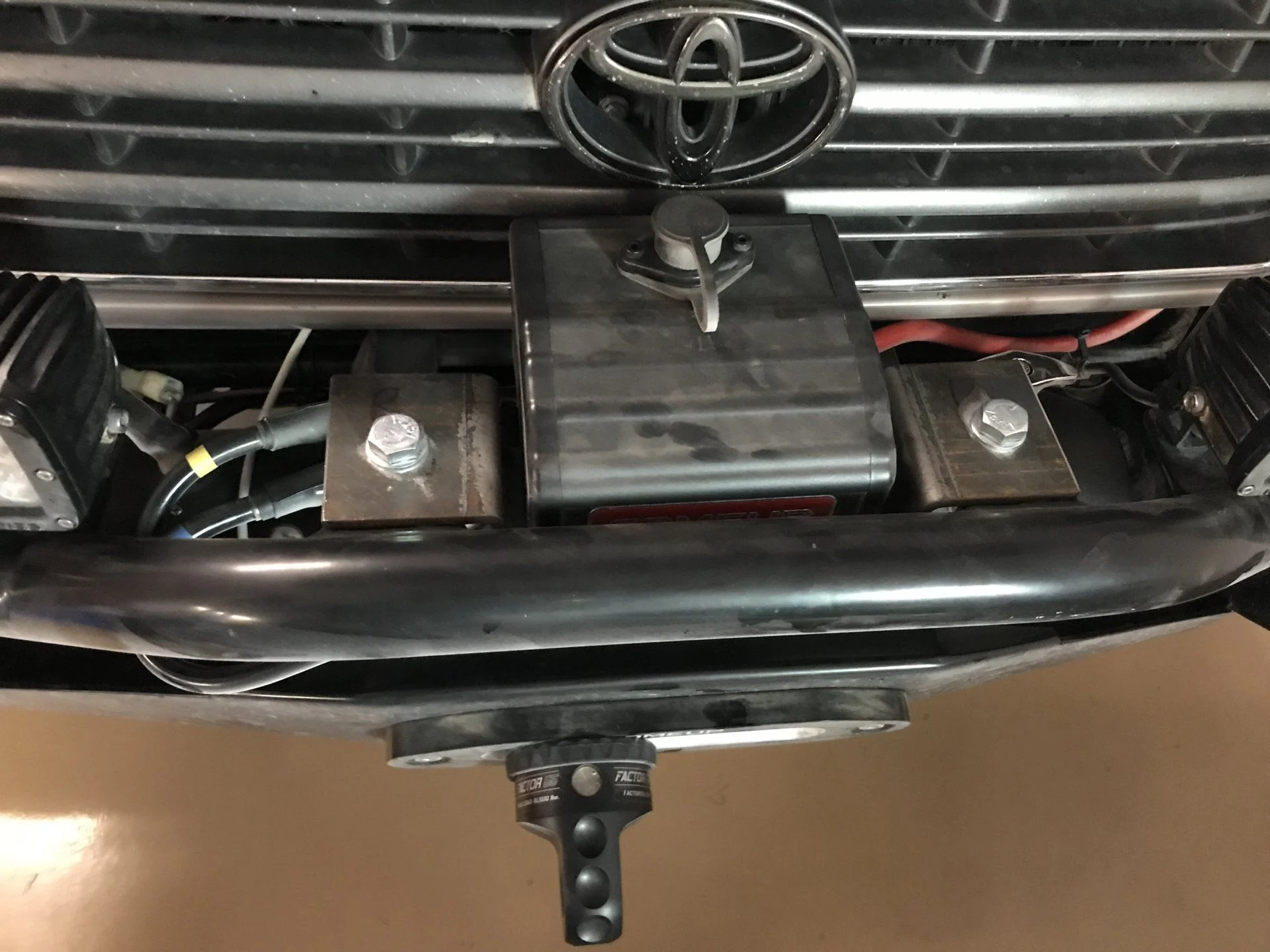

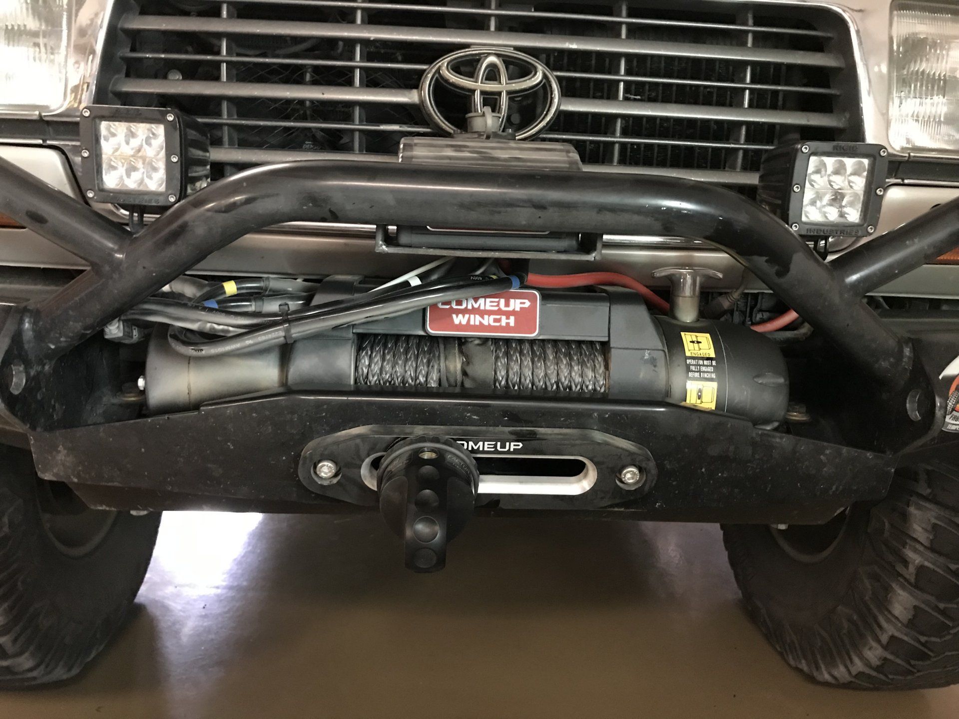

With the help of Steve at Sonoran Steel, we replaced my 8000lb S_ittybilt winch with a Comeup 9.5rs and a Factor55 Prolink. Now I meet the 1.5x winch rating and have way more confidence in my winch.
Steve made me a custom bracket for the controller to fit on the Slee Shortbus bumper.

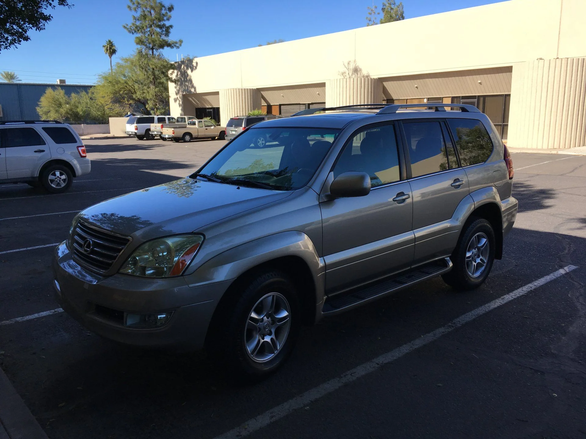

GX470 added to the fleet - pics to follow

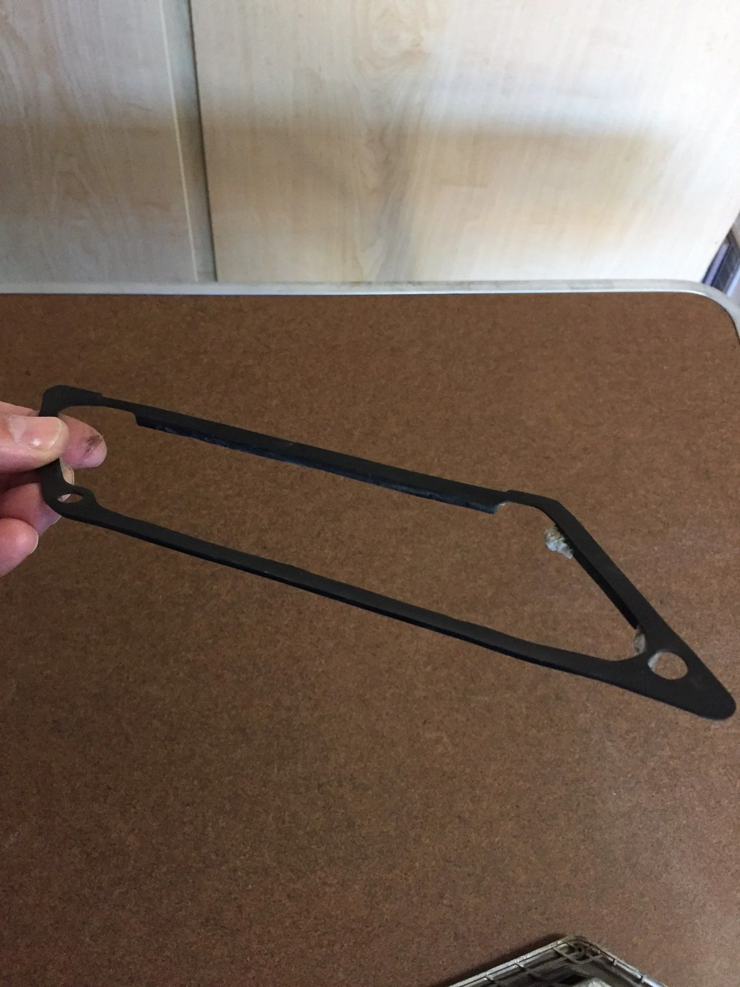

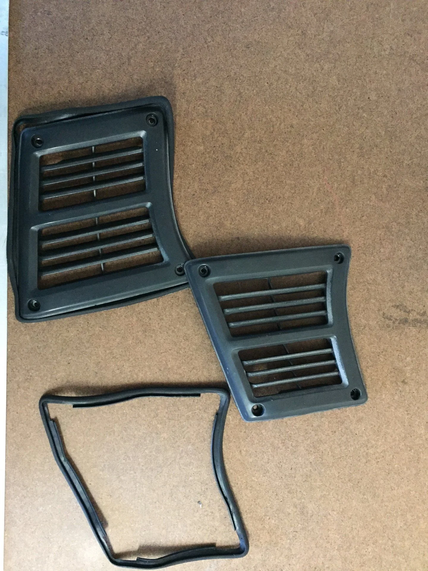

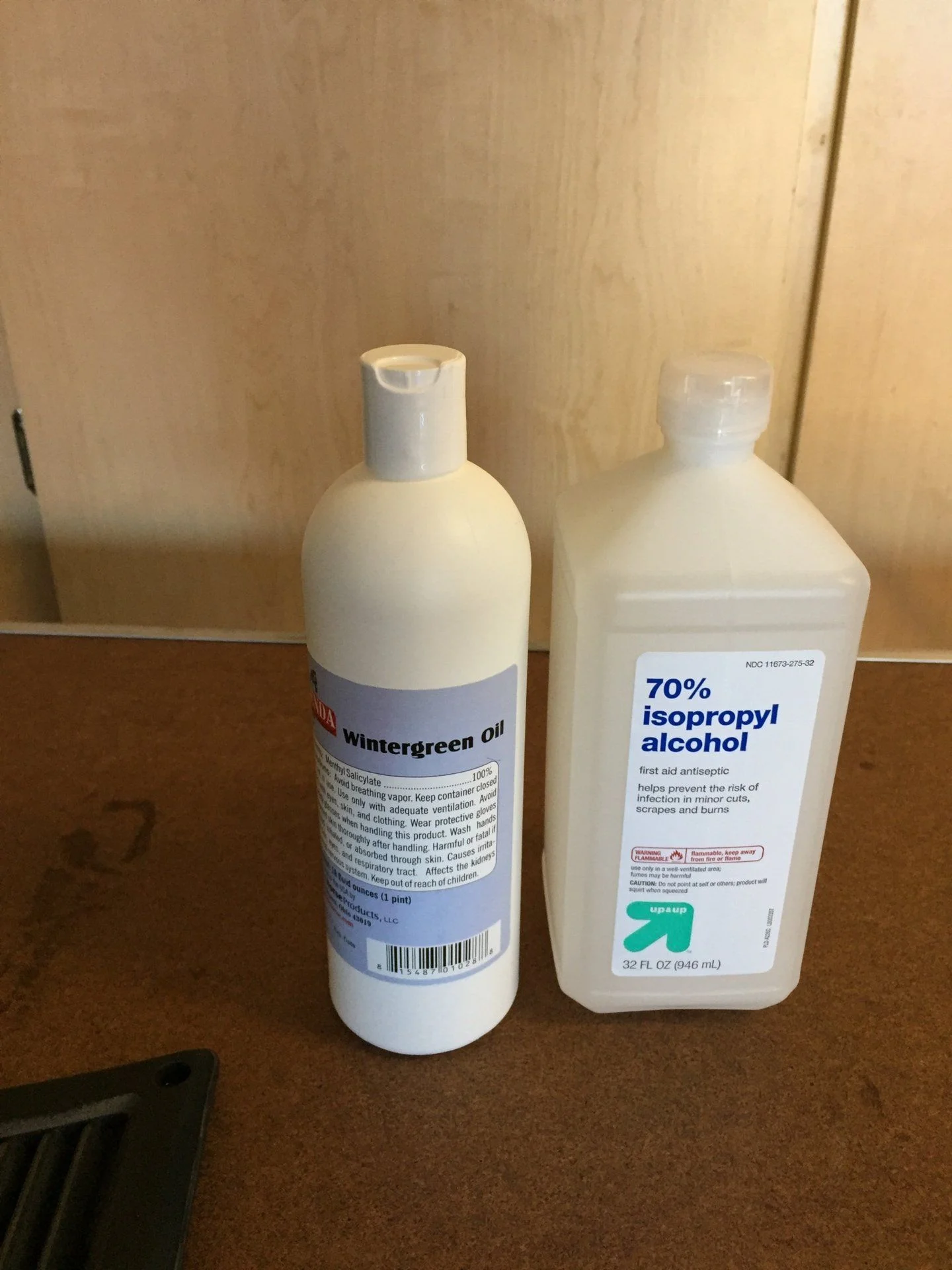

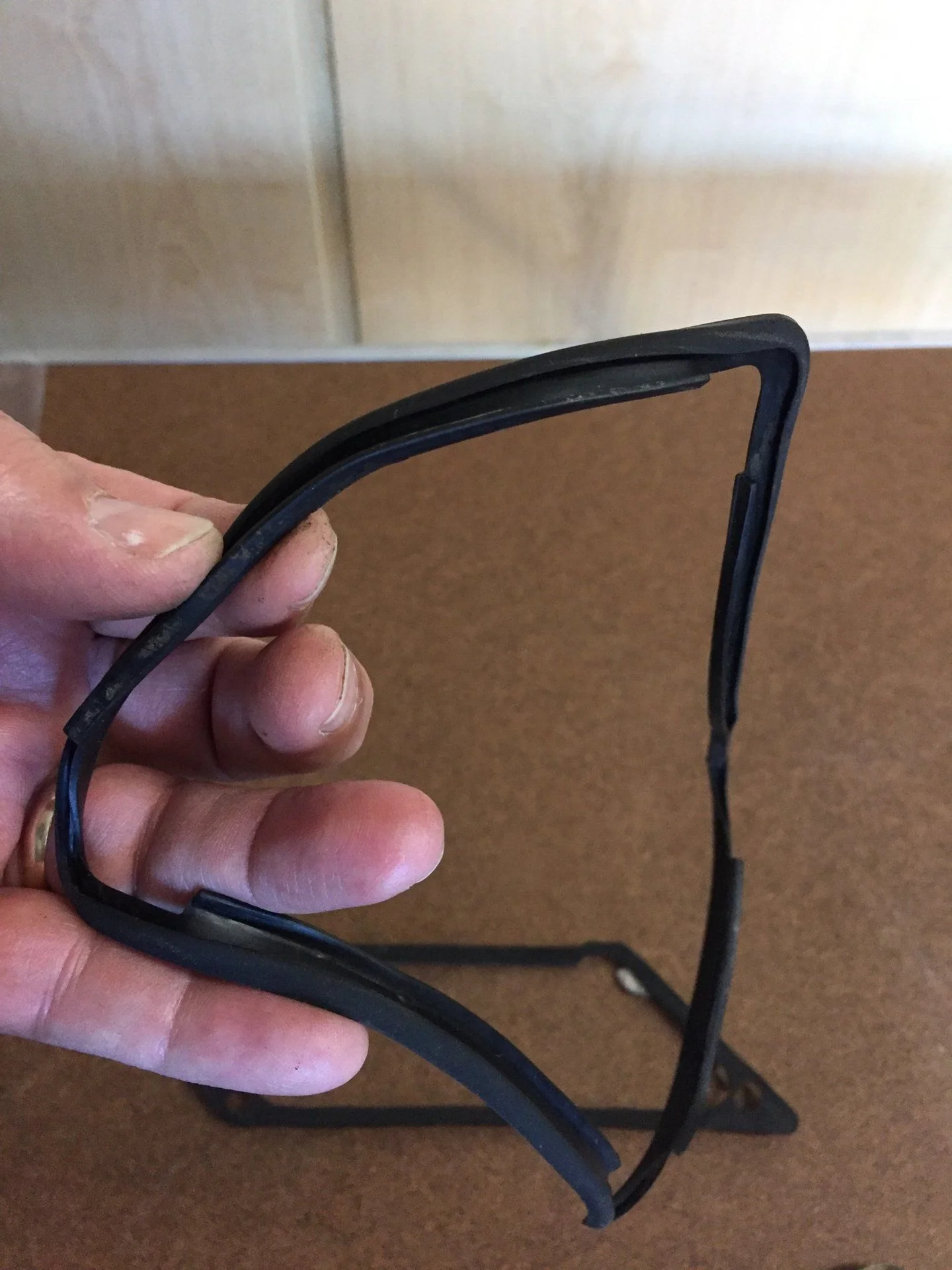

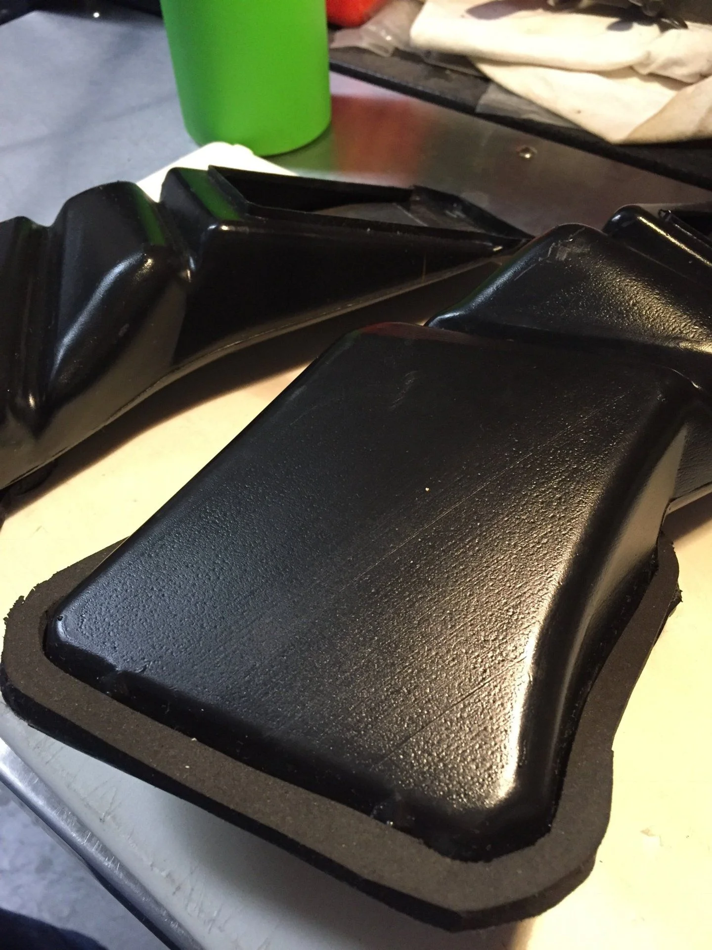

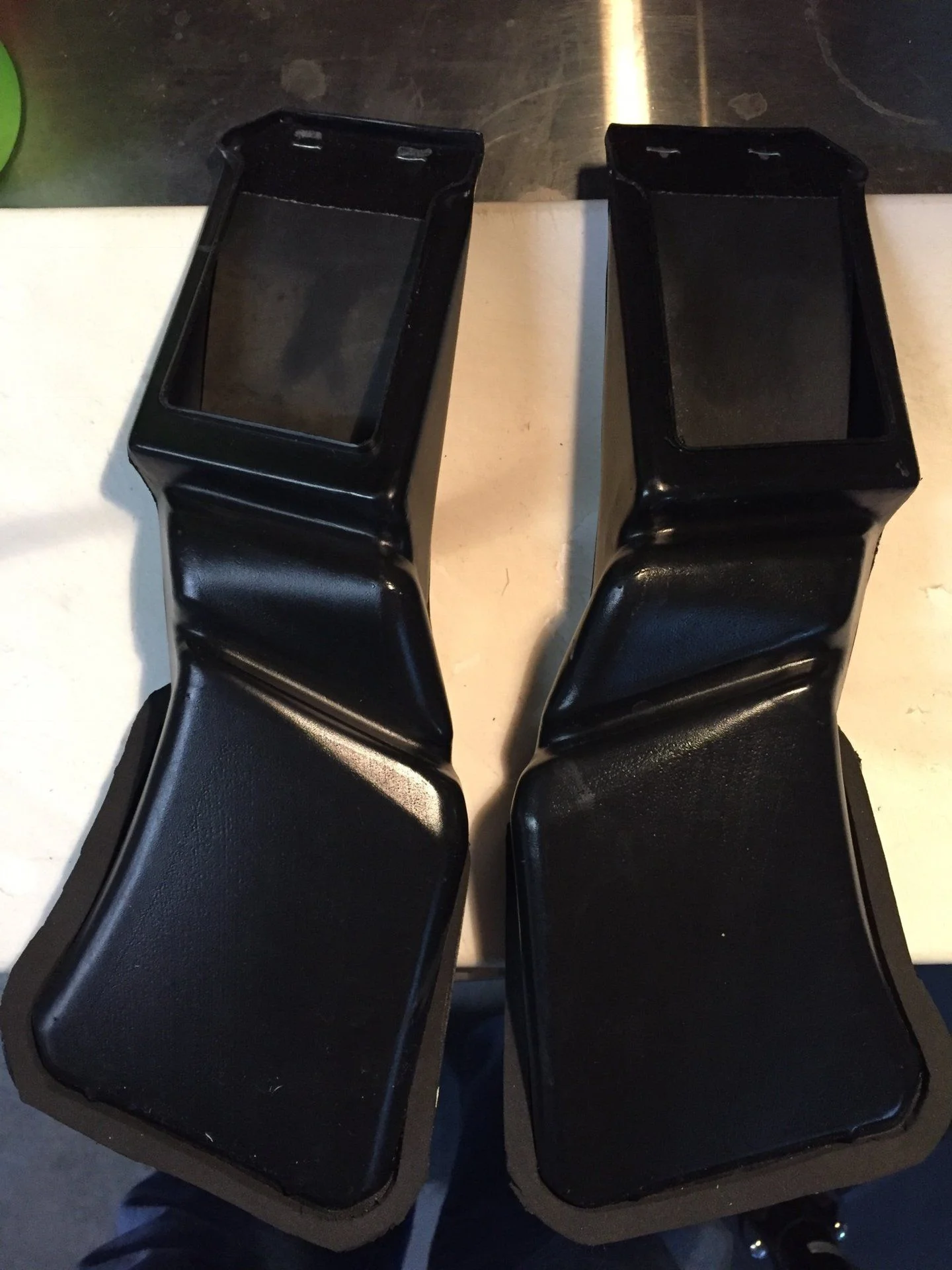

Did some old rubber restoration on FJ60 D pillars vents. The old gaskets around the plastics vents was so hard it was about to break in to pieces. I tried a recipe that is used by the old hot rodders and posted in another section on mud. Use one part oil of wintergreen and 4 parts isopropyl alcohol 70% mix in a ziplock bag and add the rubber parts, ensure coverage and seal the bag. Wait overnight.
Here is what they look like now, like brand new rubber. The parts still need a day or two of drying time but the results are amazing.

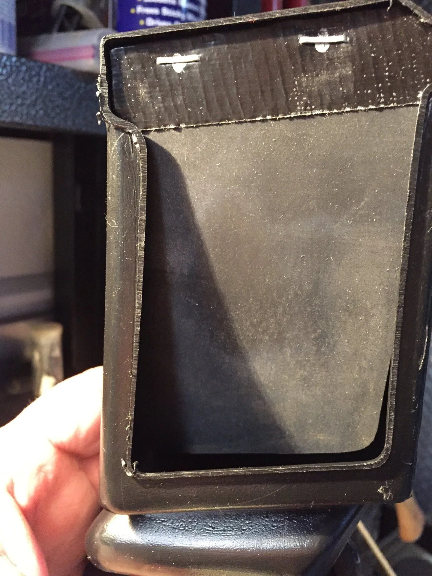

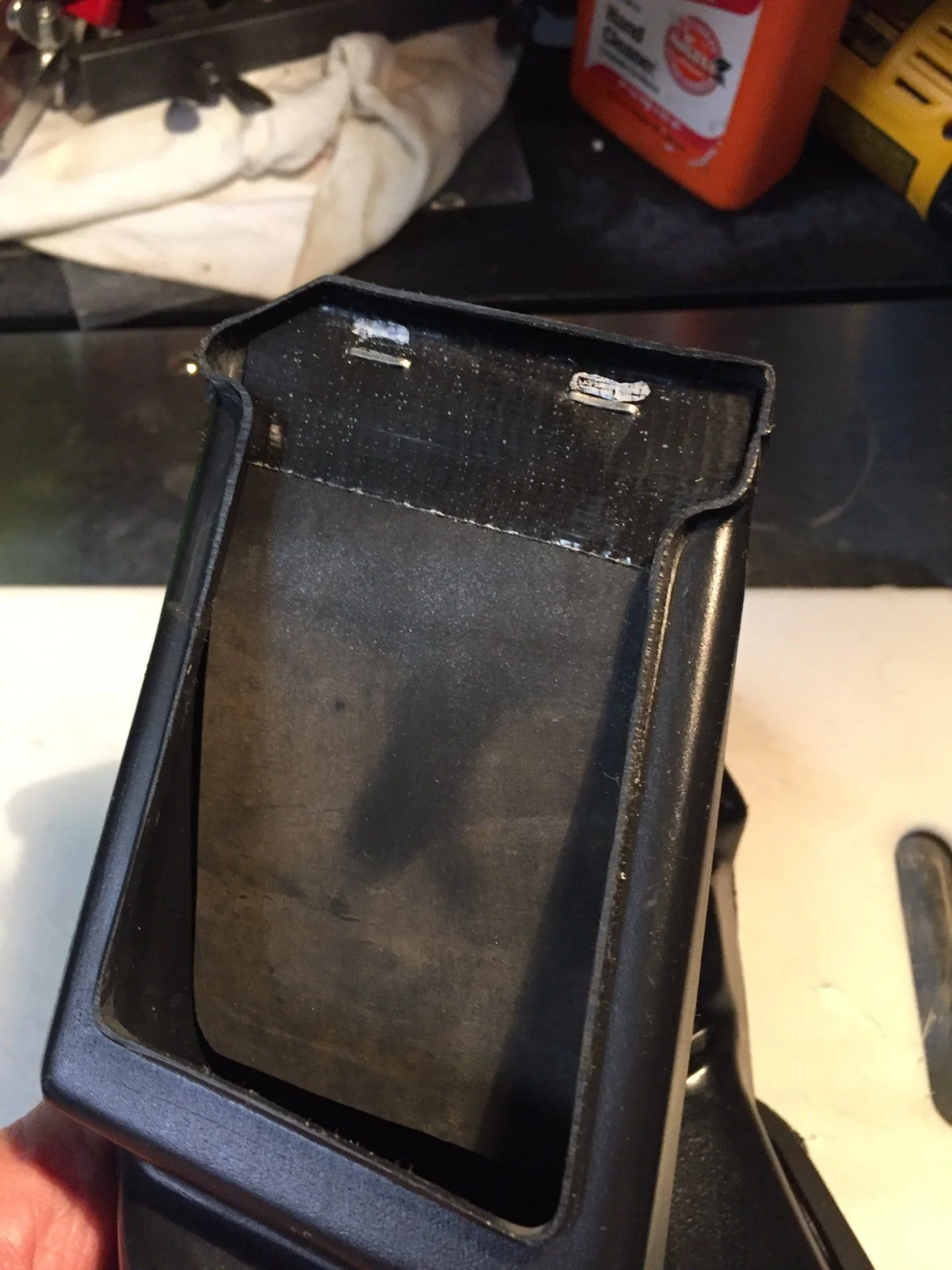

I also made gaskets and rubber flaps for the vent tube that go inside the D pillar, the flaps rot and break off leaving the vents open and allowing dust to enter. I made multiple flaps for others in the 60 club.
Here are some more pics
The rubber swells a bit so it will take a few days to shrink back but if you have old rubber parts and gaskets that are no longer available or you are trying to keep the original patina this process works very well.
Next step is to install these first completed parts in to a friends 60 and pull out some new donor vent tubes and vents and make the next one.

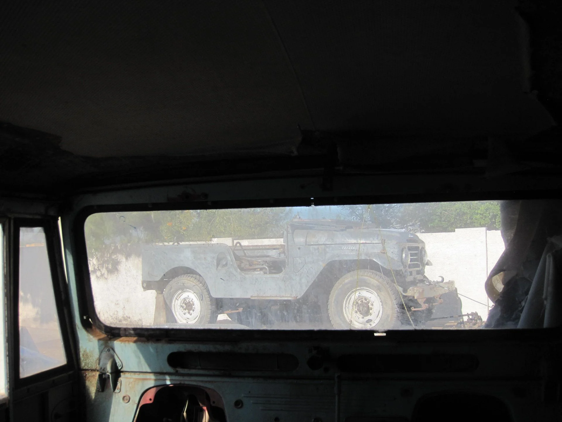

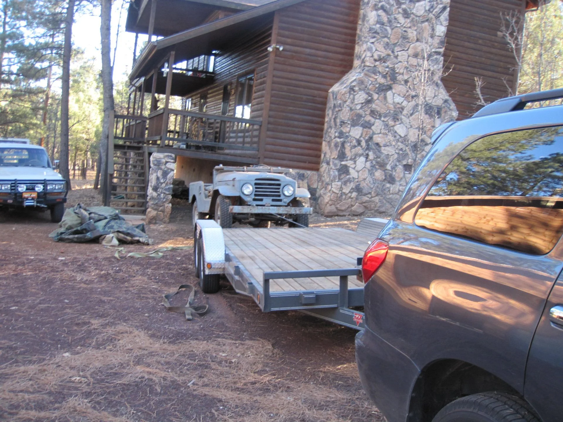

Last week made a trip up north to haul a FJ25 back to the valley I need to work on.
Steering was removed from this one to get a old FJ40 home from a junk yard. This the one that got the steering and the one on the trailer that it came from.
Not sure of the tire size but lowest point of the frame in the middle has over fifteen inches ground clearance.

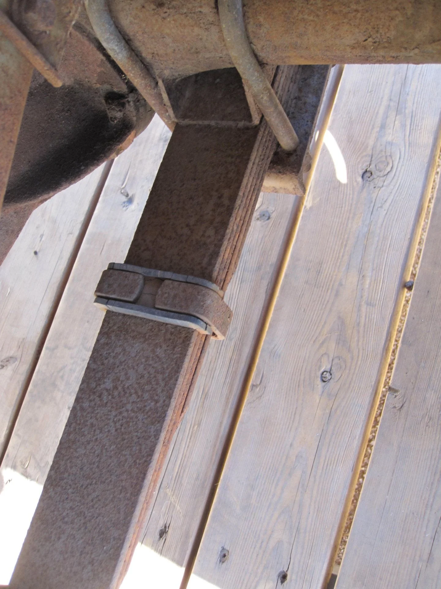

This is with the original springs and shocks. Only seen these pads on original FJ25 springs.
sorry for the poorly lighted pic - it's some goldish color . . .
:rolleyes: - taken just between when the GX threw the CEL code and the 1.5 hour mark to leave for the airport to make our flight back to Baton Rouge - mind you, in that time I also helped to get the LX squared away for storage until the new motor build
