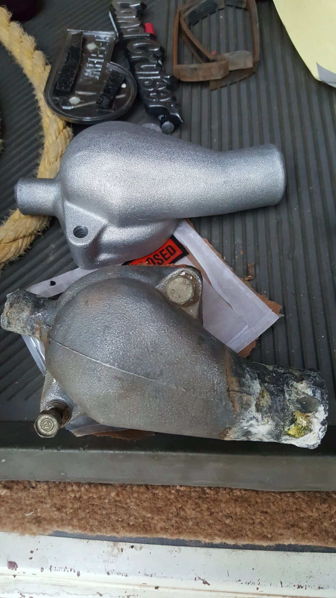

On the FJ40, new water pump, all hoses, thermostat, and upper thermostat housing. Tomorrow I find out if my work leaks?!?!
(Fingers Crossed)

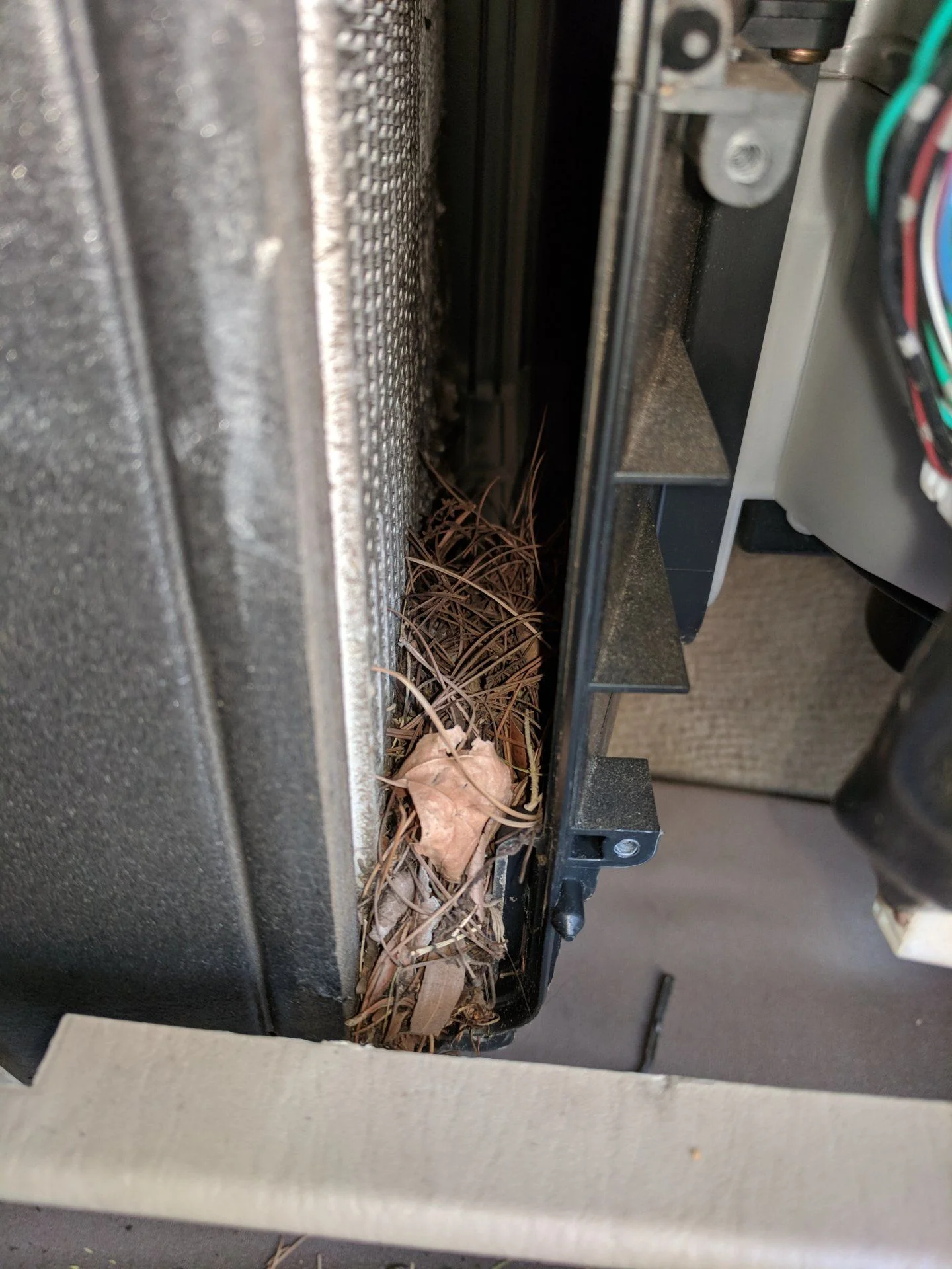

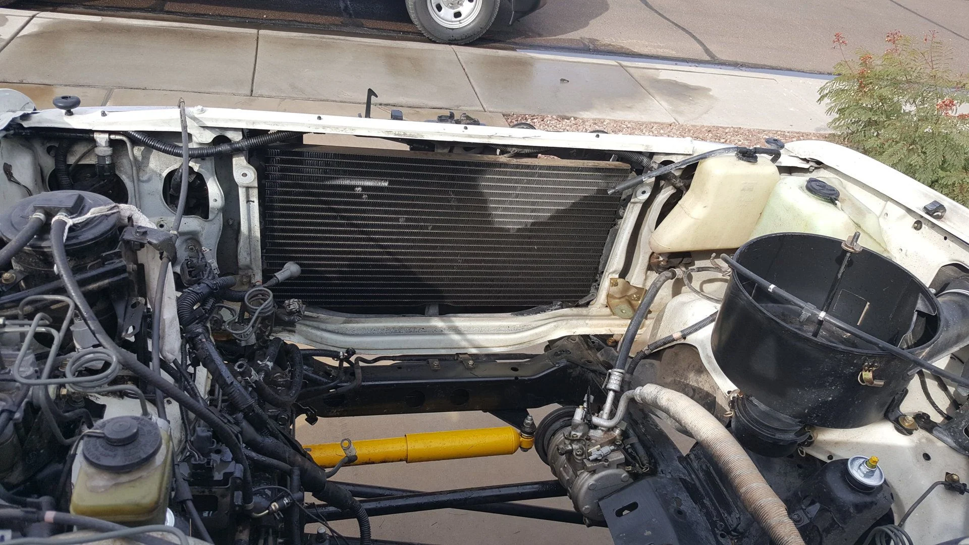

While hanging out at the in-laws in Bakersfield, I decided to tackle the leak under the passenger side dash. In the AC condenser, there is a little rubber gasket at the bottom, part number 88578-47040. During the summer, I was getting drips in the passenger side floor board. Based on some Mud posts, decided to replace this gasket. Sorry, no pics of the gasket, but I did take a pic of the all of the other crap in there.

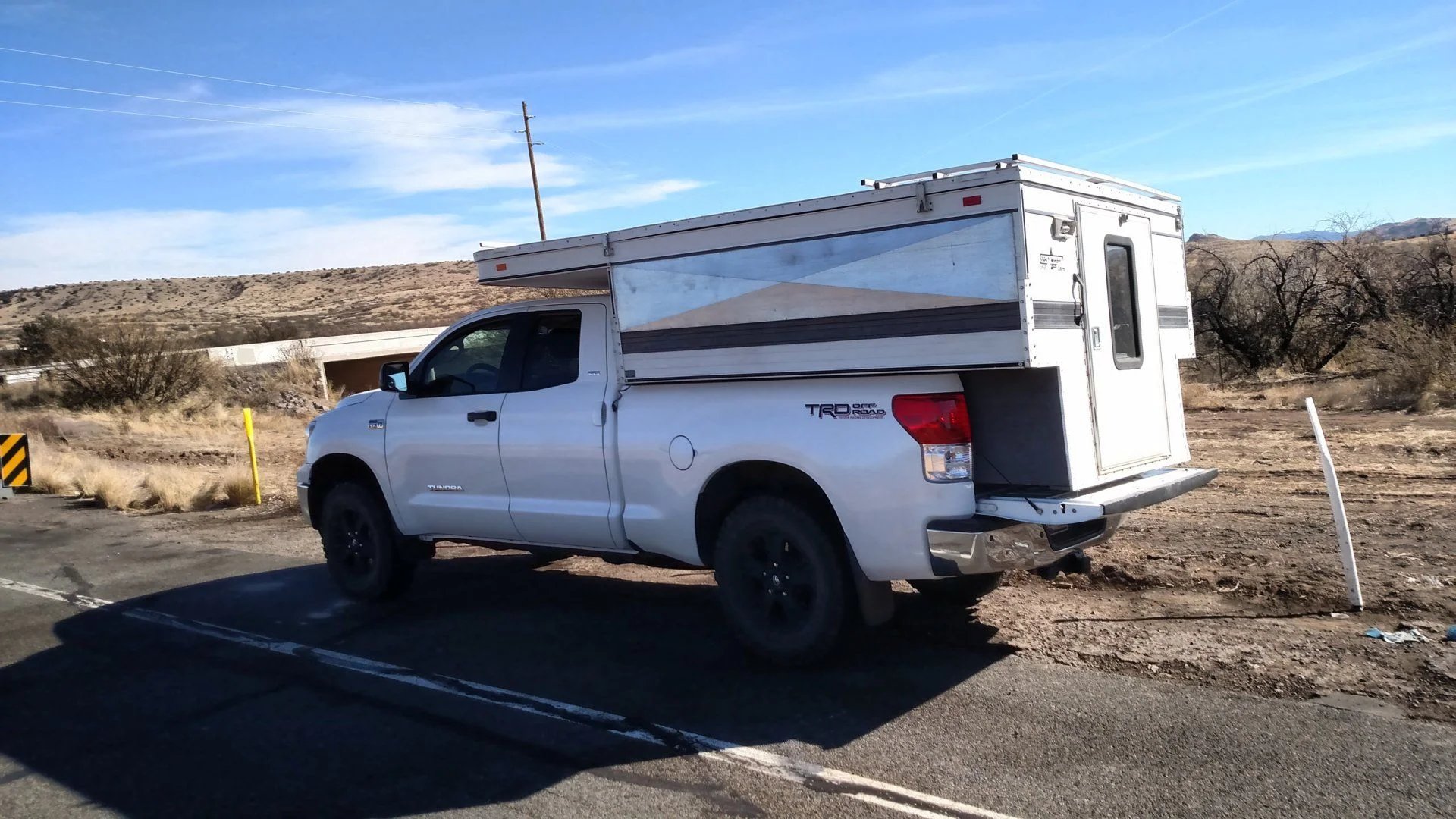

Picked up a new project for the Tundra;
It is a Four Wheel Camper Grandby. I would have preferred a Hawk, but this works with the tailgate down. Basically a gutted shell. Here go my free weekends through the spring...

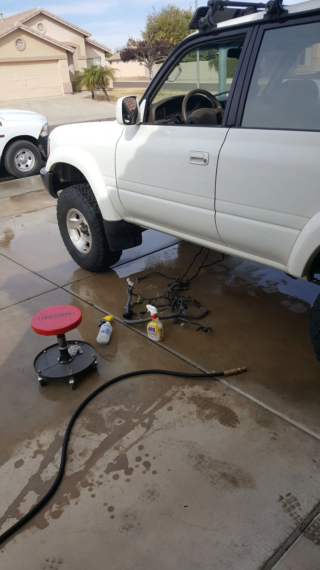

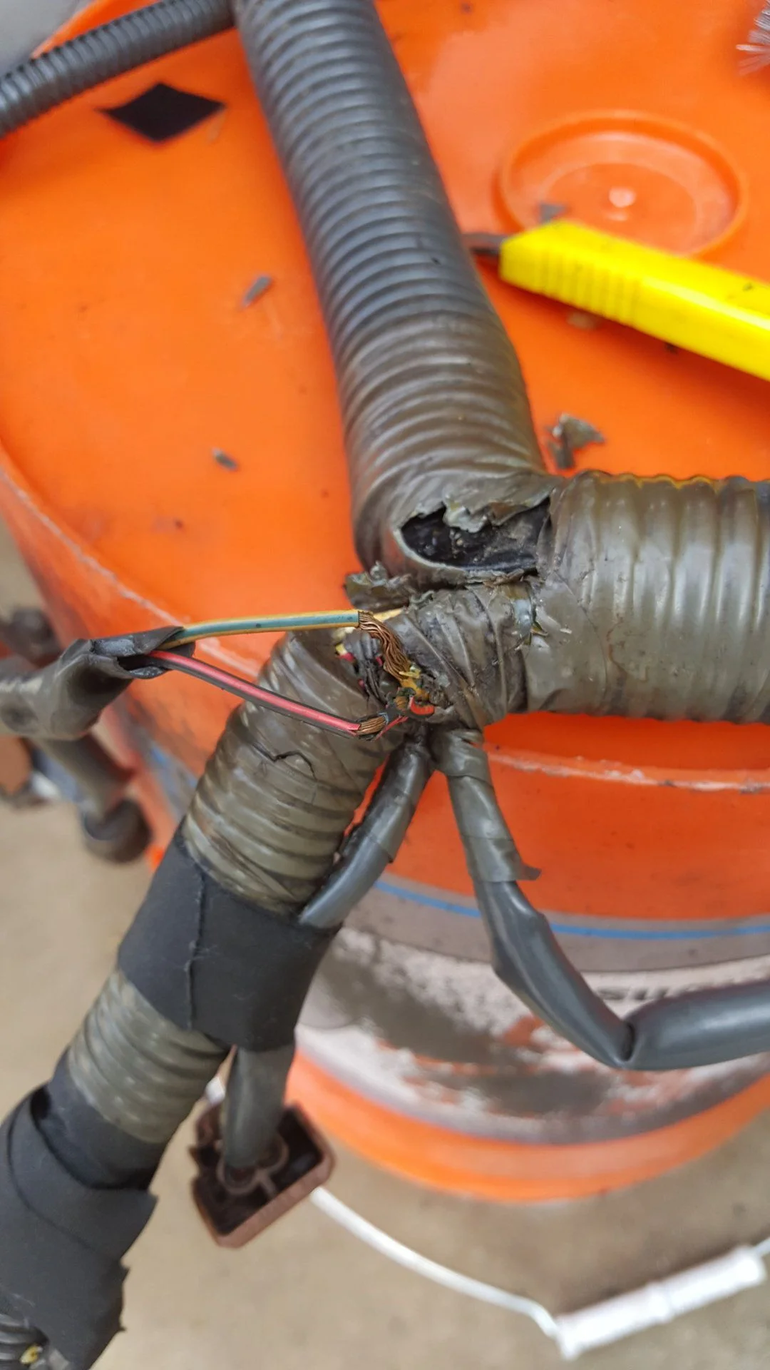

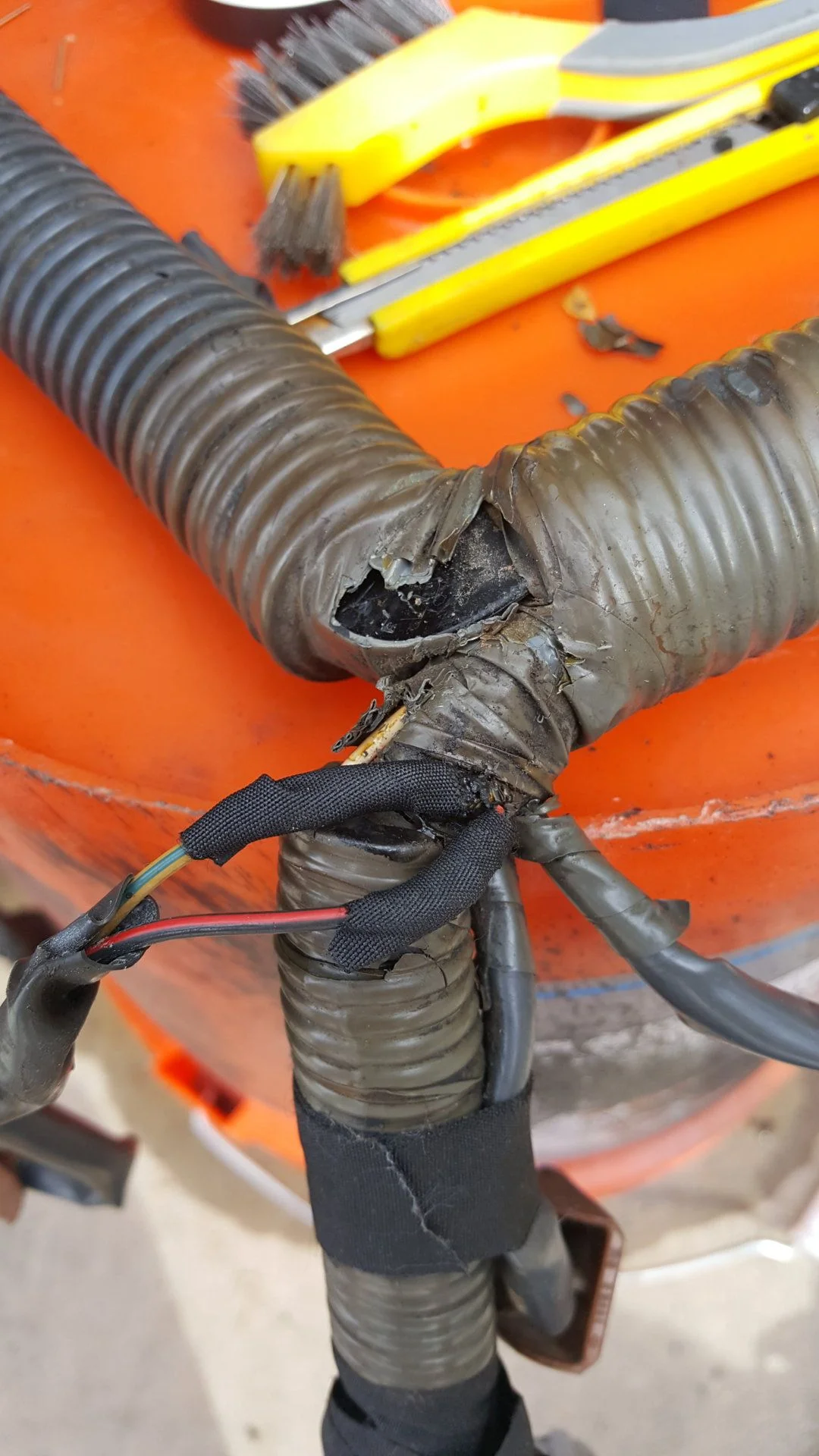

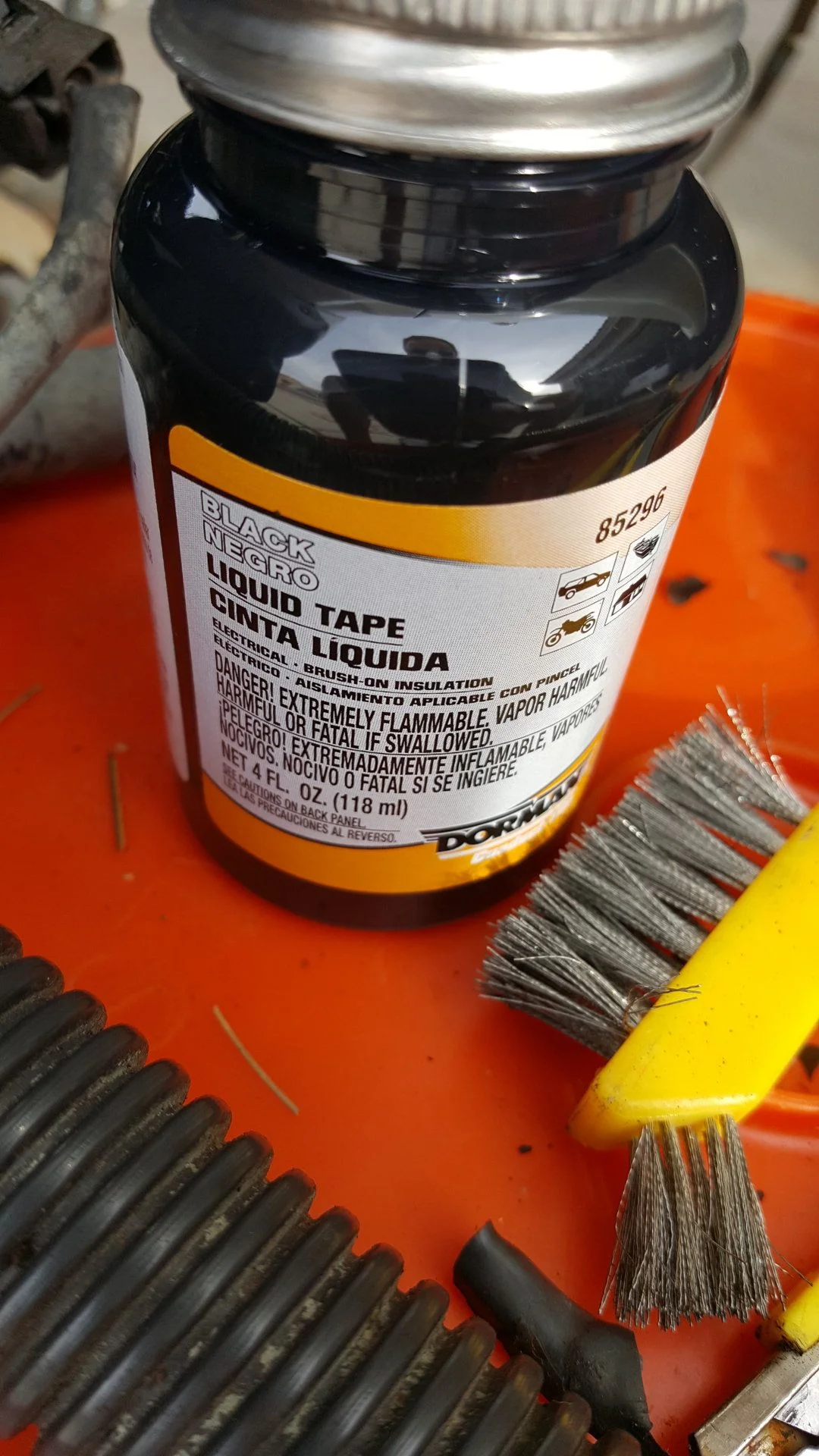

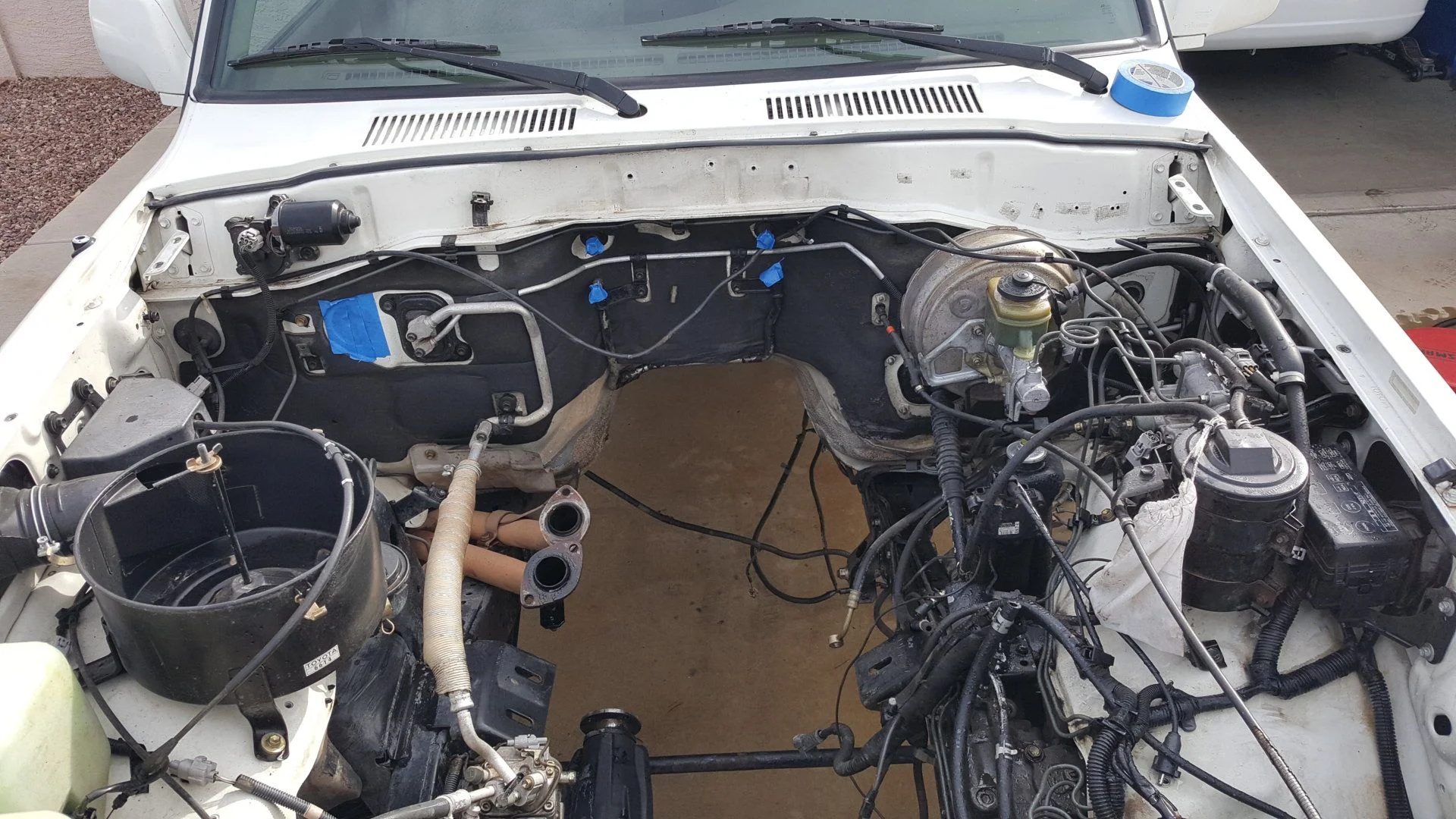

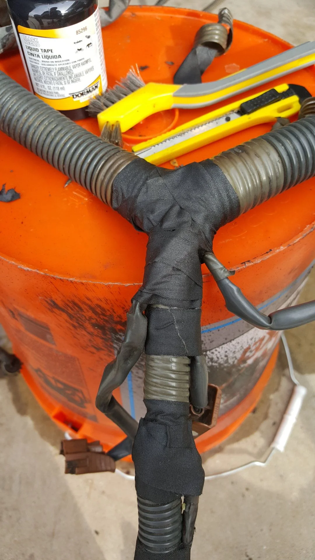

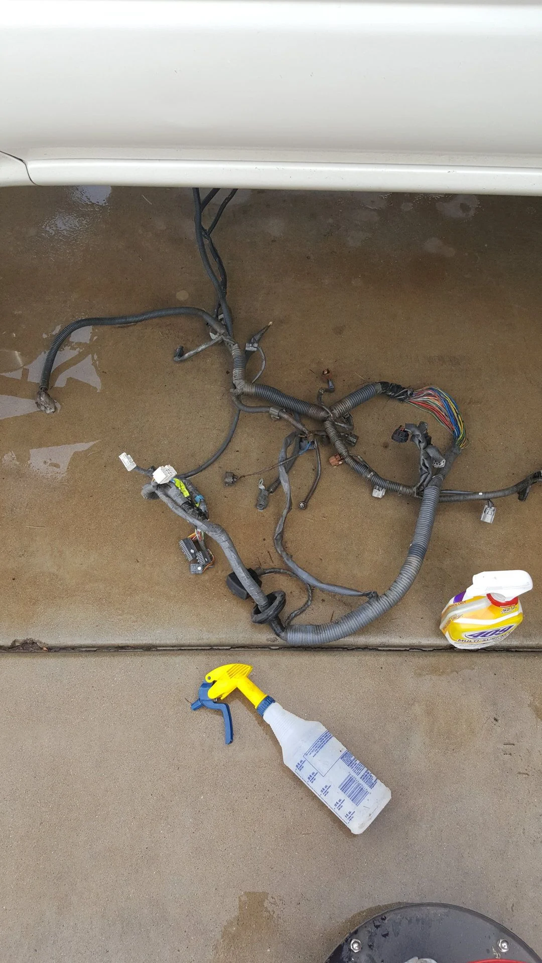

In preparation for receiving the rebuilt engine this week, I degreased and pressure washed the undercarriage, engine compartment and peripheral engine parts of 22 yrs and 236,000 miles of oil and grime. Also took a couple hours to clean and inspect the entire engine harness. Found quite a few bare wires at the connectors and a pair of wires going to an injector that were bare and likely shorting. Used liquid tape and anti-chaff fabric tape to repair all the problems.
Looking forward to getting it going too! It appears that a bad injector leaned the cylinder out and burned a hole in the #1 piston.
