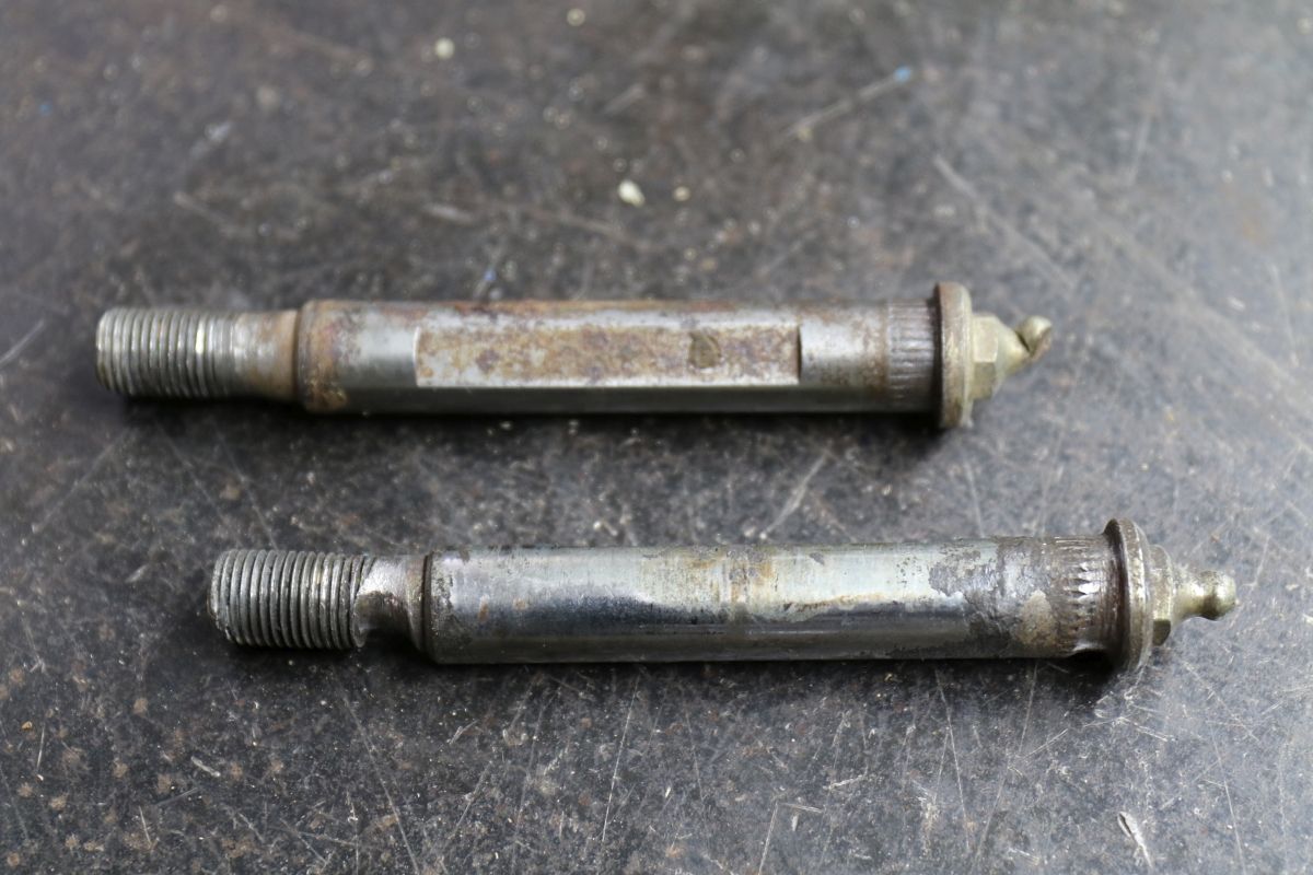

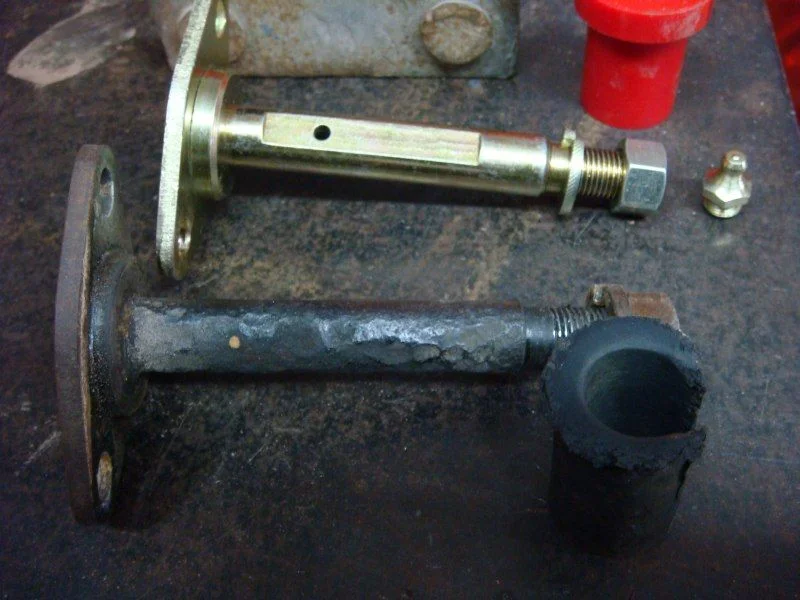

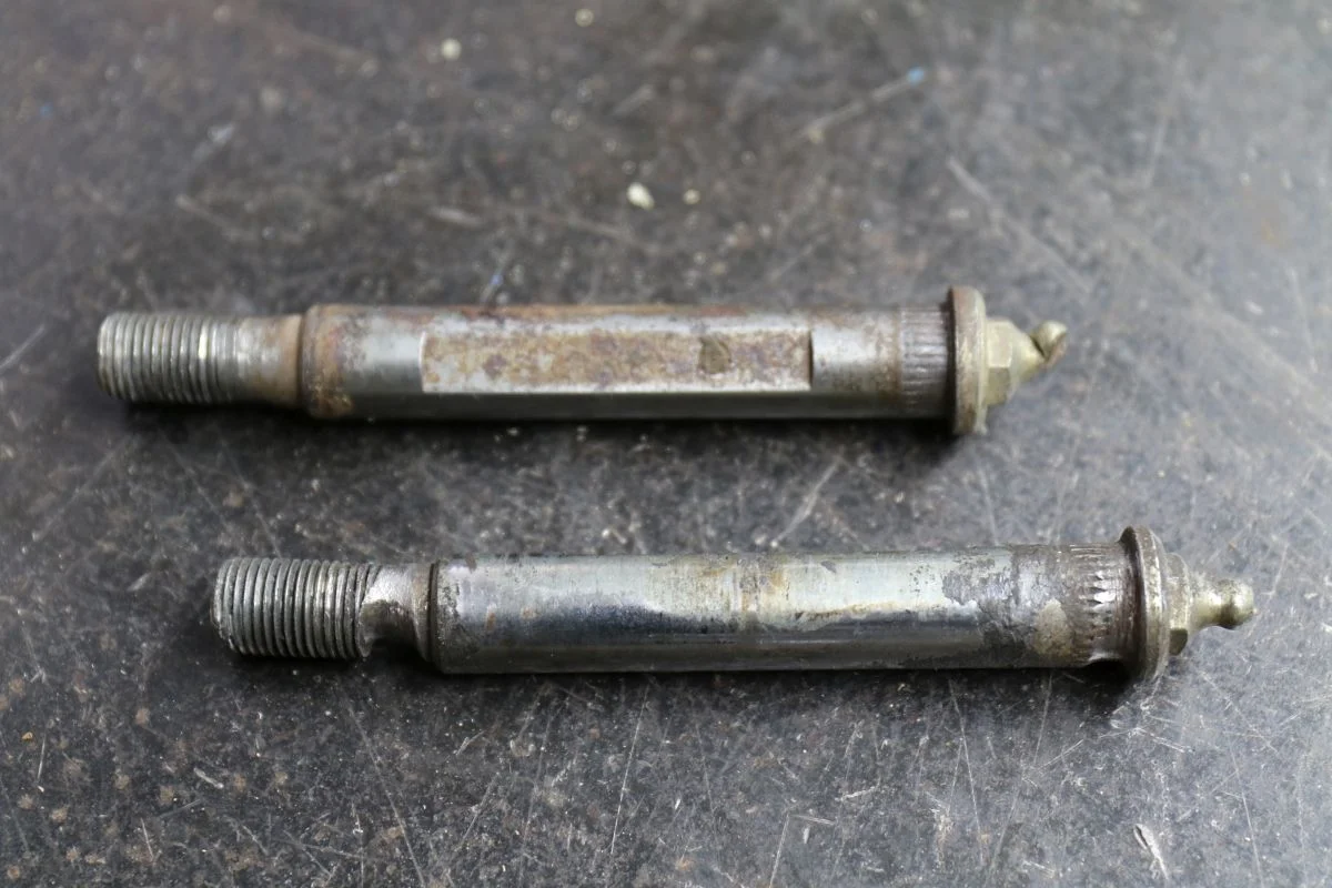

Replaced the front spring shackles.

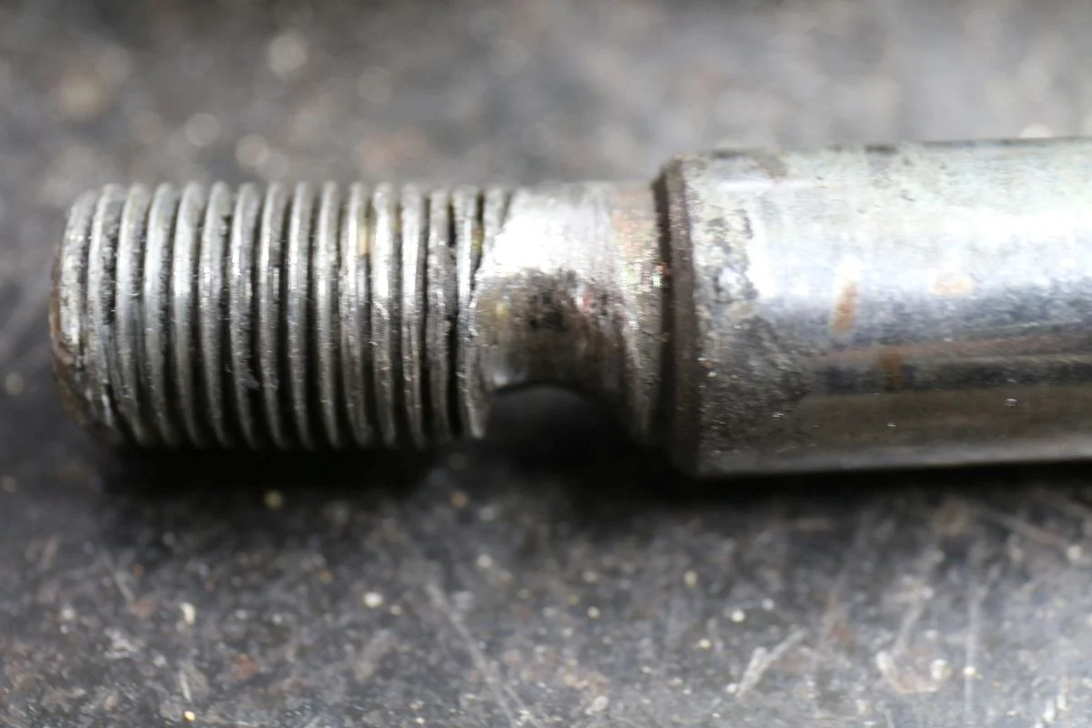

When I put the Skyjacker springs on I bought greasable shackle pins. A few months later Claudia had one of her greasable pins break out on the trail and I discovered that they were not the best choice.
They looked better than the 1971 vintage factory ones tho
The one pin has significant wear only a few years later - this is some seriously kr$ppy steel
1/3 has been worn off and this was going to break sometime soon (and probably at high speed or far into the boonies :skull:)
Got some new solid pin shackles from Kurt at Cruiser Outfitters Cruiser Outfitters

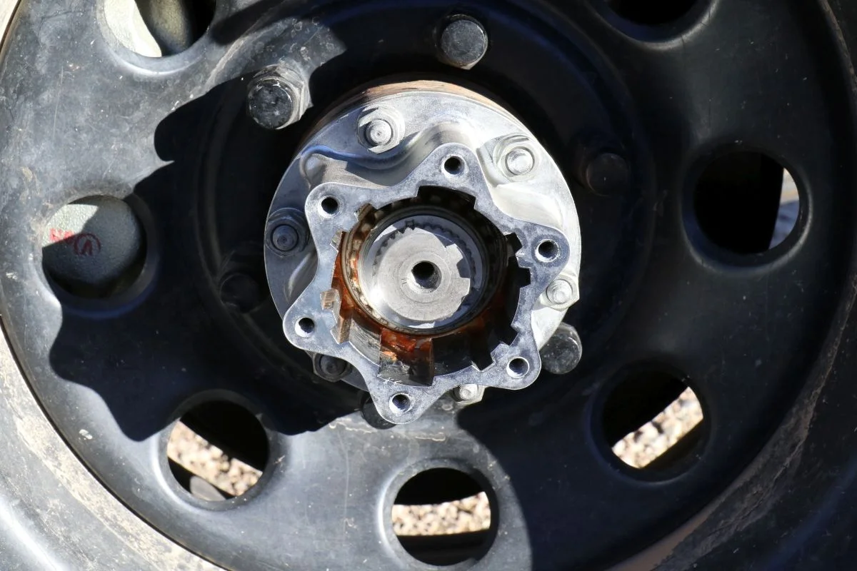

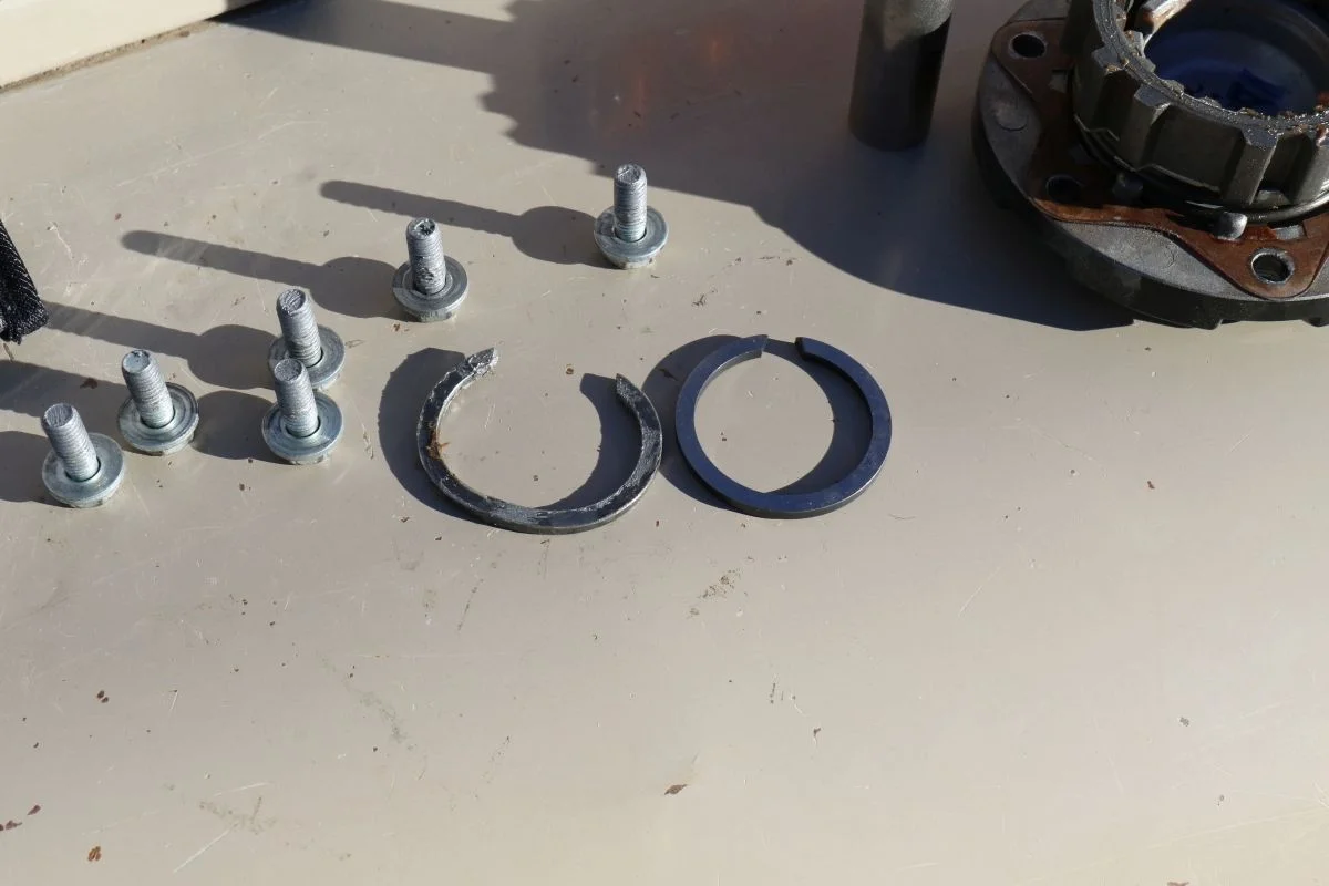

Did a pre-trail repair on the new Aisin locking hub I installed on the passenger side.
The Warn hub I replaced used a bolt in the end of the axle to keep it from drifting into the birf, but the Aisin uses a snap ring.
The only snap rings I had were for my old FJ40 axles, and they were too small to fit on the Longfield axles.
I managed to stretch one out enough to fit in the groove, but it was only making contact in three places - the two ends and the center.
@murf brought me the correct snap rings on his Rug Road ROTM, and I installed one while the group was airing down.
Thanks again @murf :clap:
The stretched ring on the left - correct on the right.
Snapped into place and ready for Rug Road!

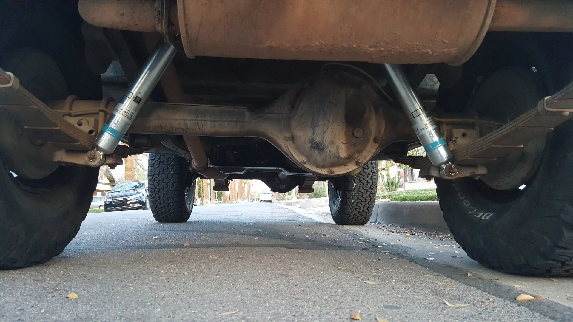

New (used) 33" BFG Rubber, New Bilstien shocks, New Side View Mirrors, New wheels with center caps
*Special thanks to Murph, Camelback Toyota, FTBshop, Firestone Auto Care, Jacks Alignment, Fat Bobs Garage.com

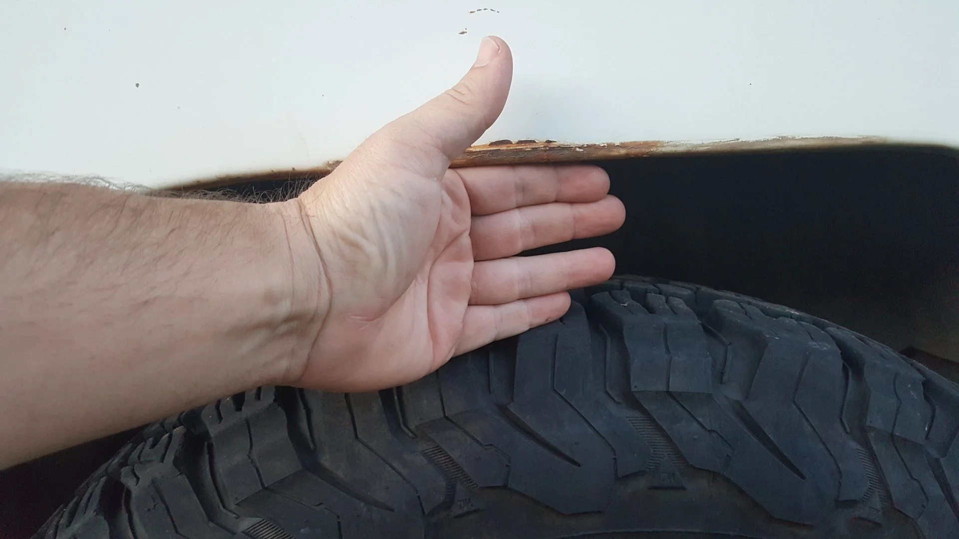

The new KO2 tire seems a good bit wider in the tread that the previous KO version. Being wider, and this cruiser sitting lower than my previous, I need to test the rear tuck to see if it will rub on the fender opening. The tire/fender gap is about 1.5" smaller than my previous Fj40. These are my second time installing the bilstien are they are great. Now with a quieter ride the window glass rattling is driving me nuts. New window felt is next!

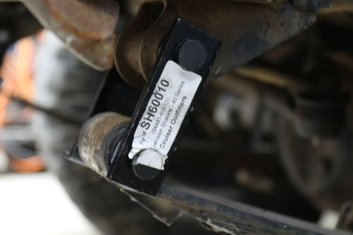

Kurt's spring pins have held up much better than the greasable - but I still managed to mangle two of them :hillbilly: or maybe three, I don't remember :rolleyes:

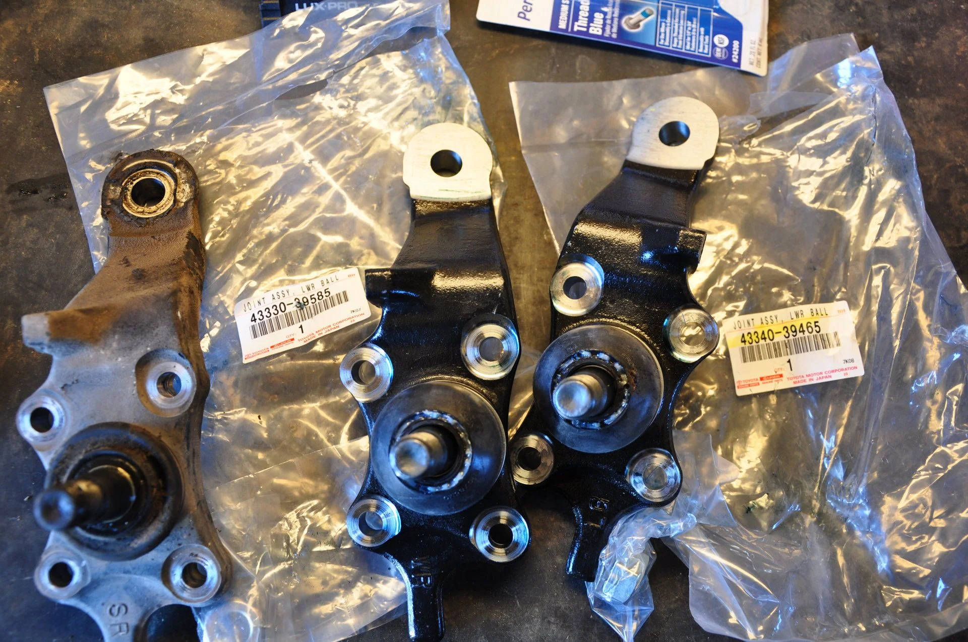

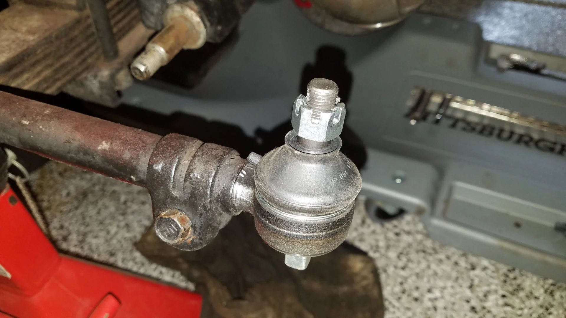

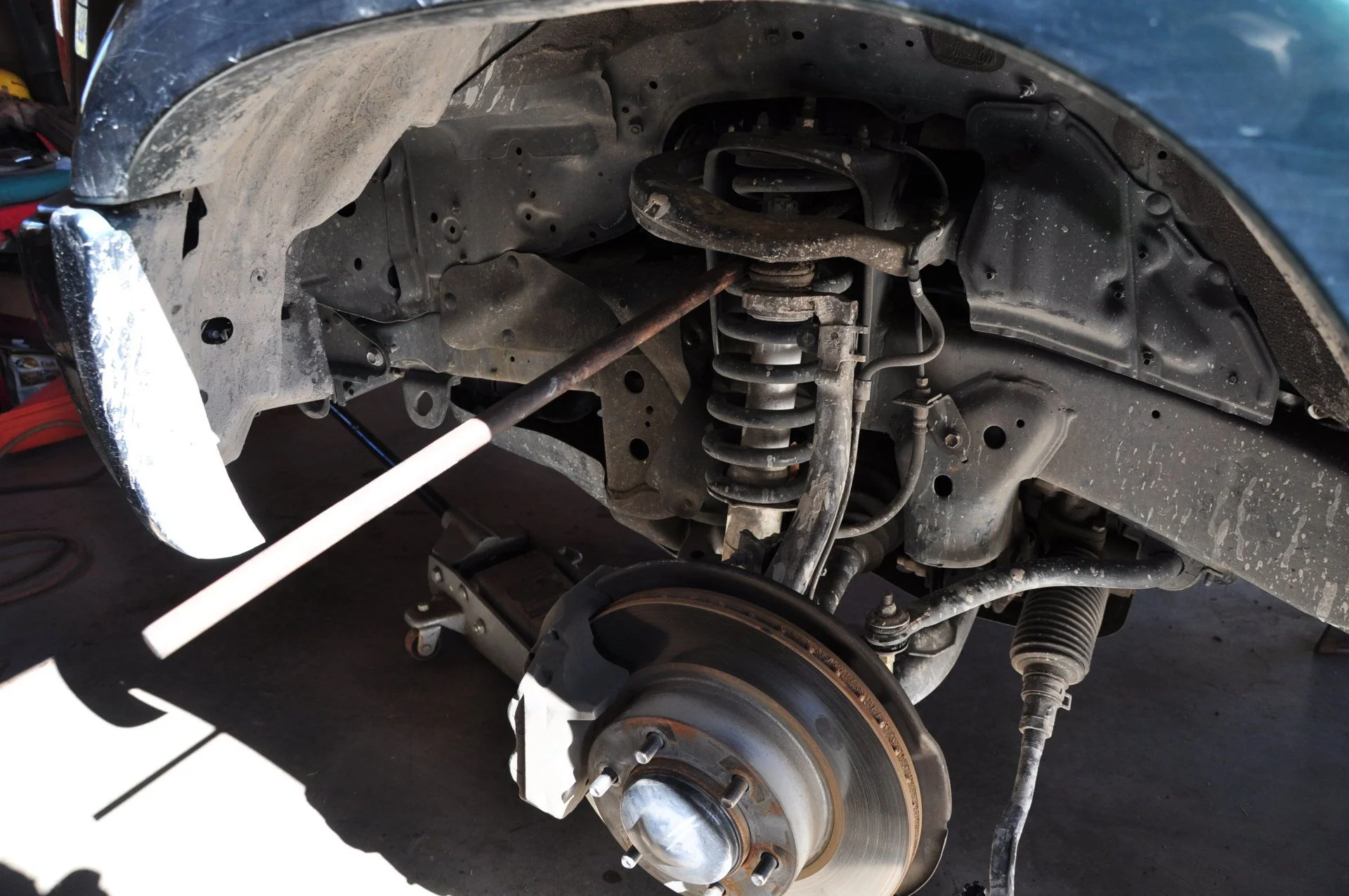

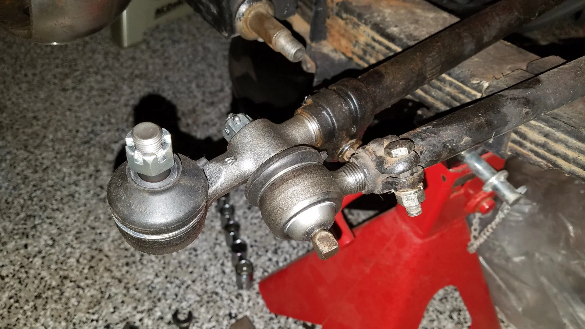

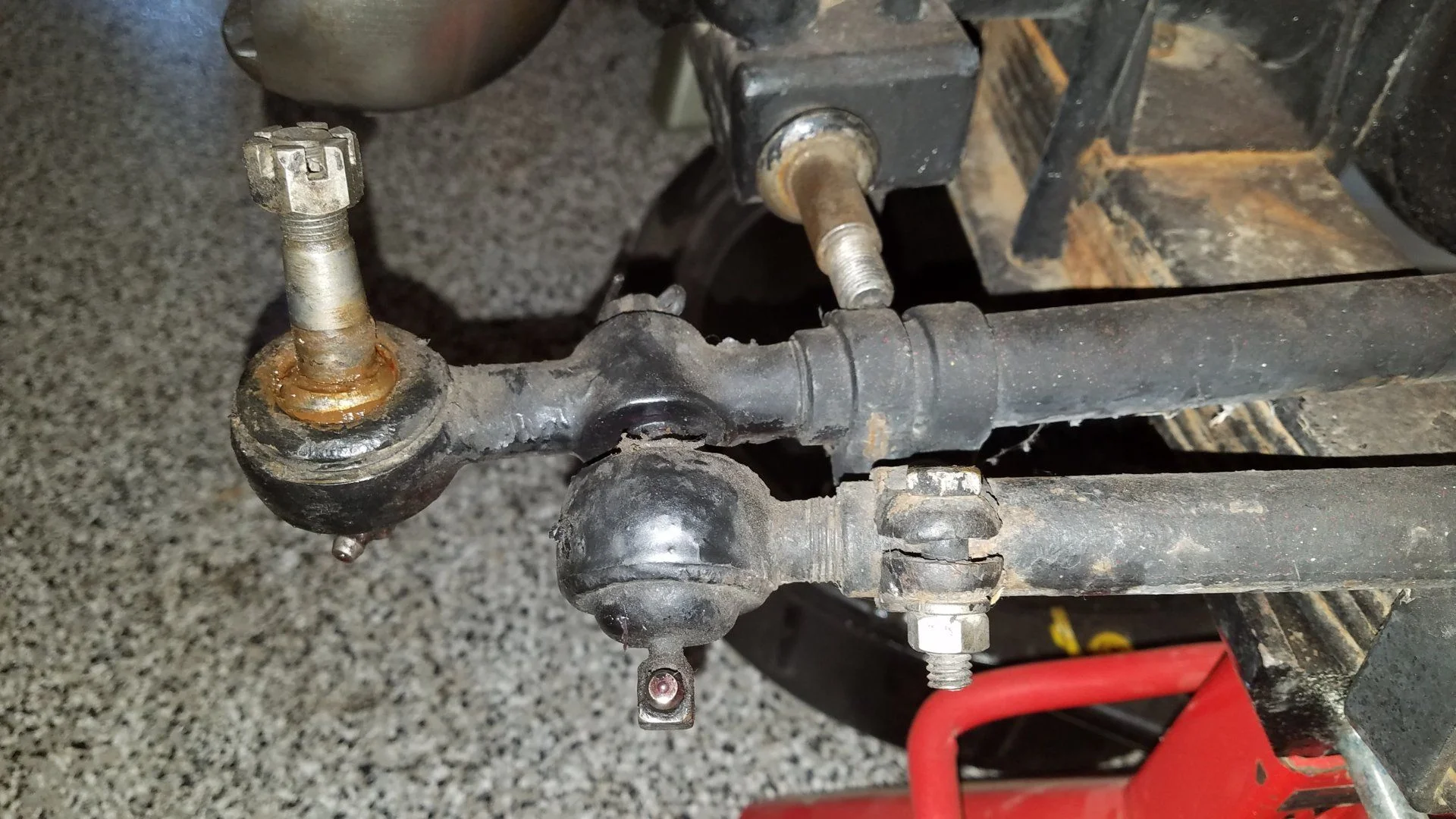

Insurance after reading all the horror stories about 3rd gen LBJ's. Inexpensive piece of mind if you ask me to a vehicle with over 200k that I have no clue if this was ever done. Old ones seemed to be tight, but the tires were showing some cupping on the inside...
Easy job with proper jack stand/jack placement, a BFH, and pry bar placement.

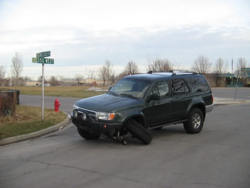

One less thing to worry about is this;
Huge difference and highly recommended to everyone to tighten up your front end. I remember it years ago on the 40, and now appreciate the minor work involved to improve the handling on a Runner.

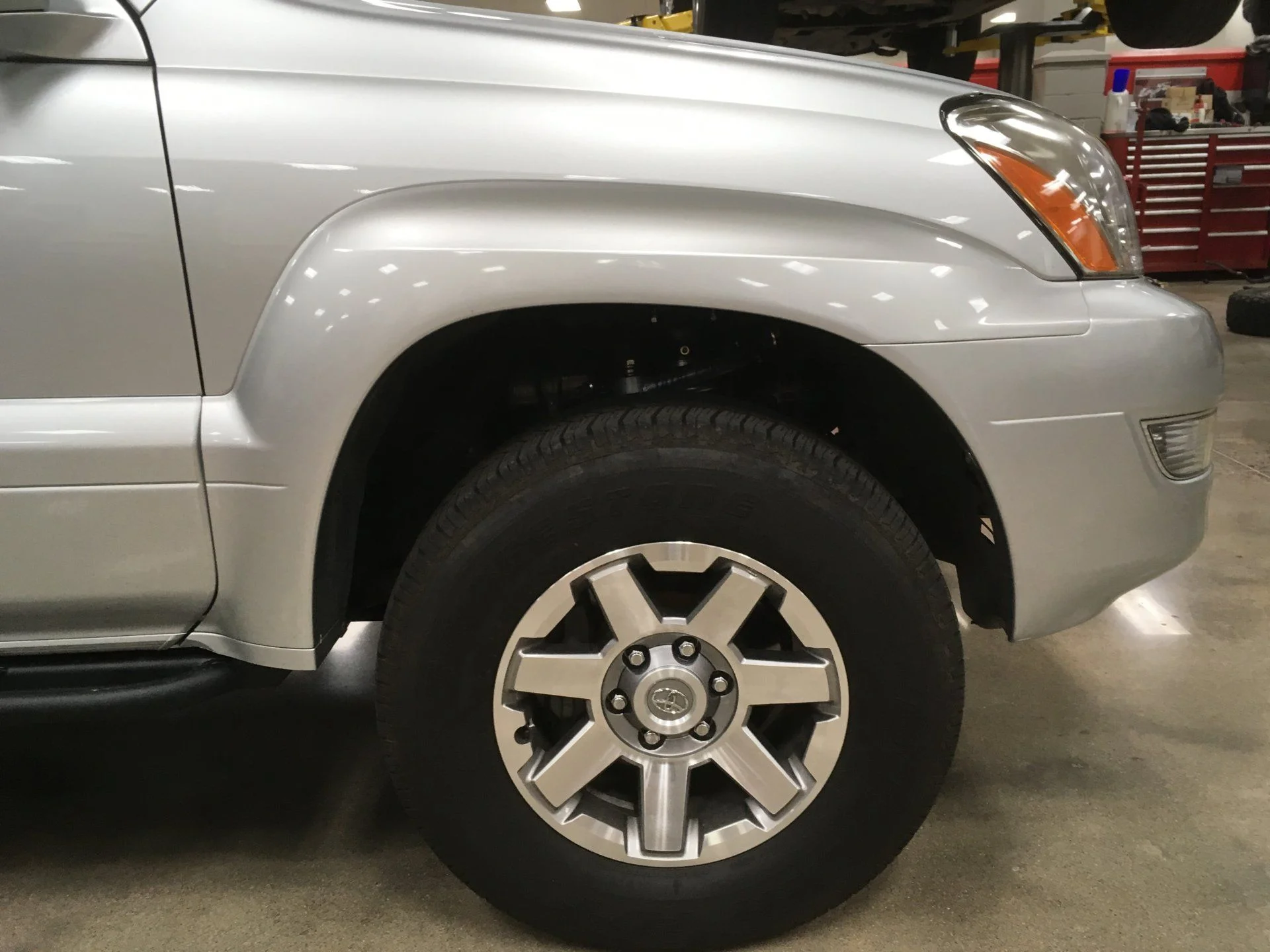

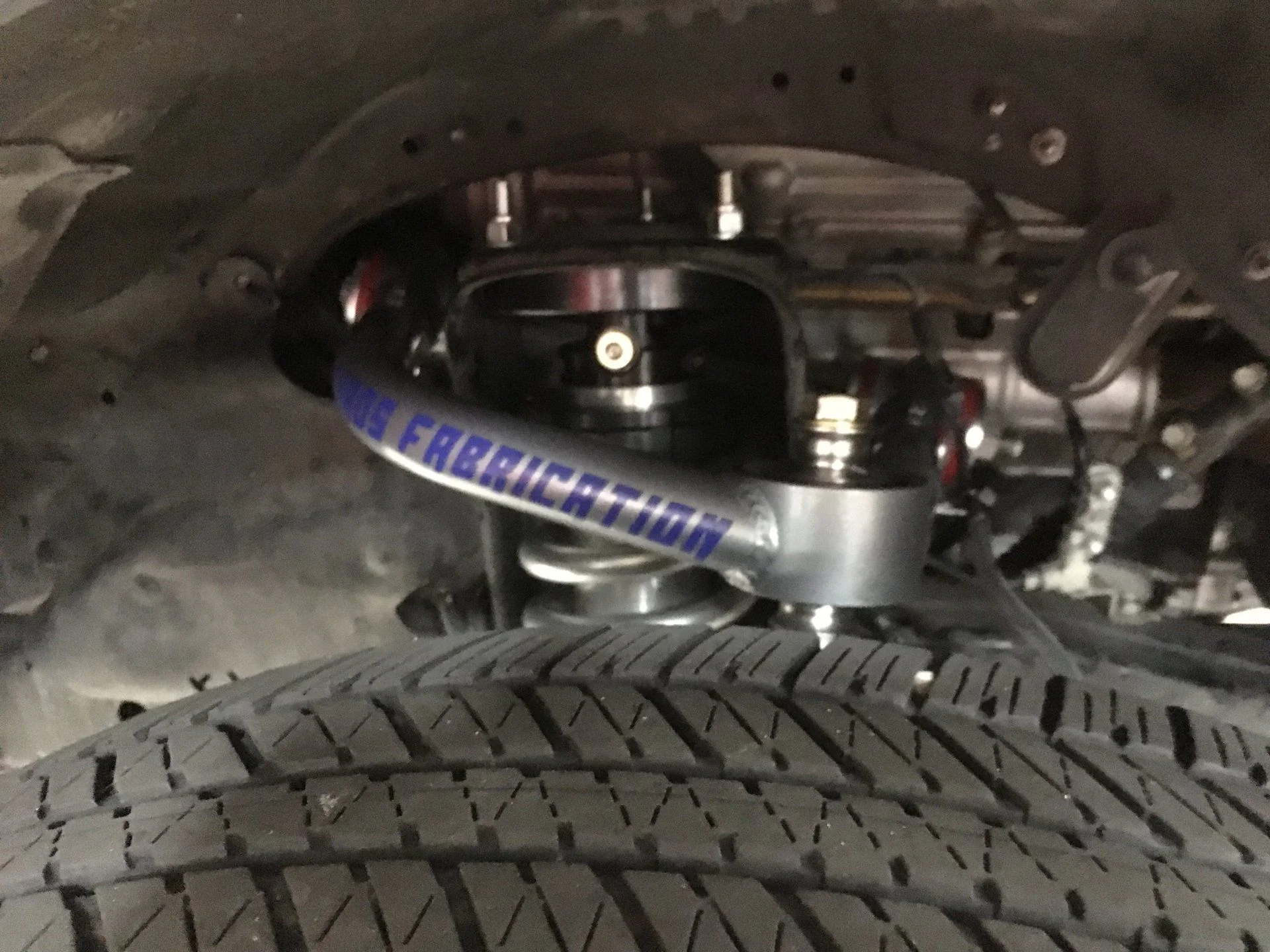

I lifted my 2007 GX 470 sport with KDSS with Radflo 2.5 coilovers ,TC UCA on stock trail wheels.
Full skids and sliders plan on running 32" KO2 tires.

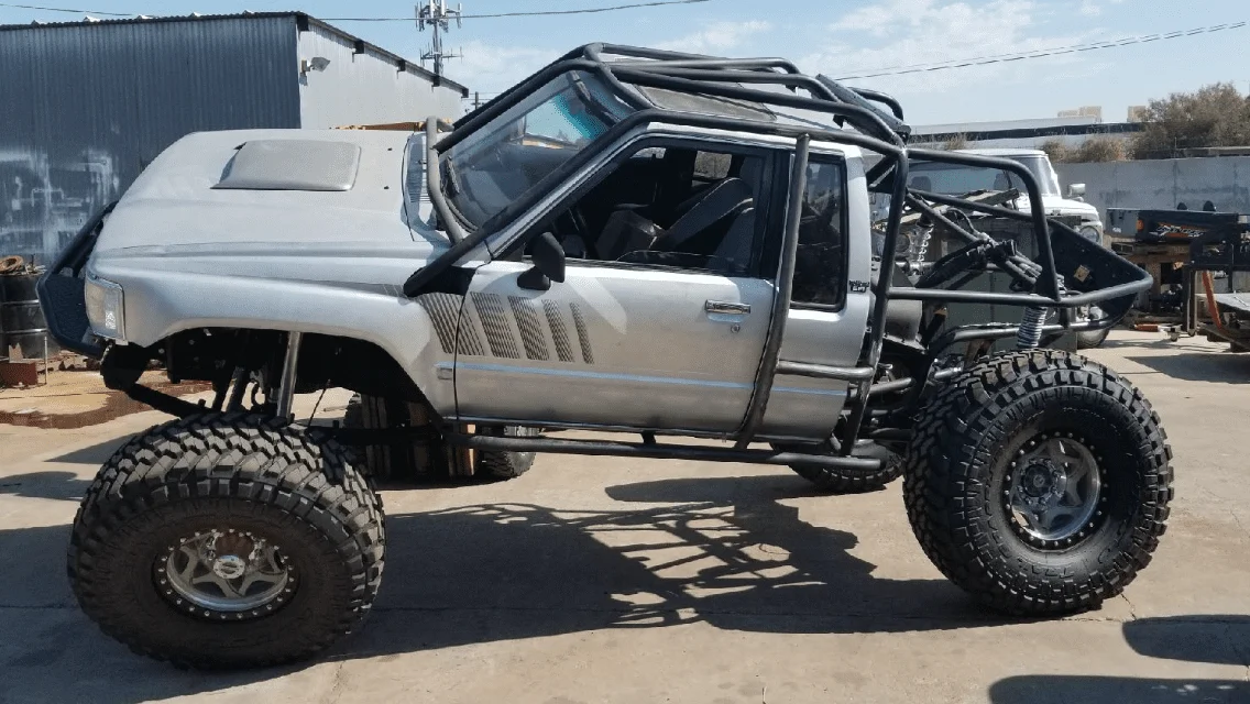

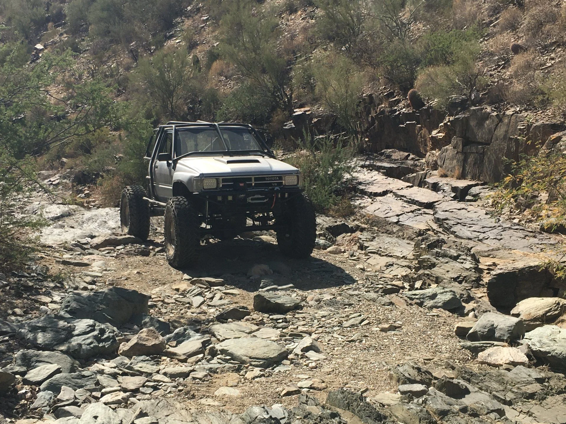

I have also been building my 1988 toyota 3.4 swap Truggy on narrowed 1 ton axles , 40" tires it is ready for a good shake down run!

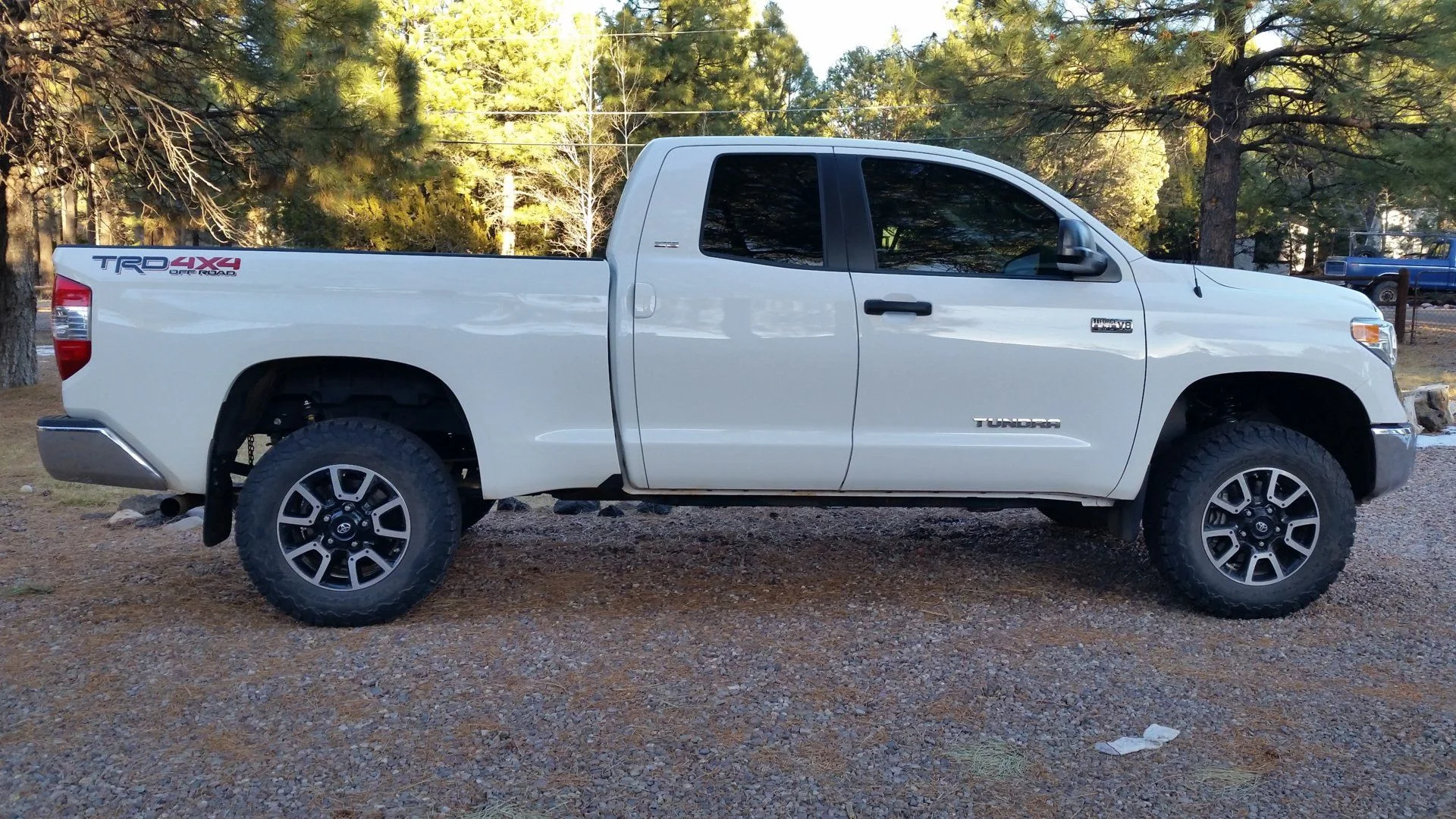

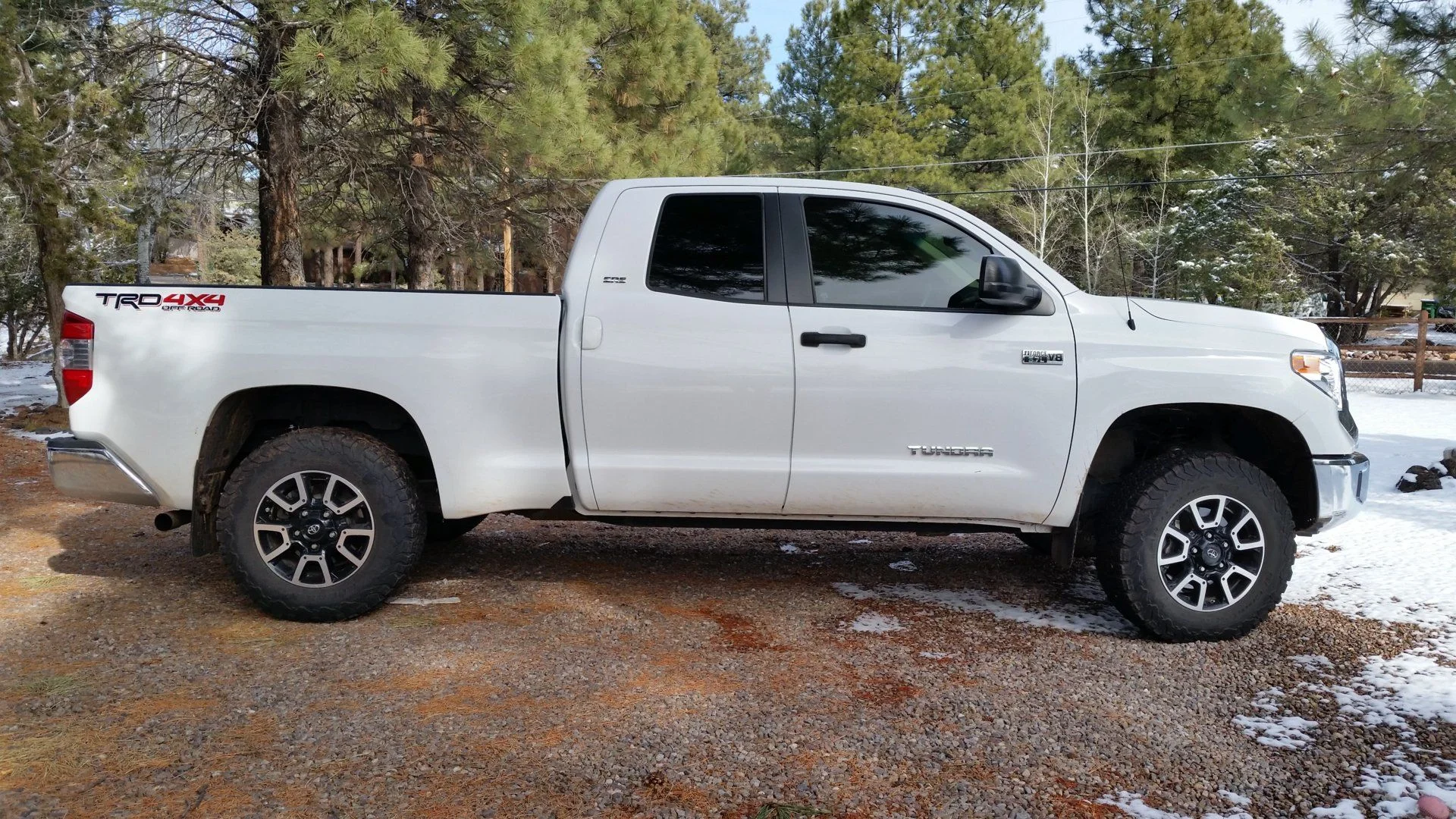

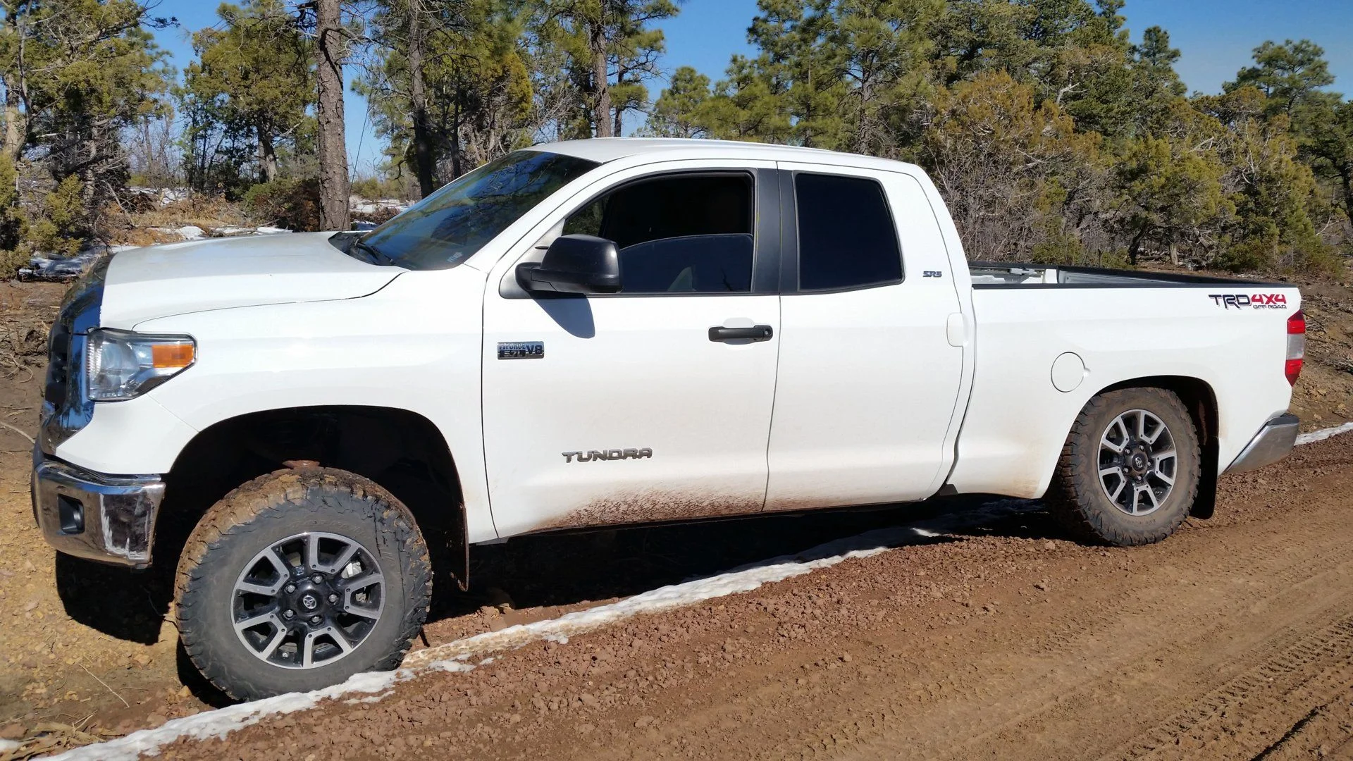

Finished up OME lift on my Tundra, full spring pack in back, ride is greatly improved over the stock springs. 1st picture is after rear springs.
