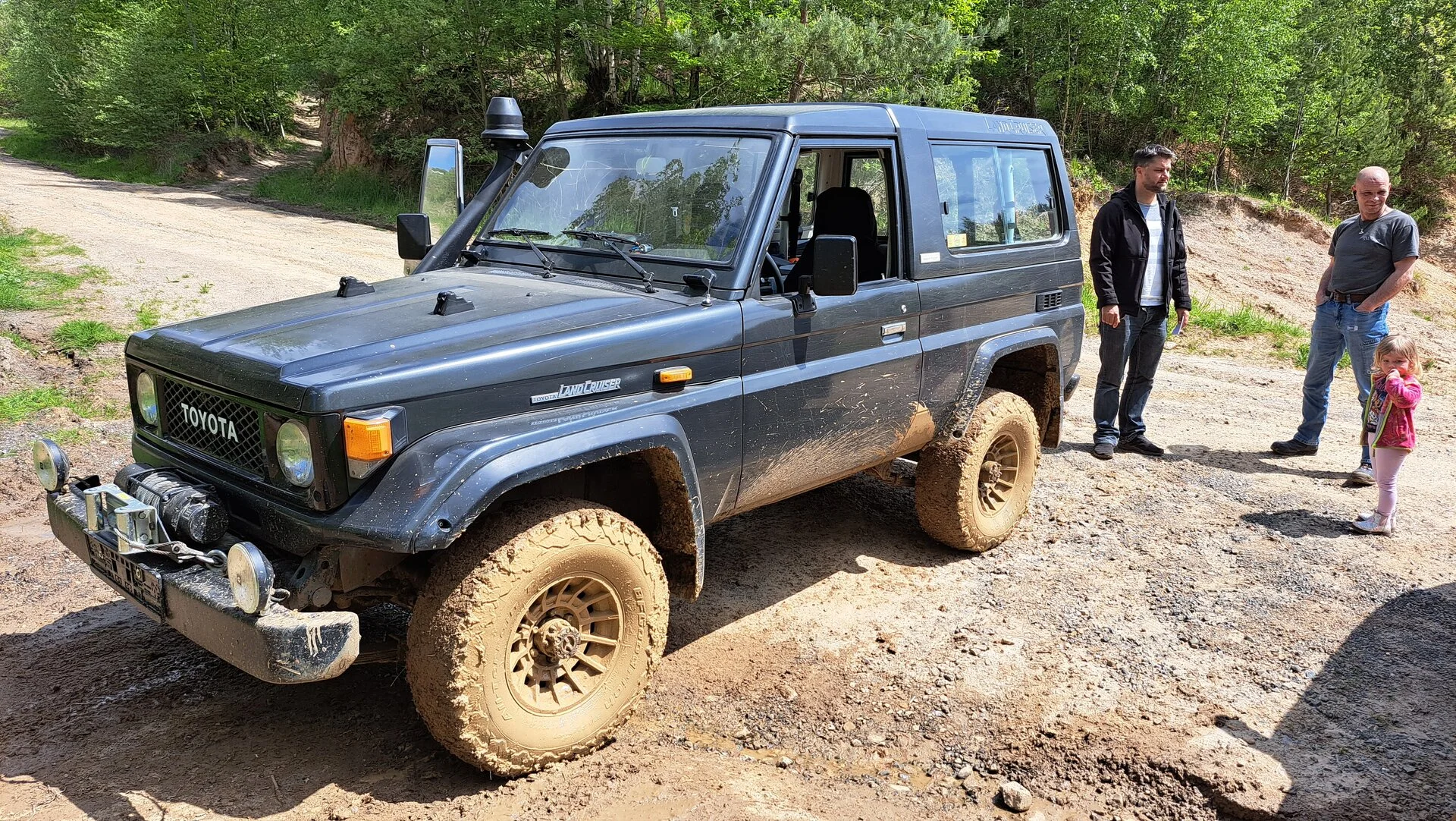

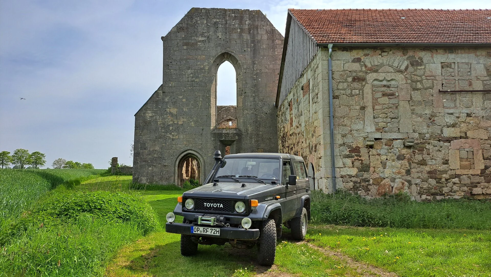

We had a public holiday in Germany on Thursday. I made an extended weekend from it and took the Cruiser for some fun.
Had a nice camp spot next to a pond and a retired tram.
Got the Cruiser dirty... Great offroading at Böser Wolf offroadpark. (It will take a few more flushes to get the mud cleaned out 😁).
Then visited a few places I'm interested in:
Old buildings and old mines.
This monastery was founded 1591.
I visited two closed mines.
This one was a lead and zinc mine. It was started around the 14. Century and closed 1974. A very small part is now a museum (2%). 90% are flooded. This was a rare chance to get into some of the abandoned and usually sealed areas.

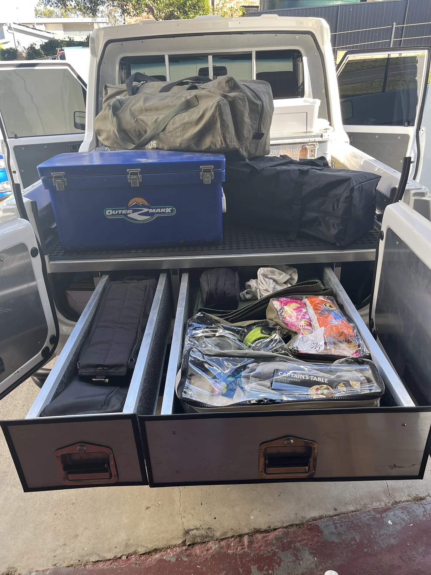

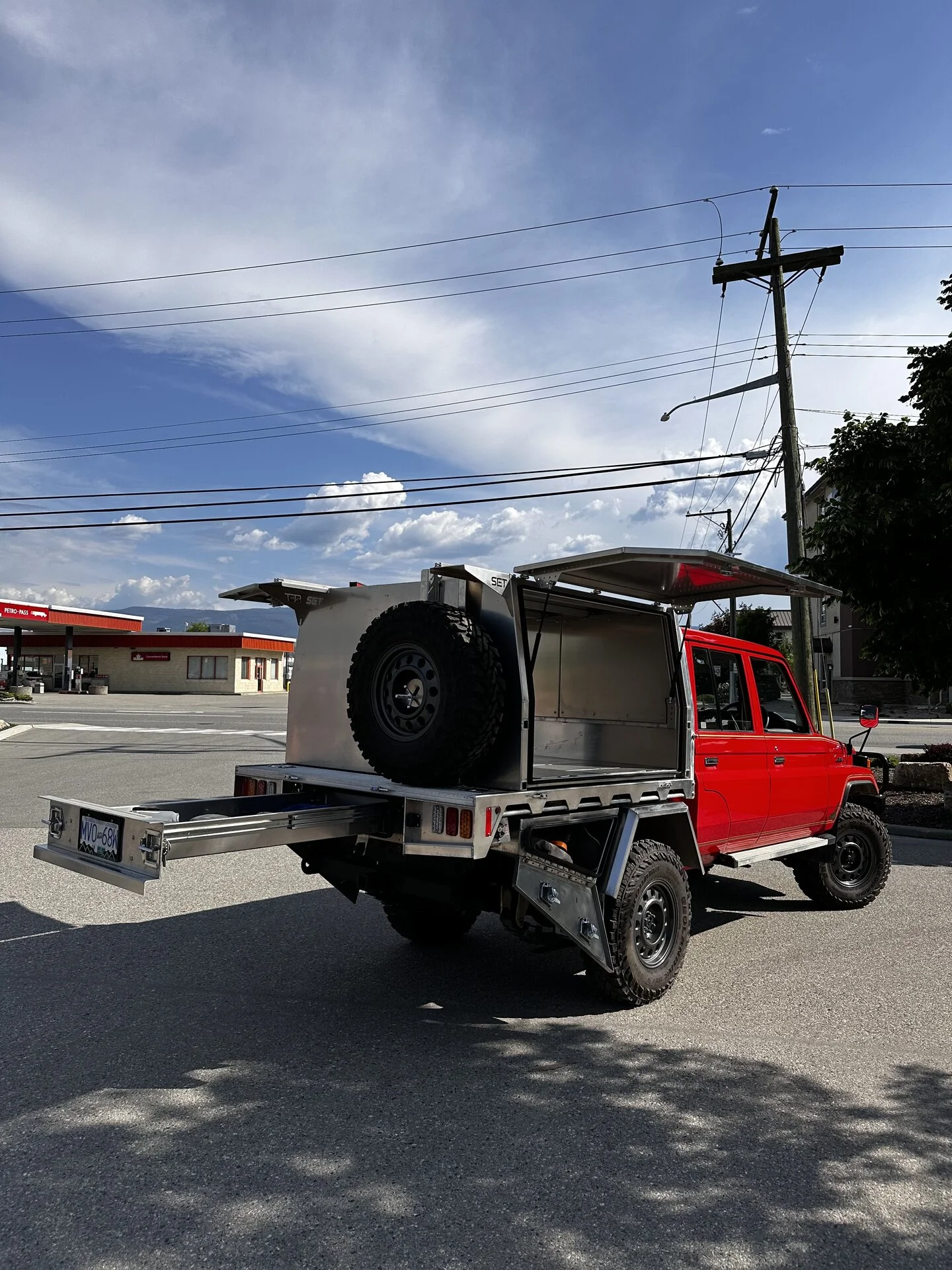

Another trip done and dusted. Went over the range again to minus 2 nights. Tested the new rear drawer setup to see if I could fit most of the stuff I had in the big Aluminium toolbox I used to carry on back, and with some canvas bags it all fitted. All the recovery gear is in the left drawer so I don’t have to open tyre carrier to get to. Going to work on a small roof rack next.
