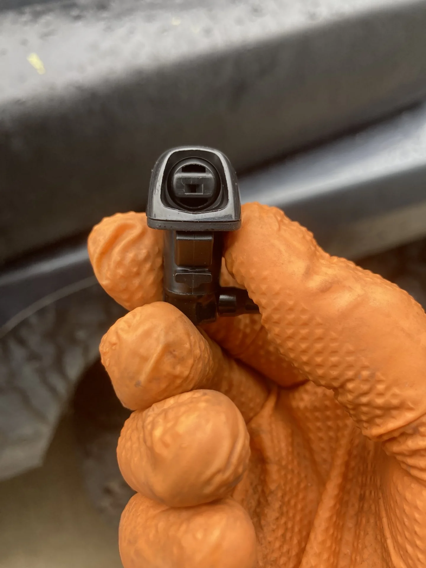

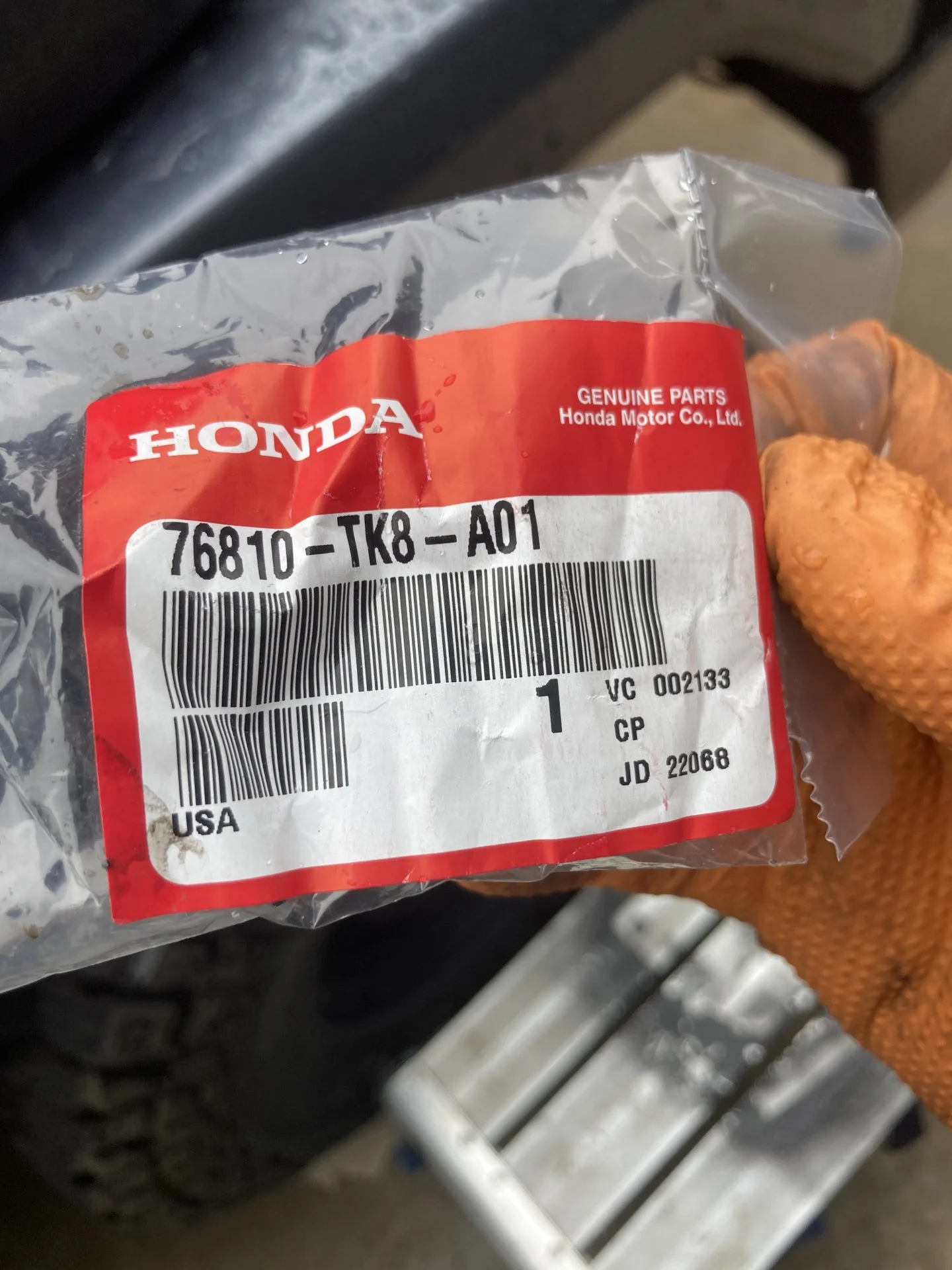

Perhaps an act of blasphemy but I installed Honda washer nozzles onto my 70 this after noon. The stock hood holes have to be opened up into slightly longer and wider ovals, but the new spray pattern is way nicer and more modern than the two-stream deal. plus the new nozzles can be adjusted for height to get them right at the perfect spot on the windshield
Got the idea from an Instagram post. Apparently this is a pop in and go mod on a 1st gen tacoma, no modifying the hood holes.
For the Toyota OEM purist Witsend sells an upgrade kit for the 80 series and they're a straight drop in for the 70 series. I believe they're Rav4 3 jet nozzles. I really like mine. I did need to reroute some hose but had to replace it anyways.
