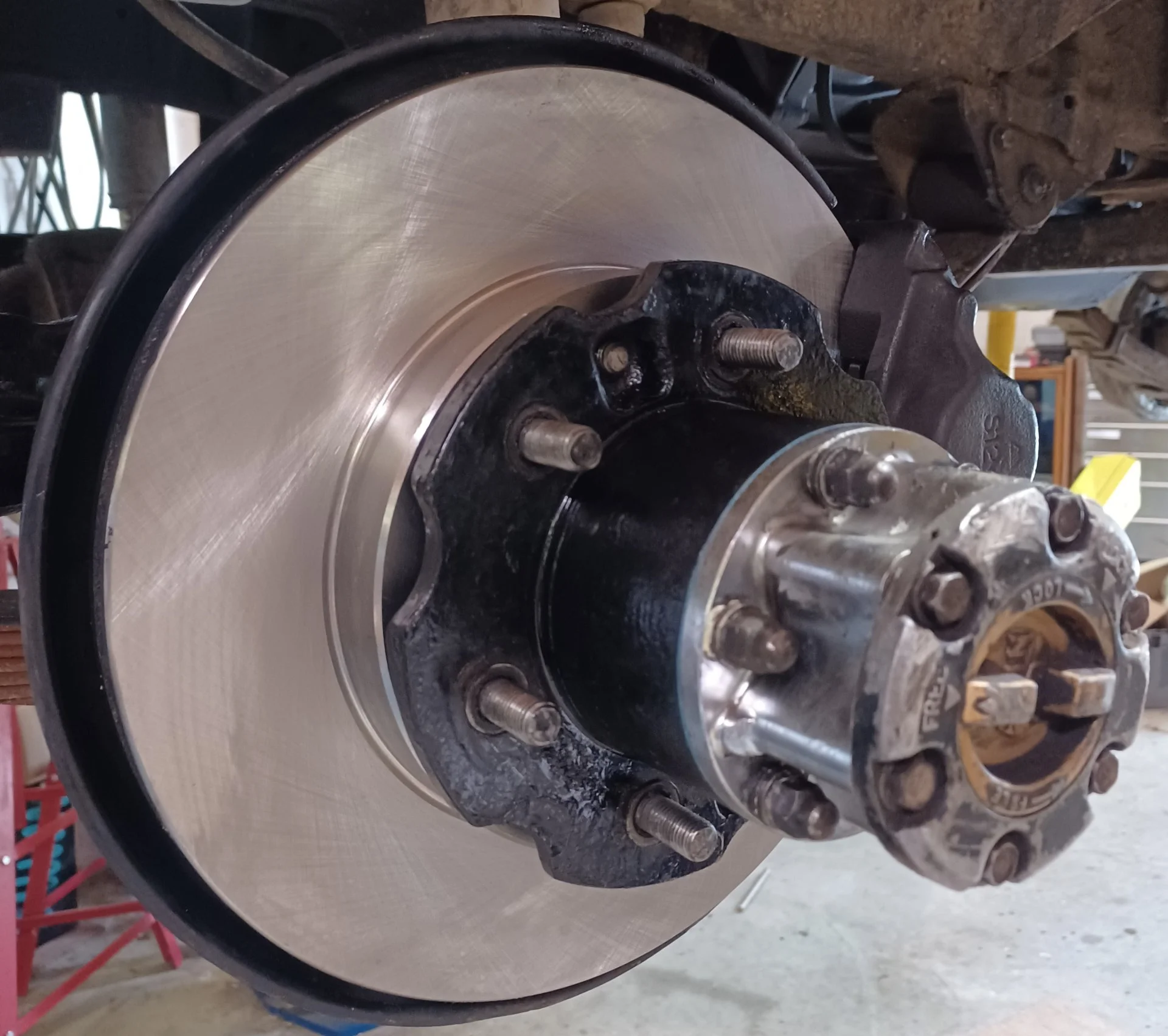

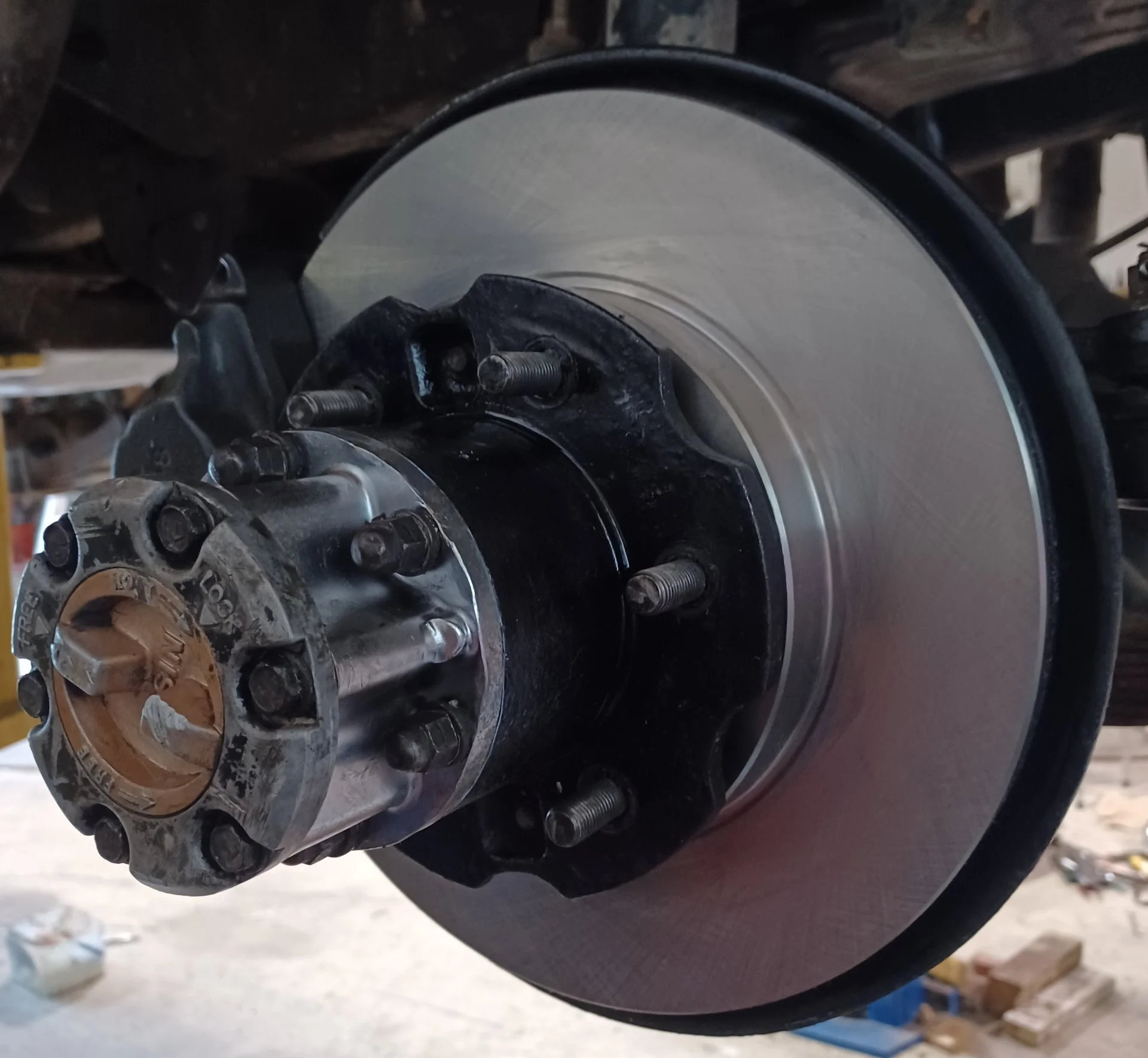

Full knuckle maintenance on the BJ70 [all seals and bearings plus new rotors/pads]
Started Saturday afternoon and finished earlier this afternoon. Clearly, too slow to pretend that I saved any money.
Kit was from Cruiser Outfitters. Very impressive kit - exacting fit on every part and complete (not just typical seals/gaskets in a knuckle kit, but every bearing, every race, star lock, grease seal and oil seal were included. The only things I added were the rotors and pads. Kudos and thanks to Cruiser Outfitters

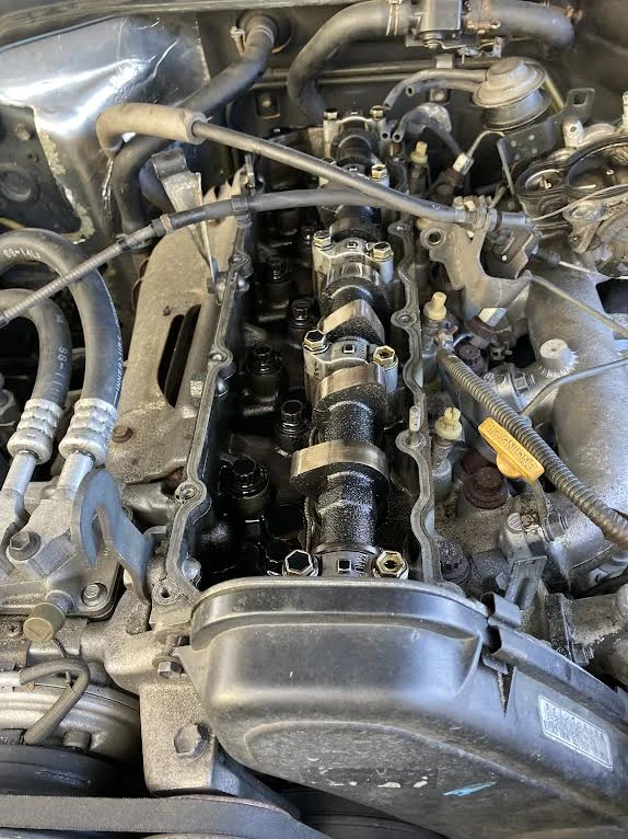

Replaced the valve cover gasket and put a new 76 C tstat in my kzj78. I was amazed at how clean everything was under the valve cover. The 3fe fj80 I had before was much more dirty under the valve cover than this thing

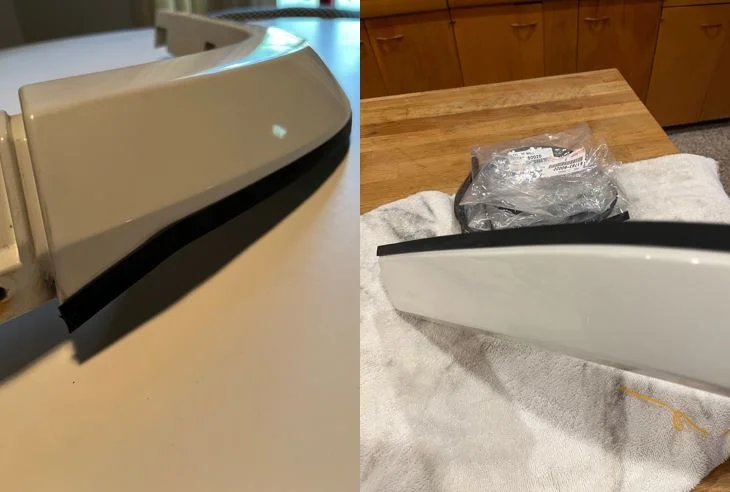

Spent part of the day installing the new rubber seals that goes between the OEM flare and body after I got the rest of the flares cleaned up with old rubber removed. Not too hard but the rubber seal was kinda tricky around the corners. No more dry cracked rubber that will let water go in.

Some of the rubber seals I used on the flares today are no longer available on partsouq and also shows sold out on other usual platforms including ebay (for the rear sections p/n: 6178360020 or 6178460020). Thankfully I had gotten them last year. I wanted to get extras and can't find them anywhere (Haven't tried Dave yet).
Bad news for anyone with a 76/77 or 78 prado with flares needing to replace the rear flare rubbers except you can cheat and use 5385190K0001 (which is for the front flares) and just trim it. It is the same thing but just longer.

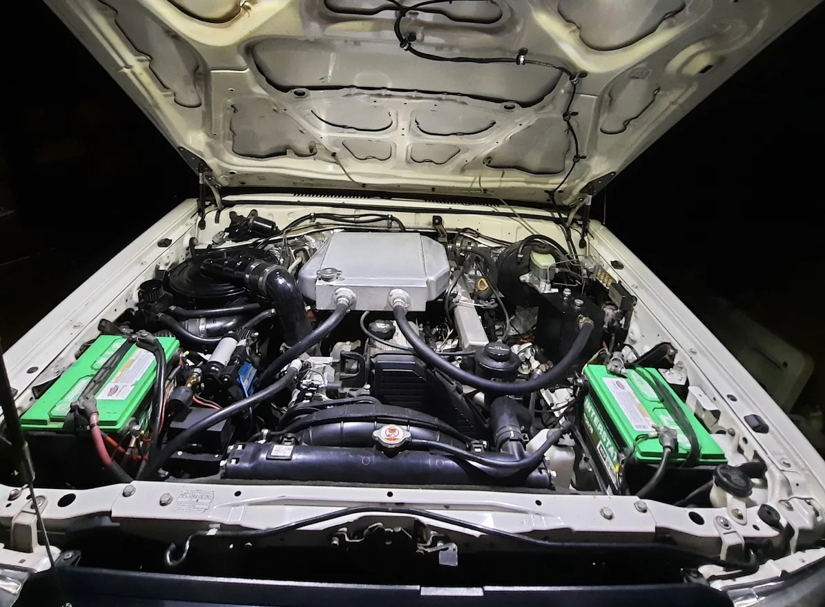

Added some under-hood lighting. 😊

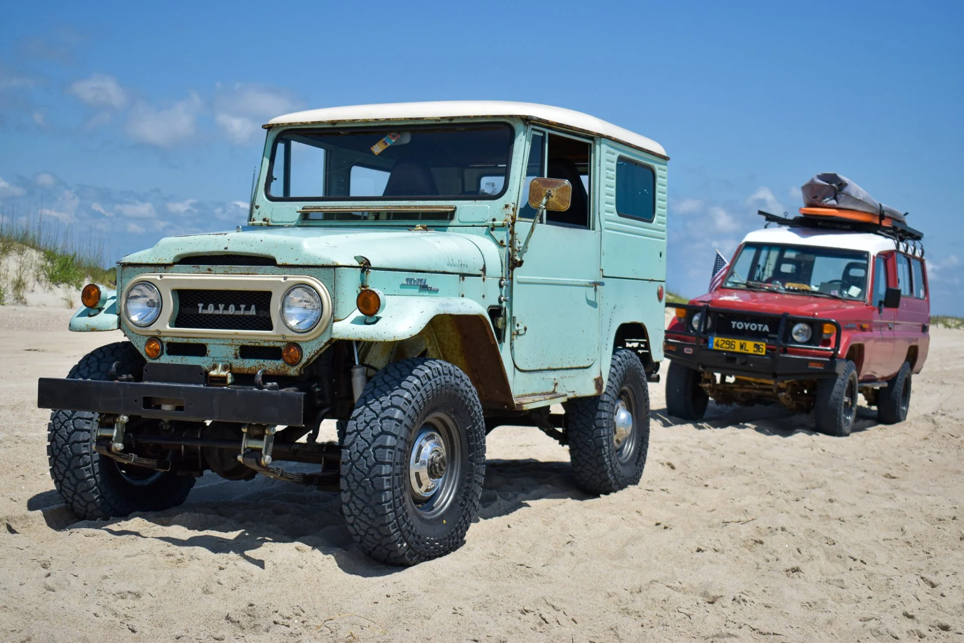

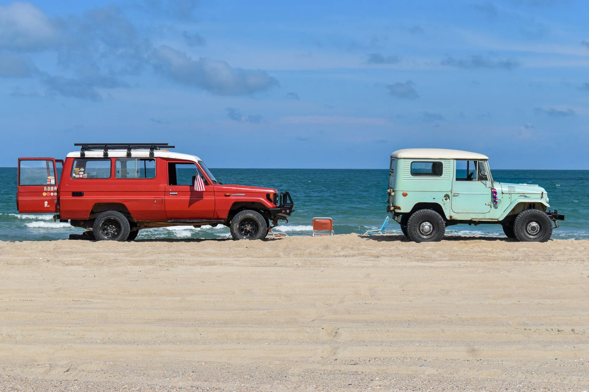

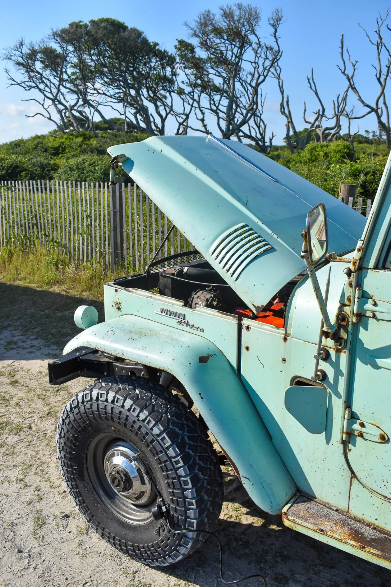

Got our 40 running well and finally braking. Took to for a beach cruise with the troopy cause if anything is wrong with a car, the sand will bring it to the surface. Only issue was it got a bit hot, like 210f, we need to put a shroud around the fan and it should be fine after that. I just finished putting an aussie locker in the front of the troopy and its a game-changer... even on sand! I was surprised at how much it helps just for driving on the beach, can't wait to test it out at Moab this summer.
If it's been sitting a while, double check that the t-stat isn't stuck and is operating.

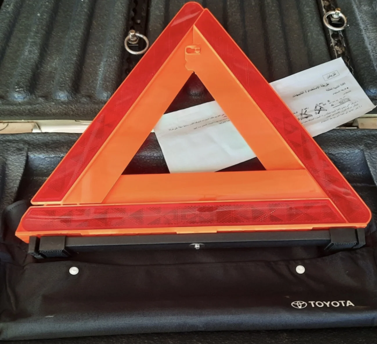

In case I happen upon a disabled Jeep. 😊

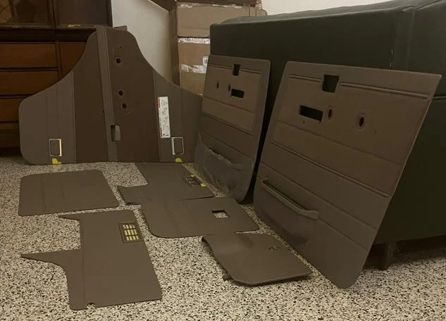

I was trying to get some plain cards for the 77 to use sometime down the road. I thought I got a grey set but they are brown which I suspected before they arrived when I looked at the pictures closer. :bang: These are new take offs off some 2021 GRJ76, one still has plastic around the bottom and they do all look brand new. Toyota makes it very hard to order new grey ones the way you want them...they either show up not available or blocked for overseas sale.
oh well....will keep looking for a grey set.
@FJ73Texas ! I need to do this job, if you don't mind, where did you get replacement seals and how hard of a job is it?
Thanks
I realize these aren't OEM and not 70-series specific, but I used these on our 80 series flares and they worked well. Think they'd work on the 7* flare as well?
