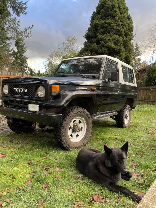

Large dog with wires.
One of the problems with having a truck that was right hand drive, then swapped to left-handed drive, then 1HDT converted is that none of the damn wires are correct. Trying desperately to find the AC trigger wire and blow some cold air in the Texas heat.

I also get judged by a large dog when I work on my truck. Maybe its a Shepard thing, and they want to corral you away from the project for your own sanity's sake.

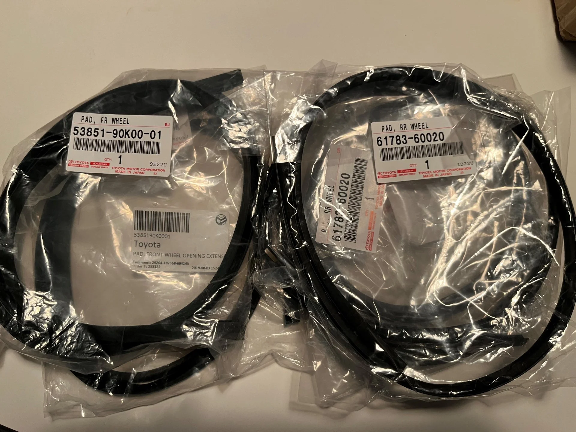

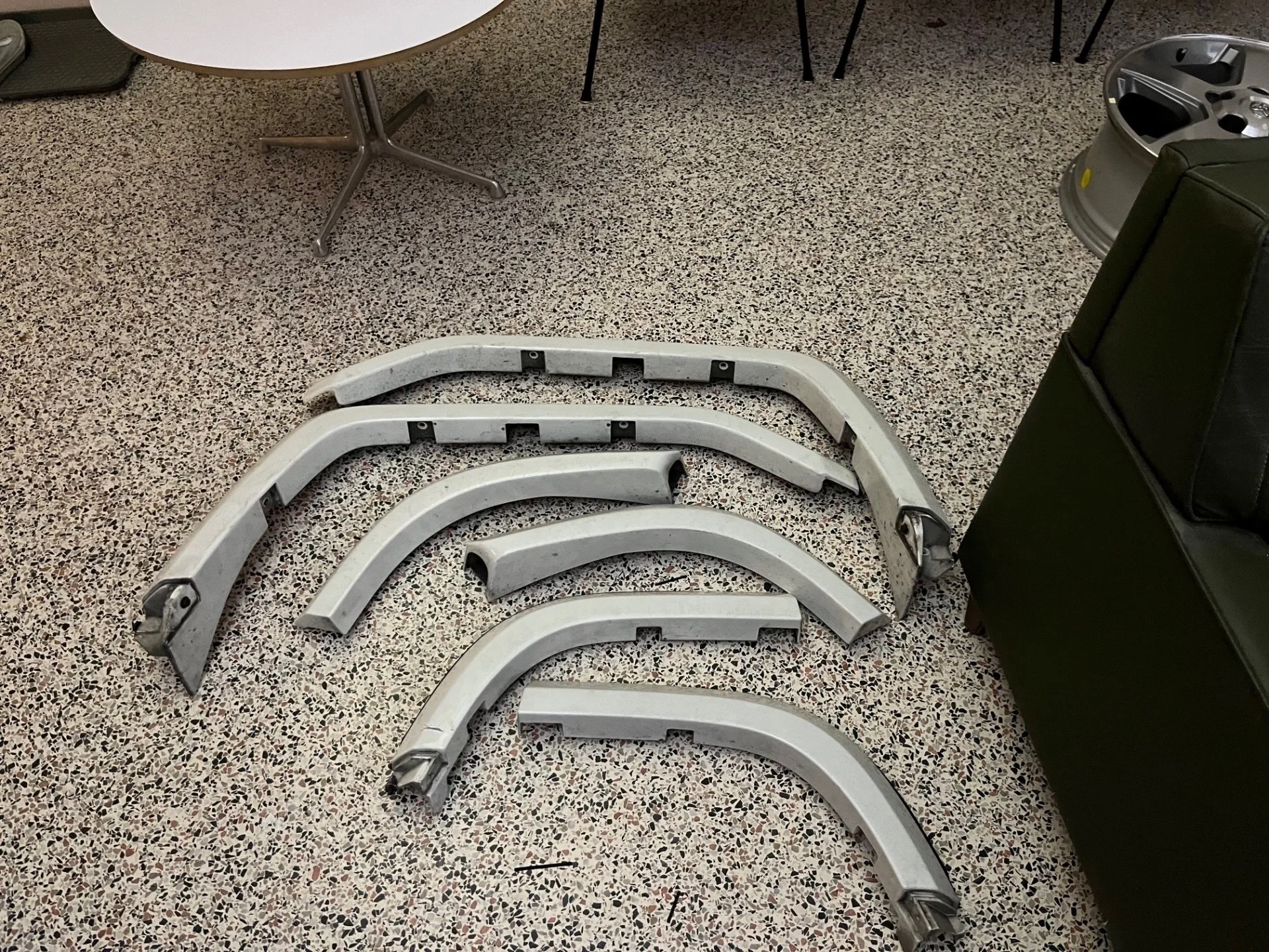

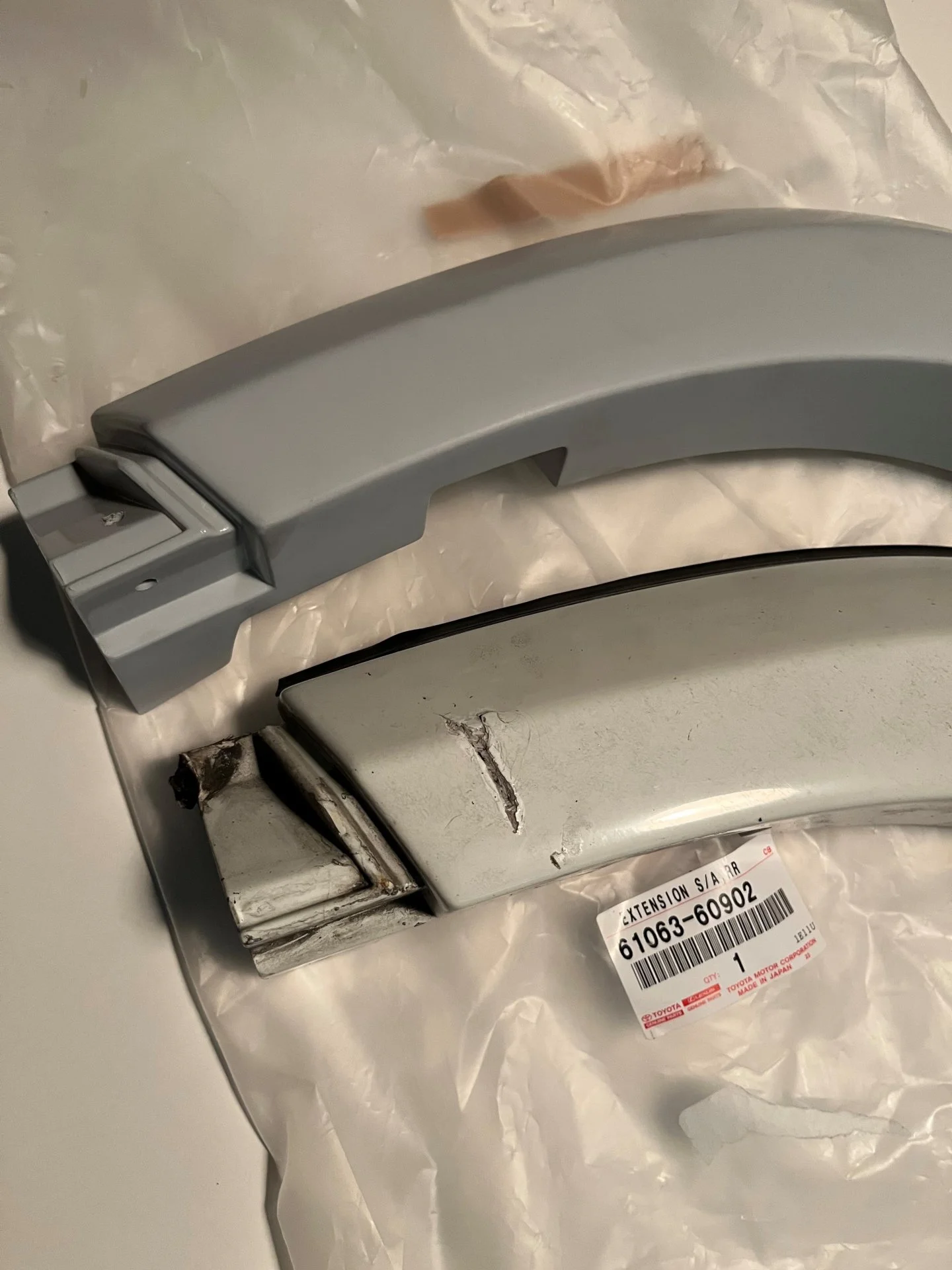

I spent some time this afternoon removing all of the OEM flares because 1) the rubber between the flare and body is dry and cracked and 2) I have a new right rear end piece (that I have had awhile) that needs to be painted and installed to replace the one that was damaged before I owned the truck.
I was afraid there would be rust under these flares but I didn't see any rust at all on any of the panels. Just really dirty so some cleaning is needed before I button everything back up at a later date. The random rivets vs. bolts at different attachment point that secures the flares to the brackets was super annoying (not talking about the rivets from the bracket to the body as the brackets are being left untouched and in place)
...it will only be M6X1.0 bolts when everything goes back on.
New flare piece vs. damaged piece. New piece is unpainted still. Not sure how I will get this painted properly but I will figure it out. I am not driving the cruiser anyways due to diesel prices so the downtime is fine.
Dry rotted rubber and new rubber.
