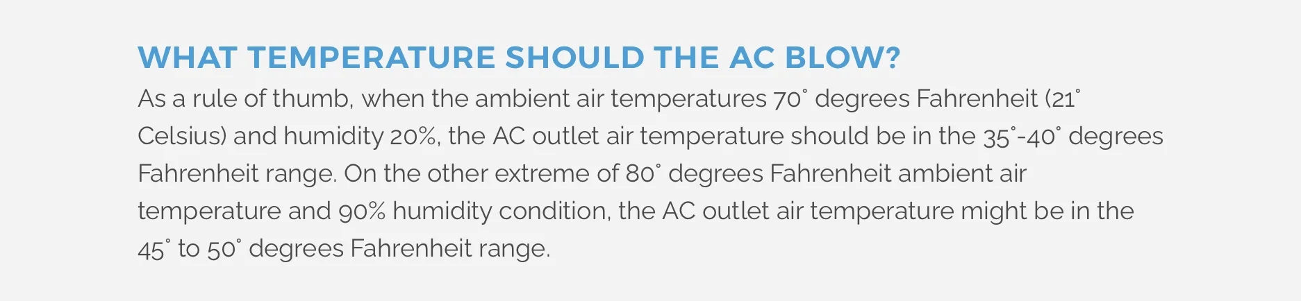

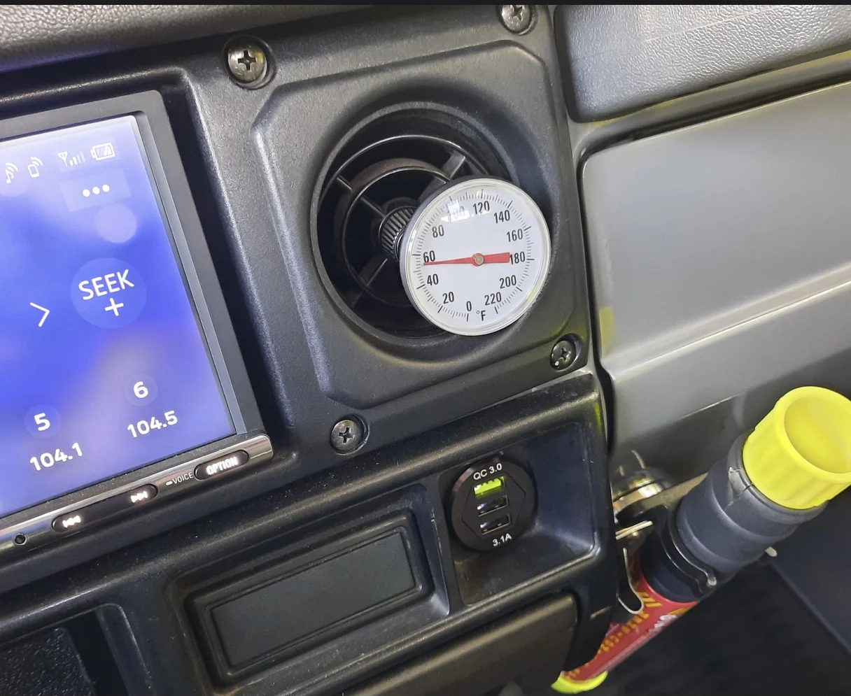

My truck was not original built with a/c which was a non-starter once it ended up in Southwest Georgia. Factory a/c has since been added and Summer has arrived with a vengeance in the Deep South. I’m pleased with the results. The vent temps dropped rapidly and settled in between 48 & 50 degrees (F) with outside temps in the 90’s. Based on what I’ve read the vent temps seem fairly normal.

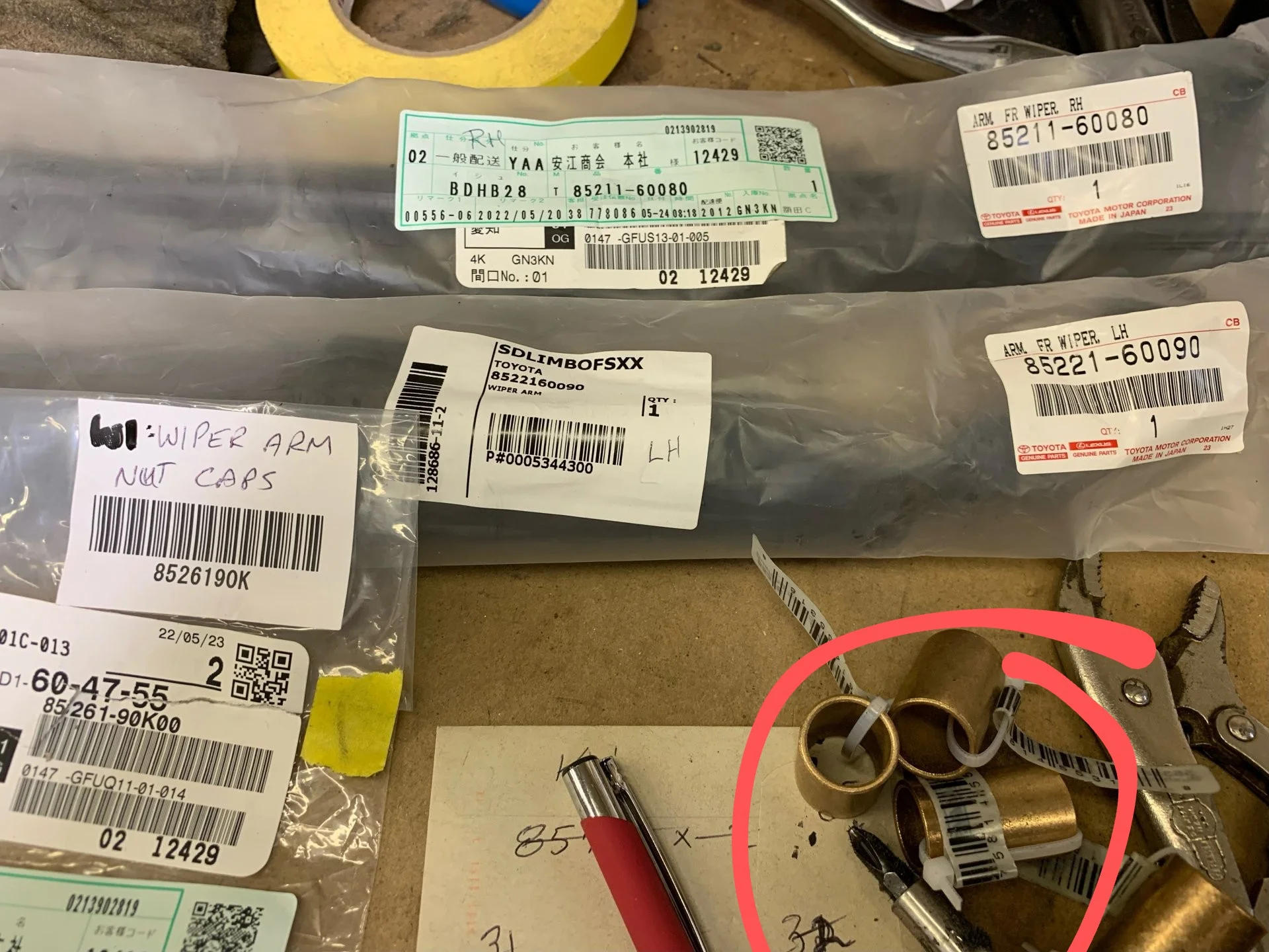

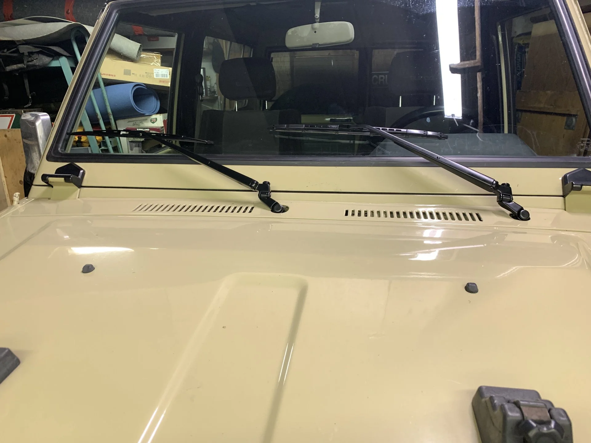

Well, 1 folding wiper arm arrived! LOL! The other is on its way from UAE. Purchased from Megazip. They are cool, I’ve realized that the wiper has to be lifted prior to unscrewing to release tension. Then when it’s unscrewed and folded and the tension of the spring keeps it against the glass so it won’t rattle. The other arrives next week.
🥳. LHD Detachable Wiper Arms for fold down
windshield.
Both attached. The LH side arm ( drivers on LHD ) is shorter in length. Here is pic of both and part numbers. The extra part number is for the little plastic caps that cover the wiper attachment nut.

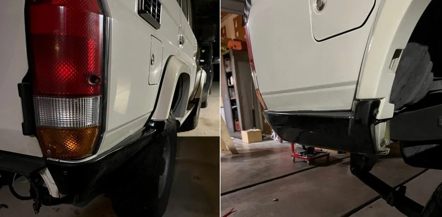

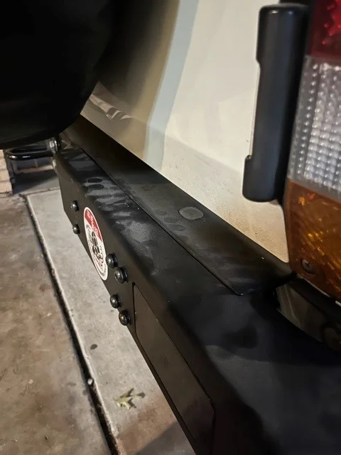

I finished up the flare re-install and put back the lower quarter aftermarket cladding. Looks pretty good. Not sure if I can use the aftermarket cladding with the kaymar when I get to that point but I will find out. The flare section shown in the photos ( closest to the rear) is the one I painted with rattle can Toyota 045 and 2K clearcoat and also a lot of wet sanding/polishing in between stages. It matched up pretty well but not perfect. I don't care as I doubt most will be able to tell.

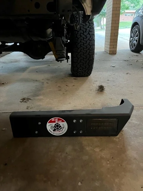

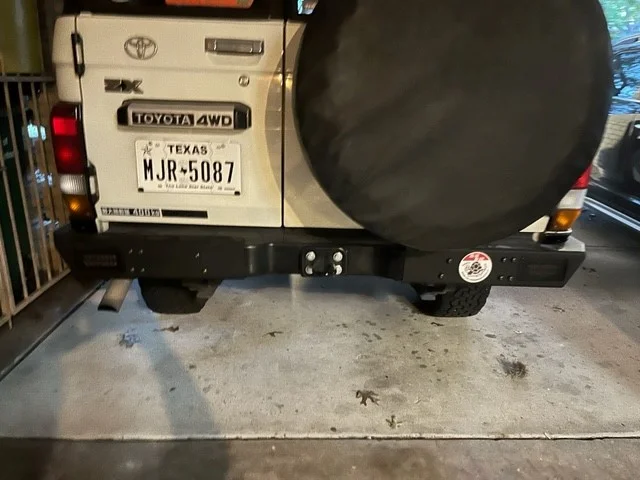

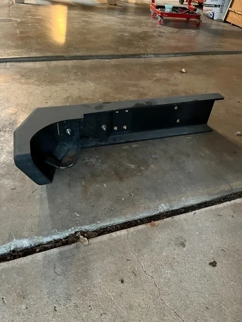

I wanted to drive the cruiser tomorrow and decided to hold off on the kaymar re-install a bit longer so the other aftermarket bumper went back on which only took about 30 mins. Super easy. The kaymar requires an friend to come over and help me, in my opinion. "Safety first".
One nice feature about this aftermarket bumper is it lines up with the plastic OEM trim.

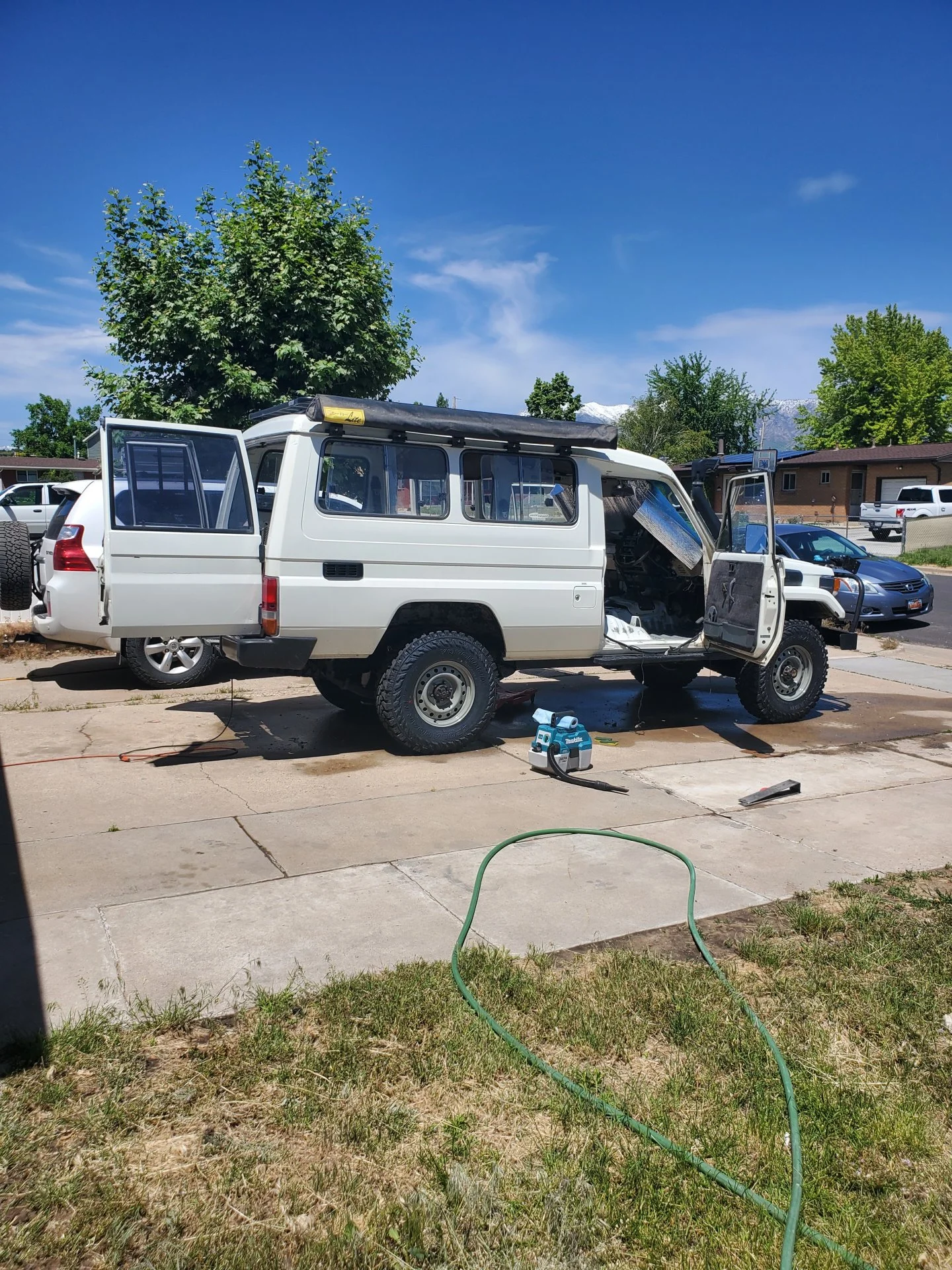

Trying to take advantage of the warm, dry weather to make some headway on the interior of the troopy. Just finished hosing it out for the 3rd time along with even more Australian dust.
Almost ready to throw the floor and seats back in and then take it for a trip
