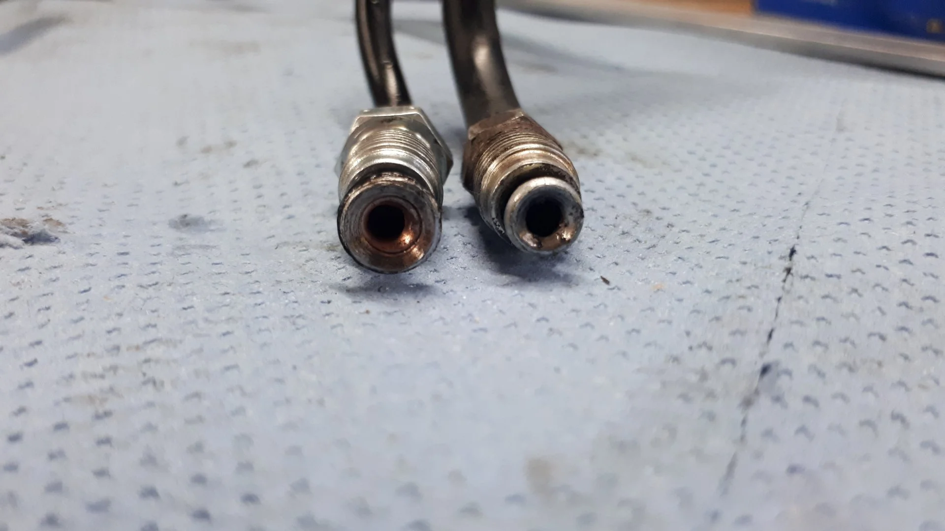

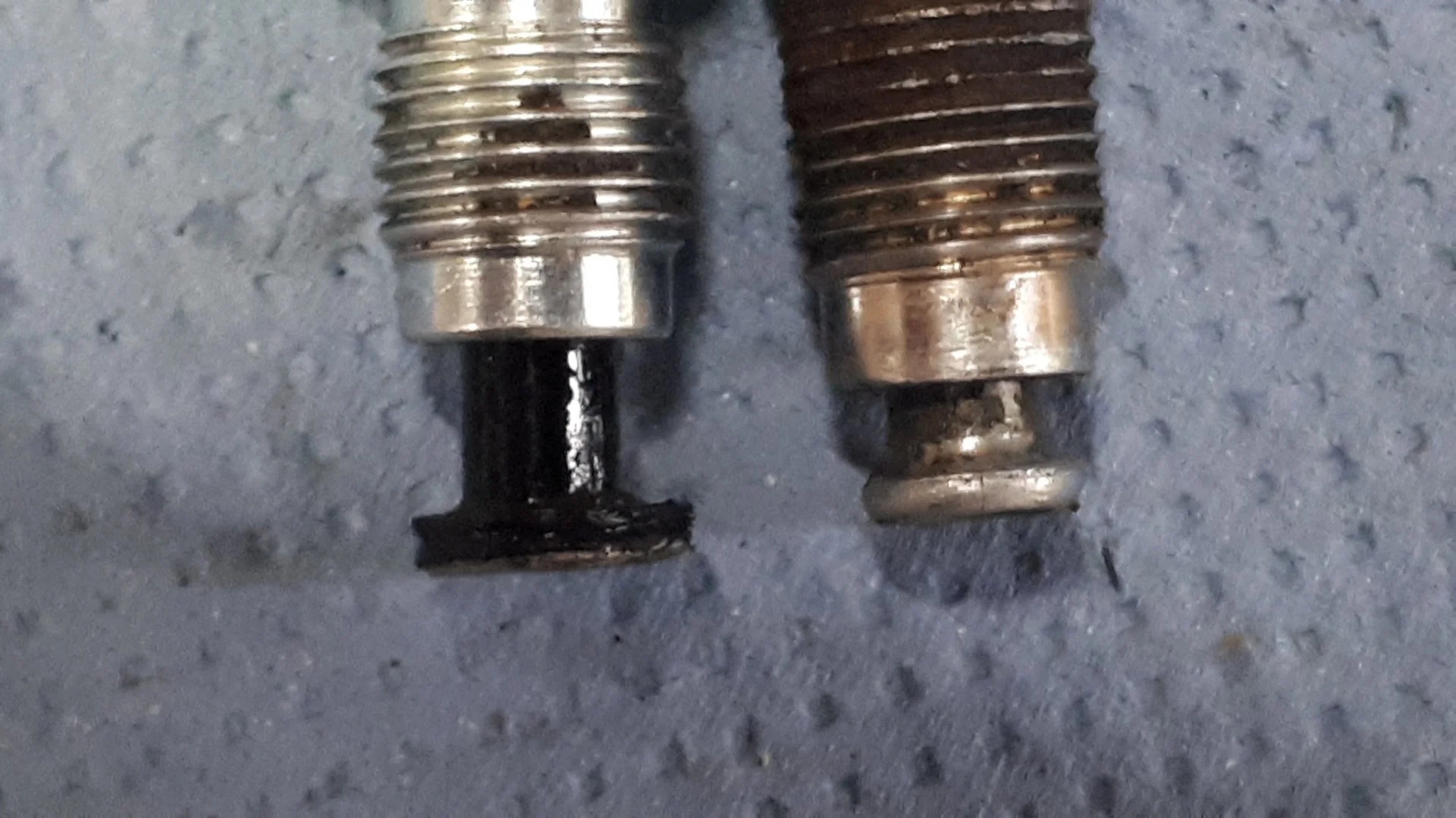

I had a local farming machinery shop reproduce that brake line across the front axle. Paid 90 bugs.
But it didn't work out. They applied the wrong flare shape. It is 8.2mm wide, while the original is 7.0mm. The original also is conic outside, while theirs is square.
>> Does anybody happen to know the industry standard that was applied in 1985 BJ brake line flares? Shape SAE F, E or what?
Looking at pictures, I can't really tell.
I'm so 😞
Left: Reproduced Part
Right: Original part.
I'm so 😞
If your male and female fittings will thread together and match they can usually form a imperfect flare to proper shape if it's not too far off.
I believe it is SAE double flare with 10mm x 1.0 “Asian” nuts.
Thank you.
I did some more Google and compare yesterday evening and came to the same result. This is called 'Type E' in Germany.
I found no evidence for any variation in that type E, also not historically. Not much chances the shop got the wrong shape.
The nuts went from wrench size 10 to 11 for M10x1.0 but that's it.
Look how uneven the reproduced flare is. I believe, it was just poorly done.
By the way: A piece of straight brakeline with premade Type E flares in the length needed (875mm) is 12€. Available via Amazon.
So much for: "Rather pay a bit more and give it to experts" Will talk to the shop in an hour.
The female part is the main brakeline distributer on the diff. Cast iron, I guess. I torqued it down as much I dared, but it was still leaking 1 drop per 2 sec, even without pressure applied! No chance.
I hope I didn't mess up the female end....
If they can use that copper/nickel tubing, it is softer and might form a better seal with the female part.
