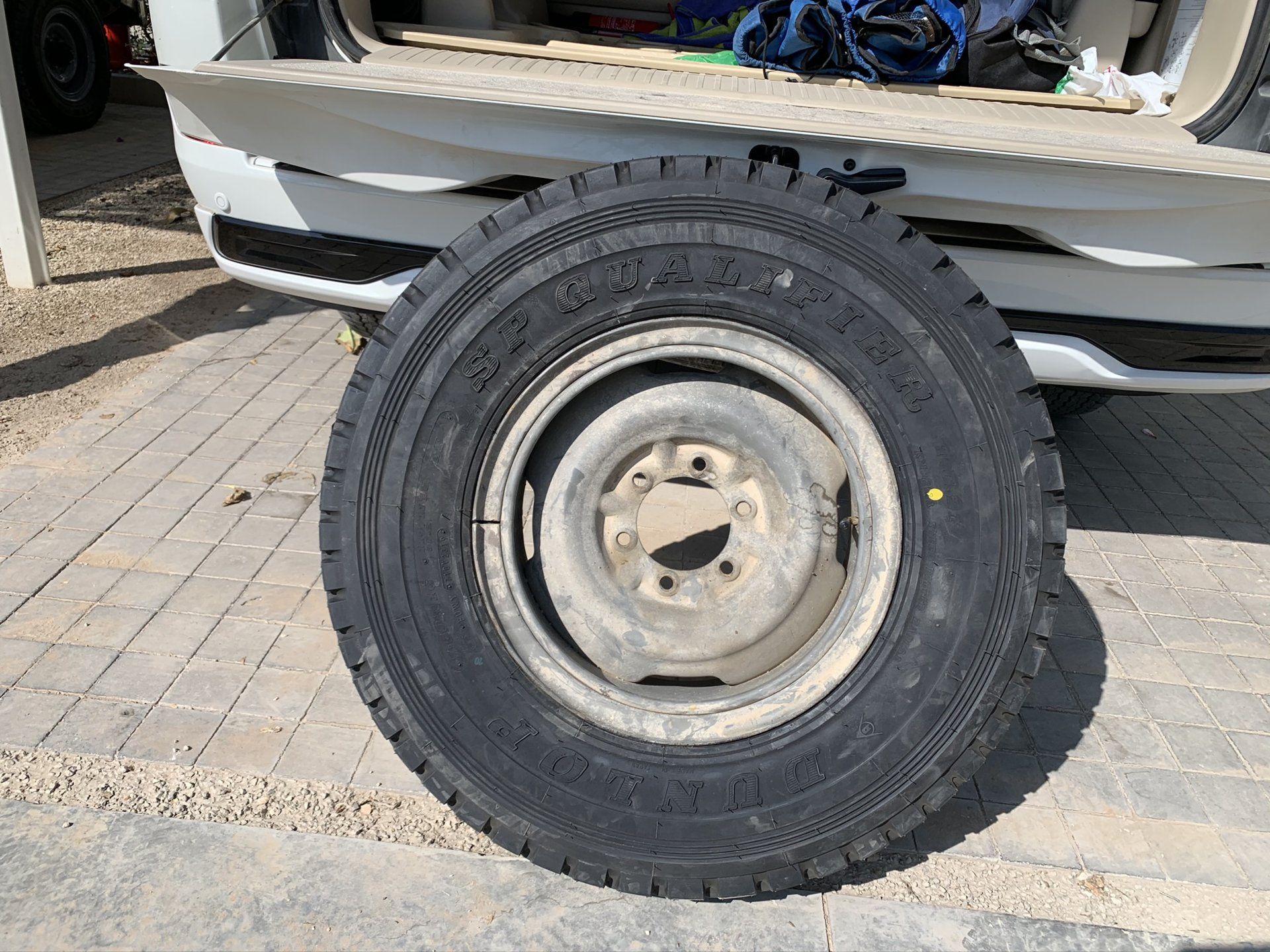

New spare to match the new tires my FZJ75 came with.
Changed gearing and added ARB Air Lockers.
**Photos courtesy of Odd Iron Off Road
