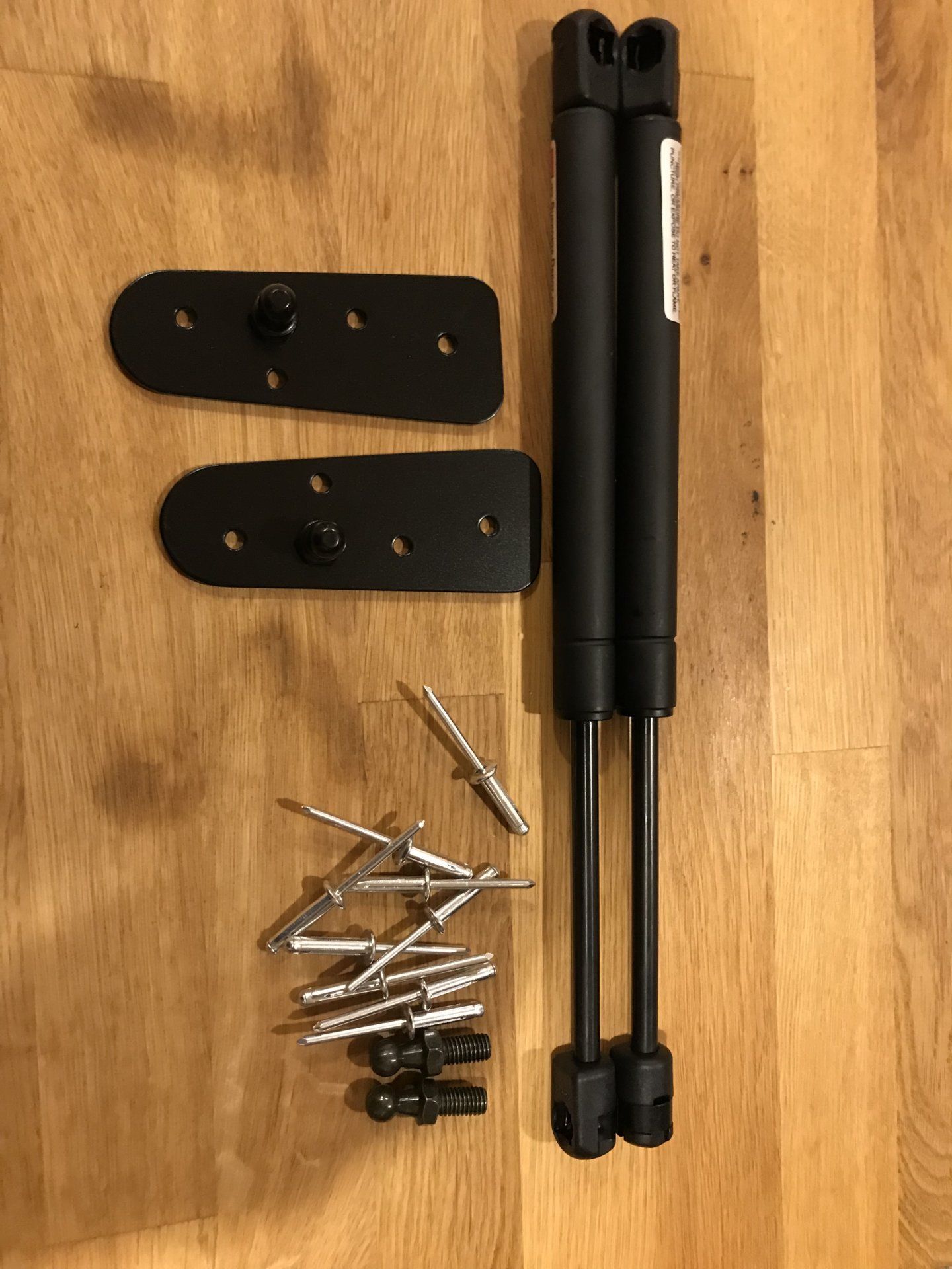

I even included an extra pop rivet just in case....don't want anyone to think I can't count properly. Ha.
I'm accustomed to having extra hardware left over when I finish a product. I thought that was normal. :)

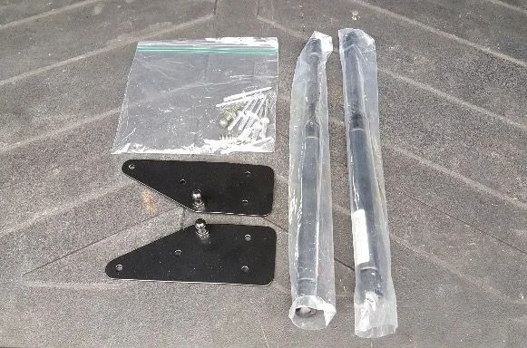

My kit came in today. Look forward to installing it.
My apologies for not putting any instructions in with these kits....we will refine them as we go. This first batch is to get some feedback from.

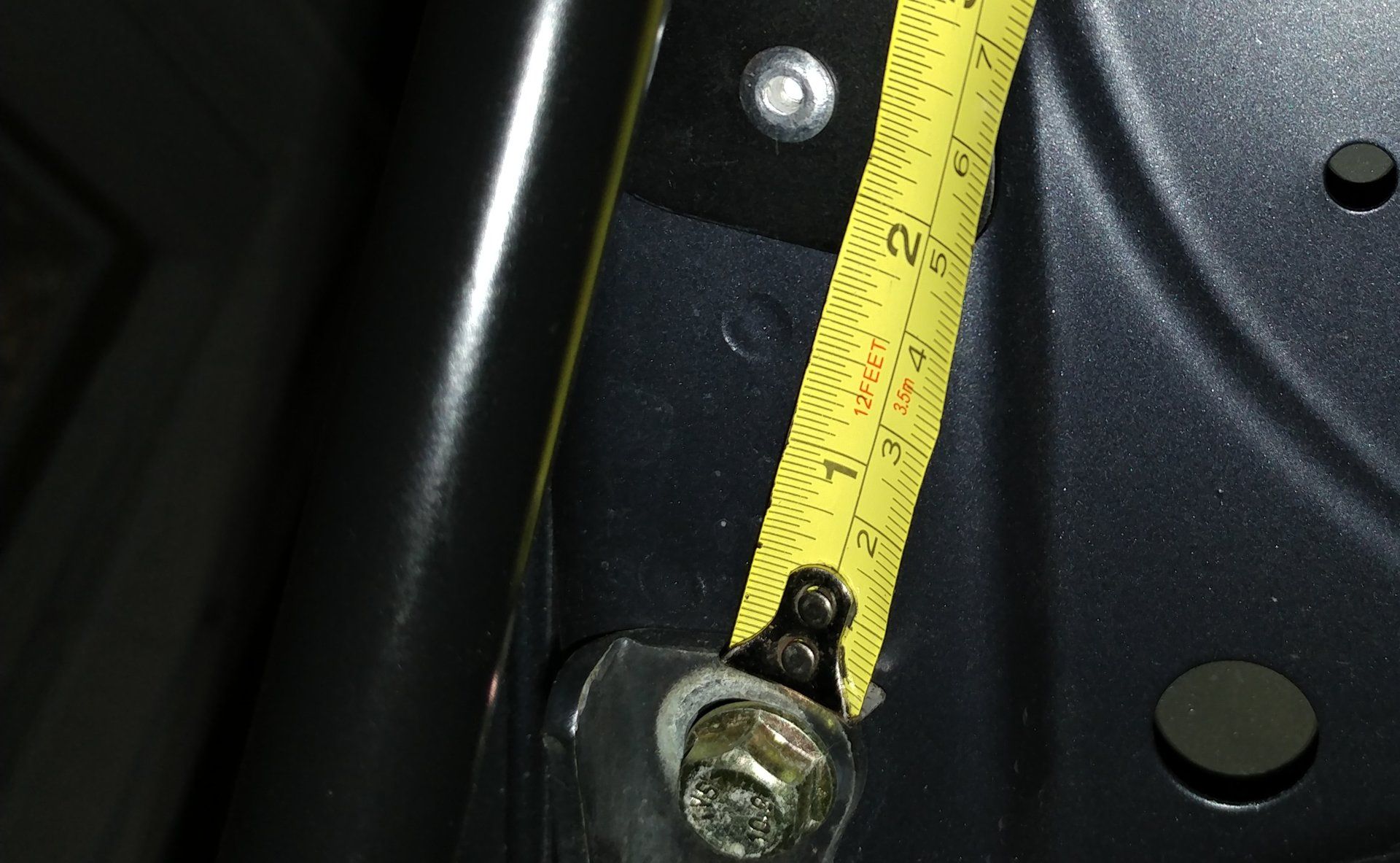

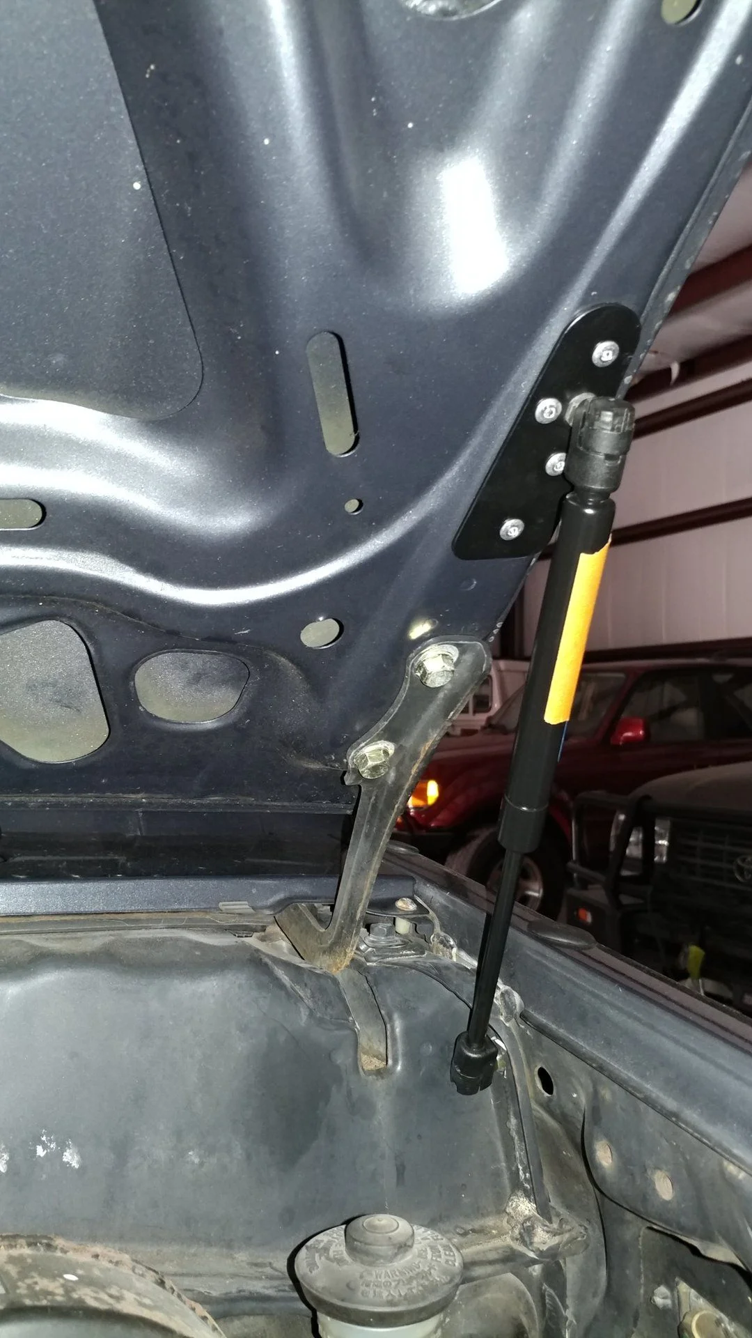

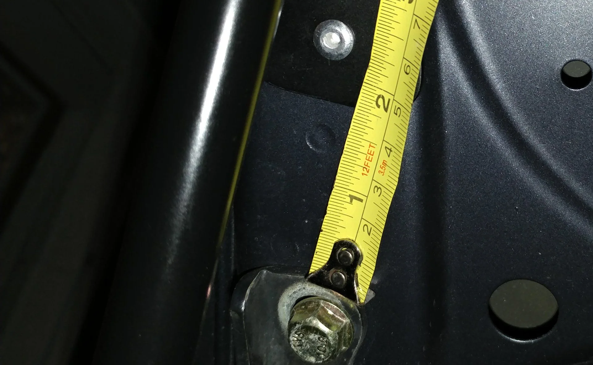

The wide nose stuff can only fit one way but the narrow nose stuff is a little different. Here is where I mounted my parts on my 73.....
The ball stud goes where that upper bolt is on the cowl, direct replacement.
The plate is 1.75" from the front edge of the hinge to the rear edge of the new plate. Pretty basic. I believe my guy made the shape to fit perfect in that area...too high and it hangs over, too low and there is too much exposed hood area. None of this is mega critical....it will work if you're off a tad.
