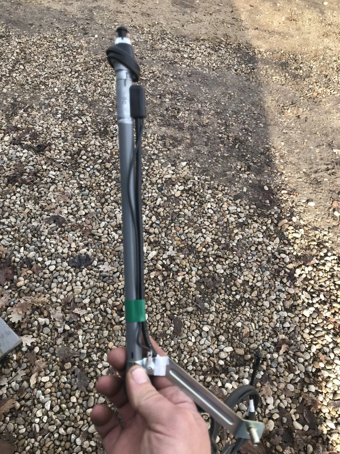

My factory telescoping antenna broke off at a weak point right at the base. trying to machine, solder, drill, an adapter to use a $4 parts store rubber antenna didn't work. Love spending more than an hour on something that is totally fruitless.
Doesn't help that the factory antenna assembly requires half the front end to come off in order to remove.
I replaced my antenna with an original one without taking anything apart. Drop the old one with a wire and use the same wire to bring up the new one. Then its just one nut to tighten. The pain was feeding the cable into the cabin. Al these on LJ, hope HZJ is not much different.

well, just looked on japan-parts and both 1986 LJ 73 and 1990 PZJ70 share the same antena 86300-90K01.
Unless the cars have completely different side wing configuration, look if u can feed the antena from the underneath into the wing and dont drop the old one without the "salvage wire"
I only remember I had a hard time to feed the cable to the radio(maybe salvage wire again?). Cable has a rubber grommet to seal the hole as its going through the firewall. That operation was difficult.
But I did not dismantled anything....:)

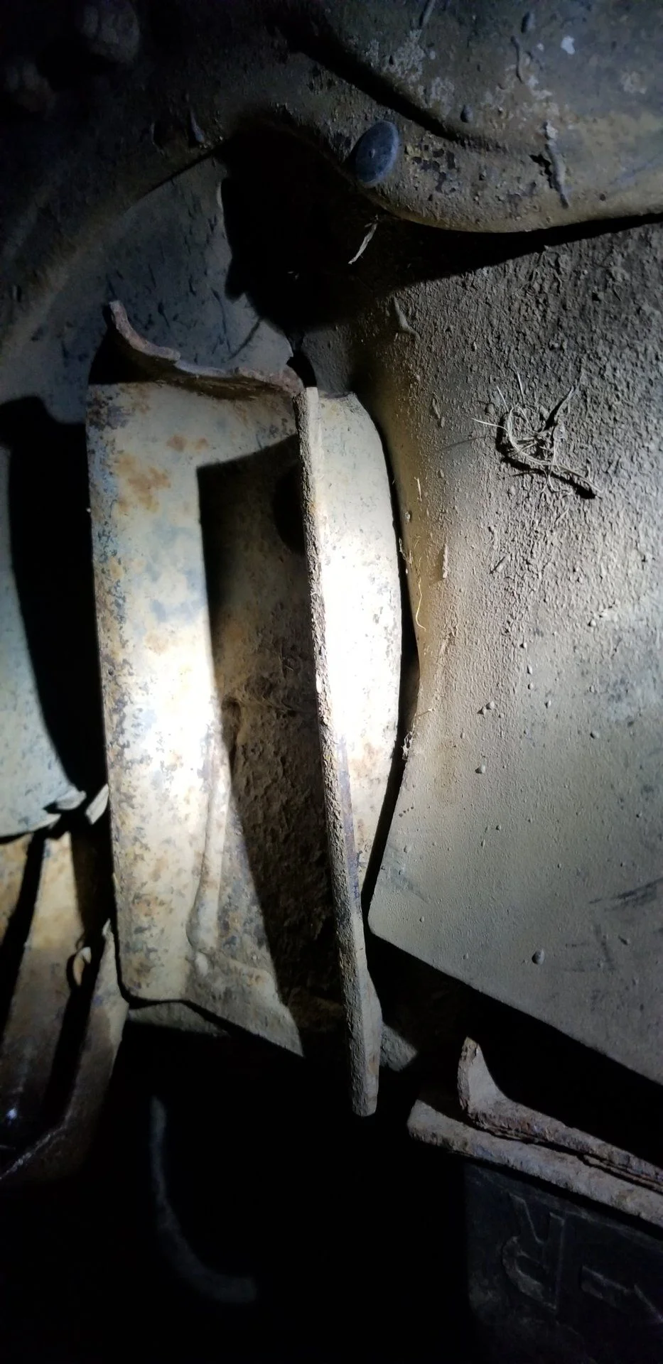

What about the bottom bracket?
if the bottom bracket is what takes the nut in the picture, then no problem to bring the bracket to the fender and fix the nut. I despaired with the cable, not with the antena itself.
the cable is also very short and needs carefull routing to reach the radio.
mind you, I have an LJ, not a heavyduty one.

I have a clutch booster and there is no access up in there without pulling it all. Even then I am not sure my small hand would fit.
Other Cruisers have a plastic access panel so you can get up to it from the bottom. I pulled the inner fender but I needed to for other work anyways.

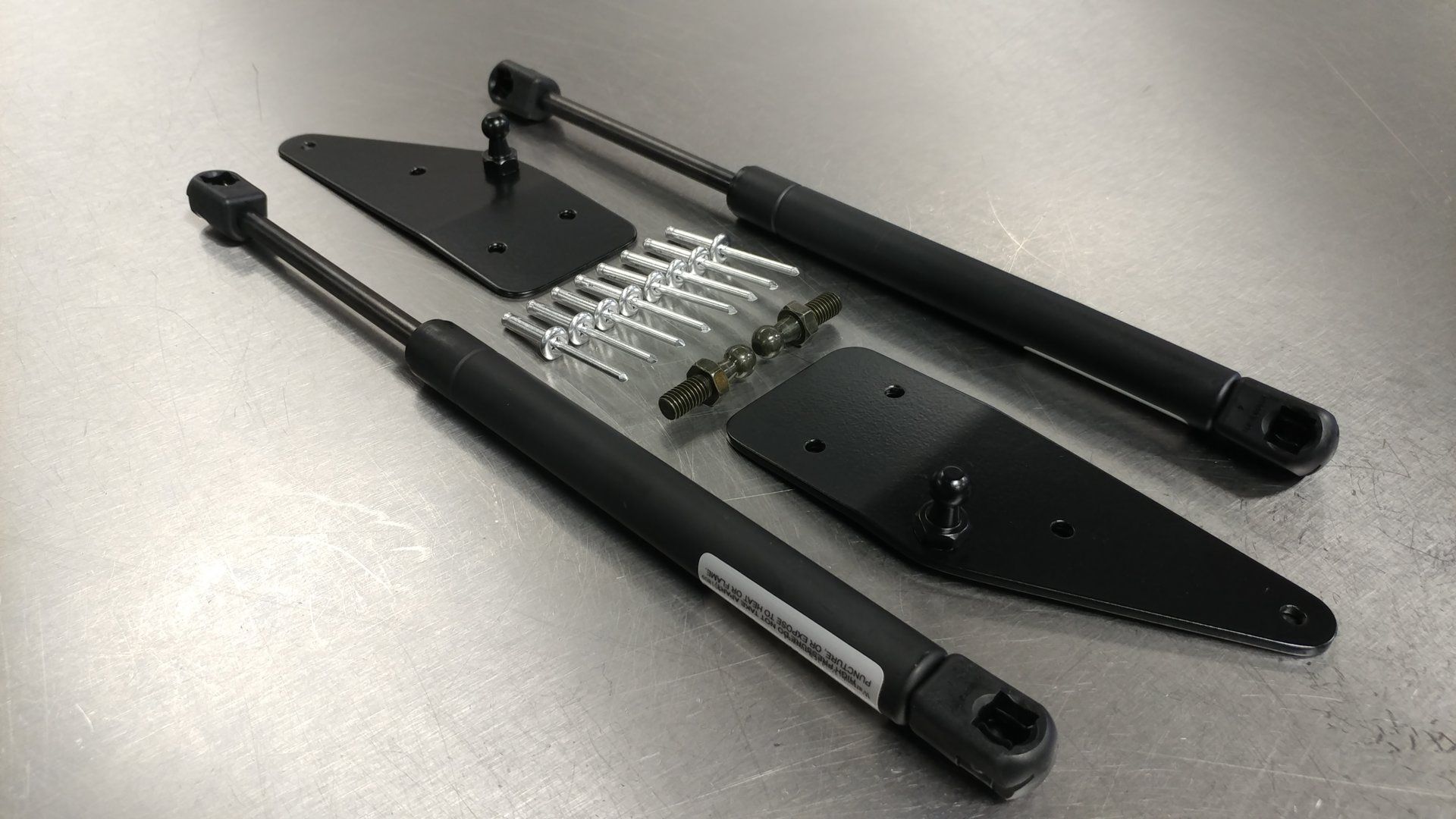

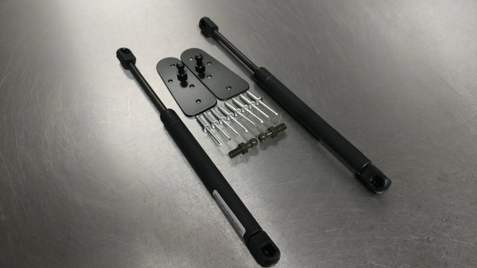

Looks like we're ready to ship the strut kits....struts arrived today. Going to reach out to those of you who expressed interest in a kit with payment instructions and hopefully get these things out right after Christmas.
Narrow nose
Wide nose
