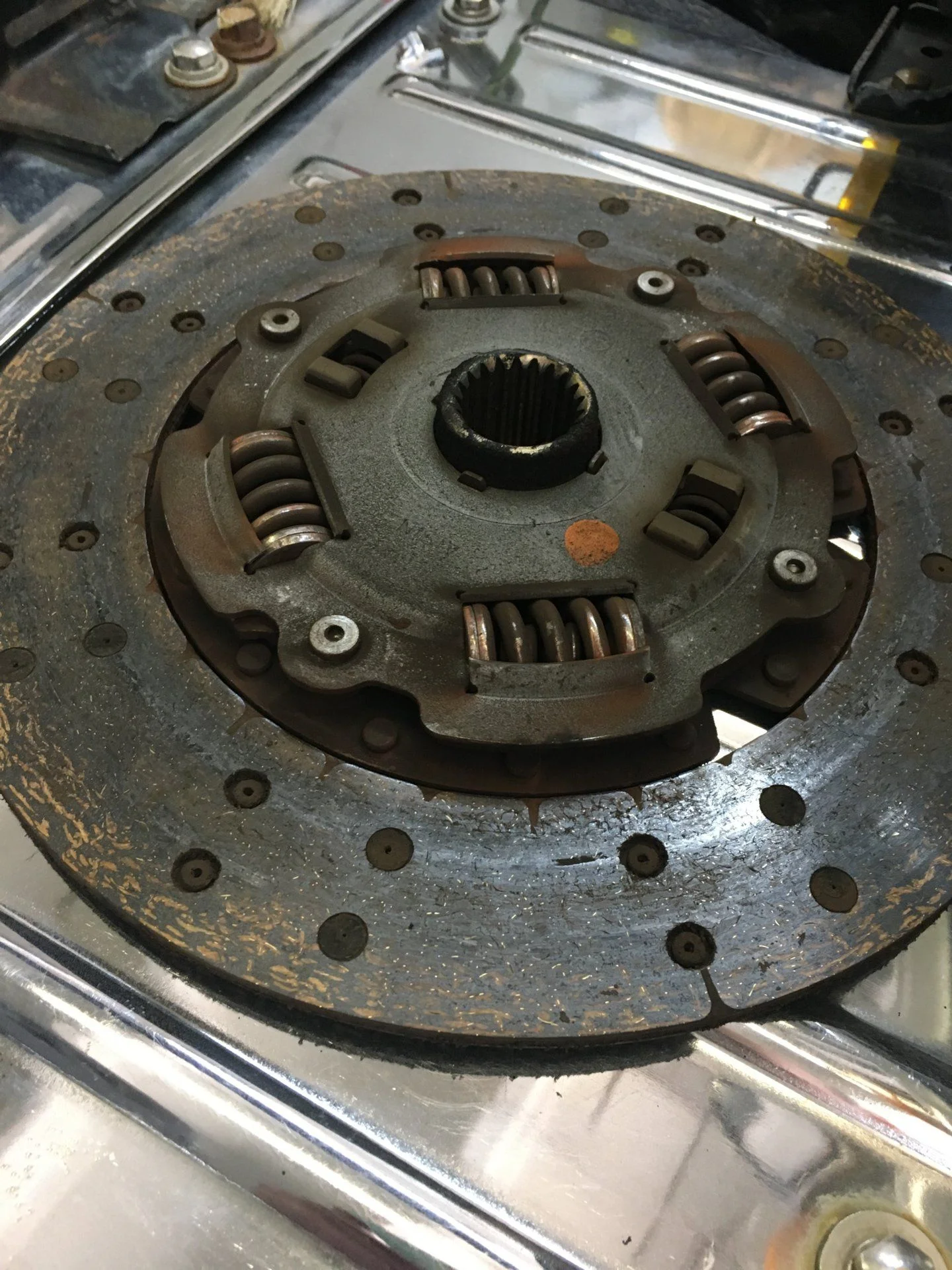

Señor Robbie finished rebuilding the transmission, t-case, and PTO. The clutch plate was also replaced, as it was down to the rivets.

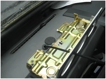

Clinometer(BJ71) and power door locks (HZJ80 - switch next to a/c control))
Someone have the electric diagram for Clinometer?
