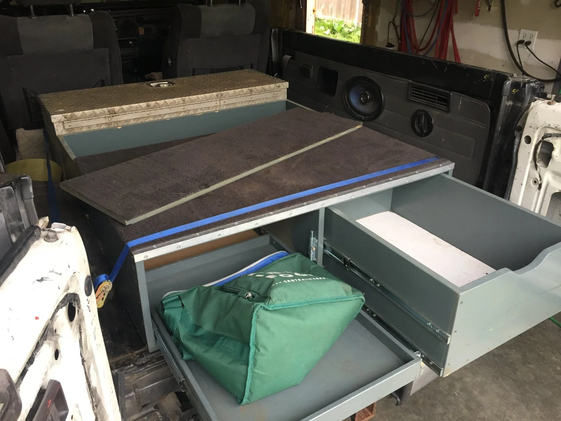

Installed the rear storage boxes. Found an aluminum box to fill it all in. Now I can carry tools etc, out of sight.

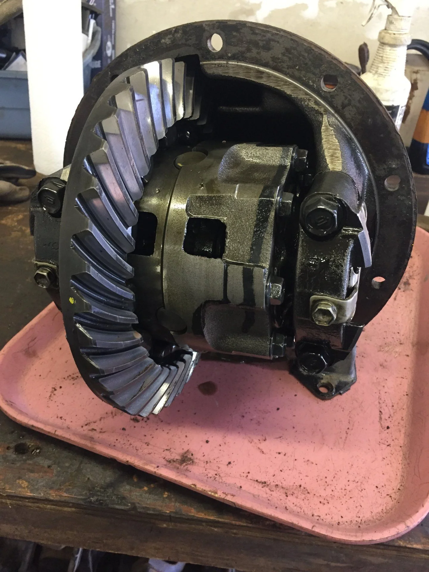

I just pulled this 3rd member from a ‘88 BJ74. It’s got the 4.11’s in it. Going to upgrade the rear gear on the 60. Is this a factory Toyota Limited Slip? I don’t have any idea what it is

As per your thread in the diesel section,
check your vin plate. Axle code will end with a "5" for factory LSD.
Cheers

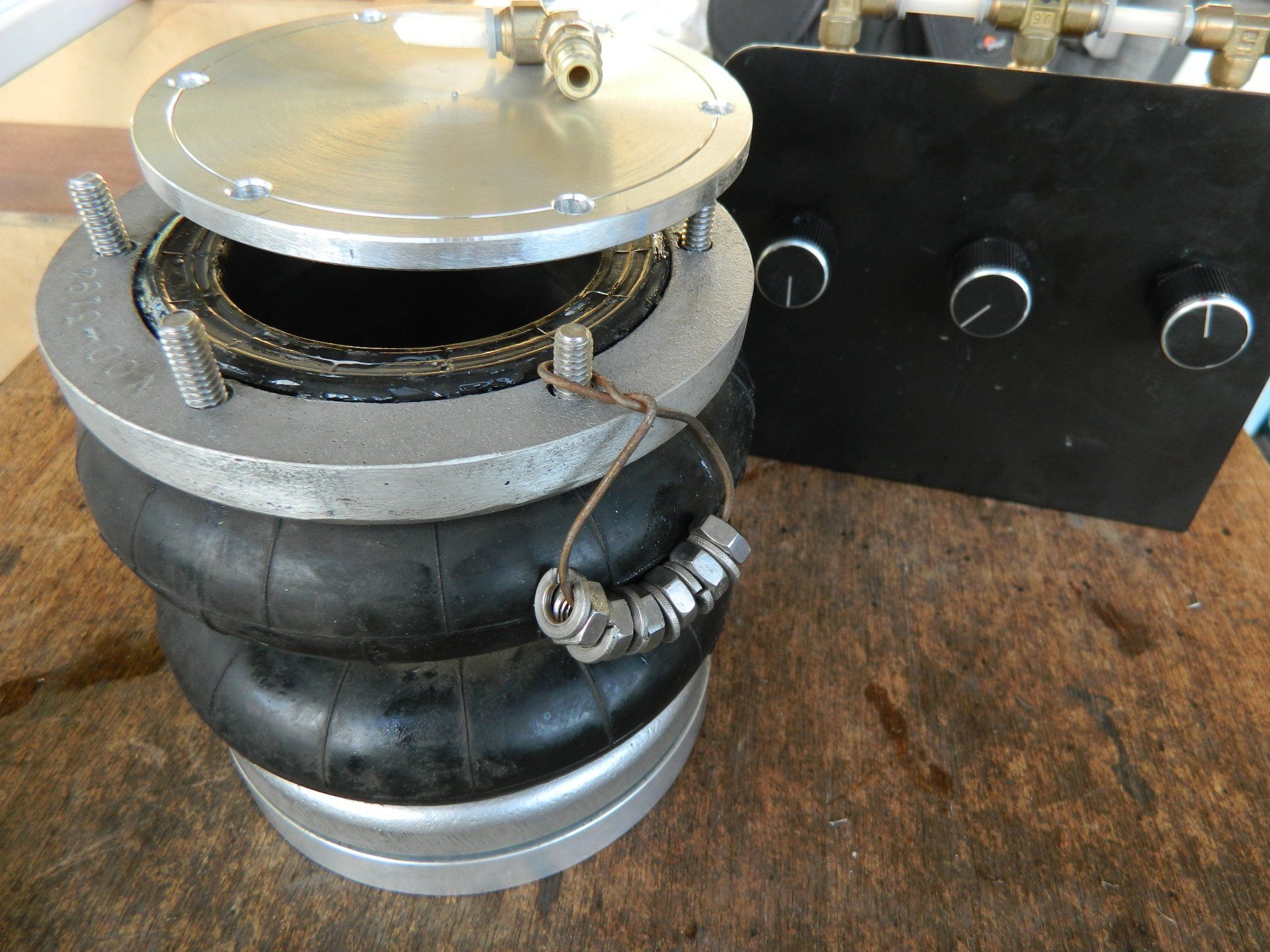

G'Day Fella's,
I have been wanting to fit a suspension seat on my BJ 73 for some time.
I was recently talking to a good mate of mine, and he suggested (then dropped off), 3 x air bags that he believes, should help achieve this.
I only need one air bag for the seat, so what can I do with the other two...................?
He's some images FYI.
Here you can see the air bad and a set of 3 x flow control valves.
You can see here, the end cap (125mm/5" Dia), that I had to machine up, to thin it out a bit to reduce total thickness/height.

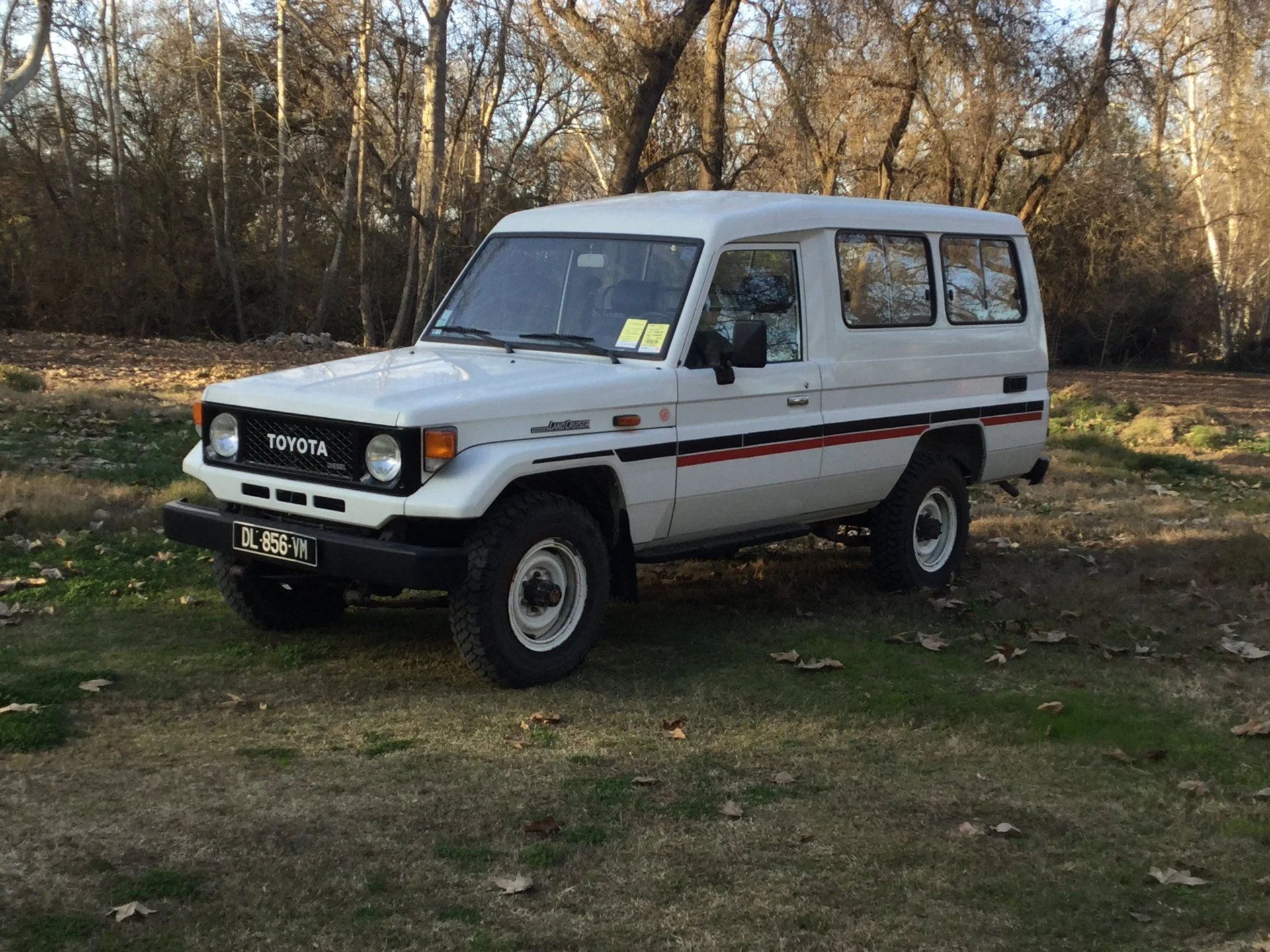

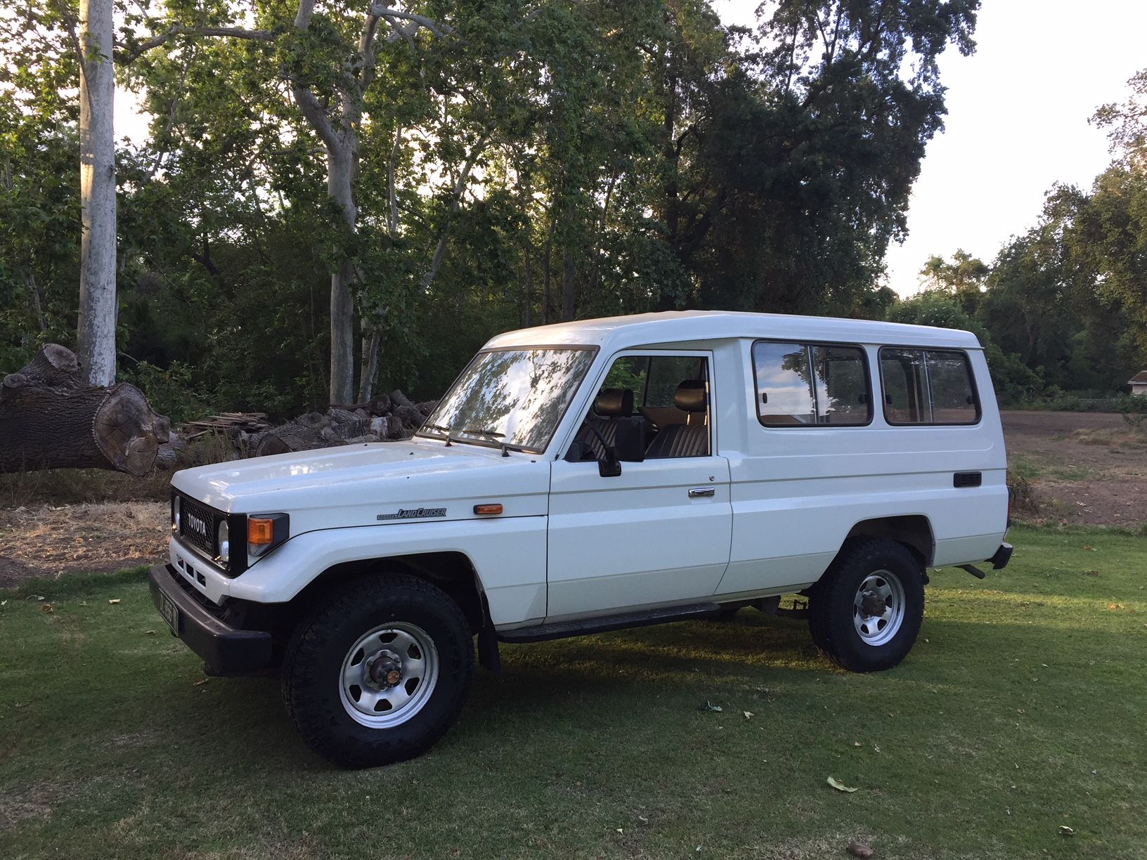

Spent a weekend taking off the dopey dealer-applied stripes on the sides of my new Troopy. What a PITA! Hours of solvent and rags and rubbing. Worth it, though, I think it looks a lot better without them, as they were very badly aged and decrepit, and not especially stylish.
Also fitted new wheels and tires, and polished all the paint. Before and After pics attached:
Looks great. I see you went to the 16" silver steelies also. :)
I kinda like the white rims you had before also.
Still have the original white split rims--I pirated the silver wheels from another 'Cruiser so I could get tubeless tires mounted. Even though the Euro spec Troopies of this vintage (1987) came with white wheels, I'm thinking I might get the split rims painted gray when I restore them. Still undecided on that.
View attachment 1700636 View attachment 1700637
Wow Steve,what an absolutely beautiful truck!! Love it!

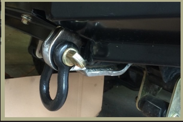

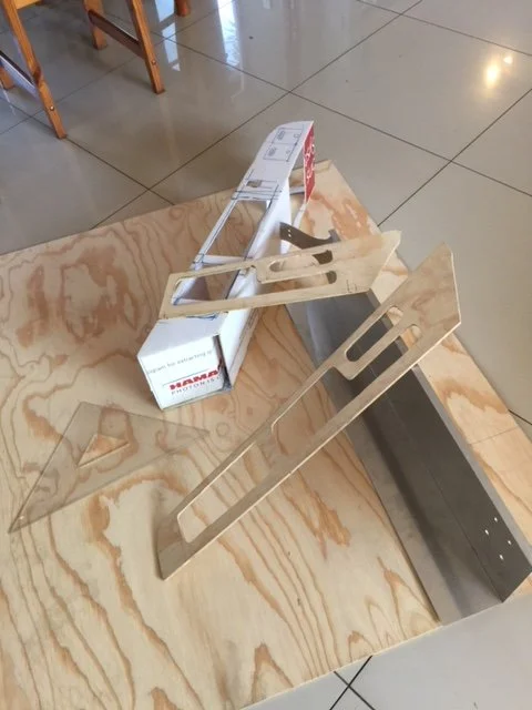

Had Rob fabricate a couple of recovery points for a future project. :)
Axle code with a “3” at the end of it will also be an LSD axle set-up
That is for the 2-pinion diffs right?
Cheers

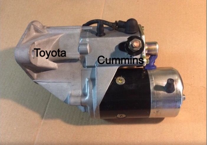

Charles,
You have me feeling better about the shop that I use for starter & alternator rebuilds. :bounce2: As part of their rebuild, they do a walnut shell media blast then paint the exterior surfaces (steel/cast iron get black paint, aluminum gets silver). The end product that I pick up looks fairly like the rebuild that I was expecting.
It turned out fairly nice. :)
A heavier duty upgrade. (1HZ)
* Photo and starter courtesy of Odd Iron Off Road
