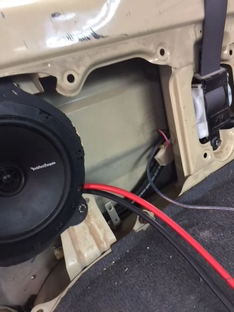

Made a good start on getting a solid 12 volts from the second battery to the rear and fit new sockets and stuff. There is a nice place on the C pillar between the seat belt and rear window,on the 76, nice and high as well, to fit some power sockets and USB's. National Luna, the fridge guys are local ( South African) and a stone throw from my house, and they make some good sockets and USB's as well. Not finished yet, but this is todays progress.
