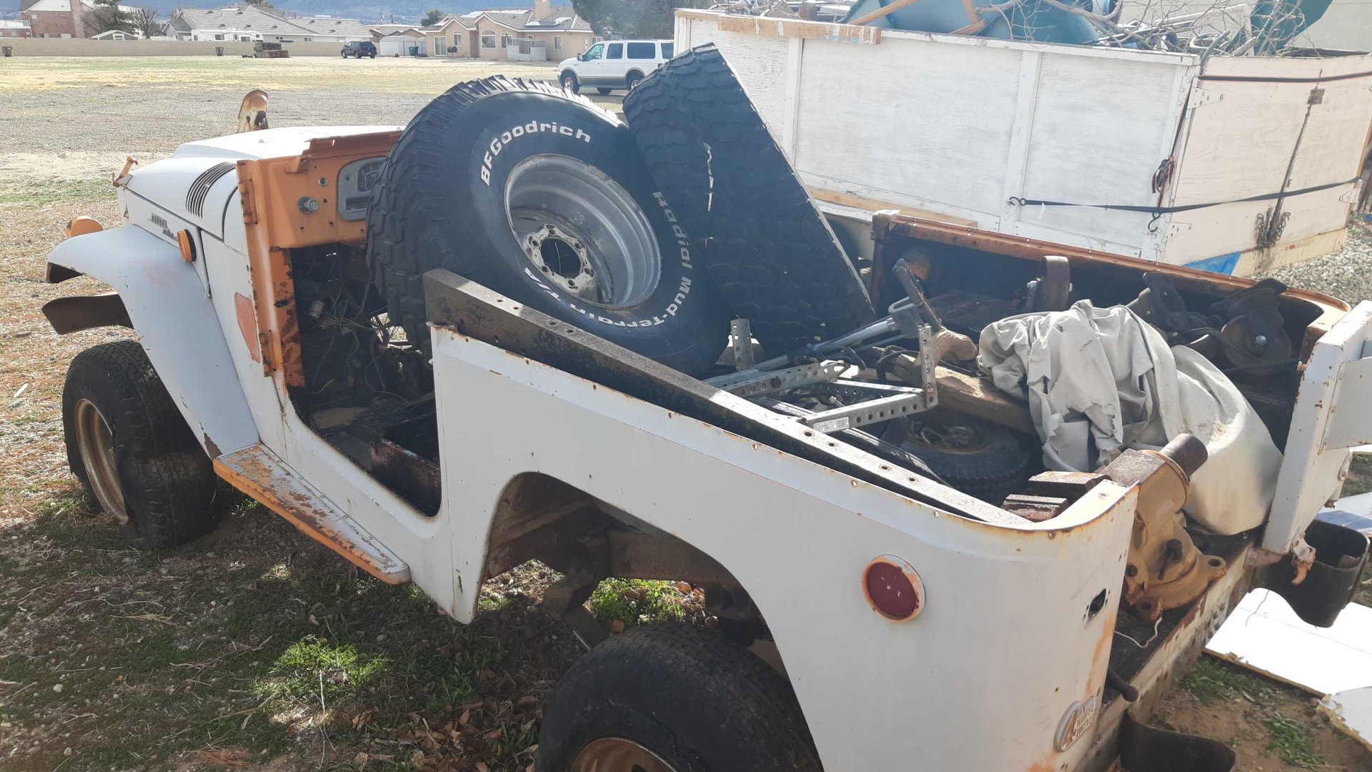

A buddy had an FJ40 of an unknown year sitting on his back lot for years. He recently sold the house and has to be out in two weeks so I asked him about the FJ. Long story short, I bought it for a song. However, he purchased it as a parts/donor vehicle so he didn't have a title or anything. The VIN was cut out of the frame who knows how long ago so I don't know what year it is and neither does he, though he guesses a 68 or 69. No engine, transmission, doors of any kind, top, seats, and more. But it came with a bunch of junk stored in it I have to chuck, so I've got that going for me.
I've done some reading and am confident in my ability to get a state-issued VIN and title it, though it's a LONG way from being ready to drive. I did get a bill of sale, and I used language similar to that found on the form my state uses for issuing a VIN.
Hopefully, the pictures will help one of you knowledgeable folks recognize some feature and know what the year is, or at least a 95% certainty of year so I can start looking for the missing body parts. I have an '06 LX470 and a '69 Jeepster Commando that I restored, but this is my first foray into FJ40s.

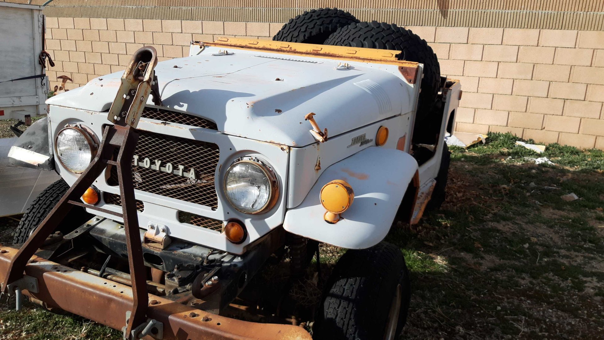

I have a 1969 and this one is probably , exactly as you say , late 68 , early 69. Telltale is the amber apron reflectors , the round turn signals, the bib lamps, etc.. I would guess made just before 3/69. Why was the VIN cut from frame ?

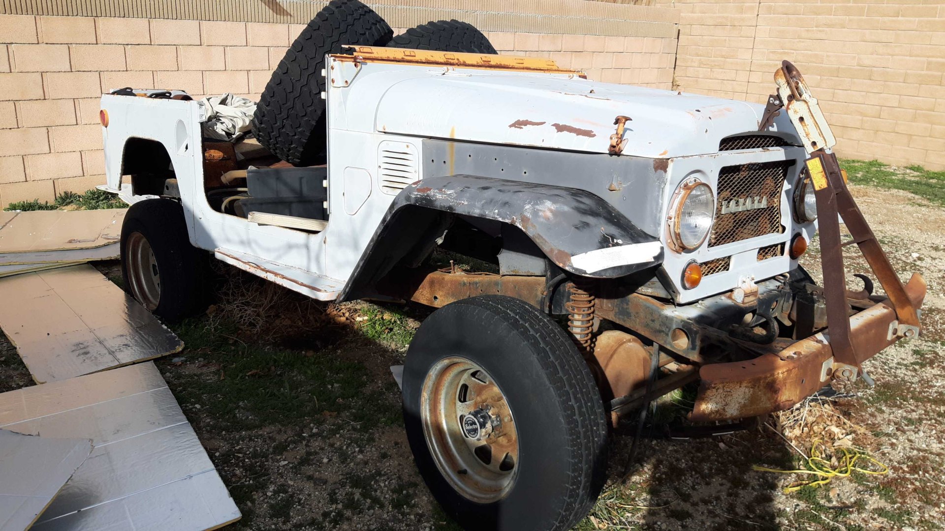

Just noticed the side steps with the trim, thought those ended in 68?
SOR says - 1963-10/69 FJ40

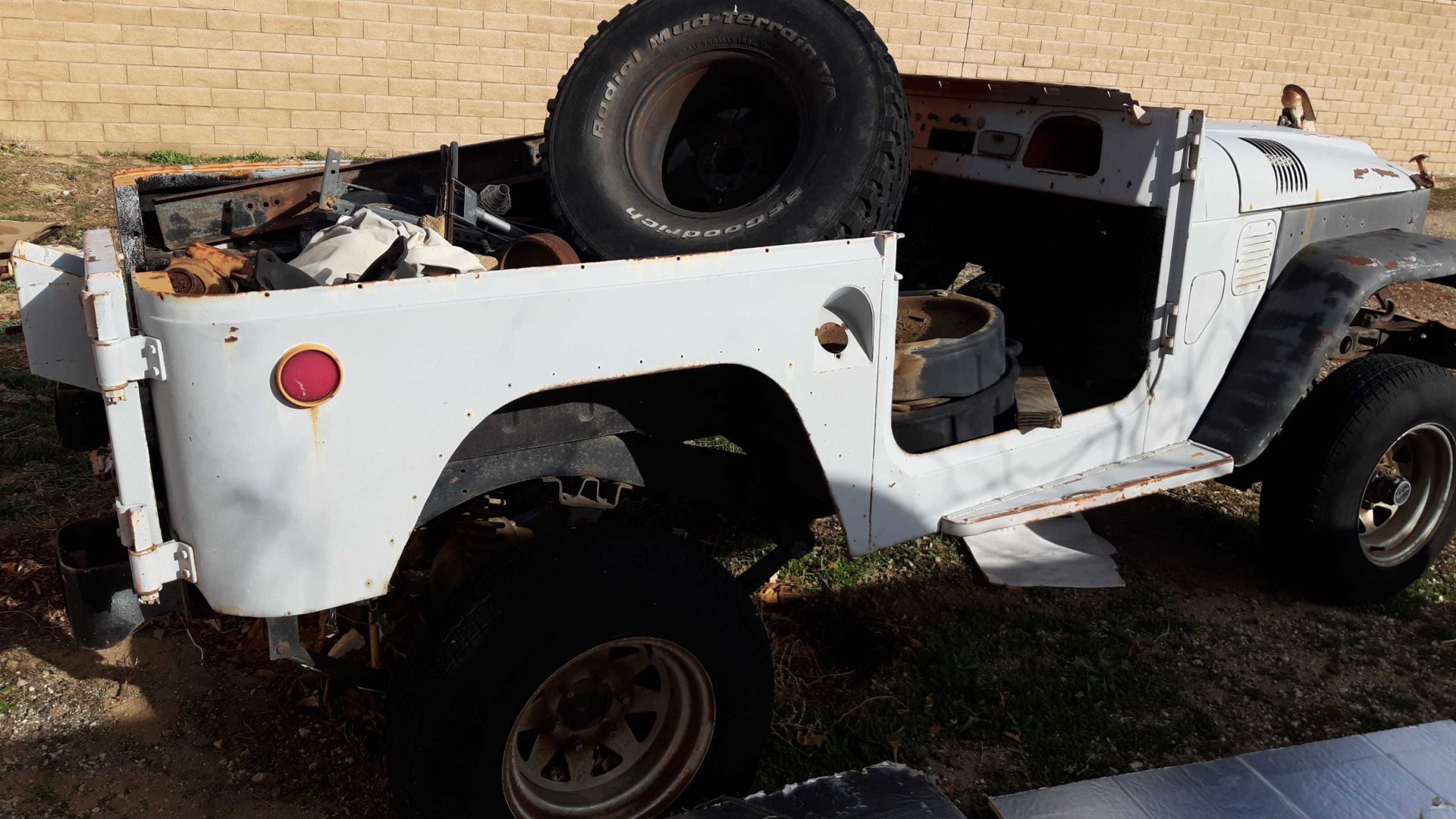

The 3/69 show a rectangle turn signal. The amber reflector were 68 and 69. My 9/67 owned since 1974 has the amber reflectors. Still have figured when the tall one level hood pads ended. Those are taller because of the windshield wiper change. Some time during 1968 Toyota switched to the ones that step down. This would also have the early center steering arm. Probably a couple holes were they removed the rivets for the bracket. Late 69s have a plate to mount the center arm. Are the holes the mount the tail lights offset or directly above and below each other? Offset are the large tail lights. Otherwise used the mid size light used during the mid sixties.

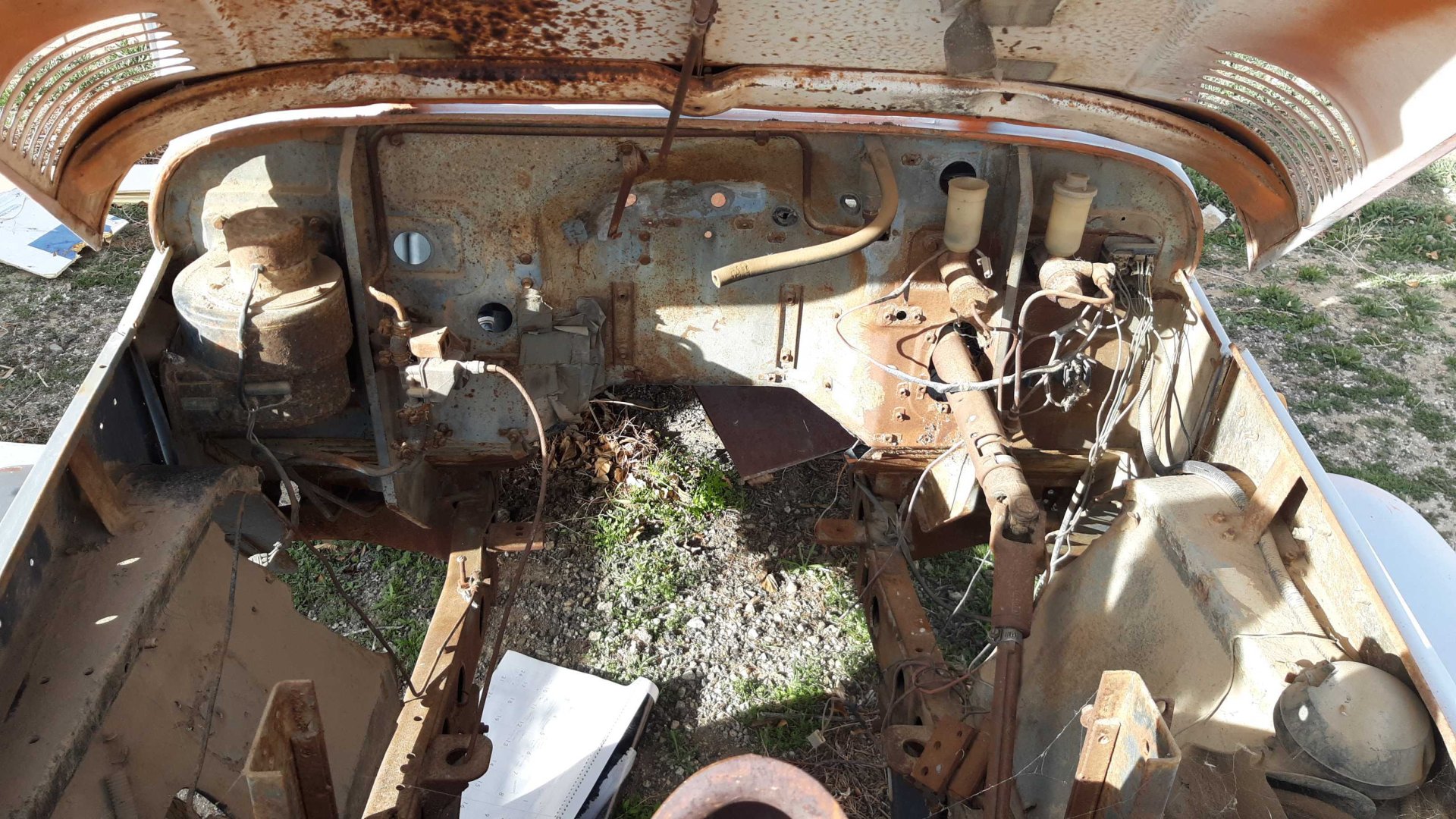

No ignition switch hole to the left of the gauge cluster, so probably on the steering column. Don’t know what year that transition happened though.

I'd go original 1f and a 3 speed, or a 2f/4 speed if you can find a deal. Motor/trans mounts look ok. At a swap meet you should be able to get motor/trans for $500. You might want to become friends with @landcrusher909. He's got parts and will be sympathetic to your cause. ;)

@Living in the Past, I don't have it home yet so I can't answer your question about the tail lights.
