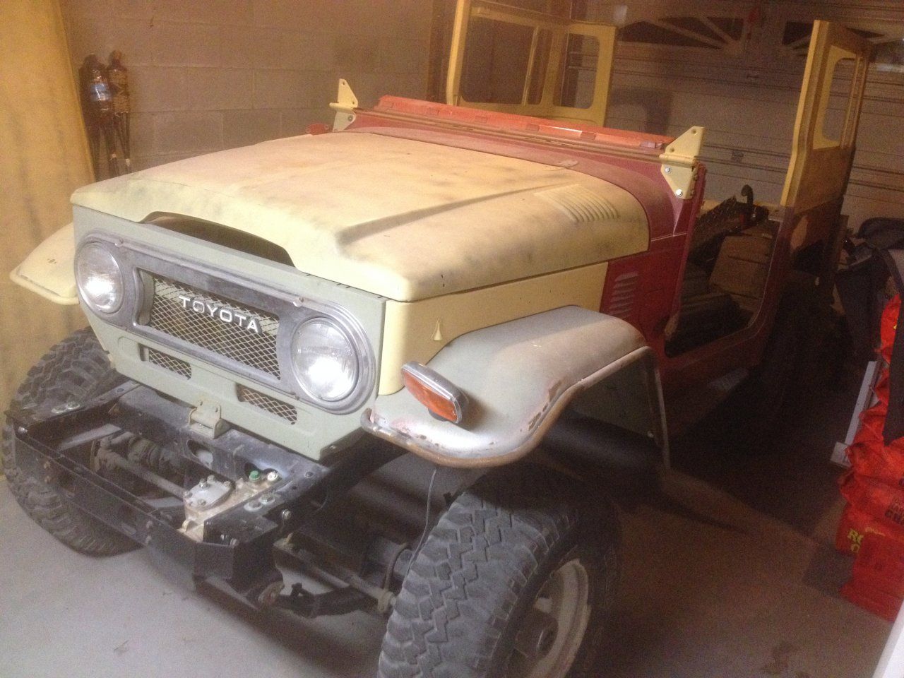

Brought home a project 40 from Waynesboro PA last week. No engine, transmission or transfer case but it is a rust free 40 with a beautiful frame. Has a four inch lift, shackle reversal, and 4.10 thirds with ARB lockers. That's Ben delp tying the new addition down to his trailer for the ride north to Brockton. I worked all weekend getting the truck ready to go to the paint shop- all body panels are now (temporarily) installed, windshield glass has been removed, and all 16 broken bolts in the top were drilled out and re-tapped! I have a really strong running F engine that may end up in this truck although I am looking for a good 2F. I have the transmission and transfer case that i want to use. Have sketched up some bumpers for it and will get started on those while the truck is at the paint shop- hopefully sometime this week. My paint guy turned the 55 around in six weeks last summer and I am hoping he can do the same with the 40. By the way ben got a nice red LT1 equipped 40 in the same deal! Things are happening here in PA> Let me know what ya think about the 77 and what color do you think I'm going with? truck was originally red. Gary S

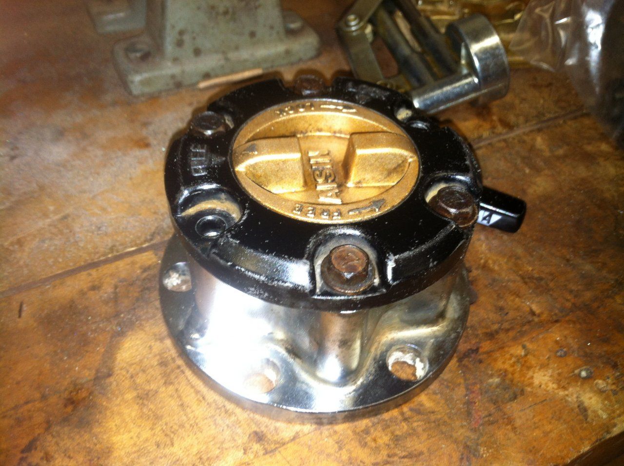

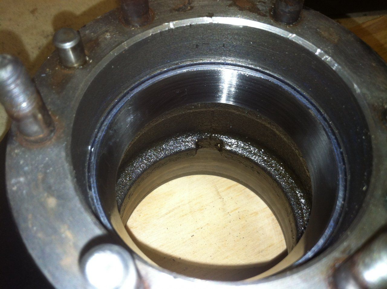

Slogging away on @Stumpalama's donor FJ62 parts. Now that the weather was nice, I finally got them painted up, new races installed, and one of the hubs reassembled.
Question on the Aisin hubs - I've asked it elsewhere but don't have a clear answer yet. I get a slight amount of play (about 1mm) in-and-out if I grab the inner hub gear. It's as if the C-clips and spacer aren't QUITE taking up all the slack in the system. Is this normal play, or a cause for concern?
Also - when I switch it to "LOCK" the inner hub gear still turns, very slightly, before "popping" into place and locking. I'm assuming this is normal (just seating the gear teeth) but wanted to confirm.

Rick- your hubs are fine, the inner ears float a bit in their housings and a slight amount of waiting for the gears to align when shifting is normal. Your work looks great- take your time and make this the last time you'll have the knuckles apart! Gary S
Thanks Gary, I figured that was the case, but as this is my first time doing any of this, wanted to be sure.

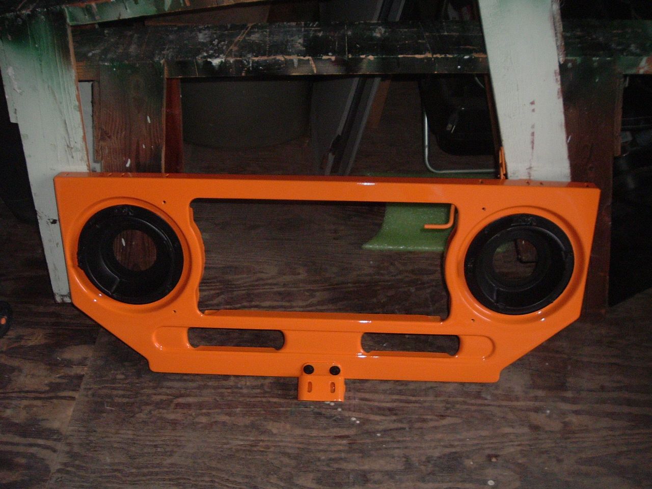

Andy- the Sag install looks clean! big improvement, eh? I did the same thing with m Tuffy years ago- CB on the front and cup holders moved to the back. Gonna make it to Coal Mine at all this year? I'm planning to lead a stocker type run Friday for a few folks with vehicles they've not yet wheeled. Let me know. And we're getting color on some of the parts for the 40 project. Bib and aprons are done, all four doors should be pained by the end of the week. Next to go to the shop are fenders windshield frame and hardtop sides. She's comingGary

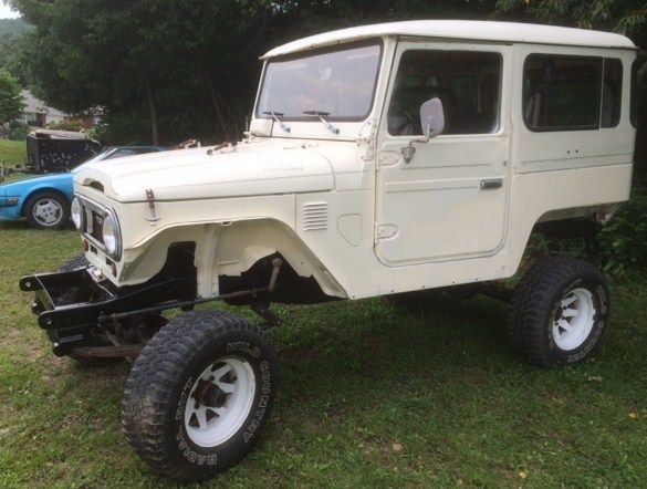

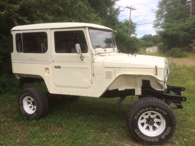

Also been cleaning up a 40 project I got from Matt Bascom in VA. Looked like an orphan when I got it, had been sitting awhile. Got her cleaned up and some parts rattle can painted, interior leaned. not sure what i'm gonna do with it- would sell it if I had a buyer but I just might keep it, finish what it needs and wheel the heck out of it. She's a tall one to be sure.....
