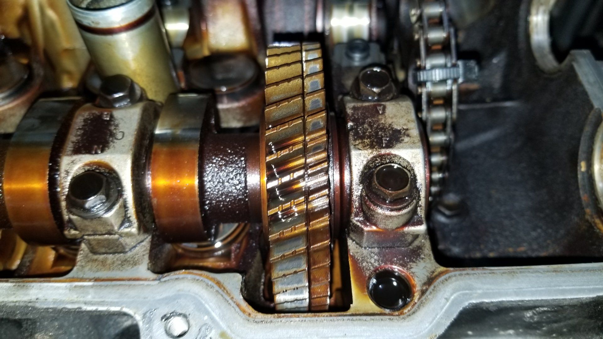

Think I may have jacked up the exhaust cam ... :bang:
I watched the video tutorial from @OTRAMM a few days back, also had extensive nores from my prior HG install. Pulled the intake cam before I set the screw stay for the exhaust cam and I think my spring sprung. Anyone else ever done this stupid before and know how to make it right?
Hard to see it, but the holes don't line up anymore ... what a moron thing to do.
Looks like maybe the front slid one tooth counter clockwise? You can just see a portion of the hole in the 2nd and 3rd pics.Can I grab the front gear with big channel locks and rotate it back? Does it even go that way? Balls.
I blame this on it being so stupid hot out today. So close to getting this off that I didn't take the time to check steps.
Grabbing a hold of the thin gear is going to be the challenge. If you can do that without damage, it looks like turning it one tooth clockwise will do the trick. Does there happen to be another hole 180* from the one pictured? If so, an adjustable pin spanner wrench might do the trick.
