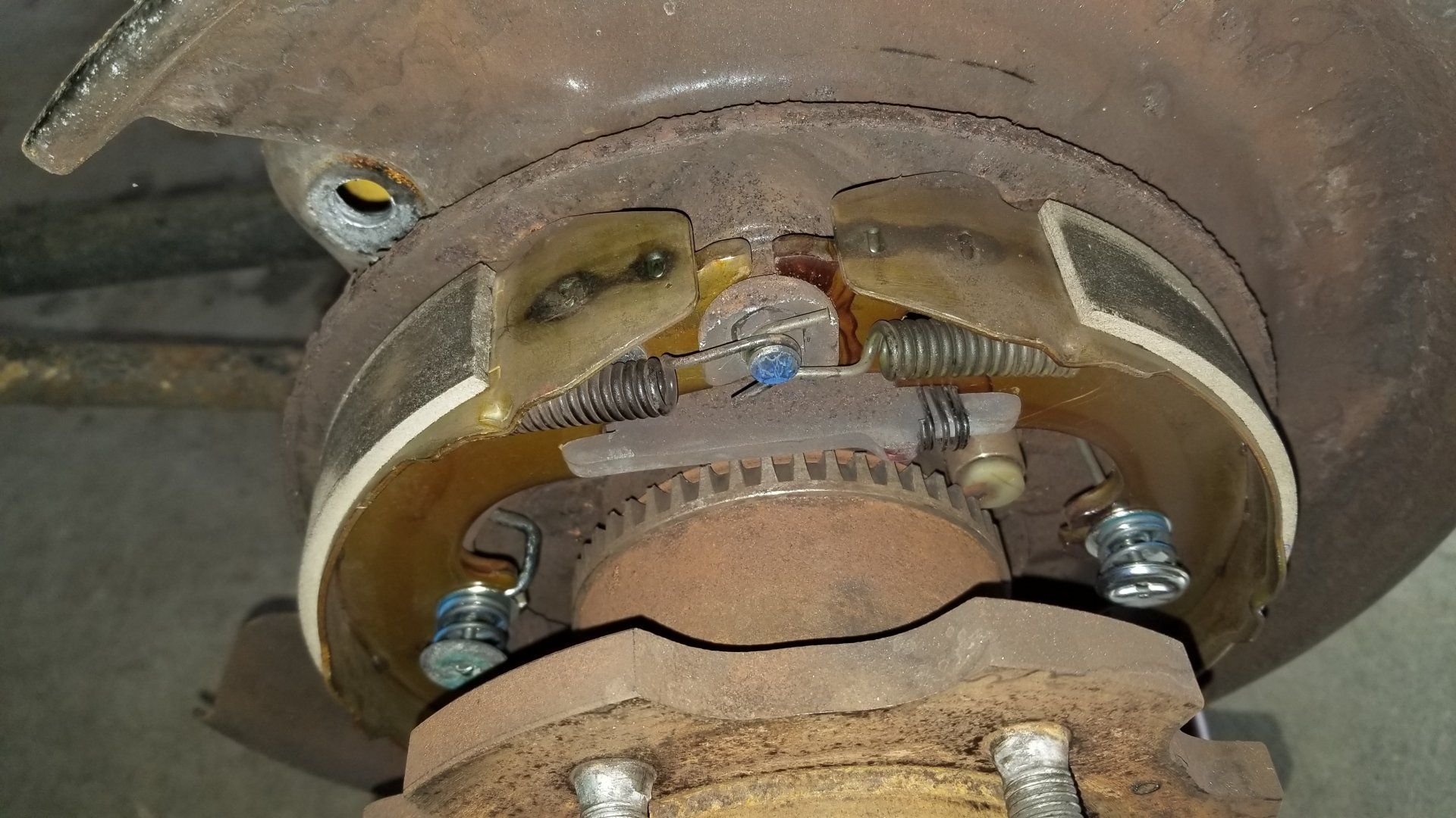

Made another attempt at getting the parking brake sorted on the LX ... NOPE. Found a YouTube video from @OTRAMM that I think shows the issue. Pretty sure the engagement arms are stuck. Tanking things apart for a 3rd time and will attempt the proper fix once parts arrive. Hoping to get this sorted and begin the preventative head gasket repair asap. Thanks to @YotaFun for the help trying to sort this out.

the bel cranks?
Maybe? I suck at the tech names for things. The part the main cable attaches to on both sides behind the backing plates or dust shields or whatever those are actually called.
I found a really good MUD link for my exact truck, so ordered fresh parts. Will then attempt to refurb the old ones for spares.

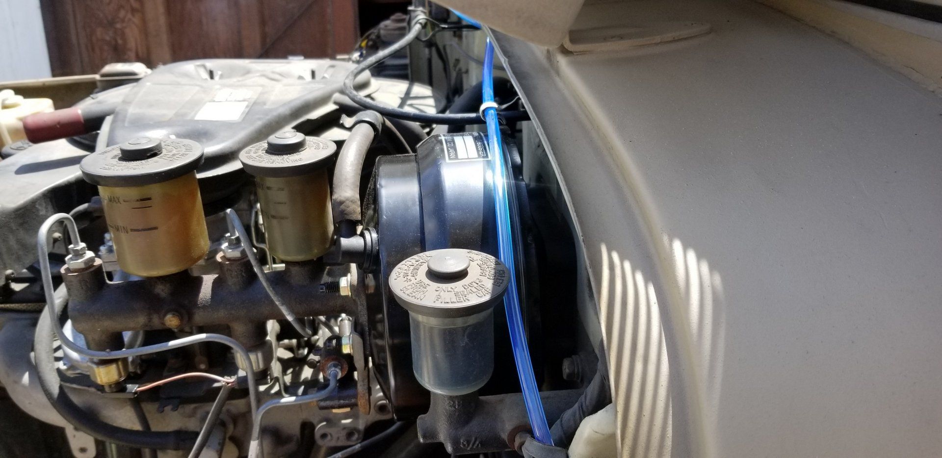

Also threw a city racer brake booster at it from a mostly pm stand point. Picked up a brake booster gauge...the pedal feels better but that's probably due to the prior clearance being a little on the excessive side.

They are currently set at fully in and are rubbing the brand new brake hats I put on. The bell cranks (thanks @brian) are stuck in the engaged position. Will get on that when parts arrive. For now, its wheeling tomorrow and then can start pulling things to do all the front motor seals and head gasket.
They are currently set at fully in and are rubbing the brand new brake hats I put on. The bel cranks (thanks @brian) are stuck in the engaged
bell
i know, i fat fingered the key board earlier...
dont bother soaking them, no amount will help. they need taken apart.
* fixed ... TY
Do they look like this on the FJ80s too?
The ones on the 4Runner, Tacoma, and first gen Tundras like these are notorious for freezing up if you don't use them. I usually get lucky with a little heat and a lot of PB blaster to get them loosened up, then I taken them apart and use emory cloth to clean them up, then use some syl-glide when I put them back together to hopefully prevent them from doing so again.
