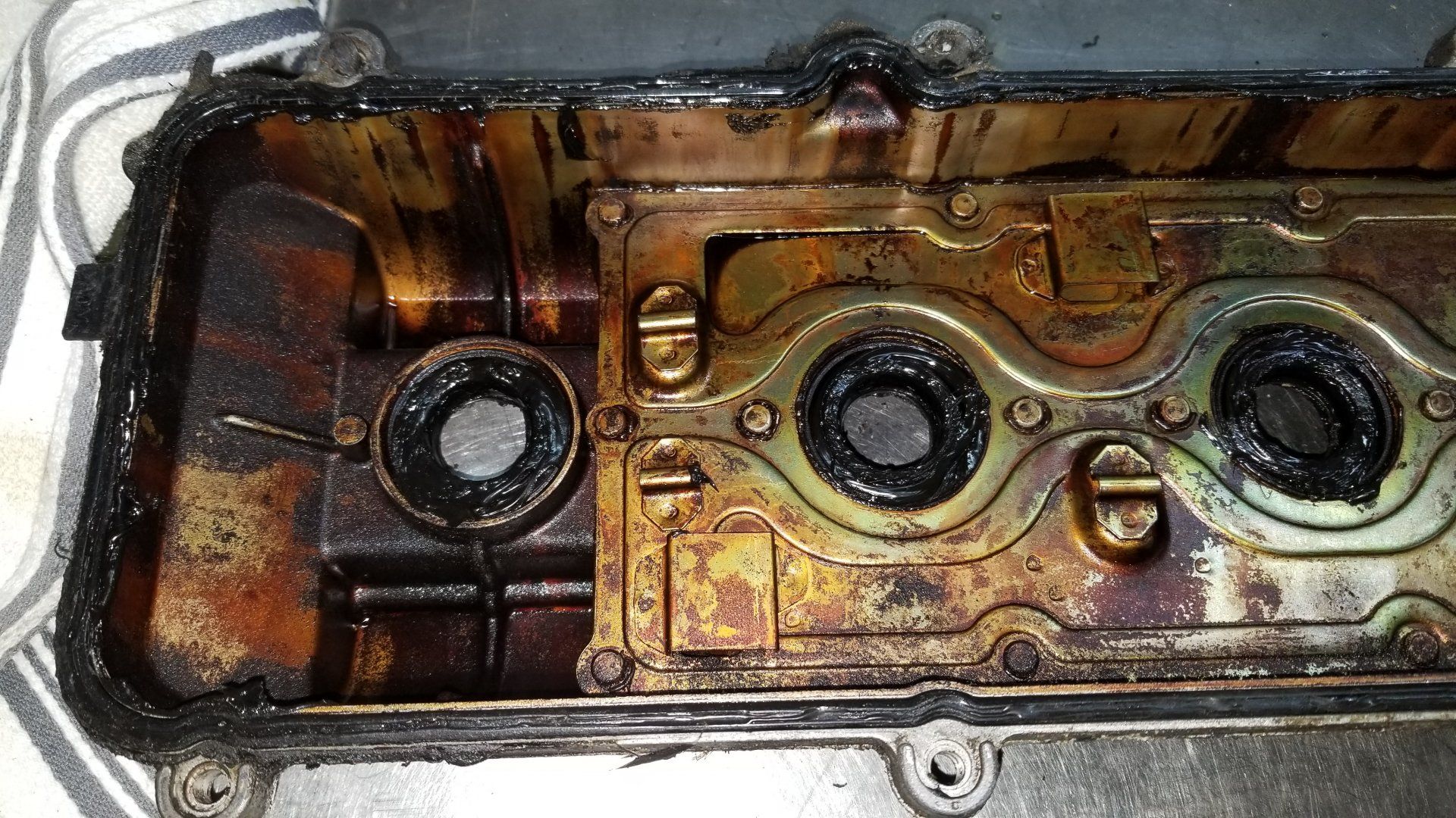

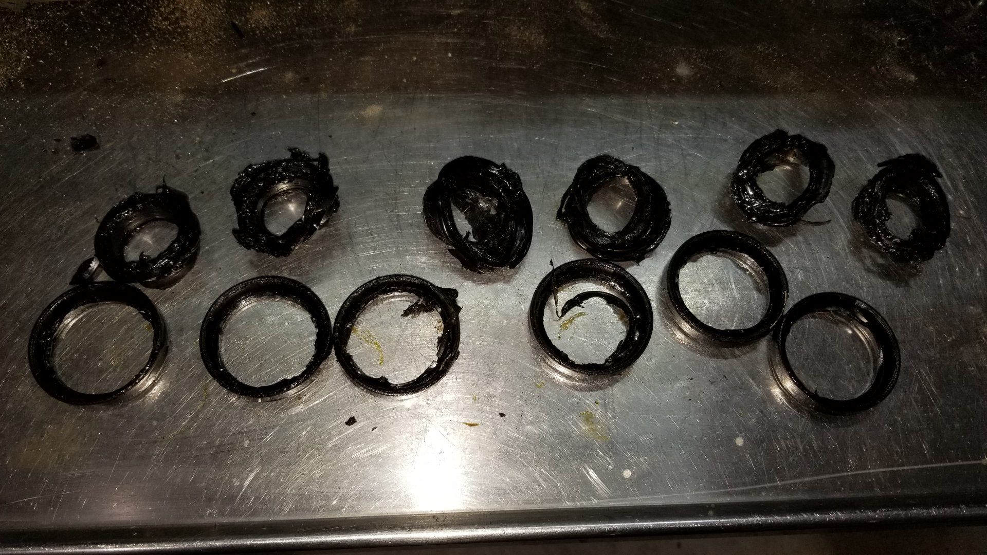

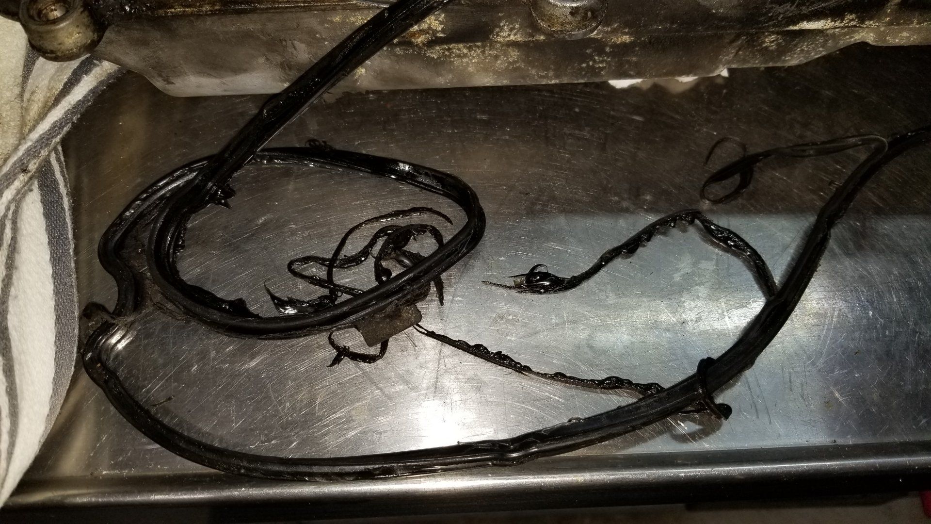

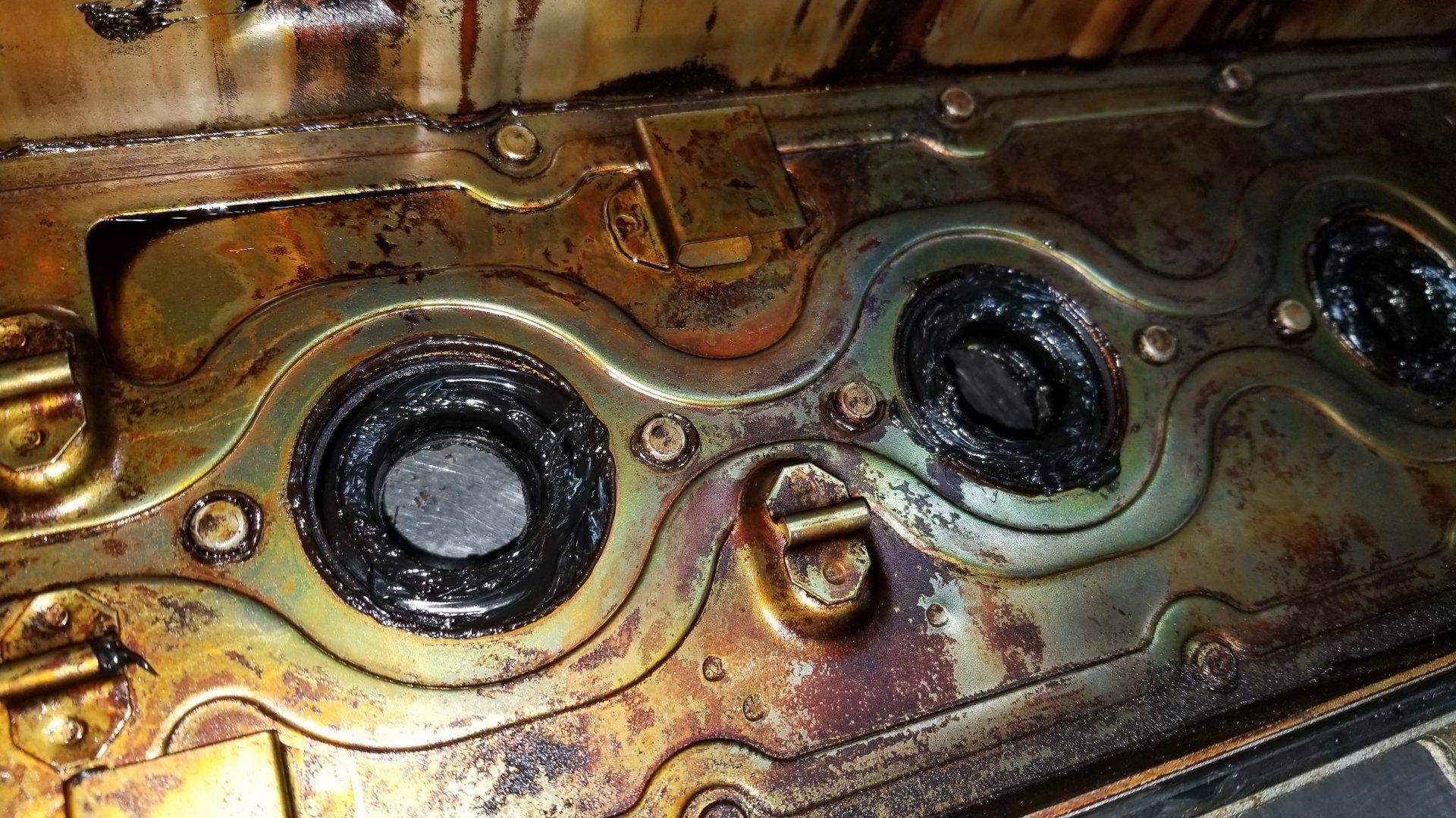

This is what happens when you ask a BMW shop to get your valve cover to stop leaking on your Lexus ... this RTV is everywhere. Like silly string. Pretty sure these have never been changed out since new. They took some coaxing, but finally broke them free.

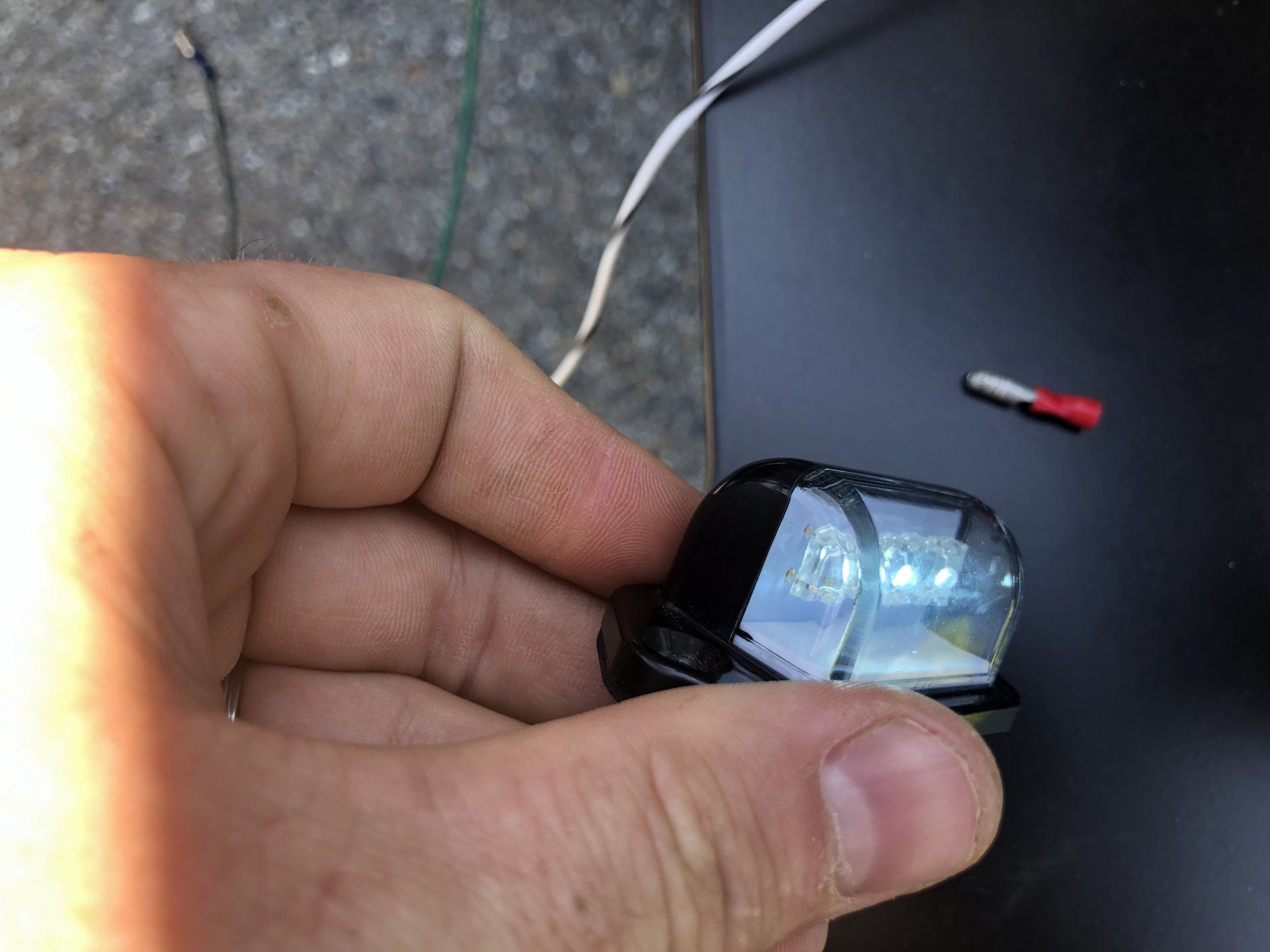

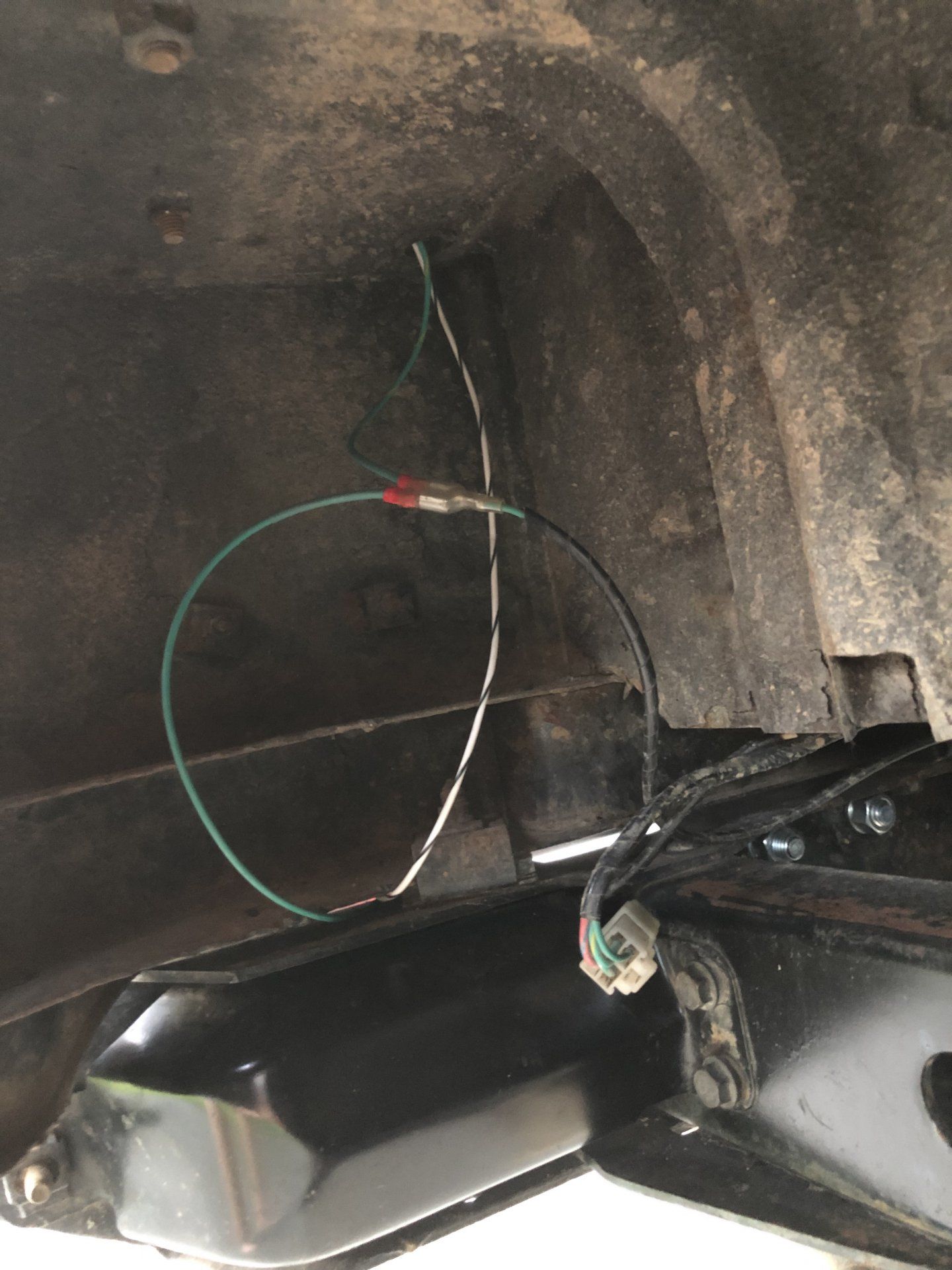

Just to prove I still do something to the 40 every now and then - I’m “street legal” again. I finally installed the license plate light on the 4plus bumper. This should have taken all of about 20 minutes but instead it took 3 hours - mostly because in the process of wiring the plate light I somehow lost my low beam headlights...and the plate light wouldn’t work.
Checked all the fuses, all good. Checked the voltage at both headlights past the relays in the IPF harness, working and switched correctly. Ran jumpers to the plate light straight off the battery to bypass the harness and switches, and it lit up. Then I checked the license plate “live” connection off the rear harness and got 10.6V. The LED plate light was rated from 10-30 volts, but 10 volts through the rear harness was a bit questionable. So - after an hour of checking electrical connections and fiddling I started the engine. With the alternator charging the headlights came back, and the LED got 12V and lit up.
Long story short, all I can figure is that somehow there just wasn’t enough “juice” in the system to actuate the low beam relay on the IPF harness, and perhaps the LED plate light needs 11V or so, despite being rated to 10V. Frustrating, to say the least, but everything seems to be in working order now...

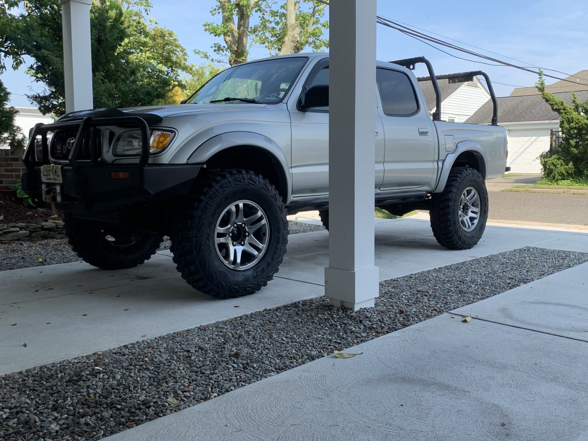

New project - 275/80/17 Goodyear MT/R mounted on sequoia wheels for the Taco. First thing I had to do was order wider spacers because the 17” sequoia wheels have .5” more backspace than the 80series wheels. ECGS got them to my house super fast. Here she is with the new wheel tire combo “stock”. Yes - they rub- a lot. Plan is to save these as Offroad set and keep the bighorns for daily driving.
Going to shave down the bumper a little in the process- here are the planned cuts.
