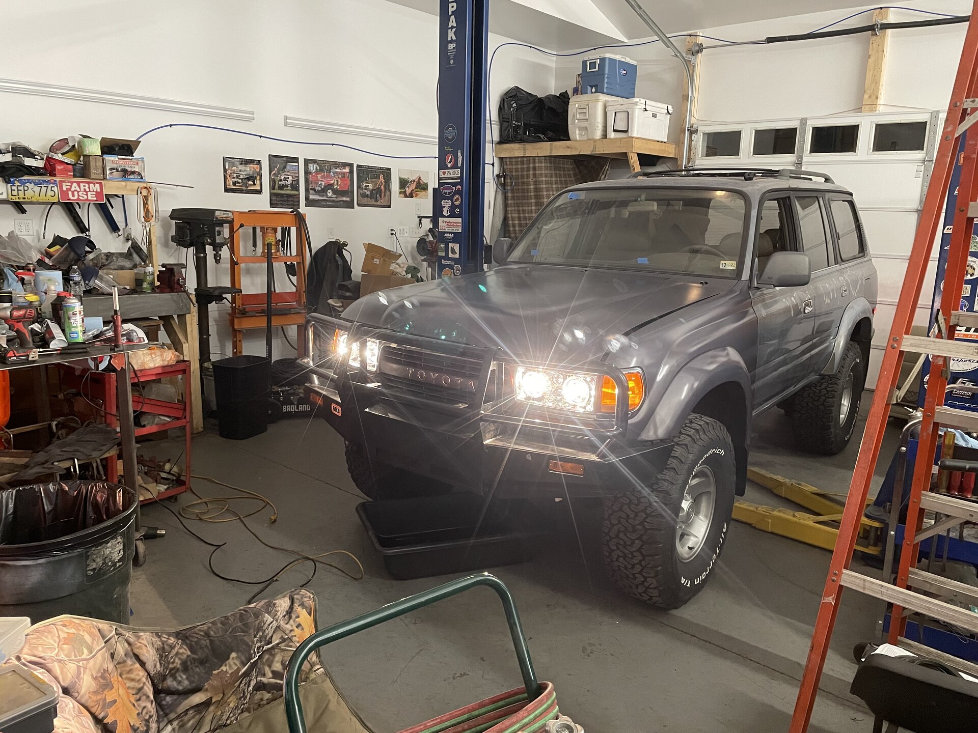

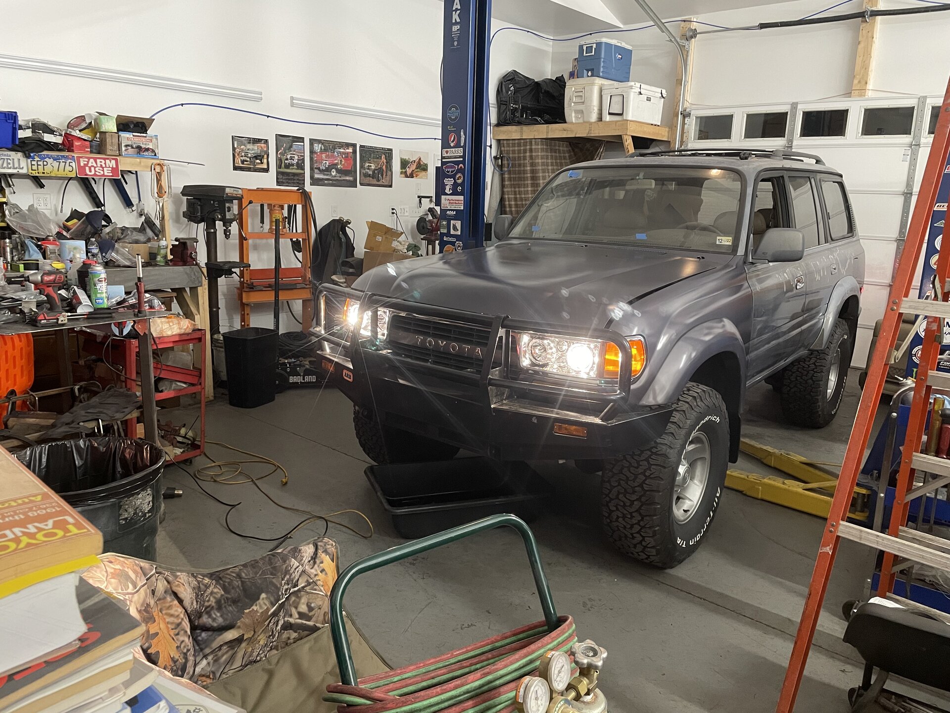

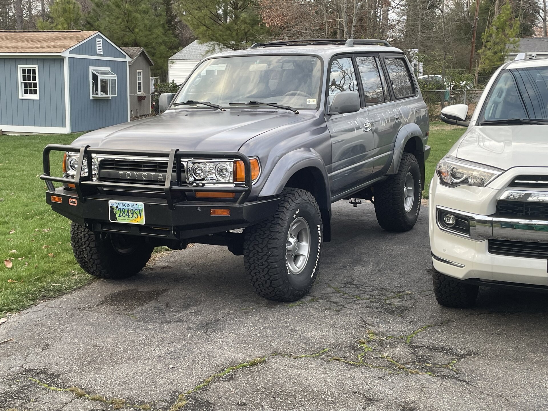

We have lights! Had to look at green on to see how to wire them up. Ended up replacing all the oem. Connectors as they were all broken and would not stay connected. A few more little things to off to get inspected!
Headlamps were not too far off on aiming. Adjusted them and will check once I get to shop.
Oh sooo pretty!!!!! Really digging those lights

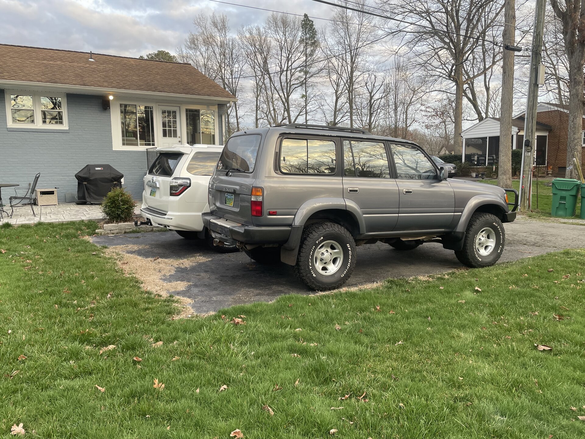

My ARB front bumper was delivered this past week and plans to install this weekend. I also picked up a used Warn M12000 and will be installing that as well. Once that is set up I may have a SmittyBuilt winch up for sale.

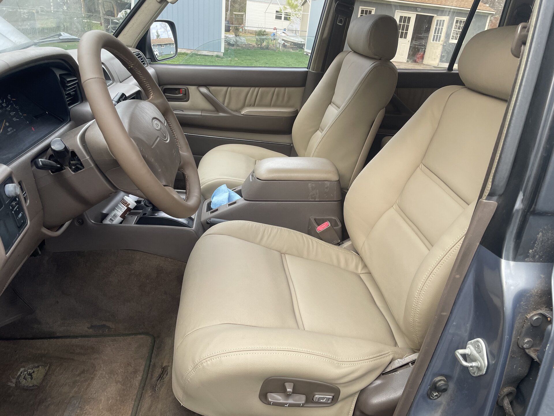

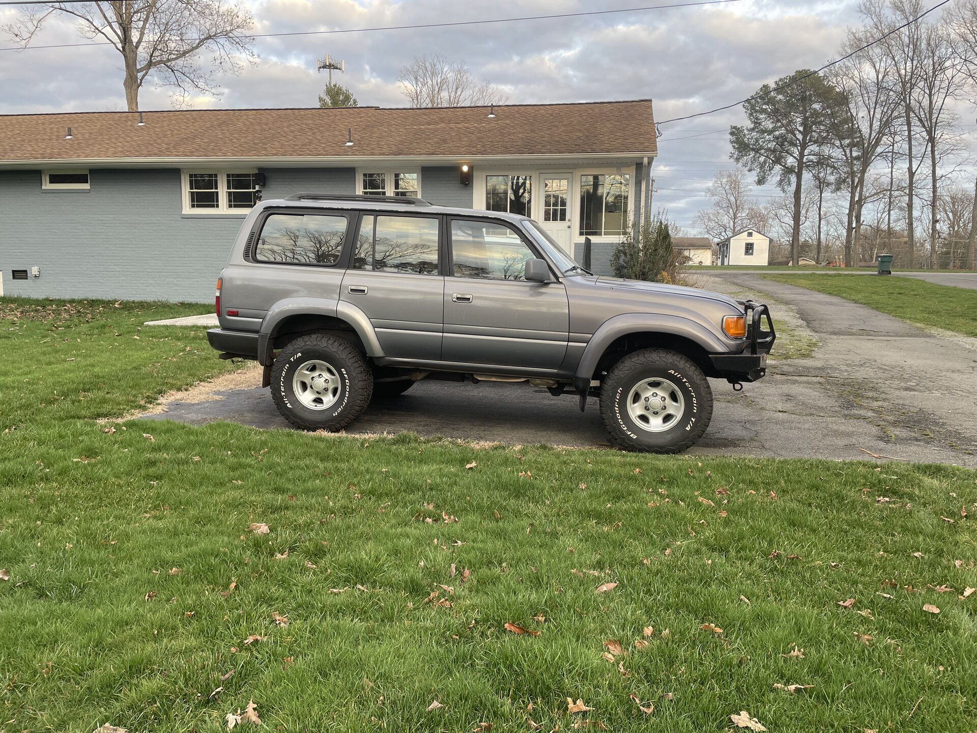

Seats in, steering wheel back on, fluids topped off, plates on and went for test drive! Will run it to work for inspection in the am. I need to see if it settles, but may need to take the 30mm spacer out the rear for something a little shorter. Still need to mount spare back in it.

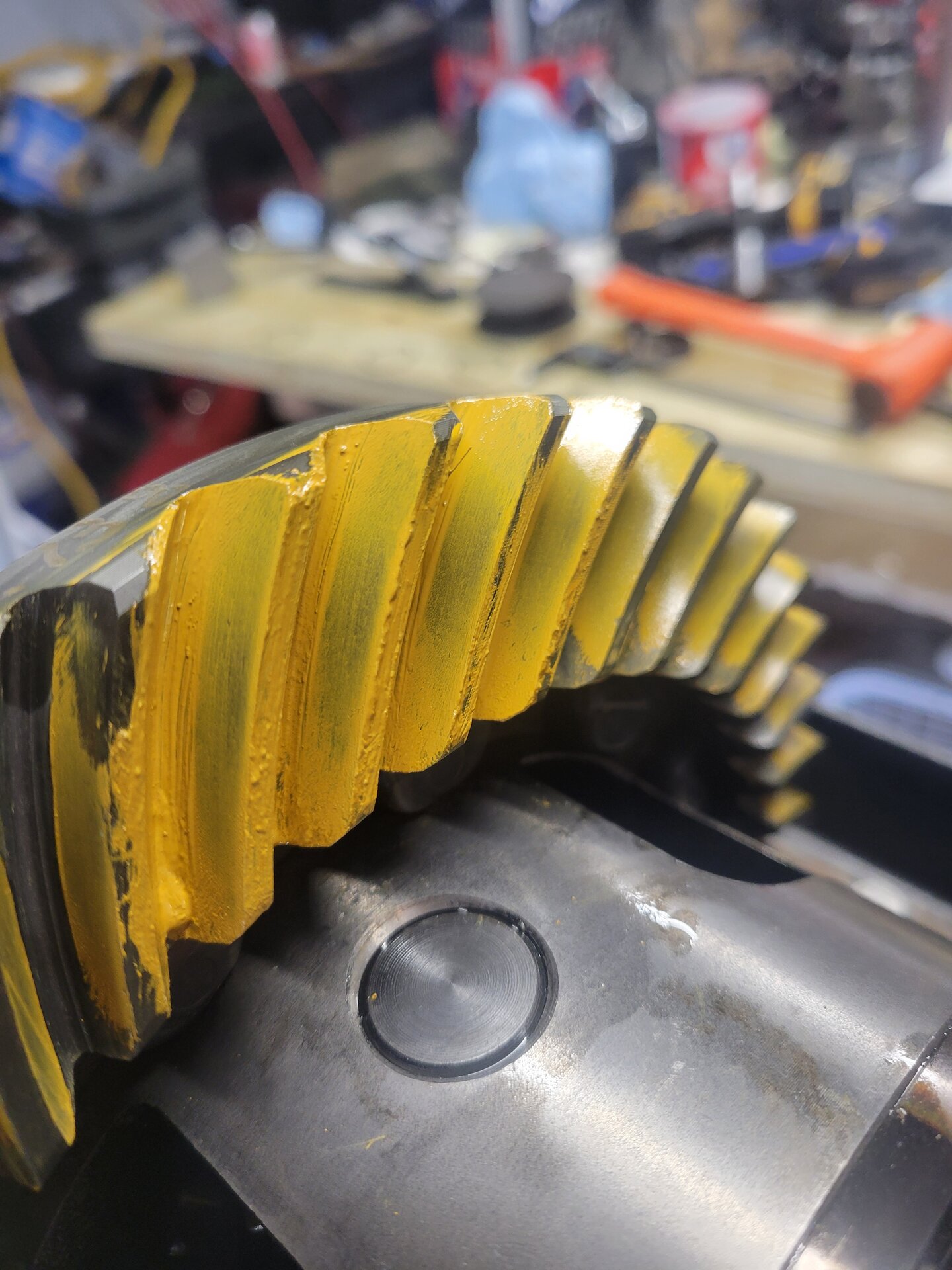

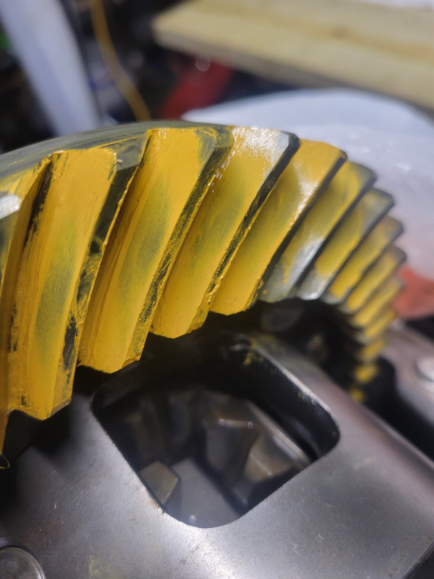

Rear diff mostly done total pre-load, backlash ect in spec. Did use Yukon crush sleeve eliminator. Carrier shims had to be changed from original. Pinion shim was good with original. Need to order new gasket for locker switch. Rear hubs are done too. Right rear hub isn't perfect, had to massage backing plate. Will search junkyards for new backing plate and eventually replace.

Some @TRAIL TAILOR recovery points on my new arb bumper. These things are beefy!

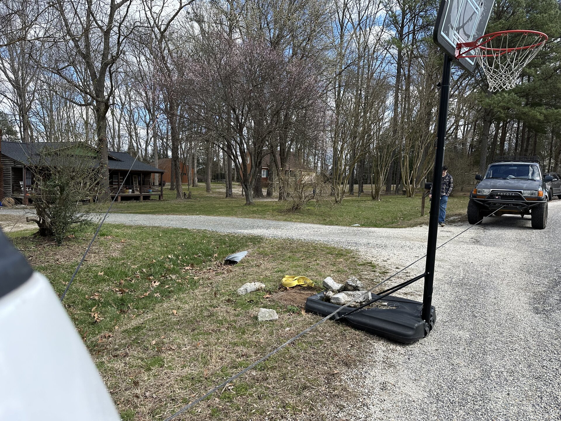

Wasn’t able to get any work on the Land Cruiser in this weekend but did use it to assist in taking a tree down. Had a narrow window between other trees and the tree was leaning the wrong way.
