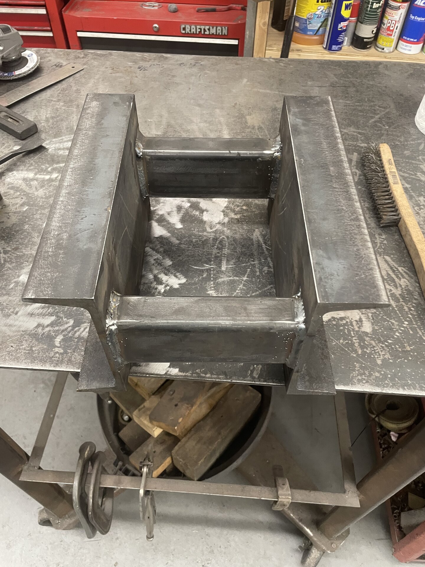

Finally finished the spare tire/cooler rack.

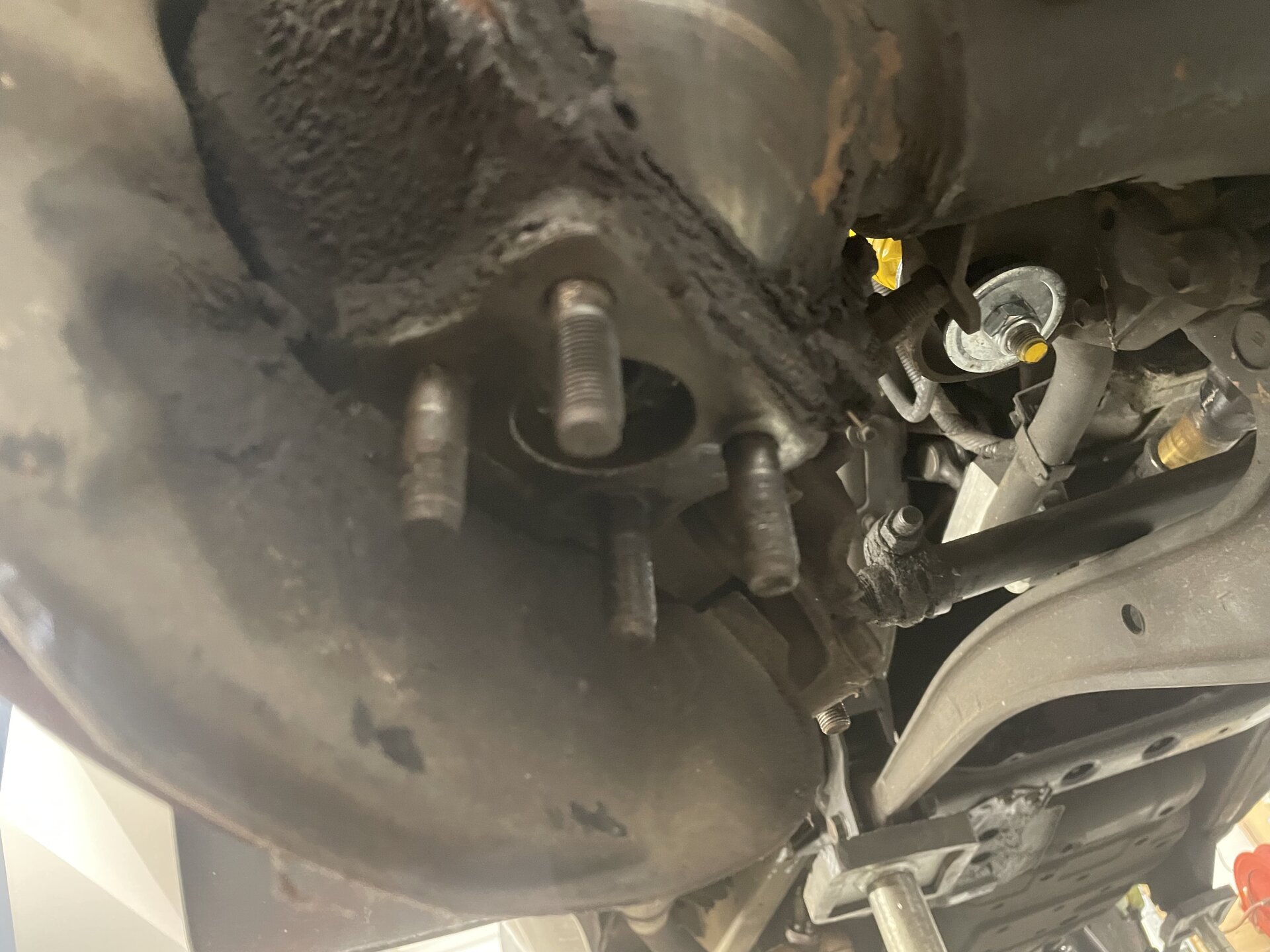

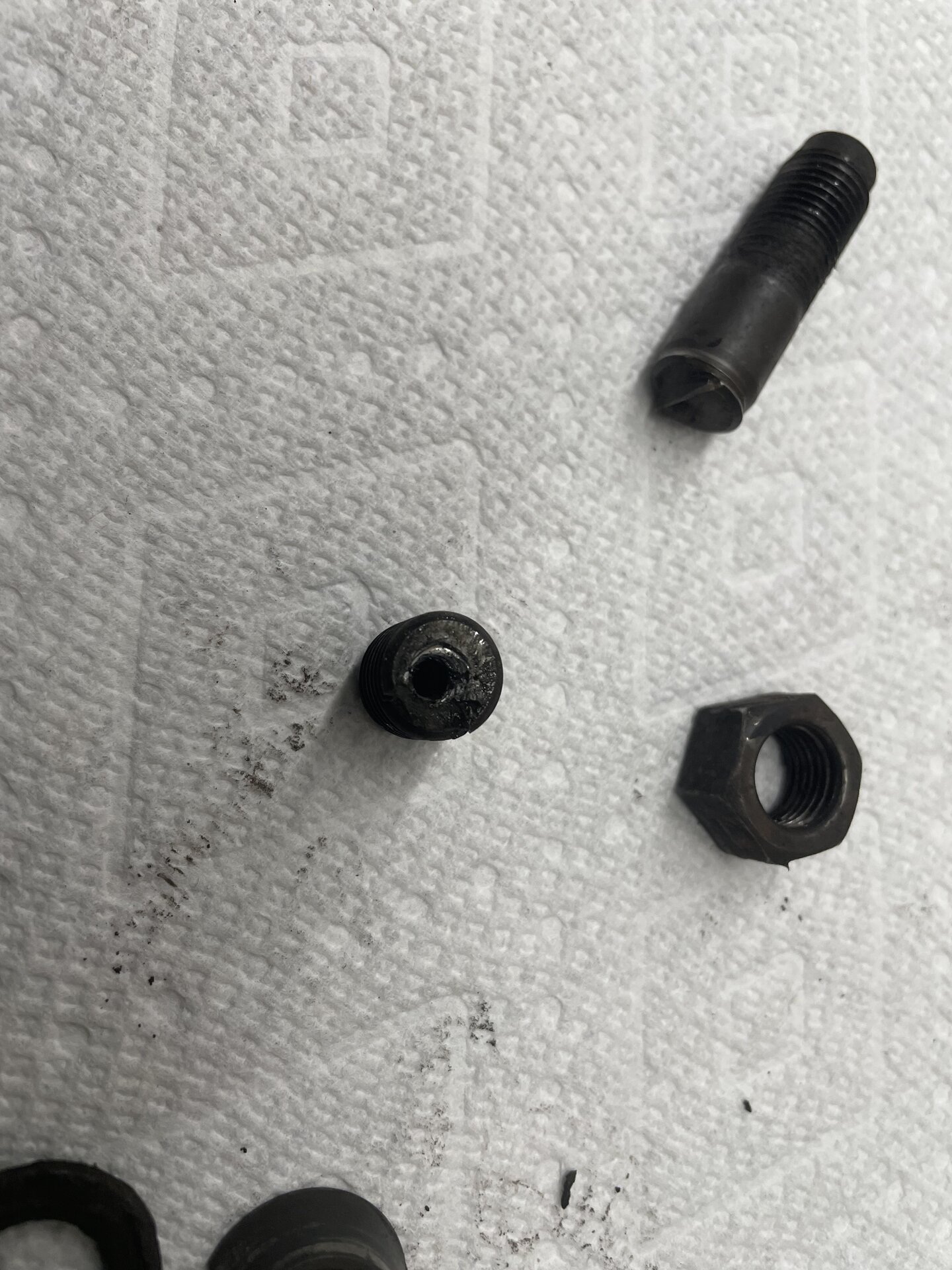

Lucky for me I hoard hardware from parts trucks. Mini truck studs are the same as an 80, so problem fixed. Now to clean and reassemble. I was able to take steering arm off, drill and use an extractor to remove broken stud without having to take knuckle off.

were you just under the truck bolt checking?
Yeah. I installed new front brake pads, now that the rotors are cleaned up from the rust from sitting. I wanted to check the bolts to make sure they were good. All the gook on them must have been holding it on. It turned easliy and then came off. I thought it was just loose. The other 3 on that side were really tight so it may have been run down too tight with an impact or something. Drivers side was good. I think the pass side can loosen due to the double steering arm and always being worked both ways??
