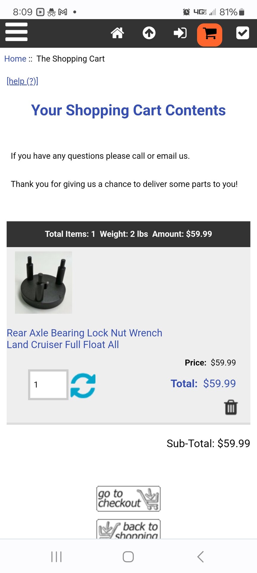

Does anyone have this tool in the Richmond area I can borrow? Don't mind buying one but thought I'd check first.

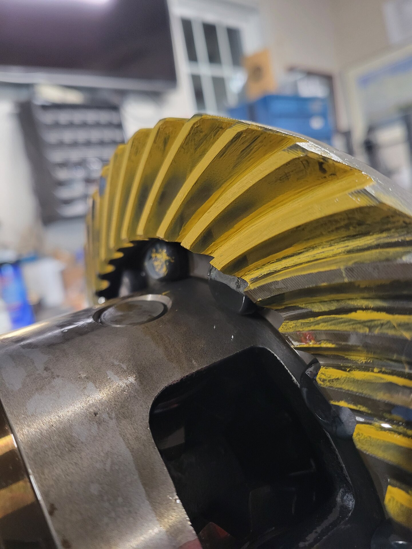

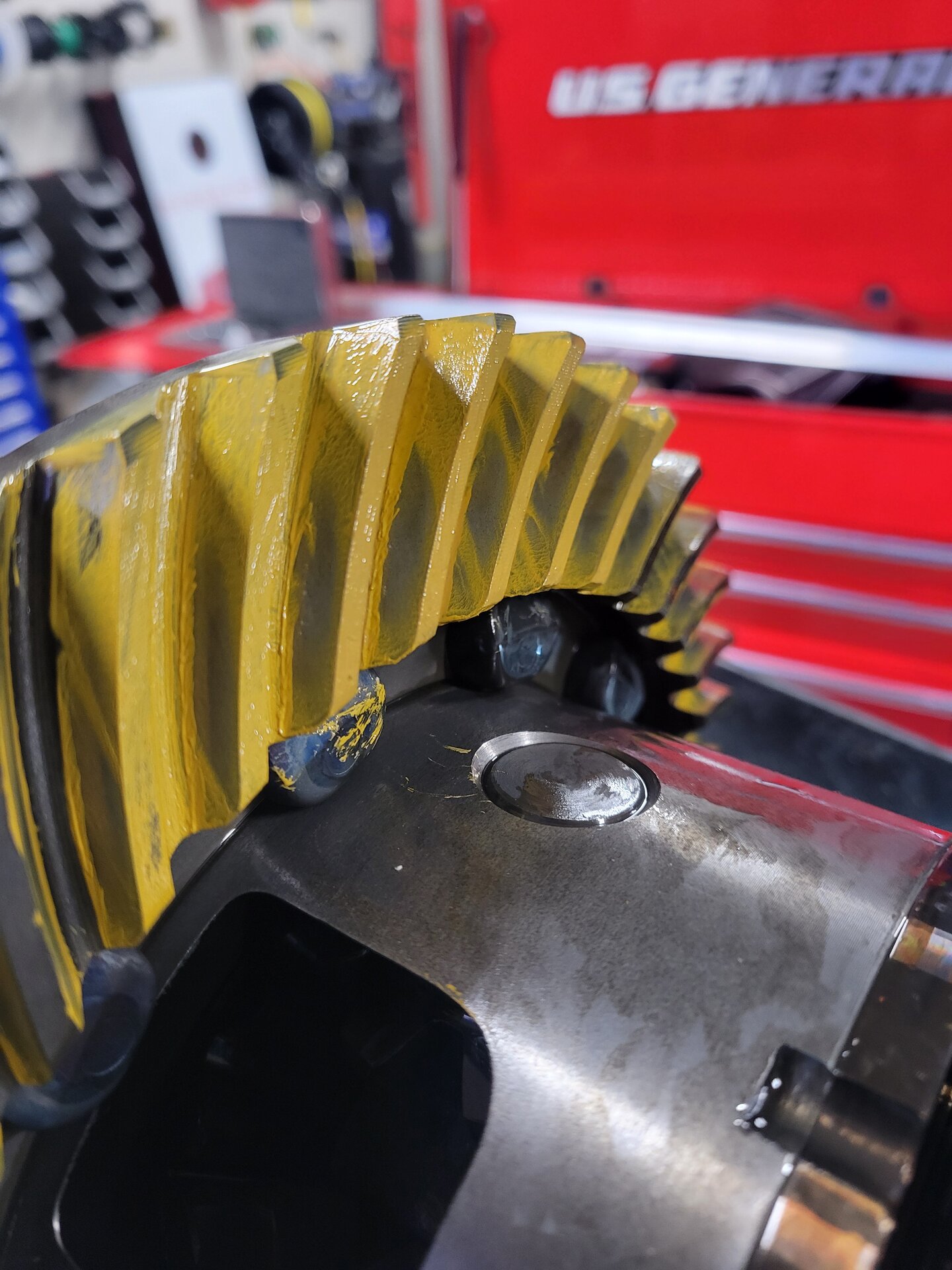

Pinon is too deep in the gear, should be more in the middleChecked original ring gear pattern and took couple of other measurements. Made simple rig to hold housing. 98% disassembled.
I agree, thought it was odd, that's the original gears. Of course doesn't mean someone else hasn't been in it before me. Had zero pinion pre-load. Ring gear backlash was top of spec. Pinion flange run out was in spec.Pinon is too deep in the gear, should be more in the middle
I have one (somewhere). I can bring it to the next meetingDoes anyone have this tool in the Richmond area I can borrow? Don't mind buying one but thought I'd check first.
I have one
Rob hooked me up yesterday with the tool. Thank youI have one (somewhere). I can bring it to the next meeting
Saweet. That also works with the 100's rear axle as well, right?Rob hooked me up yesterday with the tool. Thank you
