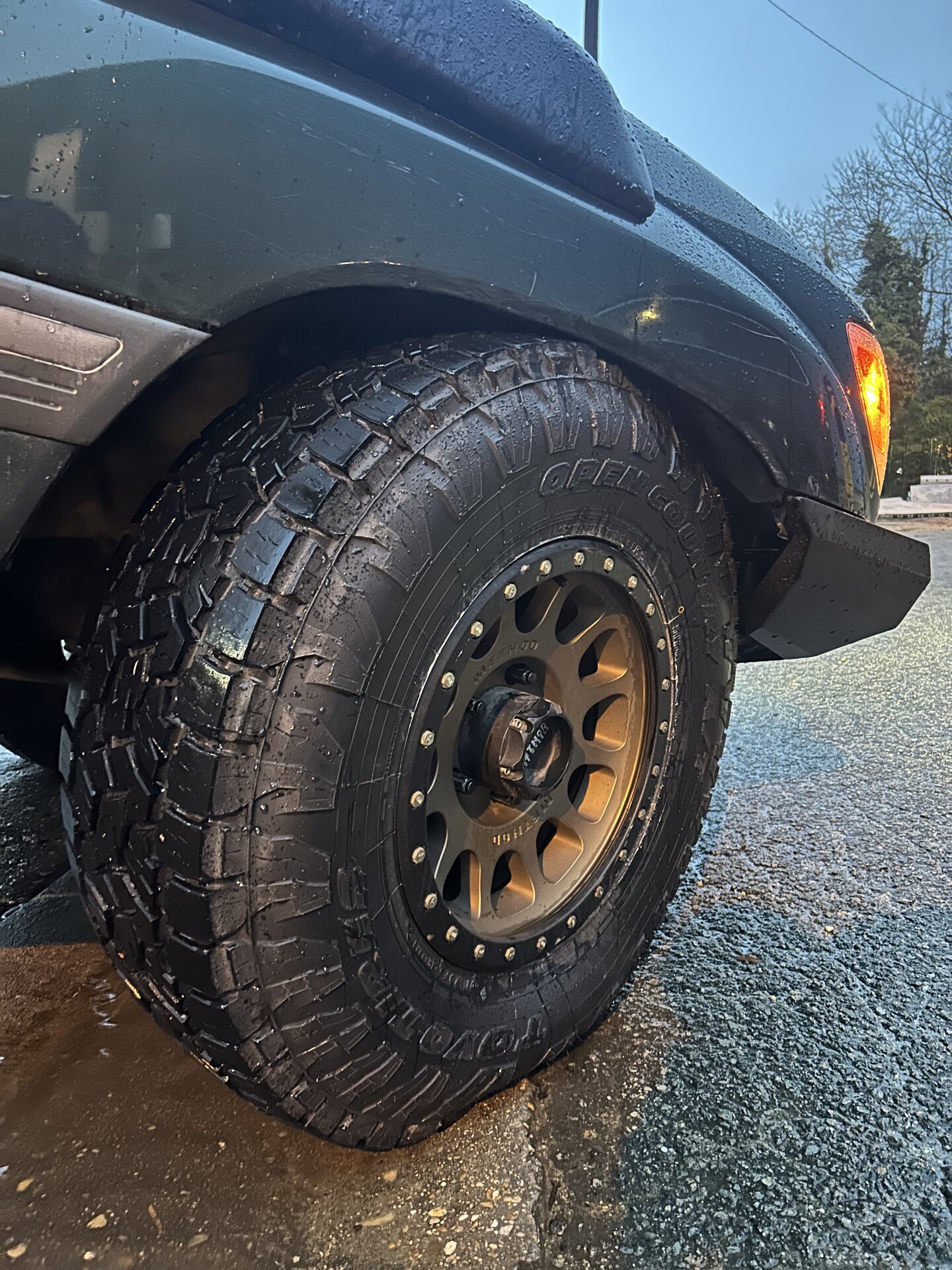

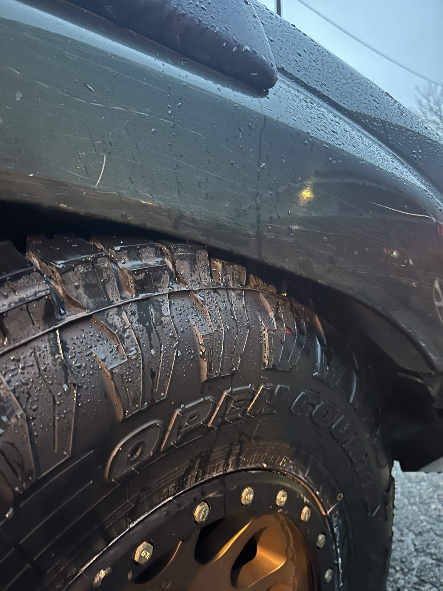

Can't come in the morning but if you are free around 12:30/1 I would stop by for a little bit. So far did a little testing on a concrete incline and I'm going to have to do something about the front.... anybody have a fender roller?? Only running at the top there on the edge. Still some clearance at the top and where the bumper is.

Do you need to extend the bumpstops? I know on the GX some people do that with big tires to avoid this situation
Yes. Learning a lot and running into some issues but thank goodness for welding haha
Exact same thing happened when I removed my factory bumpstops on the GX. Welded a few nuts to it and finally got the bolt to come out
@matzell what do you think about tomorrow around 12:30pm? I got the front bump stops extended a little bit and did some work on the fender liner and pinch weld. Hoping it's good or very close to good now.

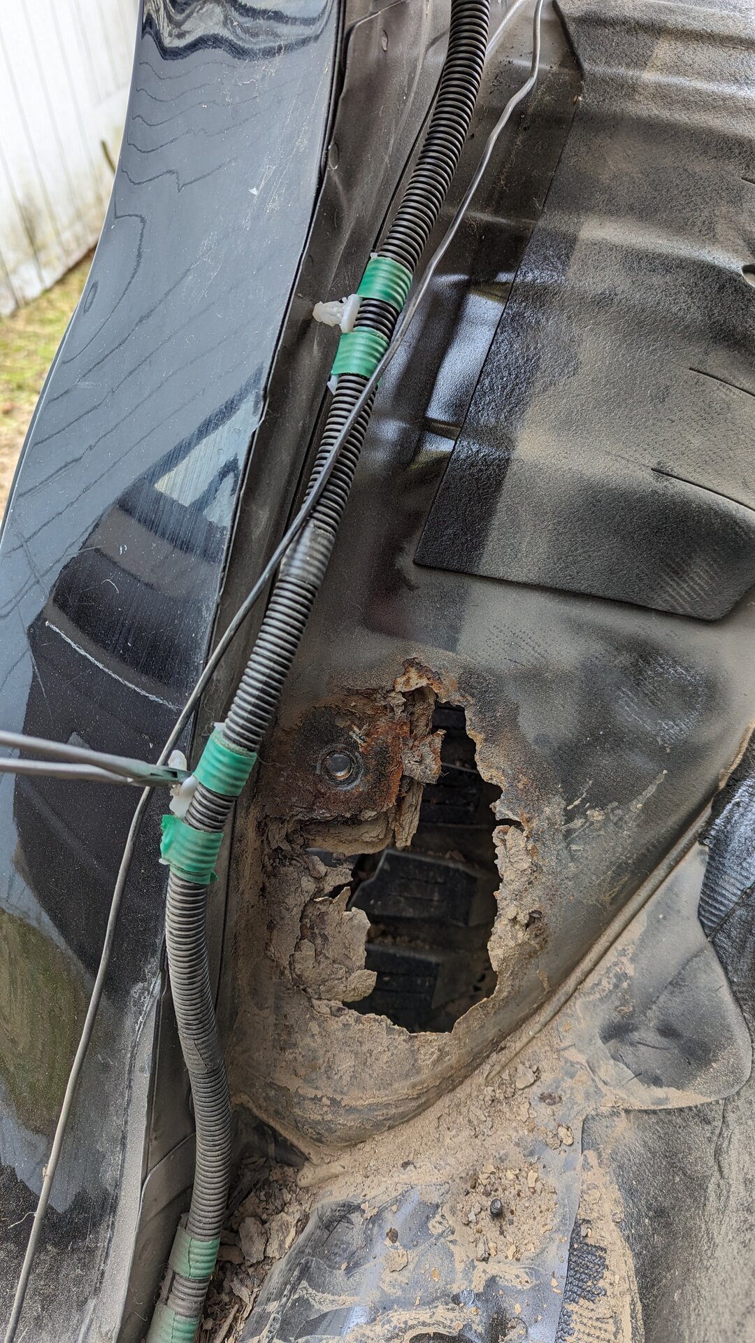

I will be off work a the shop and home by then I hope. Might be able to do something there as I will have the truck with me. I am going to be working on David;s wheel well repair.

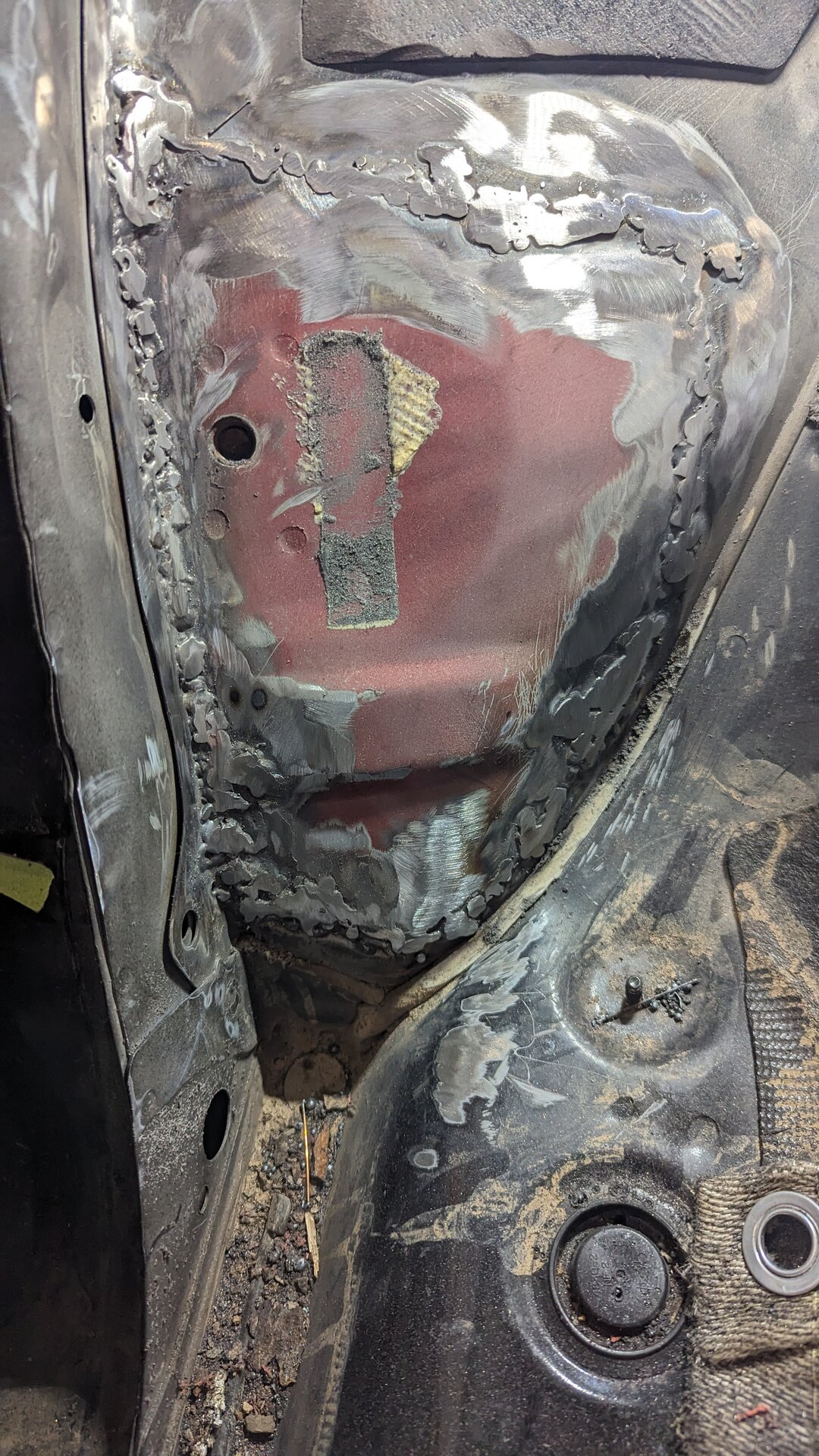

Welding sheet metal is never any fun... With Davids help we used a copper heat sink to absorb some heat and flashlights to look for holes. Once we got it all welded solid we did a little more sanding to the inside to clean it up. I think David has it primed and will finish it off.
