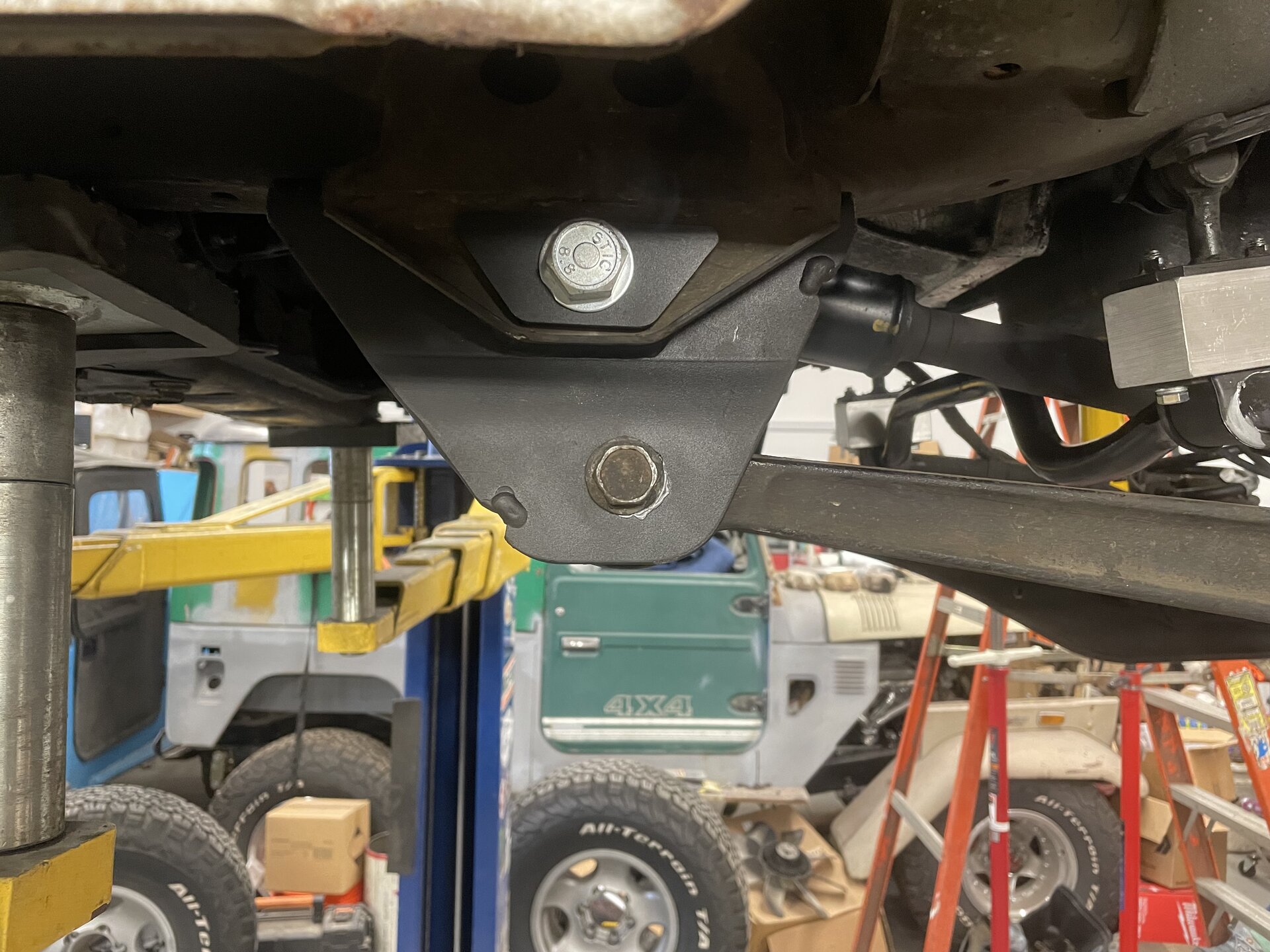

Looks like we had several folks working on rigs this weekend including me. Was able to lower my front diff to replace fully the diff breather hose. swap out the rear PS diff mount along with chiseling out the front diff mount and pressing new one in. Change oil in the T4R and Outback. Had the boyz working hard Sunday afternoon ;)

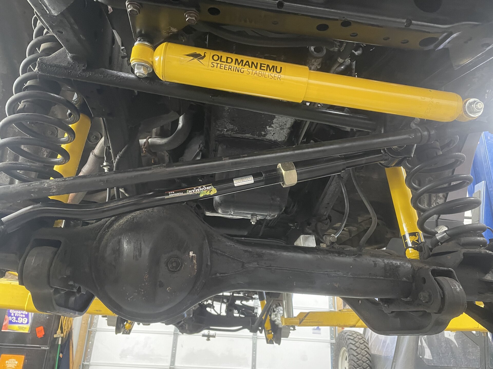

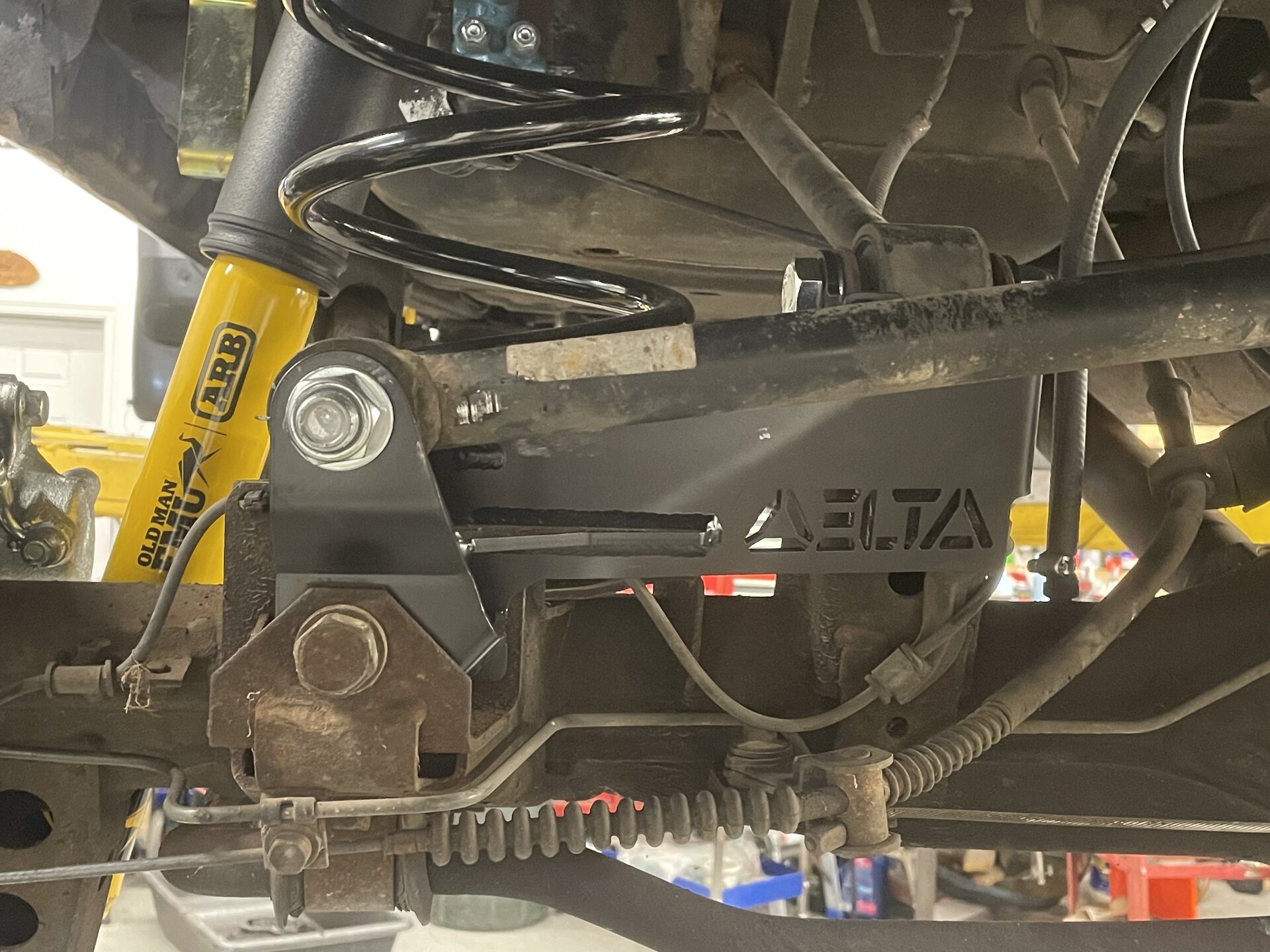

Back on the tires again! Ourisman Toyota had 8 of those sleeves in stock, so of course I had to put it on and see how she looks.
I also picked up my seats. New Toyota cushions top and bottom and "Lseat" leather covers.
For reference. This is a front OME J spring lift, rear OME medium rear springs with a 30mm spacer. 315. BFG's

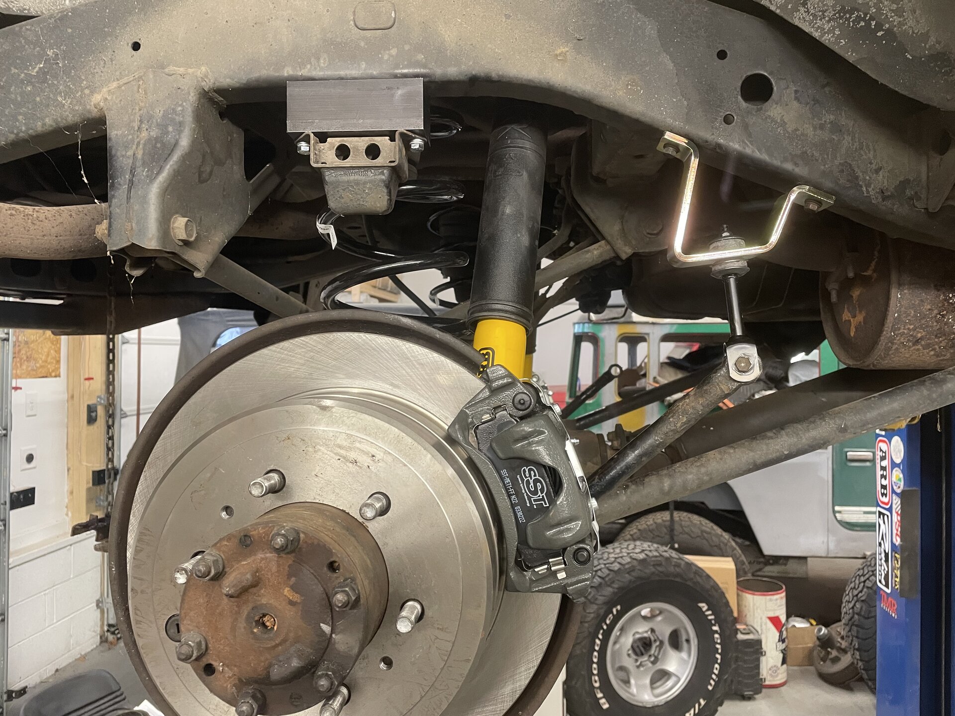

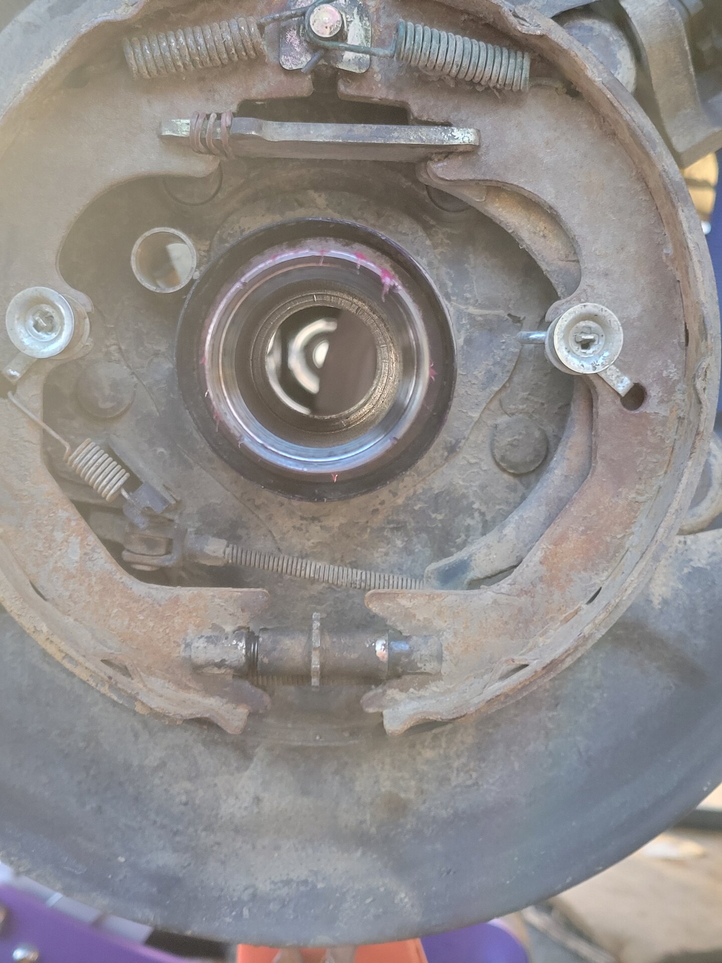

Tried to finish right rear hub this afternoon. The hub is contacting/dragging slightly on the part of the oil seal that is attached to the backing plate. That part is not centered on the spindle. I have 1/8" difference between narrowest part to widest part when measuring from the spindle to oil seal lip. I don't see anything obviously bent but perhaps I'm just missing where the issue is coming from. The question is, is the backing plate/oil seal bent or is the spindle or just loosenthings up and try to make small adjustments? I didn't notice any issues on opposite side. Thoughts?
