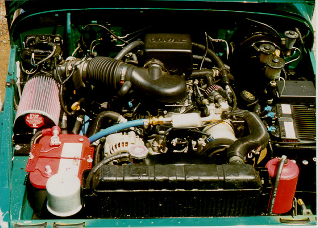

This is my temporary eco-friendly (recycling) fix. :D
Done
Put one in from Baxter auto in Portland. 7.99 for the reservoir and 2.00 for the hose. About 1/2 hour and 4 beers later . Wallah!
Well sure enough I had to fawk with it!. I installed the overflow jug. I noticed the rad cap was releasing the antifreeze at too low of a pressure. (I didn't measure it , it just seemed to come out when it wasn't very hot) any hoo. I got a new 13 lb. Stant rad. cap. well now I have a lower hose leak with a big bulge. It found the next weakest spot!. I'm gonna replace all the hoses today and hope my little piggie stops there. The next thing would be the radiator and or heater core then maybe the head gasket. I hope it stops!
