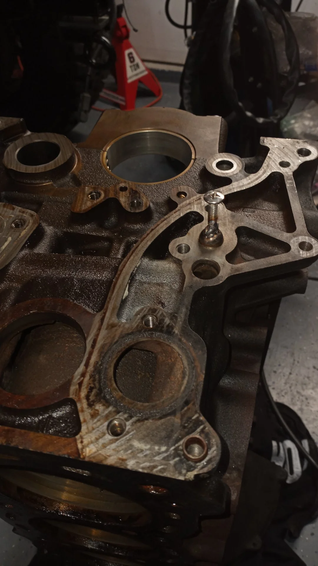

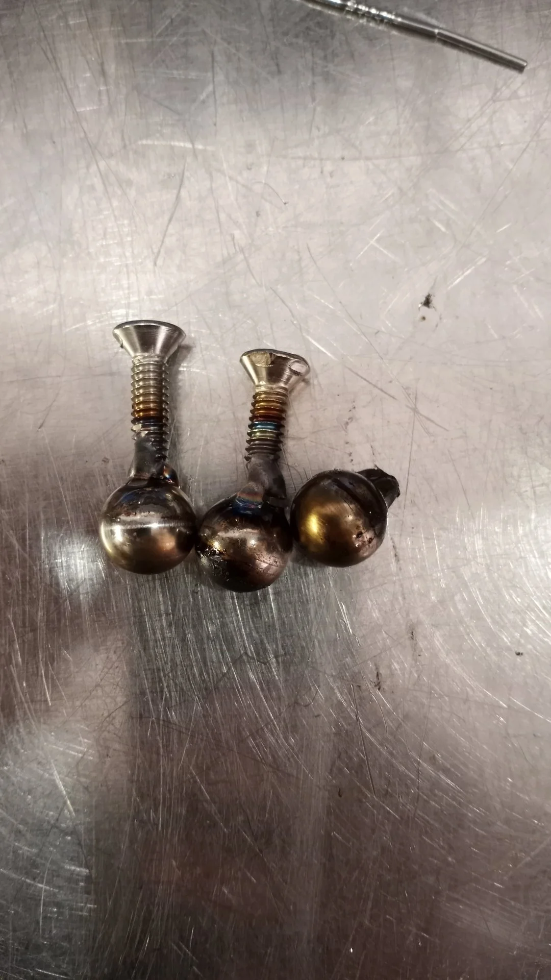

Pull yer balls and clean your holes.. errrrr yeah... hahaha! Figured I'd do as much as I can so I don't have to pay the machine shop. But seriously. If you ever rebuild a block you need to yank all the oil galley balls and clean the passages with a brush there's tons of gunk in there.. didn't do this on a motor a long time ago and it wasn't pretty..

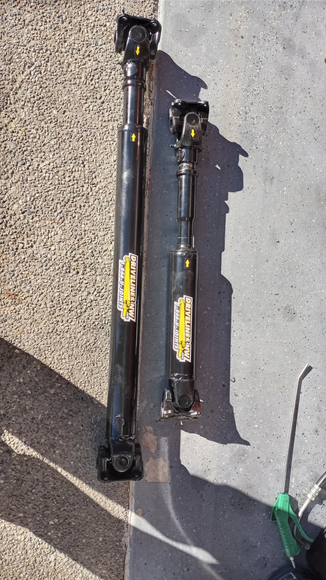

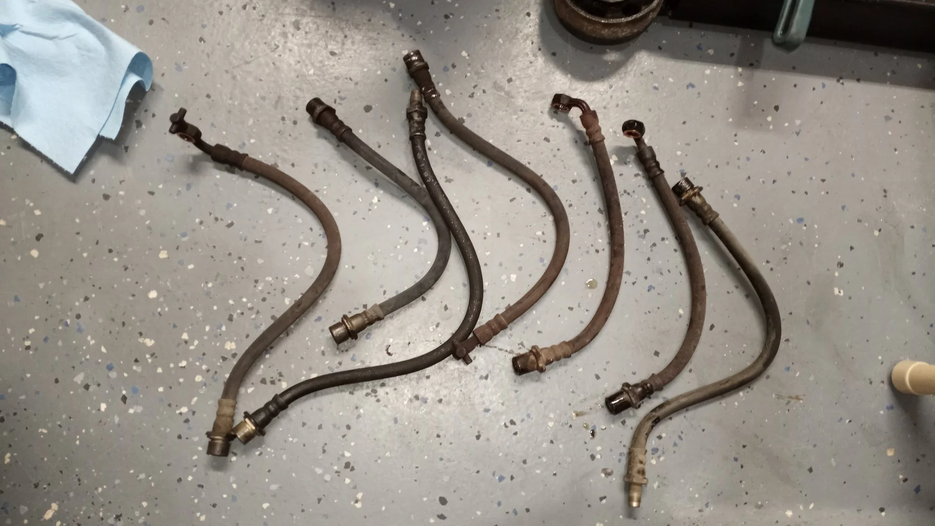

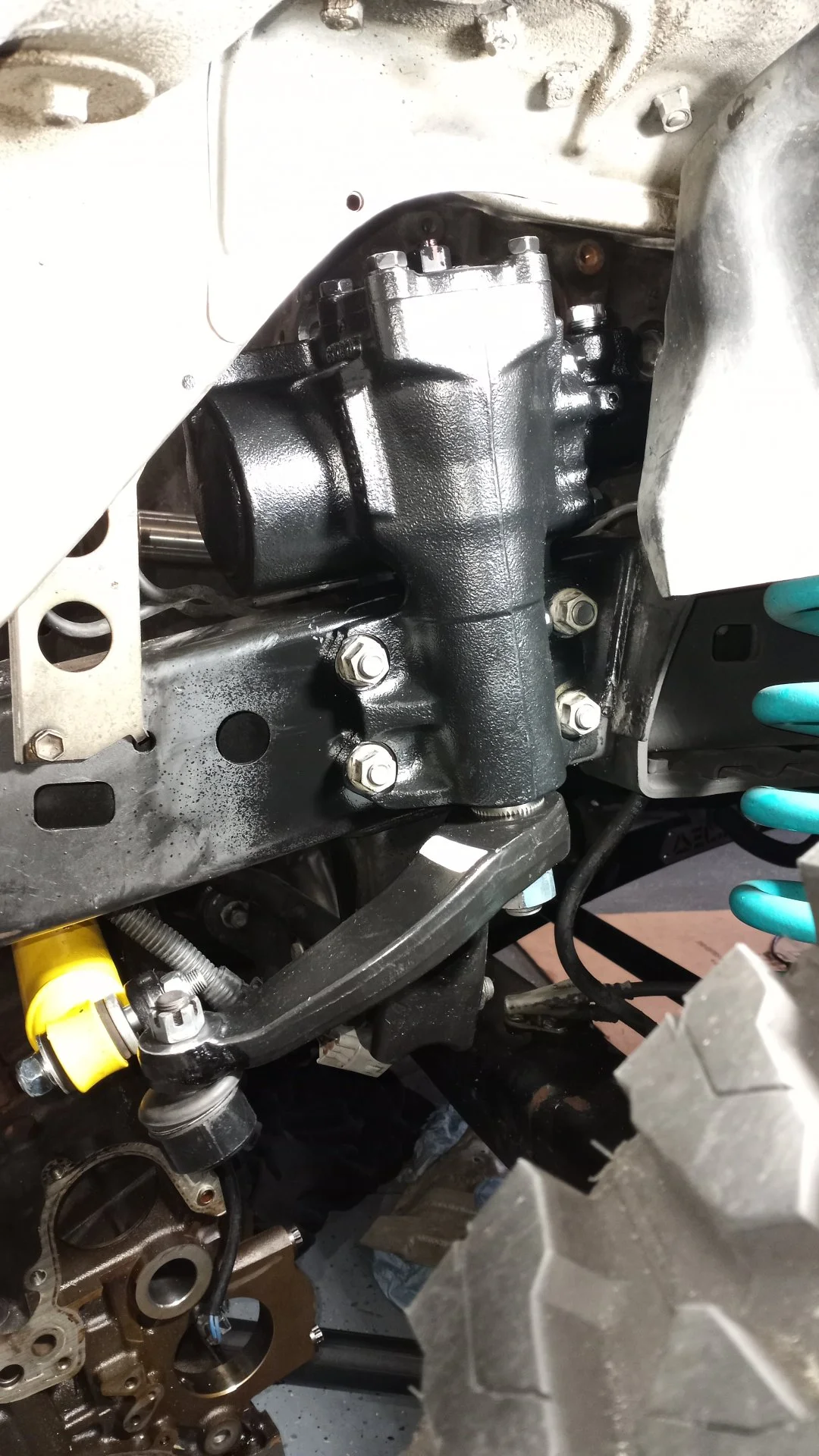

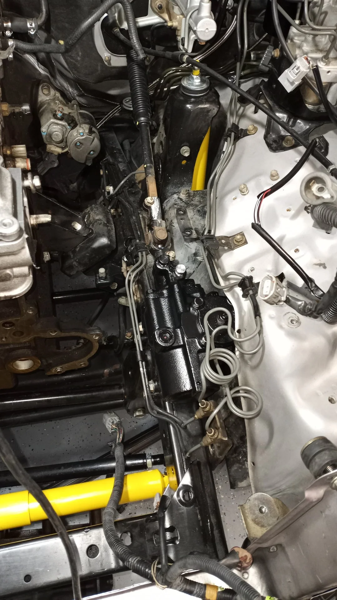

Been a bit but here's a progress report! Finally got my block to the machine shop last week so that's huge... I was checking in with 3 different shops and my #1 choice finally had an opening, all shops were 2-3 months behind... got the trans cross member all modified for the new mount location. brake booster/master cylinder/all brake lines(longer toyota lines) replaced and bled and replaced the rotted out steering shaft seal on the firewall. Replaced the throttle cable. Got the driveshafts re-tubed to the proper lengths, balanced and replaced all u-joints with new toyota units. New oem steering box with the updated 105 parts has been installed as well. Flushed the front and rear heater cores with CLR. Finished the mods to the new oem engine harness, deleted and added the necessary wiring for the haltech and turbo stuff extra sensors etc etc ect...now I am in the process of test fitting and reinstalling the wire harness protection. Modified a 100 and 80 series t case shifter to fit the new location, got the trans shifter interior base plate modded. I am currently making new battery/ground / power wires for the 130 amp alternator. Also started welding up the exhaust. New fuel fuel pump (walbro 485) and new sending unit installed, along with ptfe fuel lines, feed is a -6 and the stock feed is now the return line.
