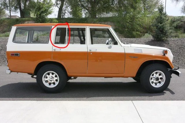

I circled it in this picture. I also need one of the metal bars that is in the door between that fixed window and the roll up window. My doors were all taken apart and one side is missing.

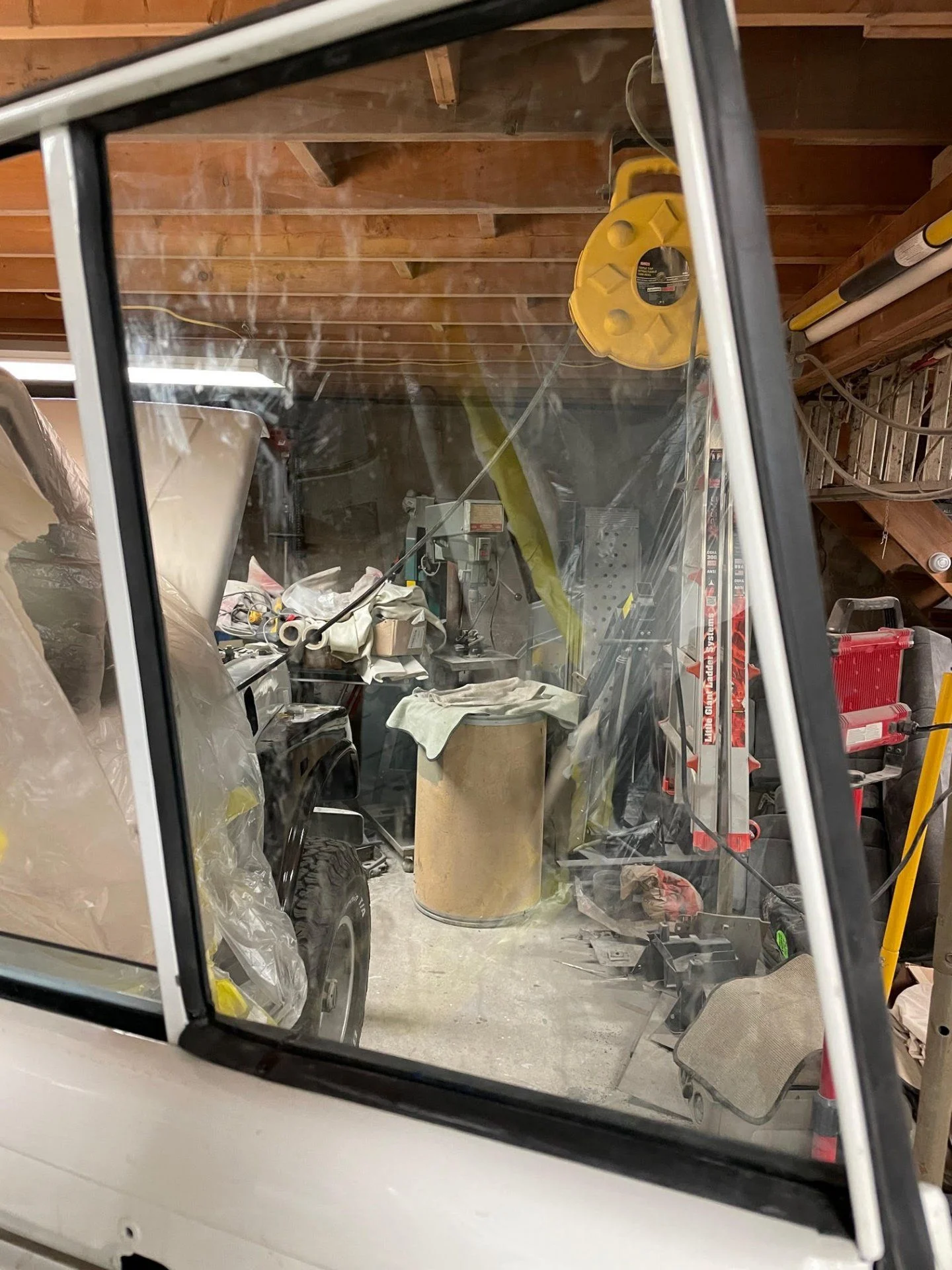

Has anyone figured out where to source rubber for the rear 1/4 panel windows? Or an alternate source for the early vent window seals? Without replacing the entire door for one without the vents...I like them.

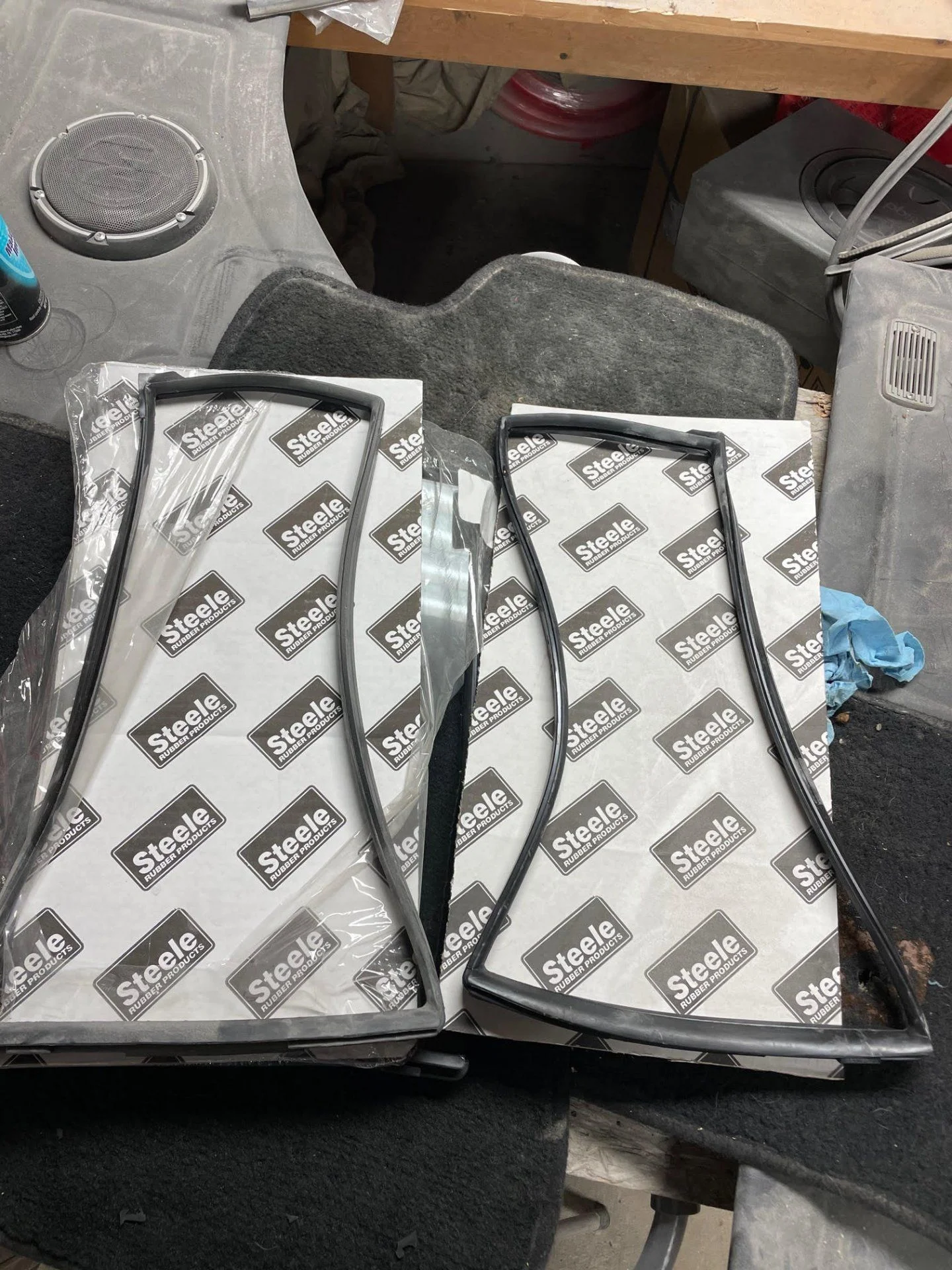

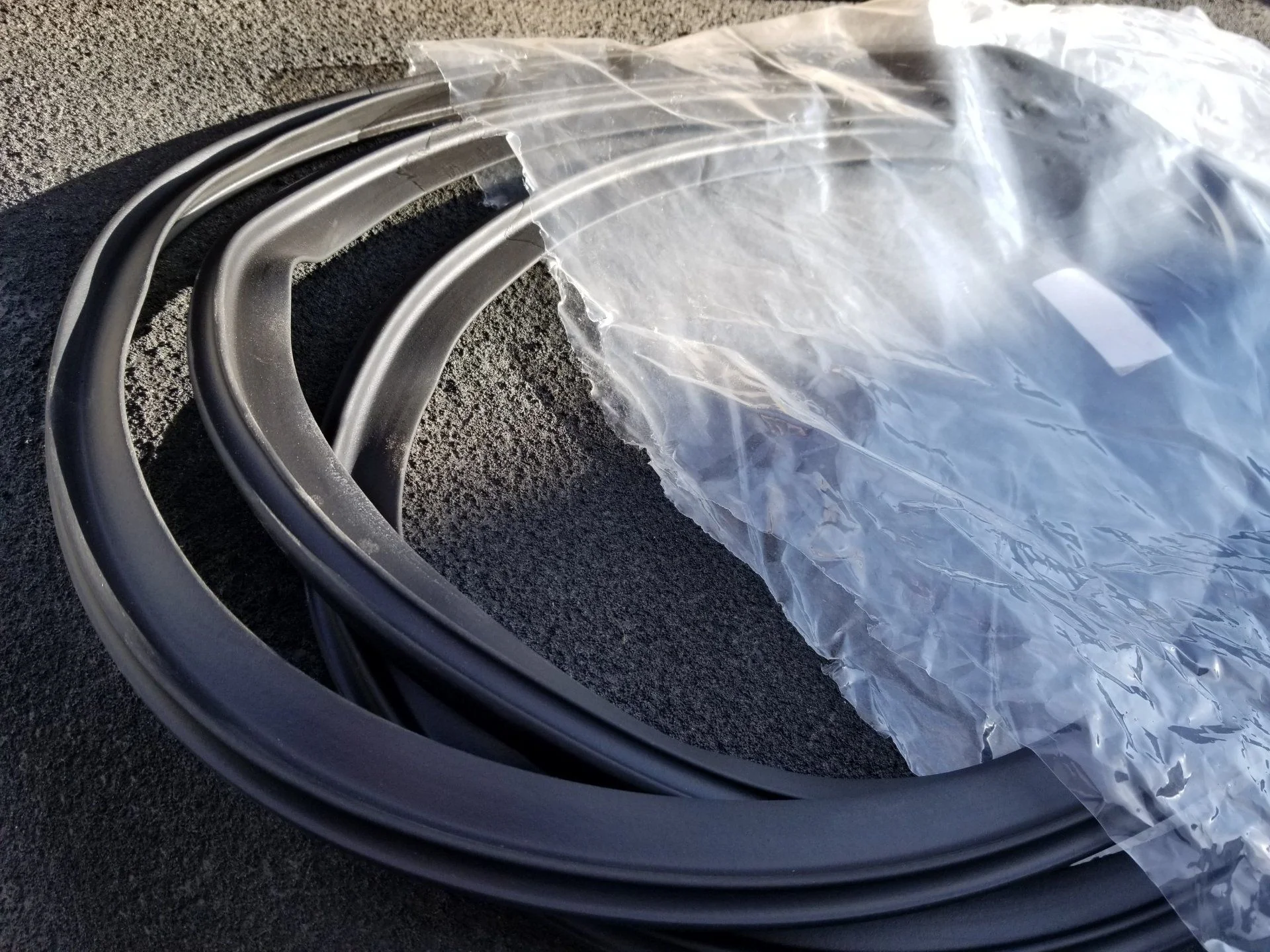

This is the best I could come up with at this point.
Noted Steele Rubber was selling similar rubber but not the right dimensions. Wasn't cheap, had to buy two sets. Figured we could use pieces of both to make one for each side. The profile worked. Unfortunately the only way to do this is to splice it. The fit is tight, made splices as tight as possible, should be weather tight?

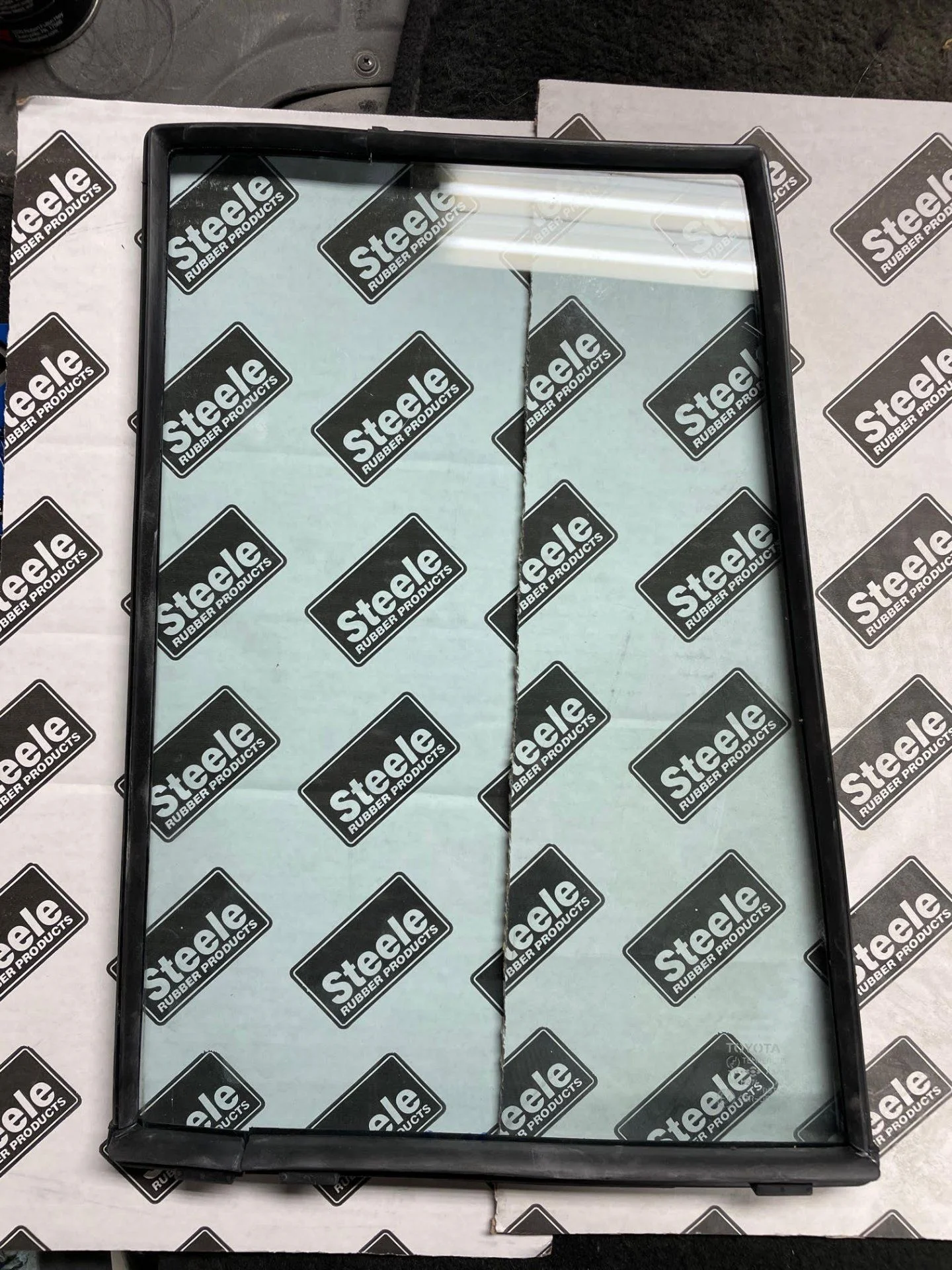

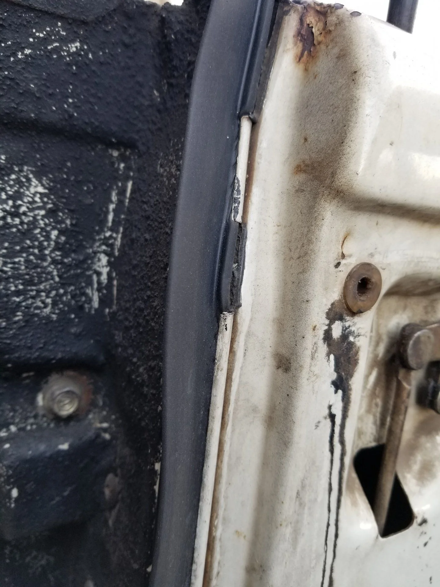

View attachment 2614315View attachment 2614317
Now that seems to be a good solution even if a bit pricey. Thanks!

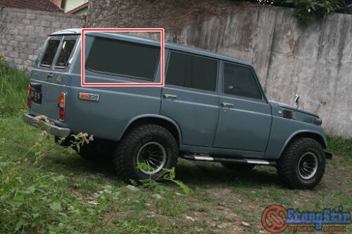

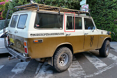

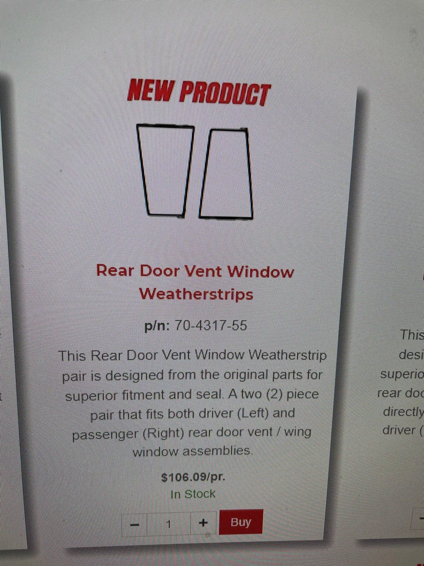

Not sure I would take a flyer on these given the source but thought I would throw them out here for information:
I would definitely use Slocruiser on the cargo window but just for completeness:
And just for @gonzopancho :
I 100% need the quarter panel window rubber. Been checking with John at SLO but out of stock. I was planning on making two out of 4 smaller pieces from Steele Rubber products, but maybe I will try these from Indonesia. It’s only money!
