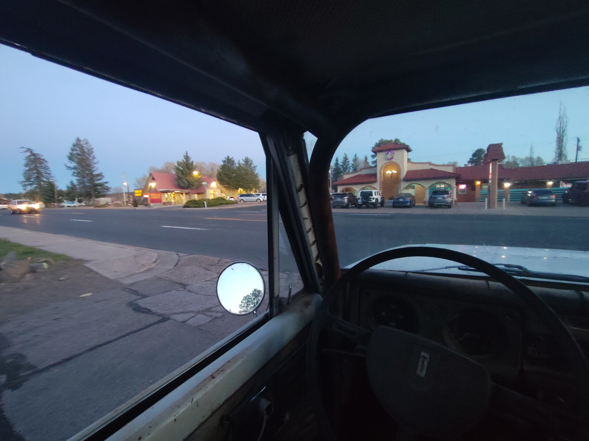

So i let it idle while i farted around. And decided I needed to try to make it drive again, and it did. I drove up around the block, and then down to the gas station. Them tires got a MEAN wobble after sitting for so long lol but everything went great, suspension actually felt amazing. all three gears worked great as well. What a satisfying drive that was.
You gots to celebrate those victories!!!
