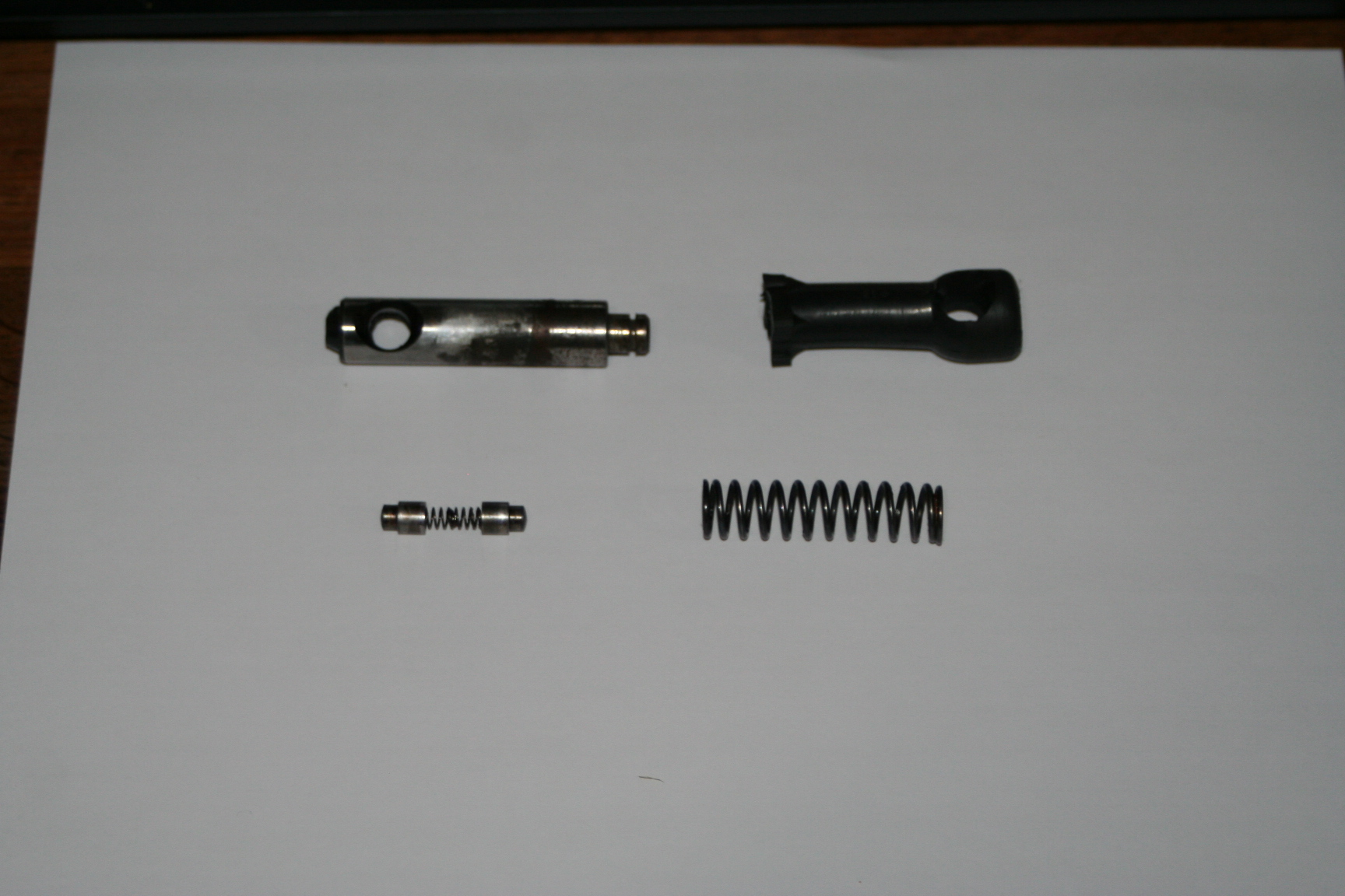

Here you go, I'll try to get to the post office tomorrow. At least now I know how to repair a column shifter. :)
The section that looks like a C Clip goes on it - do I need to access that from behind the steering wheel? or was there a trick to it?

Just the little piece I need thats broken is plenty lol I am pretty limited on storage space where im at. (maybe the little shift knob too since mines missing)

I had to jump on this part though. got the parts from @scrapdaddy installed and i didnt have the washer or clip either. So found a washer in my stash, and an old throttle spring. Peened the spring between two hammers, heated it and made my own clip. Shifter works normal now.
