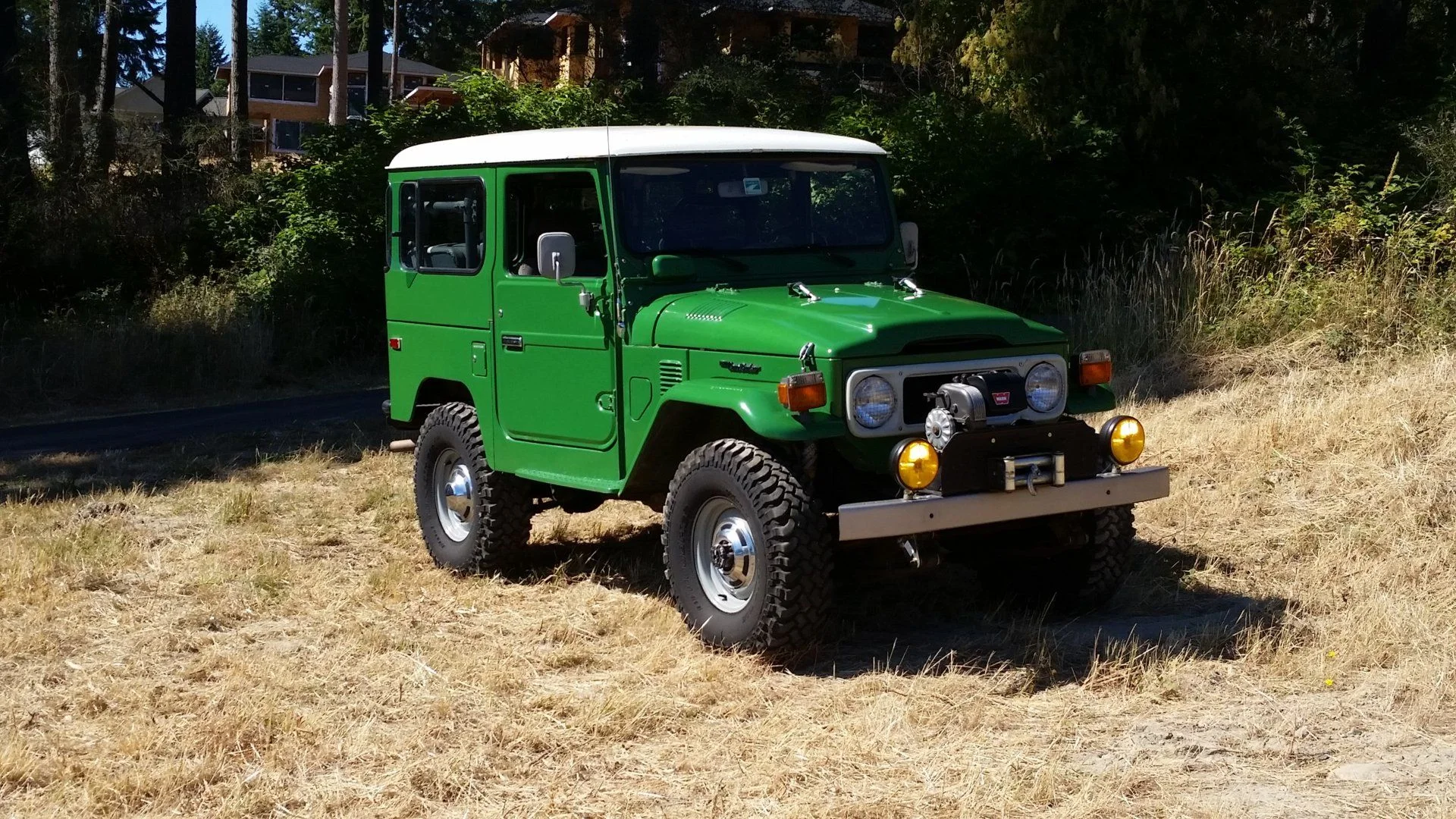

Warn 8274 w/ OEM Bumper Pictures?
Nice ride. I think thats some version of a ccot bumper. Thanks for sharing.
Actually that was an option (dealer option maybe) as you can see in the photo below.

About to mount my 8274 to the stock bumper and probably over thinking this. Due to the shape of the 8274, if you center the drum on the bumper the winch as a whole obviously looks offset to the passenger side by a considerable amount as in this pic. Has anyone considered offsetting the mounting a bit to make the winch as a whole a little more centered on the bumper? Or am I just being goofy?
Mount it with the drum centered. If you haven't converted to Saginaw power steering yet it will leave you enough room to do it in the future.
