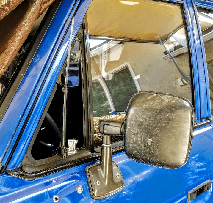

I got mine from Trail Tailor a while back....
Some parts are still available

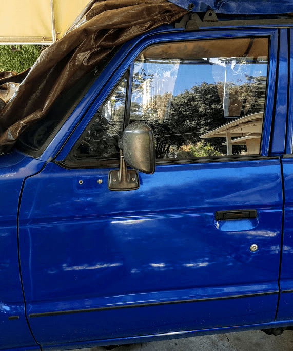

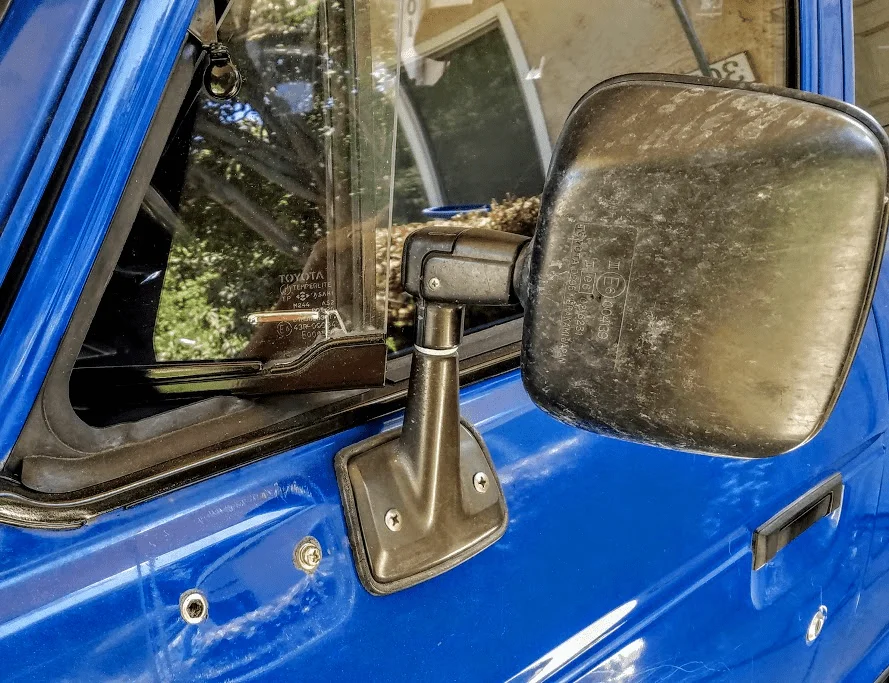

View mirrors need relocation for the vent window to open all the way...
How much do your windows open? I never thought about relocating the mirror, I figured the window wouldn't open much/any farther then it hitting the mirror, since I assumed that non-US 60's that had these windows had the mirrors in the same spot, no?

How much do your windows open? I figured the window wouldn't open much/any farther then it hitting the mirror, since I assumed that non-US 60's that had these windows had the mirrors in the same spot, no?
With mirrors in stock location, these open at around 95°-100° angles, with mirrors relocated these open fully at 130° angle
I moved them enough so that the window clears the mirror stud...
fully open..
the other thing is that I could barely see anything on the pass side mirror with the vent window open...
