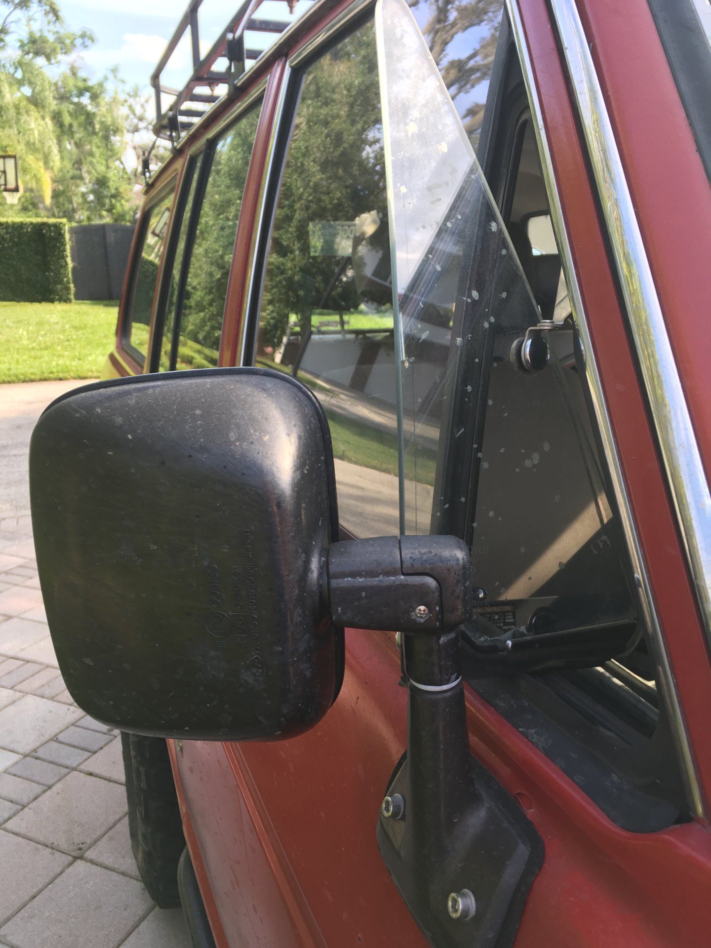

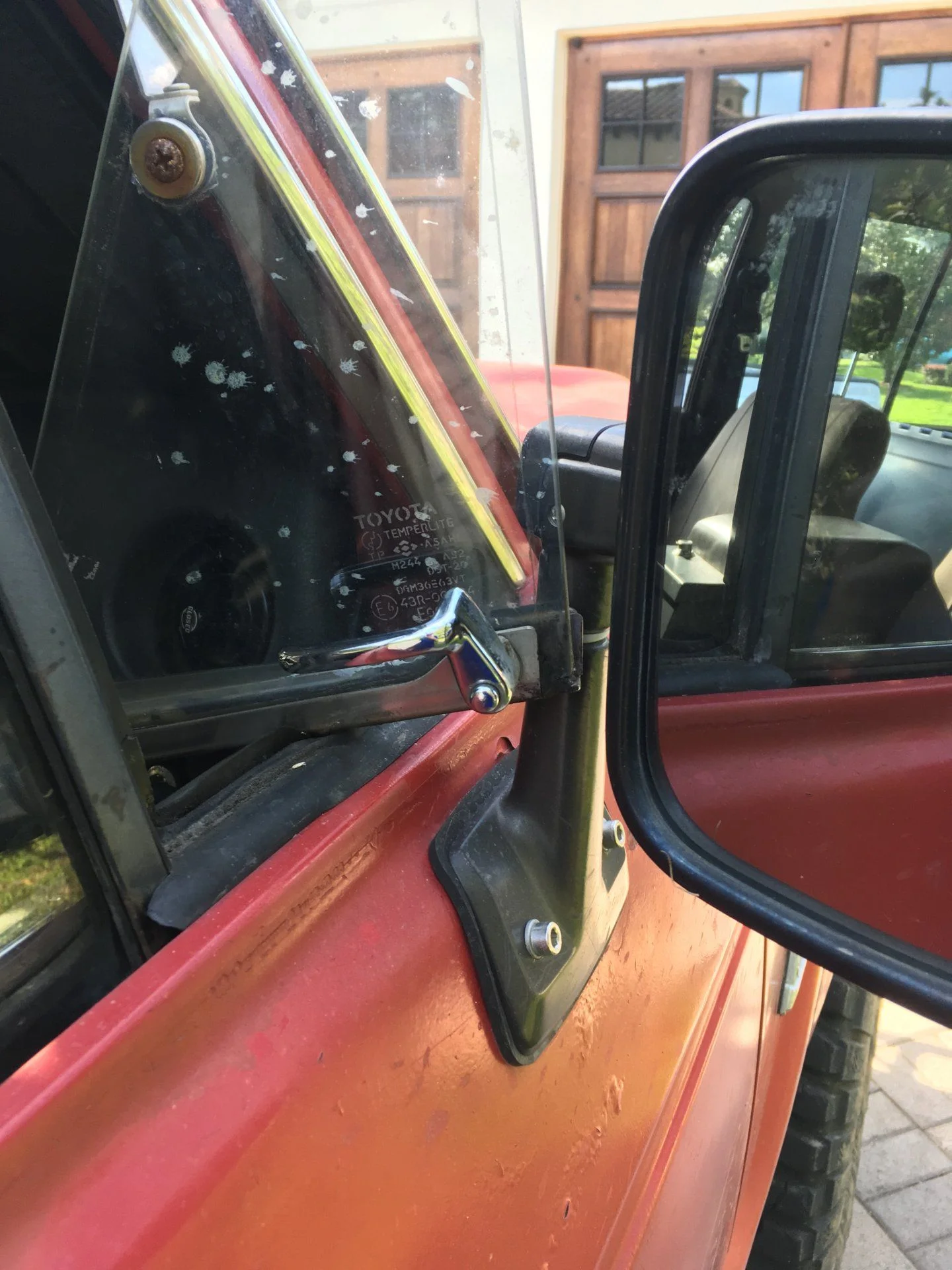

I installed vent windows recently (I grew up calling them wing windows...) and noticed that they get really close to the stock US mirrors. I had intended to eventually upgrade my mirrors to the Aussie style, but suspect that my vent windows would bump into them. Does anyone know if that is true or not?
I have Aussie mirrors and wing windows on my FJ62. I’ll post a picture of that they look like opened up in a few minutes.
Sorry dude! Totally forgot about this. Here you go.

Ok, those look like they open far enough to get a decent blast of air, they go past perpendicular. BUT, I like to have mine open to hit me right in the abdomen, does the mirror prevent that? It looks like it might not quite make it.
Yes, in the picture they are opened as far as they will go. It’s not mirror dependent, I think they will open the same amount with whatever mirror you put on there. They might open a touch farther with stock FJ60 mirrors because they are a little bit lower I think.
Mine definitely swing a ways past the stock mirrors. I'll have to fiddle and see how much of a difference it might actually make.
