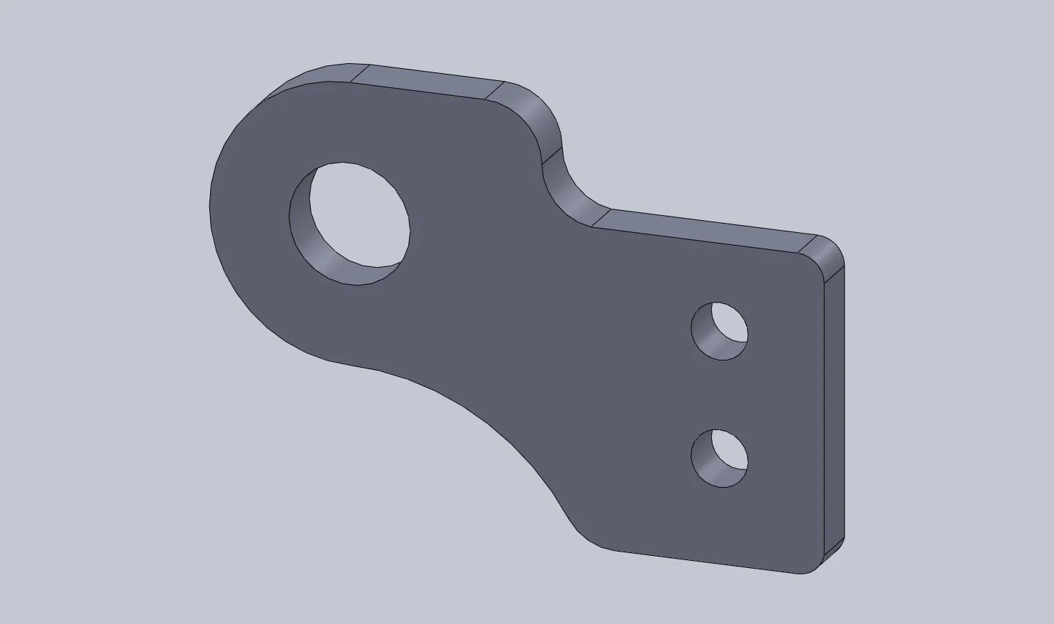

200 Series Front Tow Mounts
Anyway FFwd just a couple of weeks and he is currently finished his design and will be getting quotes from his fab shop this week to provide pricing. Bolt kits have been ordered and will be for sale separately, options are always great! The first run will be raw steel and limited to just 15 so get in line right behind Me! If they sell well then he will probably offer the next batch with powder coat, maybe red like the 200 Series ones?
Specs:
1/2" Grade 70 Steel
Laser Cut
Bolt Kit:
Grade 10.9 Zinc plated
Rendering:
gx470-front-tow-point-style-2-jpg.1520535

All of my tow point products have tensile, elongation and metallurgical certified tests papers with every batch I run. I can trace my steel elements all the way back to the mines they were excavated from. Also, all of my steel is NAFTA domestic (USA, CND and MEX), also proven by the certified reports.
From what I can tell, from internet research, all others use A36 mild steel and ARB is the only one to raise the bar to meet a US equivalent of a Grade 50. Right off the bat my steel is almost twice as strong, not to mention the eye thickness on my mount is approx. 50% thicker than others I've seen, including the one you linked above.

I know for a fact that the weak link is the frame and capture nuts when it comes right down to it. Trying to make the most substantial and strongest bearing joint is the key for the design. The bolt up creates a single shear plane as well which is the weakest as well unfortunately.
Hardware... yes its up for interpretation. Here's how I qualify it to myself.
For my designs and most AISC structural designs a 1.5-2X factor for area elongation of fastener is the field rule of thumb. Most AISC/ASTM specs are based on the shape and size of hole the bolt will be used in and based on a .7 to .5 multiplier in most cases. So for a 1/2" bolt in 1/2" steel (of equal strength) with a 120ksi yield (bolt) the rule of thumb for the elongation shear value is 60ksi.
So a grade 5 or 8.8 would be sufficient, but that extra 3500# of rating is very appealing for $3.18 of extra cost for grade 10.9 fasteners to me and most others I've ever dealt with. But, more than likely the frame will fail before the bolts..
Single shear of a 1/2" grade 5 ~8.8 bolt is 14136.5#
Single shear of a 1/2" grade 8 ~10.9 bolt is 17670.6#
At the end of the day I overbuild most every thing, years of engineering review for projects and QC inspection, but I wouldn't have it any other way.

I understand your reasoning for wanting to design the strongest product that you can and I understand how you use a particular metal and hardware grade to do that.
I find it hard to agree with the idea though. We know that there is always and will always be a failure point. If enough force is applied something WILL fail. I think we can agree on that? As the owner of the vehicle I have the ability to choose in this instance where I would rather that failure point be. I personally would much rather see your points or your hardware fail than my frame so with that in mind it would seem that going up to grade 10.9 you are only increasing the chance that the failure point becomes the frame.
If you can convince me why it's better for my frame to fail then I'm all ears...
