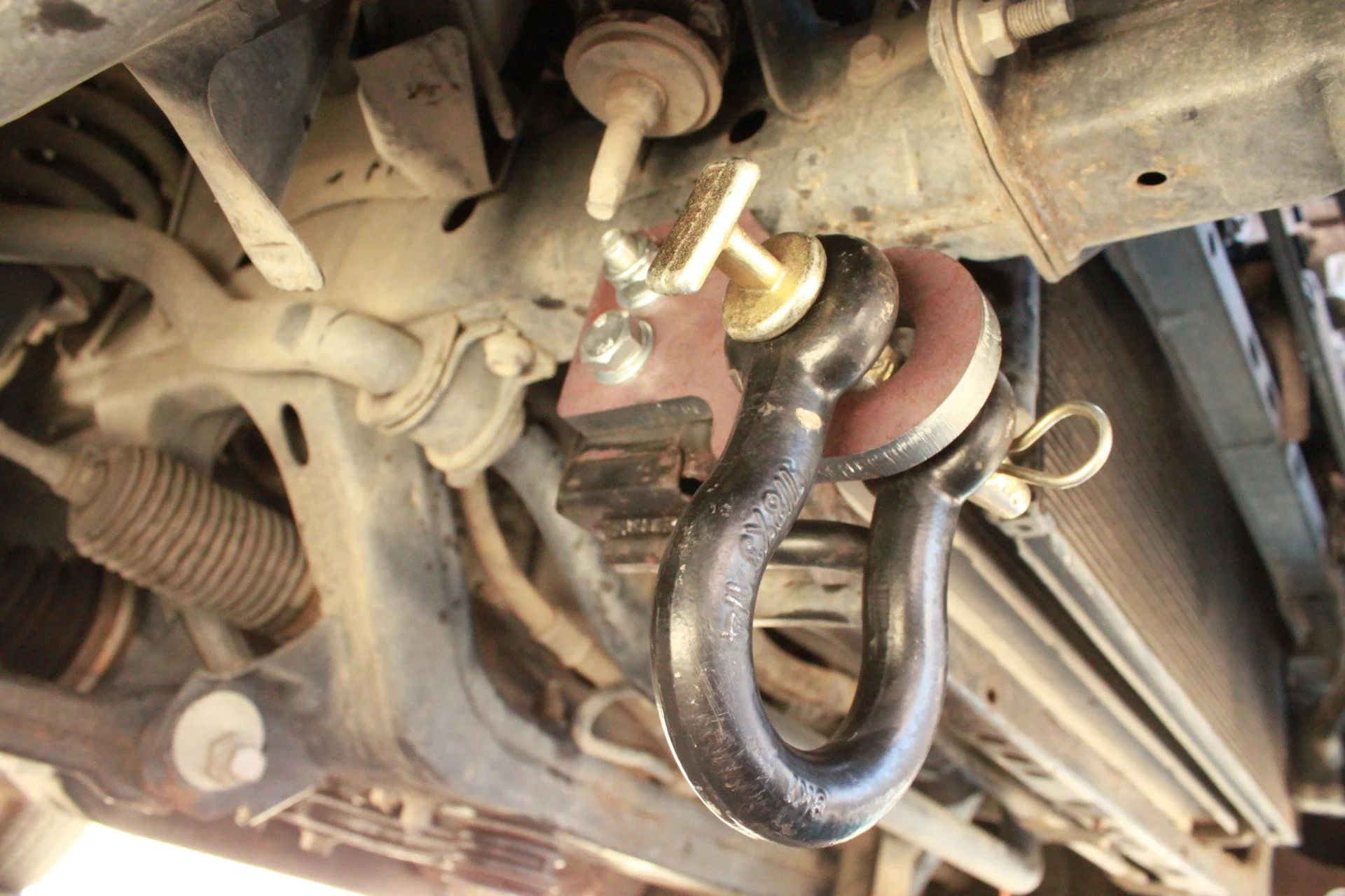

How does this load equalizing bridle work? Do you attach it to the OEM tow loops using a D shackle?
Also, whats the difference of a load equalizing bridle compared to a tree saver tow strap?
[Edit: I think I found my answers here Recovery Straps and Accessories ]

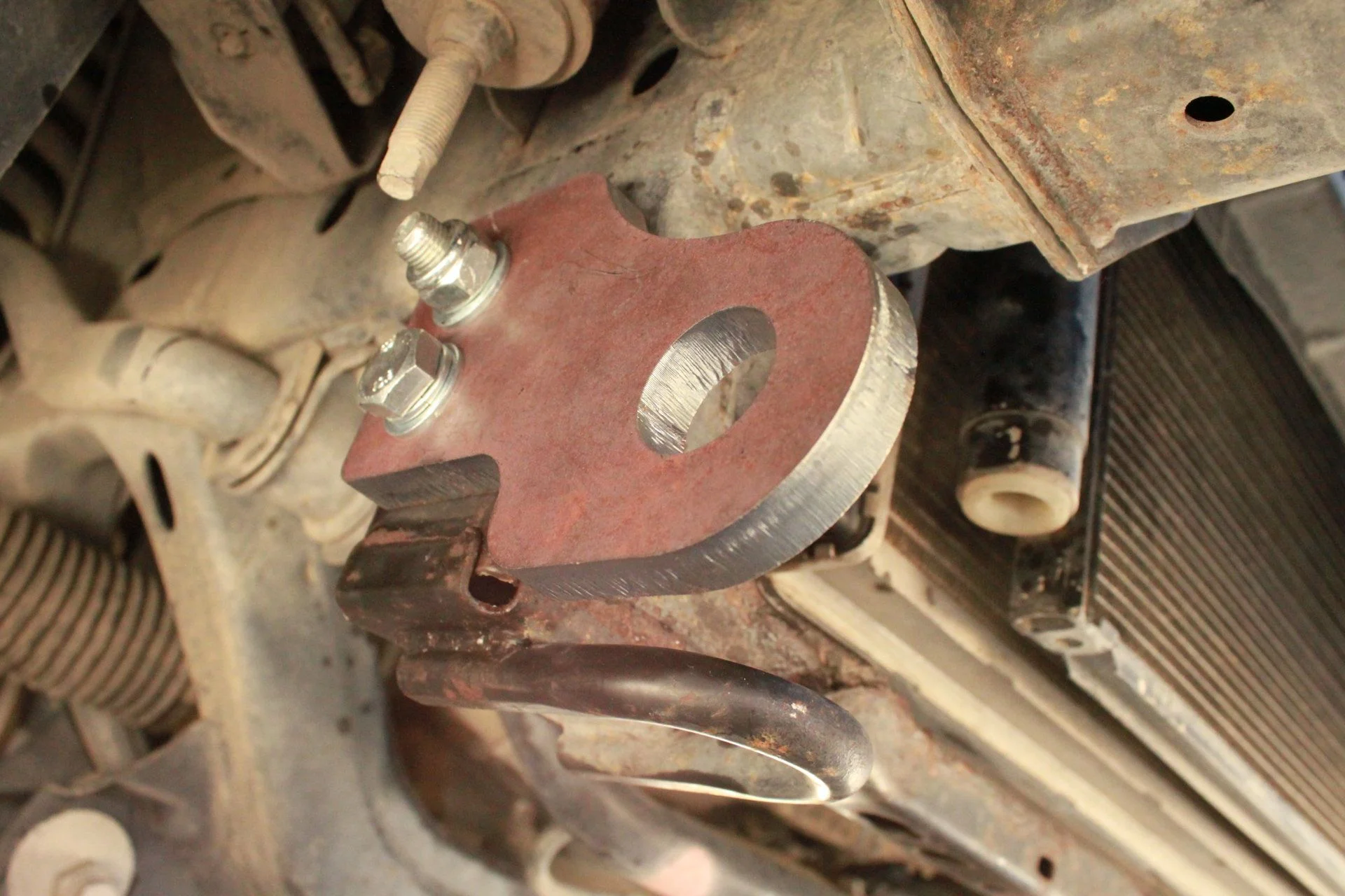

These aftermarket tow points/hooks look nice, but do you have to move the radiator in order to fit in the bolts? I don't want to touch my radiator.
If a Load Equalizing Bridle is available then why not use it? It just spreads the load across both points. There is no downside to using it whatsoever. You will have to unbolt the radiator and slide it up just a hair then drop it back down. It's not difficult at all and doesn't require messing with fluids. I don't consider myself a mechanic and I did it no problem.

Tow Points GX470 120 Series
Grade 10.9 bolt kit (sold separately)
