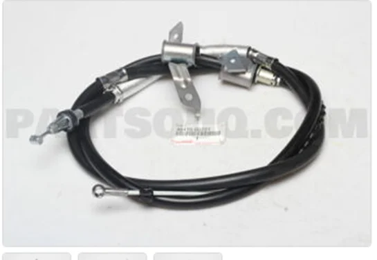

related: my ebrake handle goes its entire throw w/o resistance. dealer says the rear to front cable is broken. does anyone know the fsm (i have the digital 2004 one) page/section that addresses replacing this? particularly interested in how the anchor end interfaces with the handle and how it is fed into the cabin.
BR-33 (p. 2169) starts the parking brake section.
Couldn't find a section that shows parking brake lever install/removal though...?
can't believe 'yota left this to our imagination. my stealer is getting all the pbrake parts just in case the cable replacement id only the canary in the coal mine.
stand by for bitch & moan story after I get my rig back......
