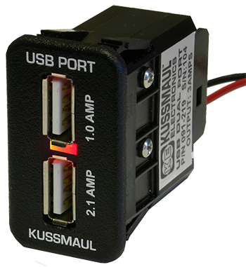

I installed this in my dash - it fits our switch blanks. The LED is a little bright so I painted over it. Still can see it though but very manageable for night driving
Kussmaul Electronics USB Dual Ports
